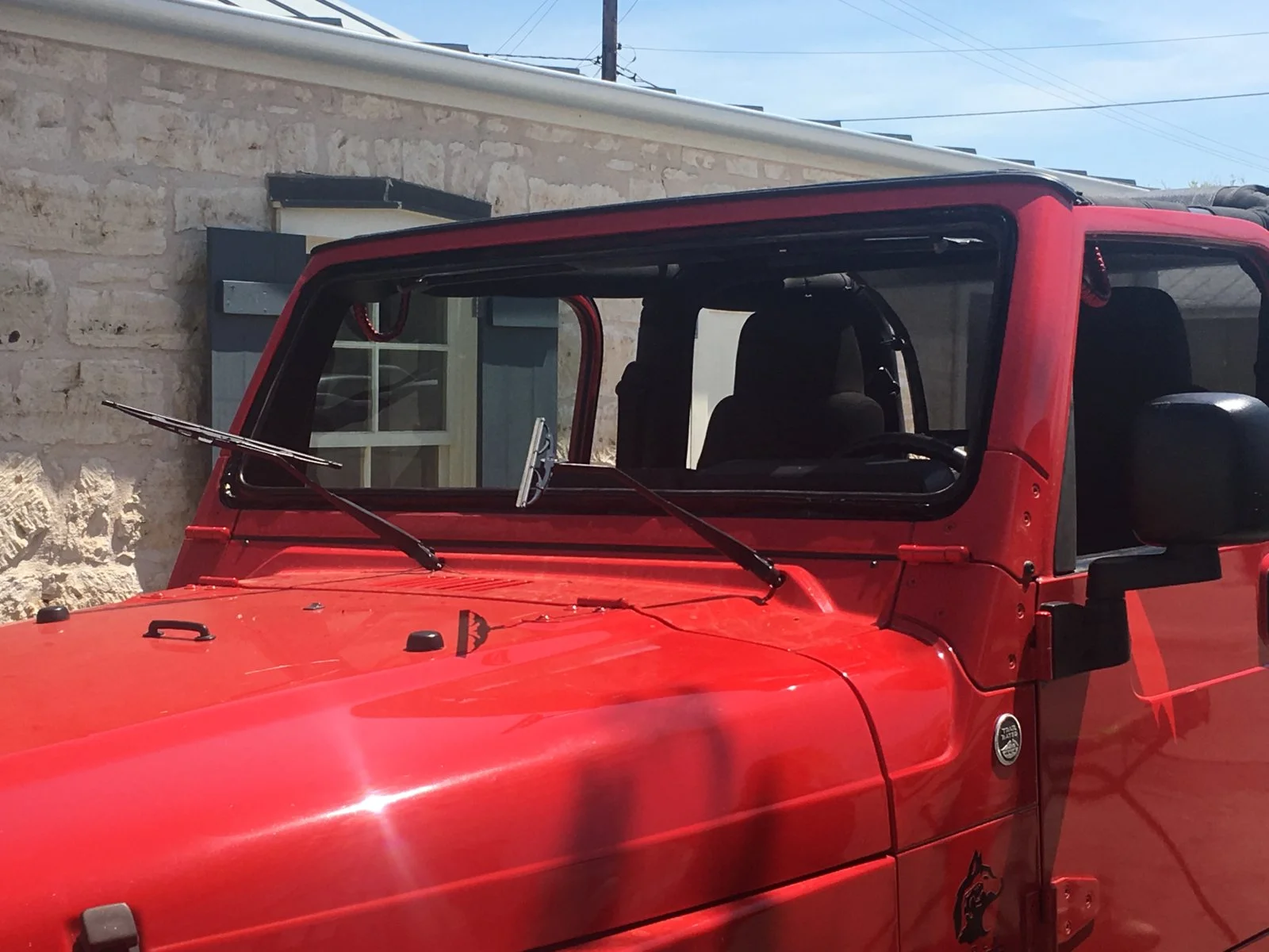

The next day I was changing my oil and a freak wind blew my hood all the way open so it hit the header above the windshield and dented the hood. I worked some of it out with a piece of soft wood and a rubber mallet, but I can't do much more at the folding seam on each side of the upper hood. Thankfully, it's not very noticeable, so I'm just going to move on. A total repair and repaint was $1100 and PDR was $175, but would only correct about 90%. Let's move on in life...it's a Jeep...You may be able to see part of it toward the left side of the pic above, on the seam that goes up on the hood.

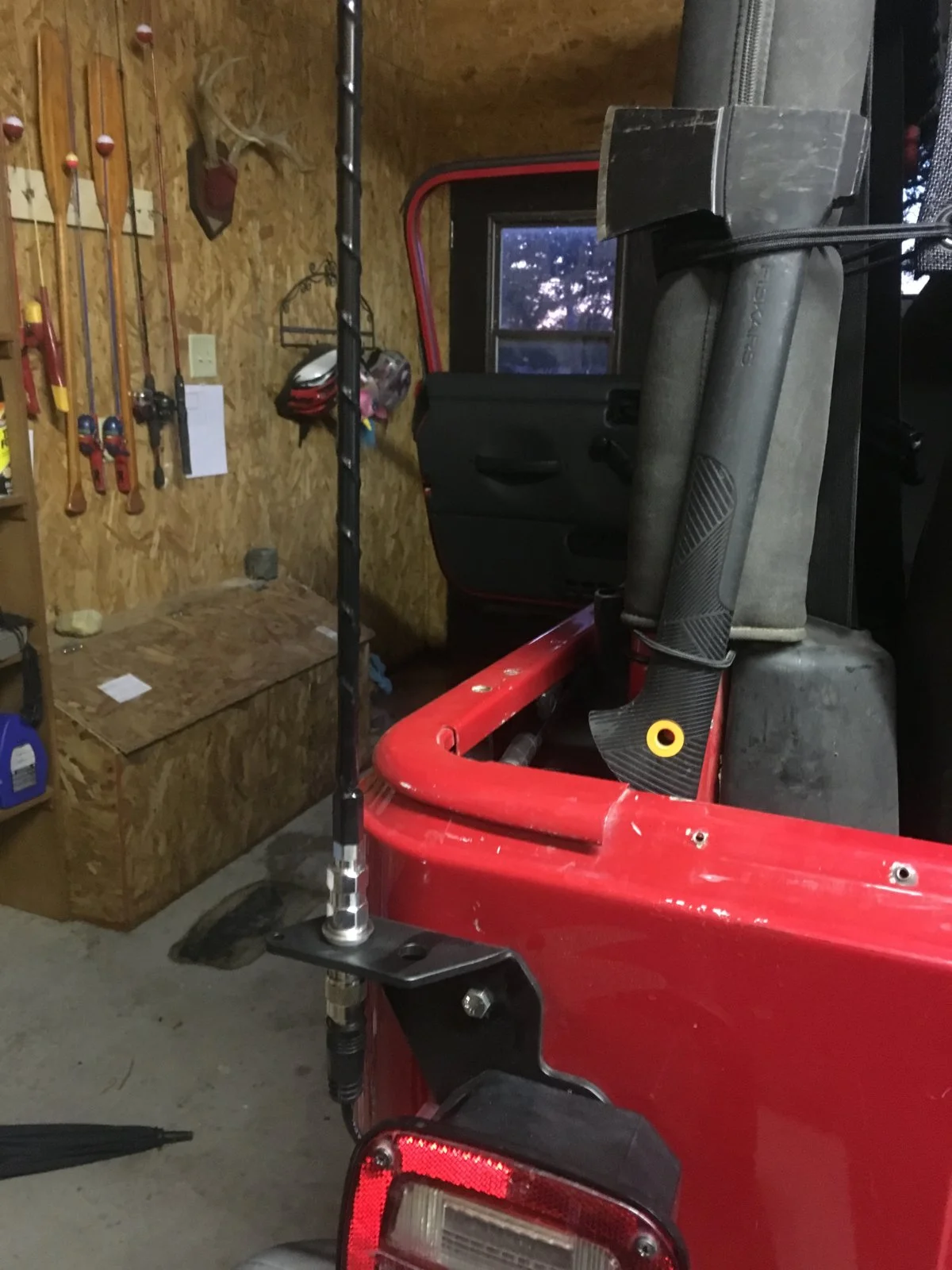

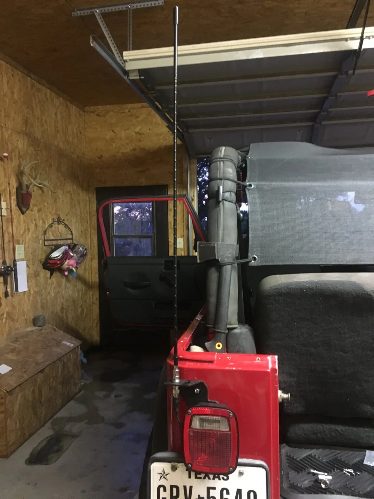

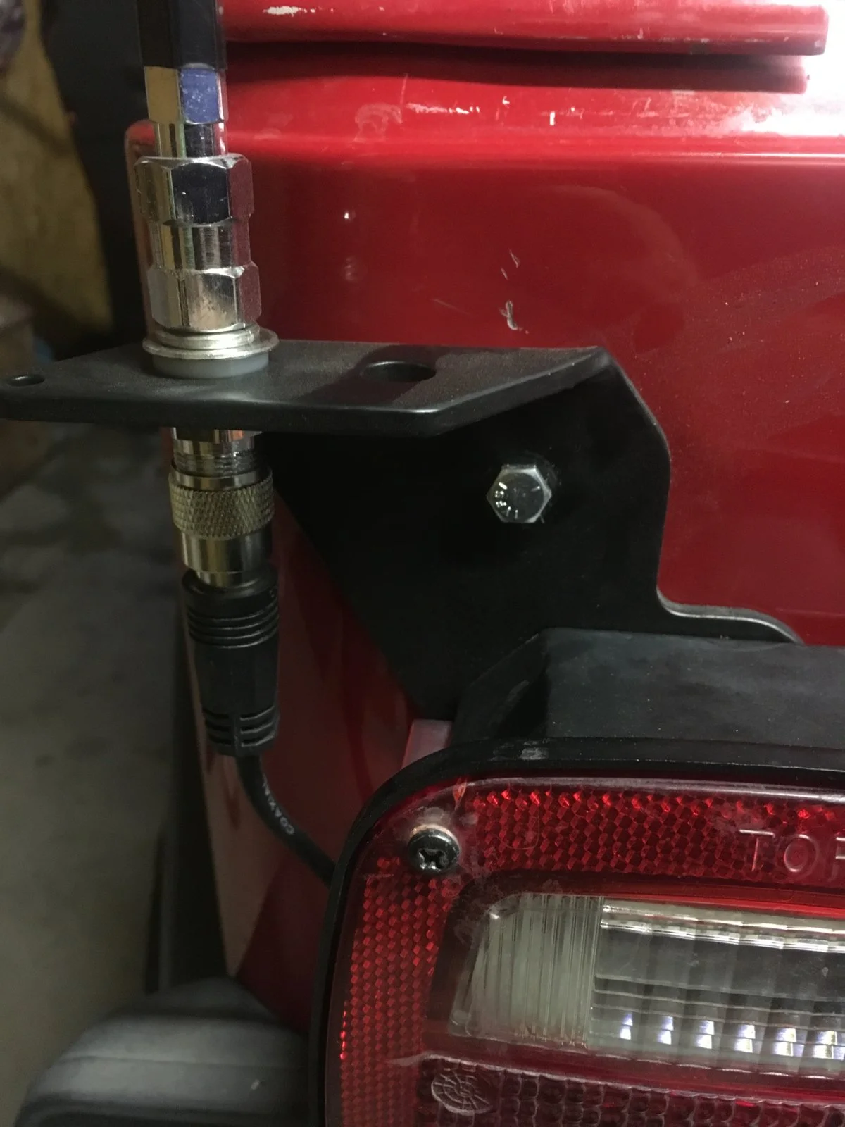

Next up, completing my CB/Antenna setup. I’ve been running the Cobra 75WXST for a couple months. Problem was I tried to run it with a Cobra Antenna with magnetic base. This meant I had to bug @b0xcar at every wheelin outing to retune my CB with his SWR meter. So, I’m done with that. Bought the Teraflex Mount for Drivers side, 18’ Co Axial Cable, Co Axial Stud and, last but not least, the Firestik 3’ Antenna. Setup is tried and true! One more tune bro, then we can wheel unhindered. Shout out to @JamesAndTheSahara , been missing you bro! Nice to see you touch base.

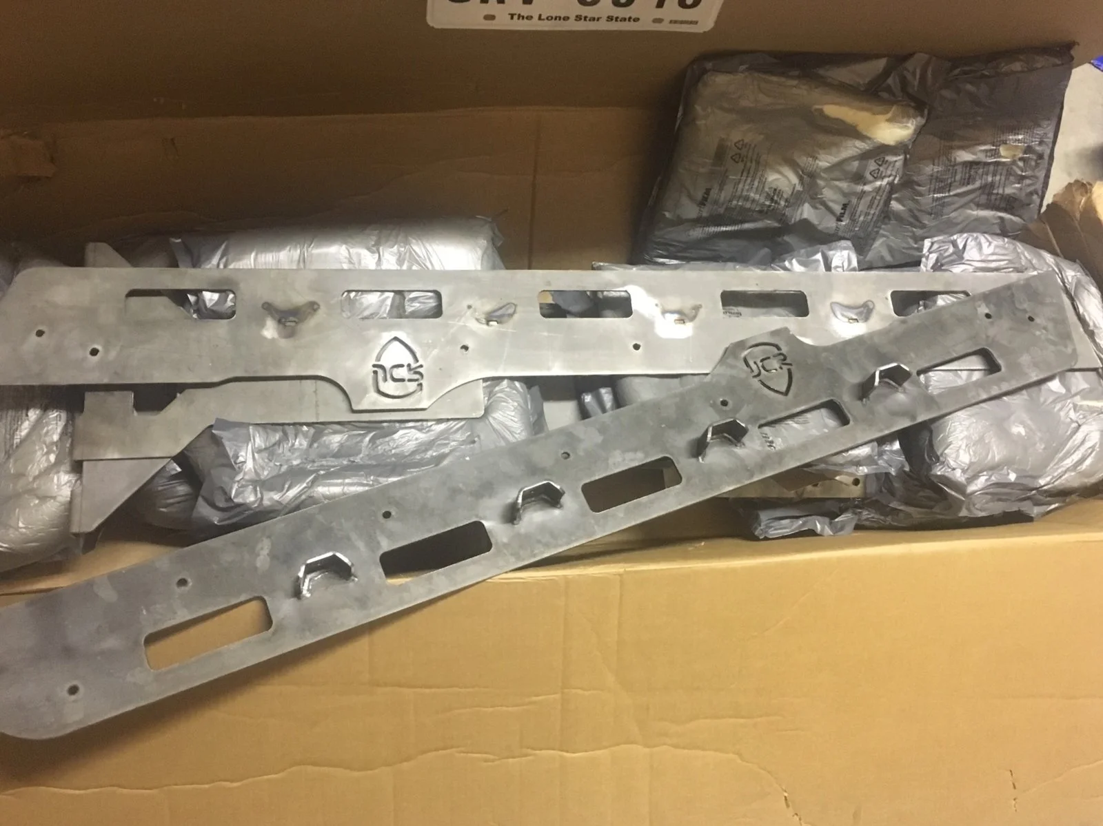

Using cost, function and others wisdom as my guidelines I decided on the JCR Crusaders. Big box.

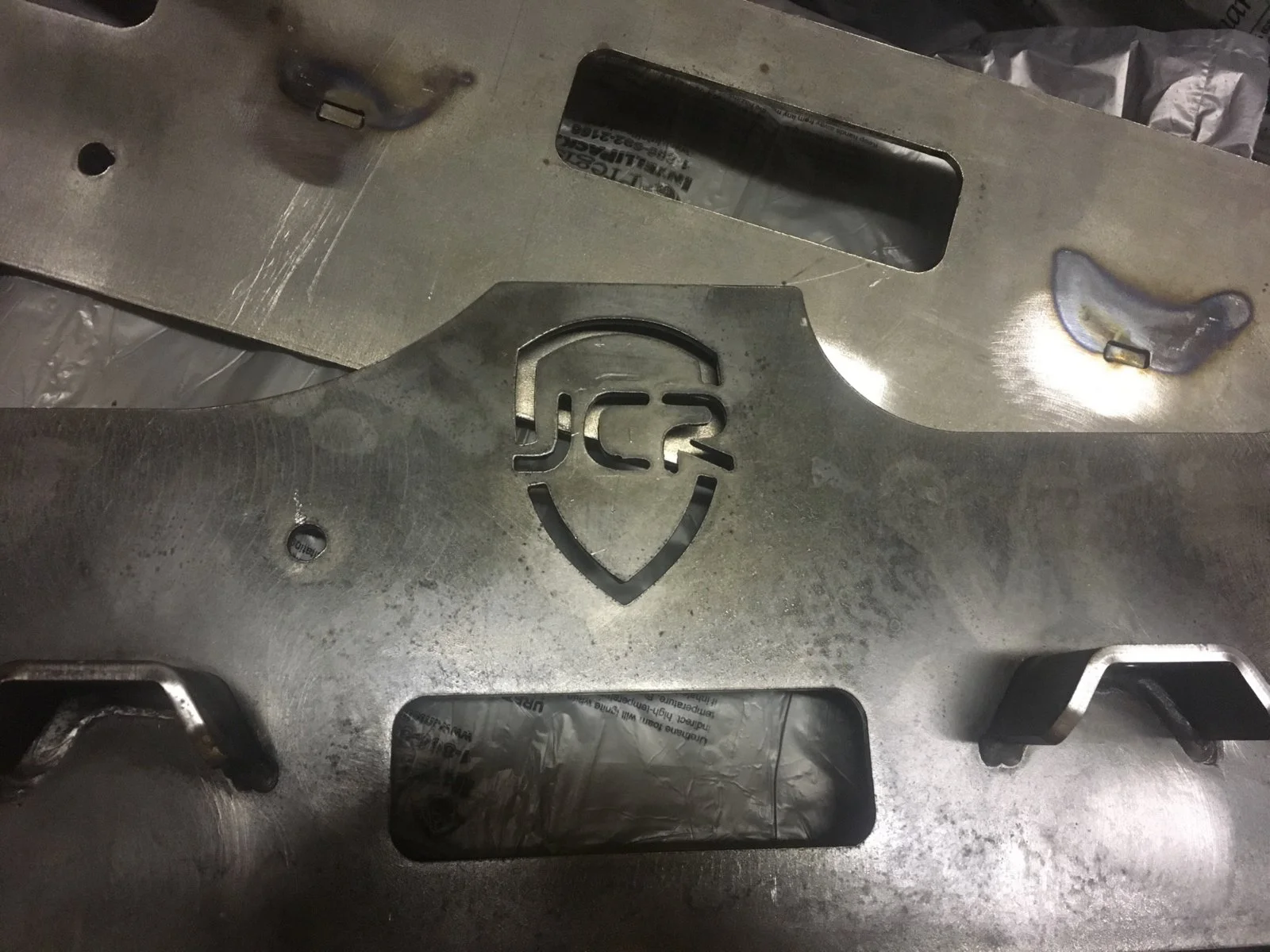

I decided to take a peak (pic) inside the box. It’s nice seeing the design firsthand. Welds look well done. The sliders (not pictured) have a perfect 45* for sliding. Backplates are ww2ww. I took the excellent advice of @Ranger_b0b, whose engineering background and creativity are a great help to me, to replace the 8 clips that hold the slider to the backplate with 5/16-18 rivnuts, on order and will be here Thursday so I can get to work. These will be professionally painted with 2K ceramic satin black.
