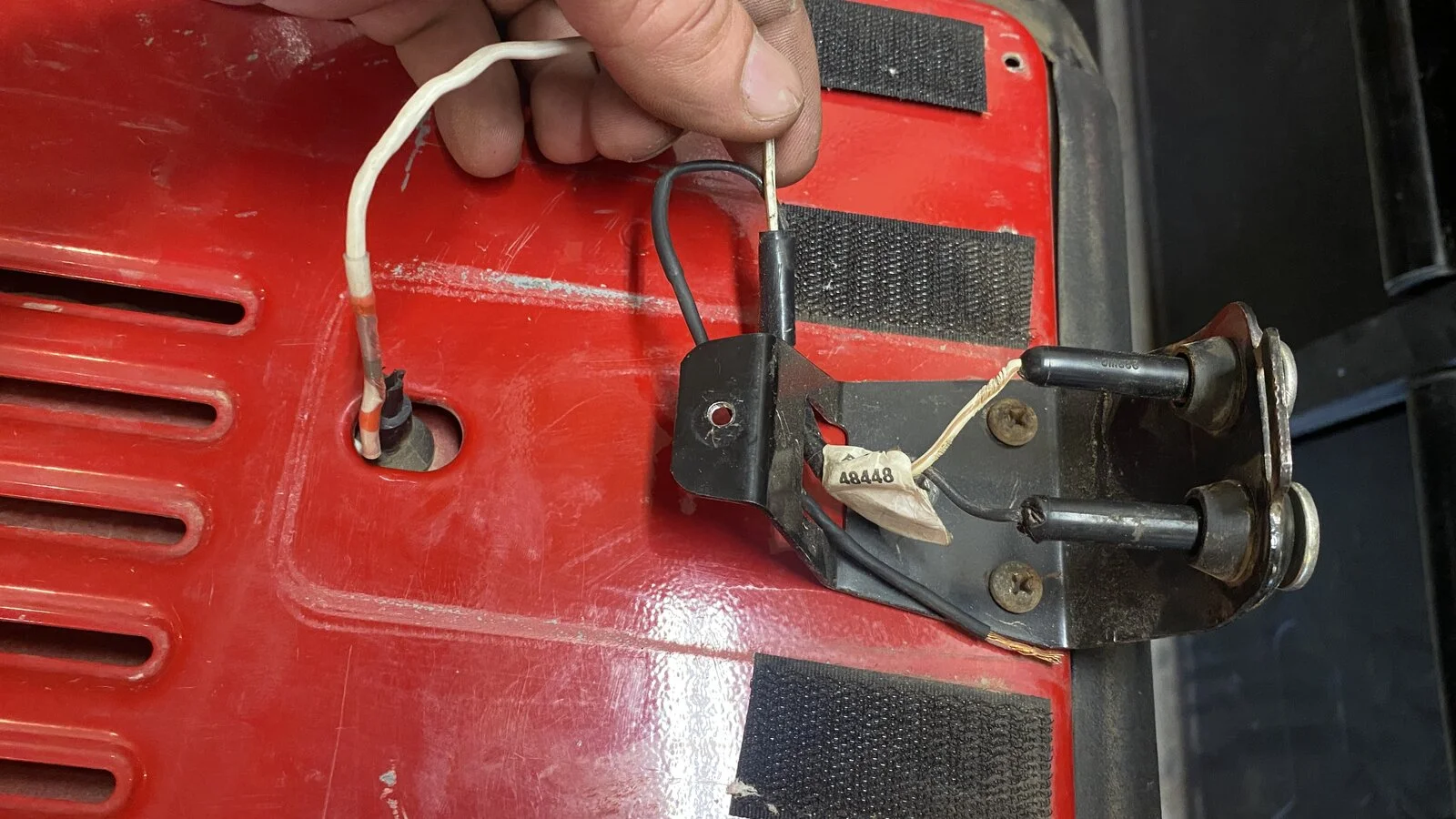

My neighbor stopped by and said, “ What broke now?” I said, “Nothing broke, I’m just fixing stuff.” So it is with a Jeep.

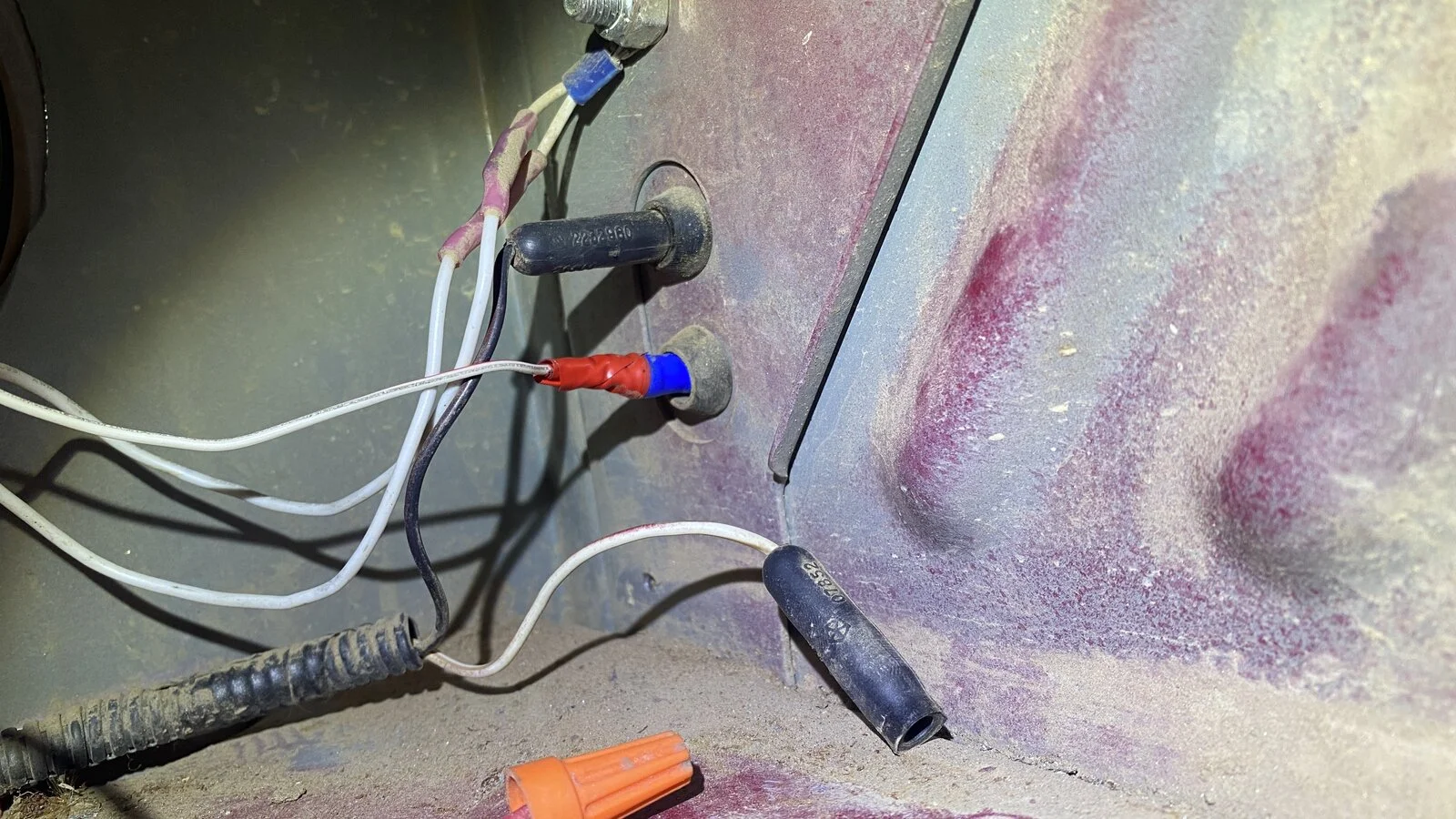

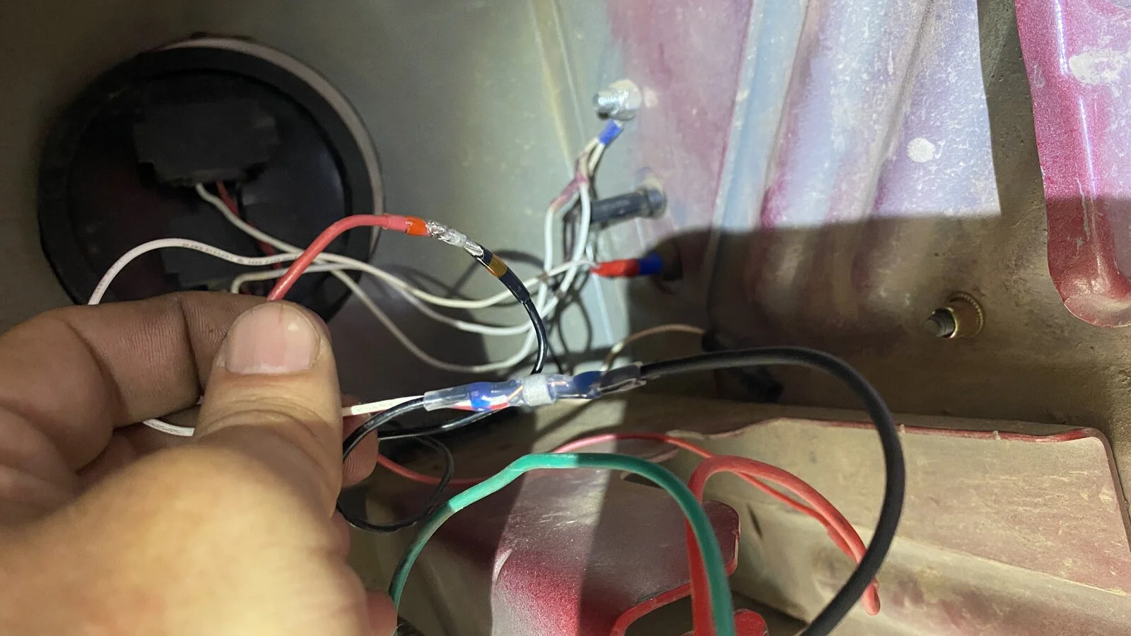

Fixed lots of things. Brake lights weren’t working. It’s been an issue since Moab when Alex and I did the GR fenders and corner armor.
On the 05’s you have the evap in the rear passenger corner. I’ve had to remove it a few times in the last few weeks because I was in Moab and in a hurry. I wanted to get in to work on the rear brake lights, setup a license plate light for the tailgate, and clean up the connectors.

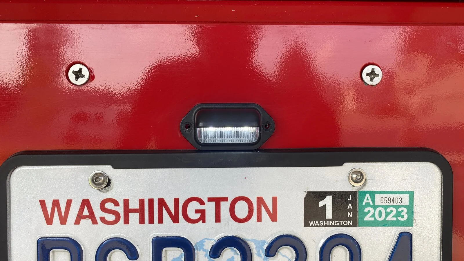

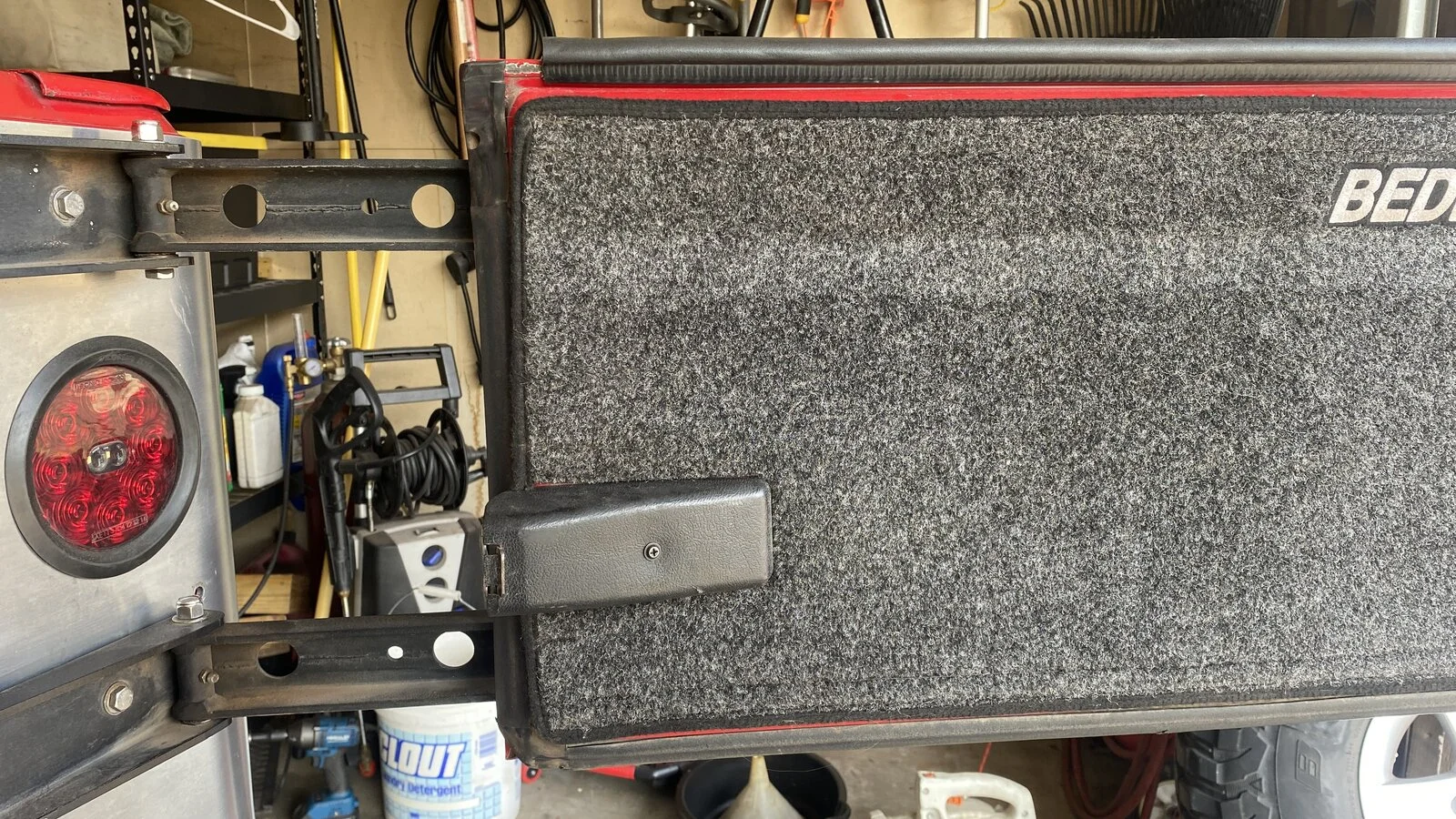

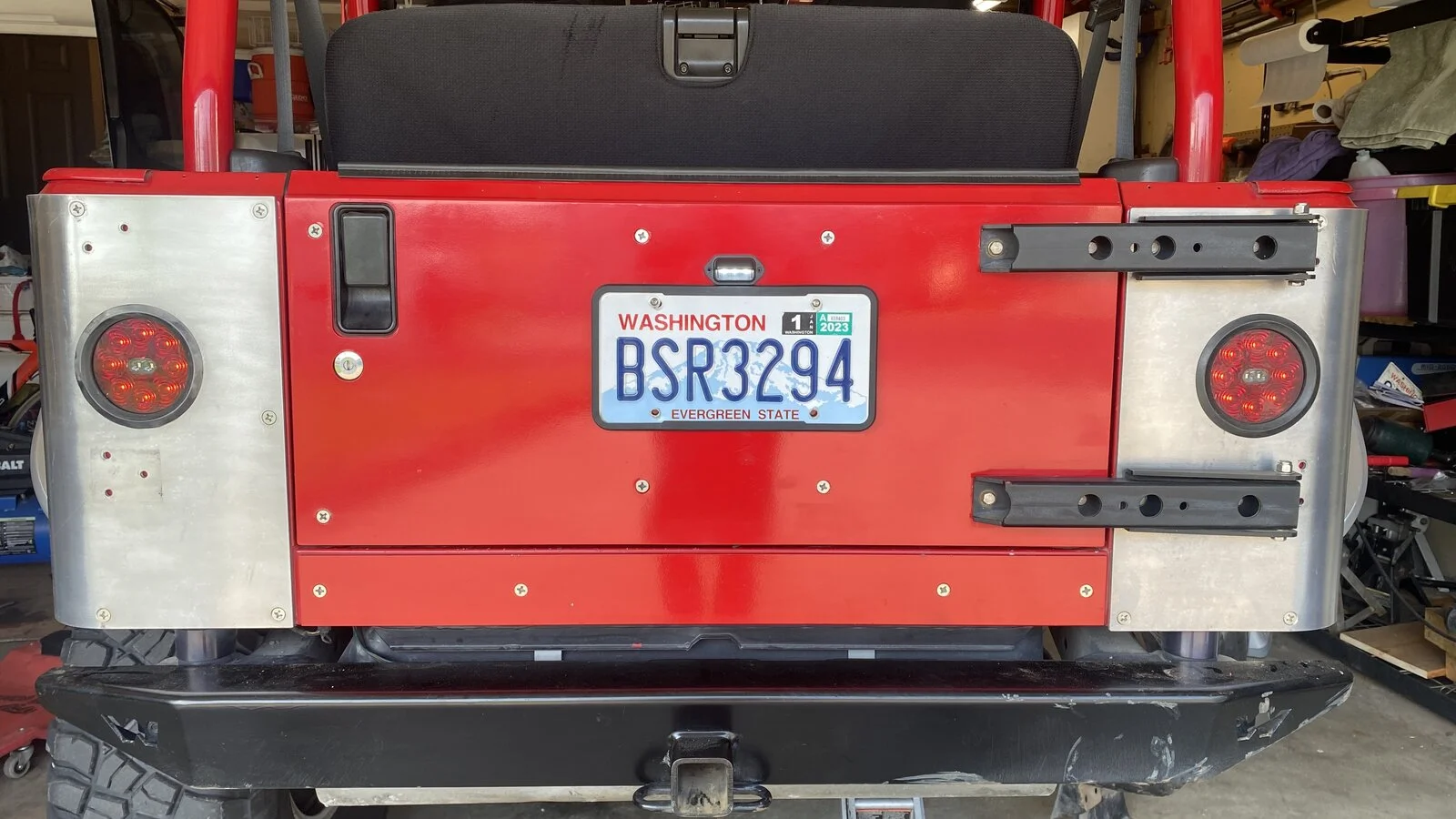

For the license plate light I wanted to ground it to the inner tailgate and get power from the tail light wire on the passenger side using one of the stock center brake light connectors at the tailgate hinge. I unplugged it on the backside and soldered a wire into a bullet connector that tied into the tail light. Worked like a charm. @Alex01 will be pleased I got good waterproof connectors on.

Looks great. Good job!!

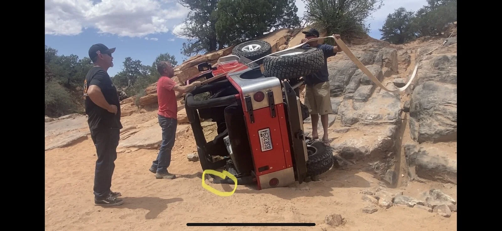

So,,,ahhh,,,,you see them better so as not to trip over them the next time you are upside down?

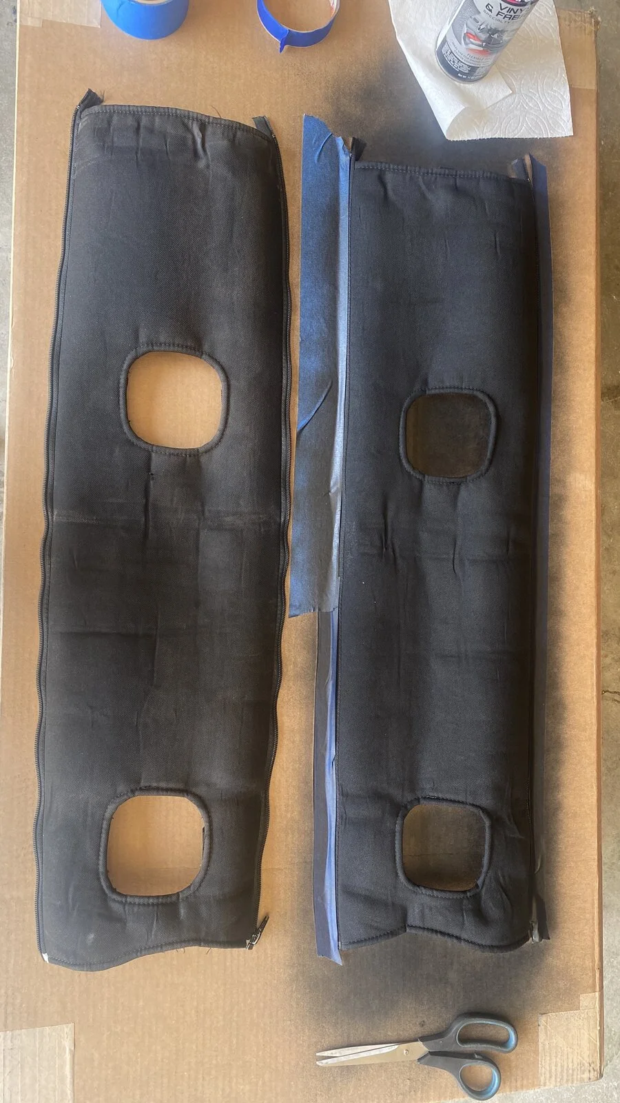

Here’s the roll bar padding in the dirt again for Redrock memorial sake. The rear are ripped in several places behind the B Pilar. They won’t be going back on. But the fronts are black! 🤣
