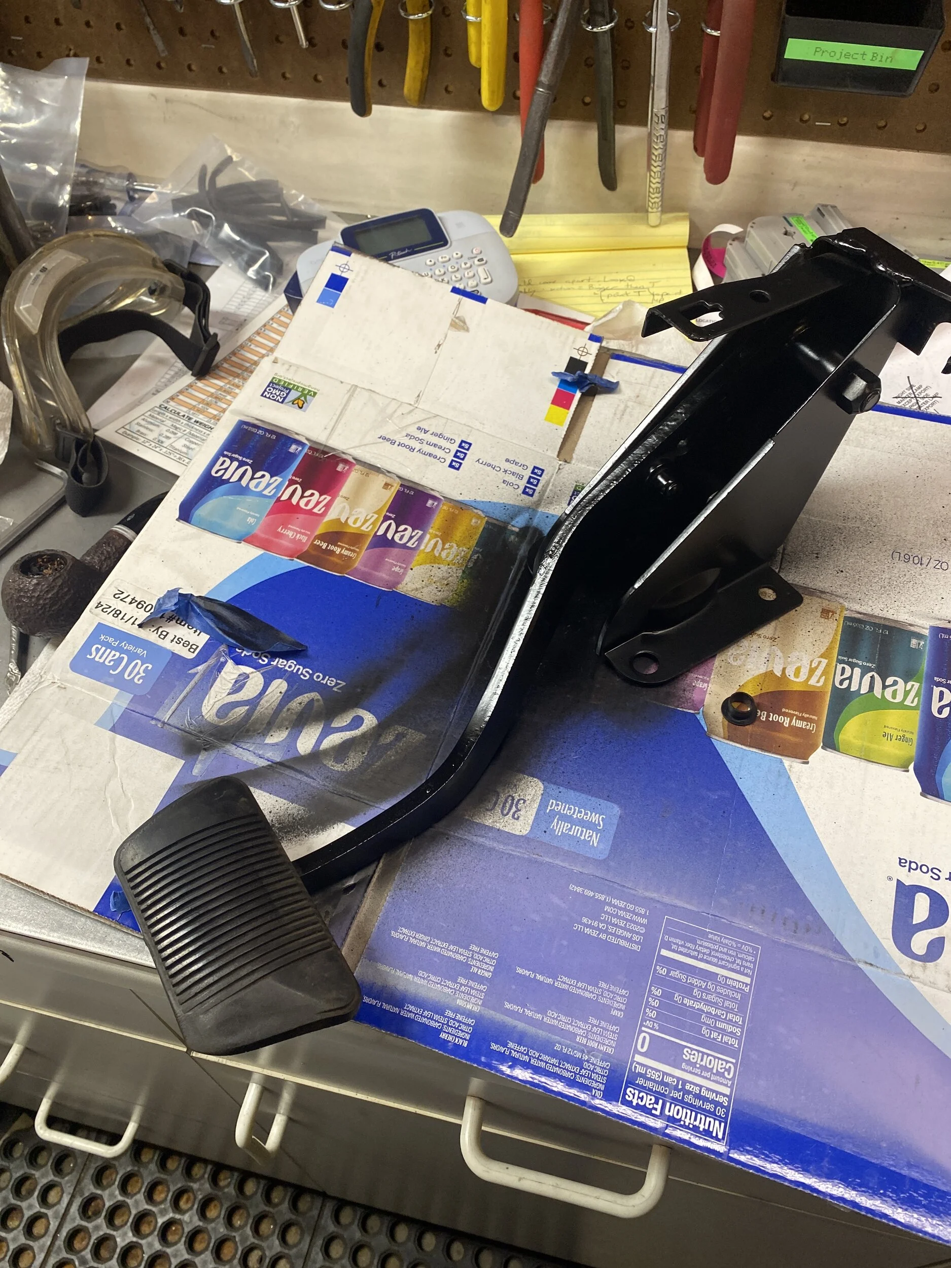

Painted the entire brake pedal bracket. I love how the factory painted just the pedal stalk about 2/3 the way up. 🤔 Not going to rust much being inside, so I get it. Pinching penny’s. But I like to have things done right.

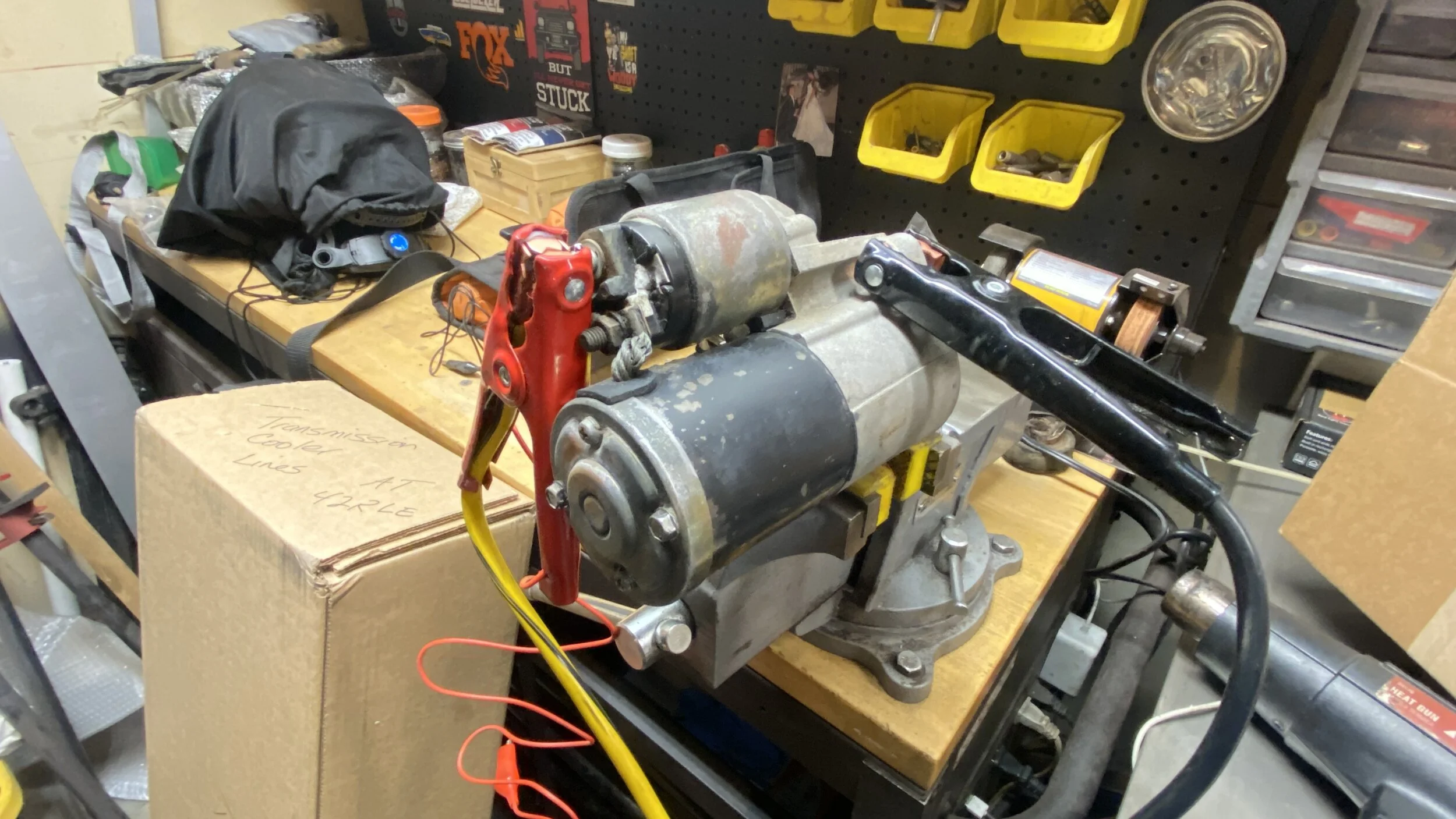

Did a bench test on the new/used Mopar Starter today. Working like a champ!
