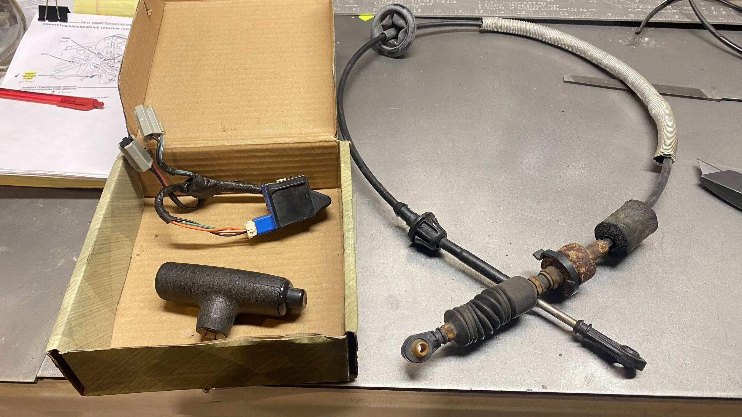

@Jamison C sent me. Shifter handle, O/D switch, and shift cable. Thanks man!

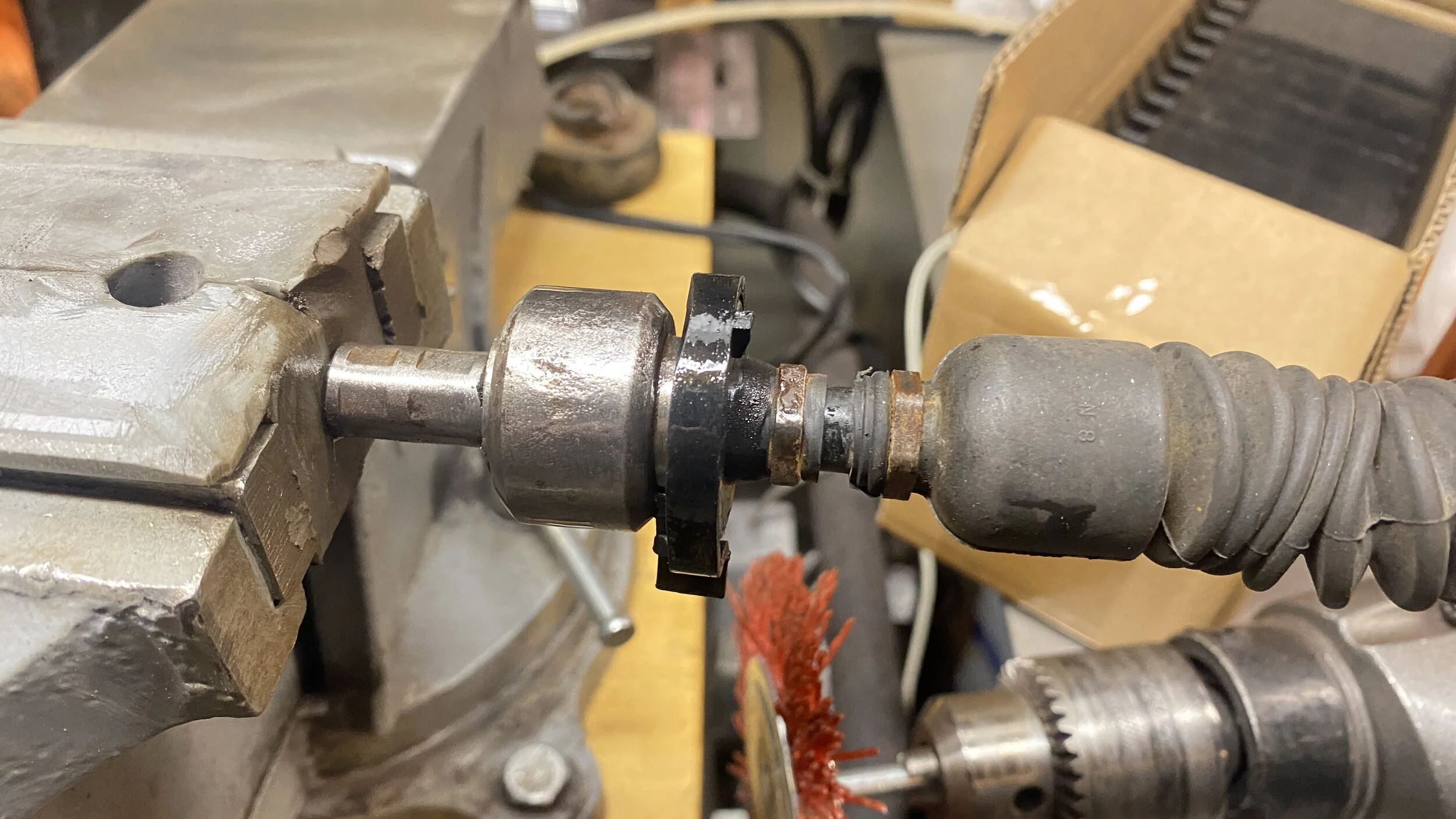

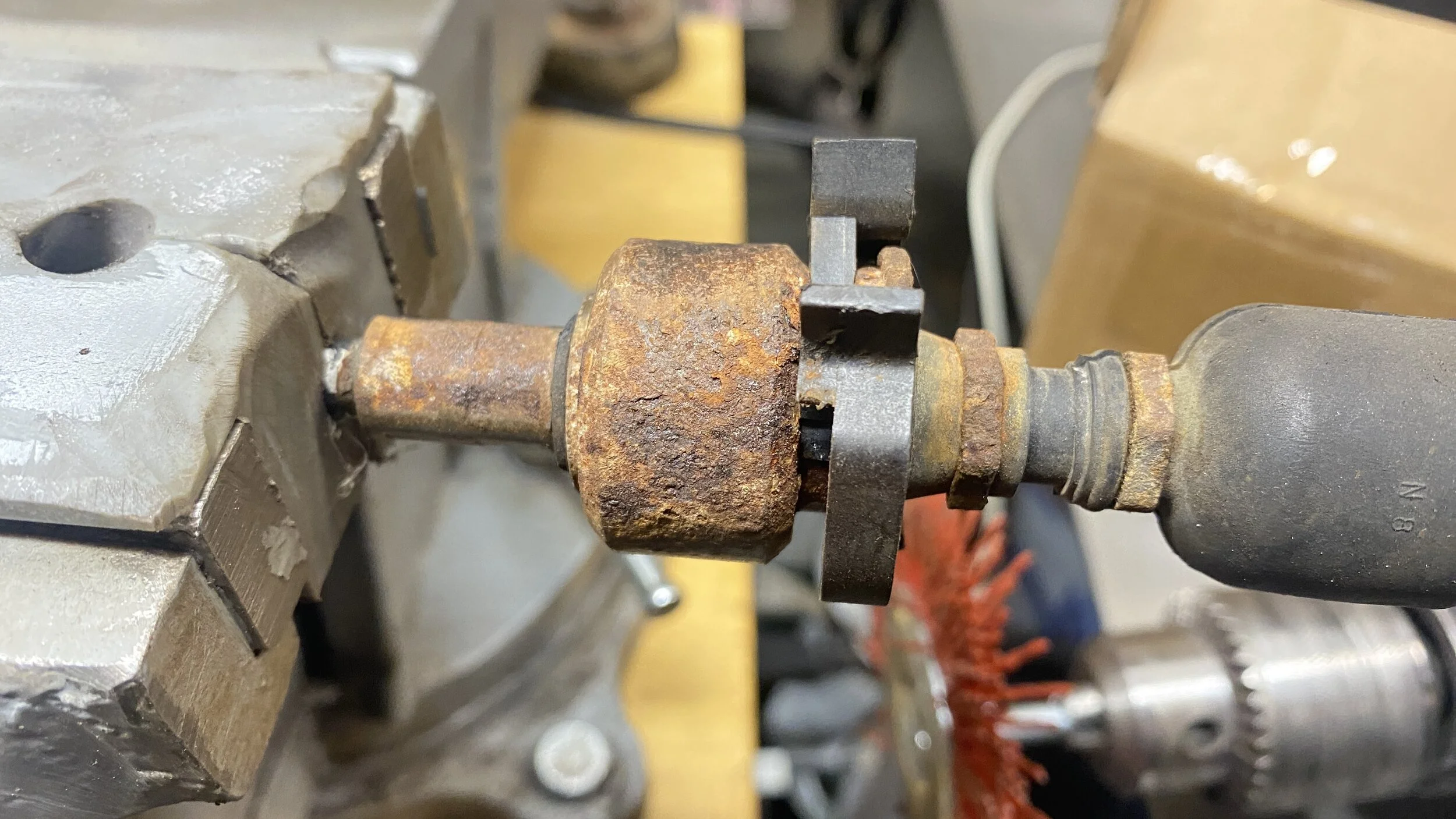

I cleaned all the rust off the shift cable.
Pieces are coming together.
