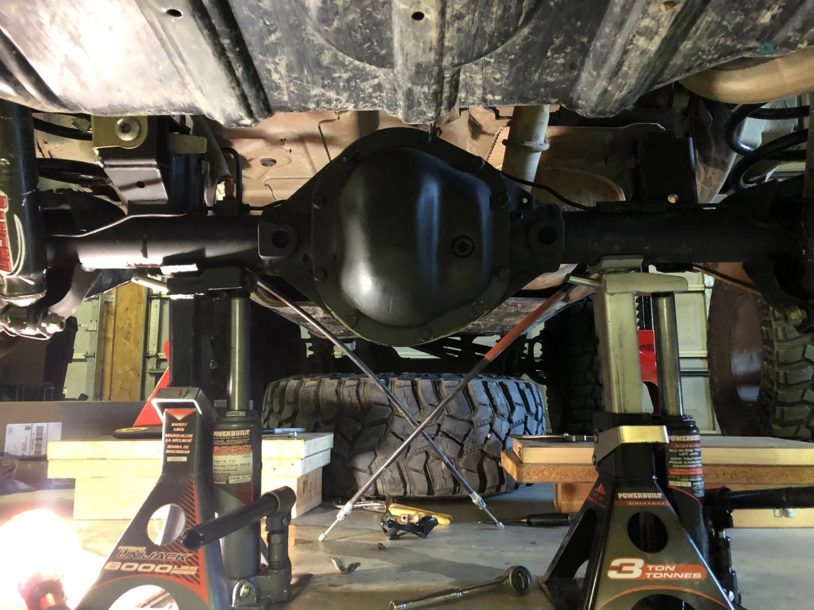

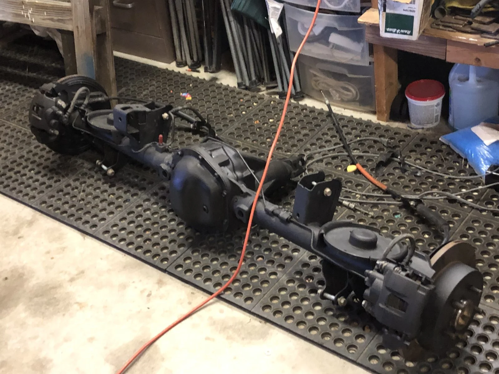

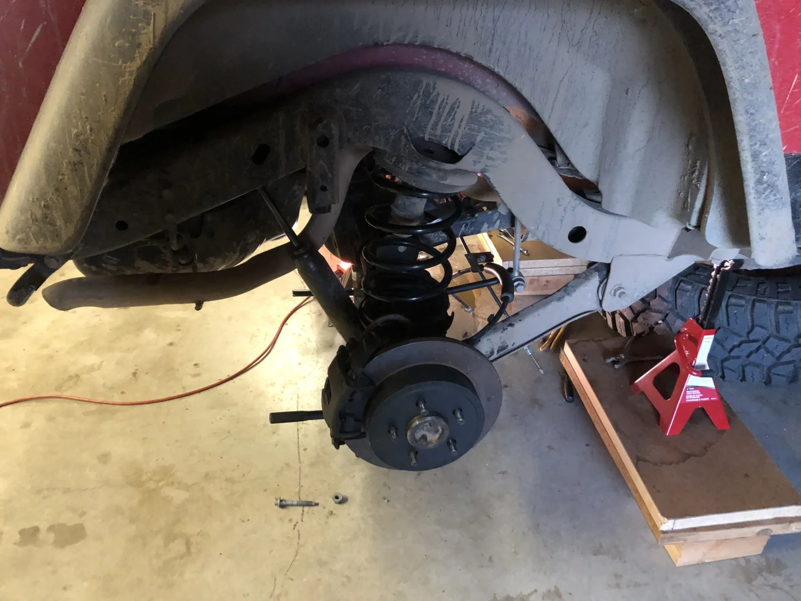

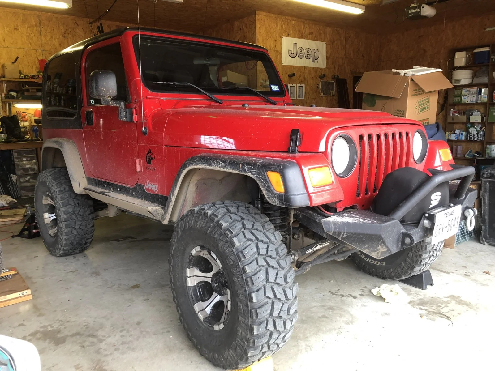

Decided to go for the axle swap today. It was a late decision. Thanks to some great crew members here like @bobthetj03, @Mike_H, @Jerry Bransford and the encouragement of my local wheelers @b0xcar , @KCsTJ and my wife, I got most of it done. She’s under the rig with a few things to wrap up tomorrow. I would have finished, but a drive with my wife seemed appealing and some evening responsibilities followed up. It is so good to have it there at last.
Here she is naked.

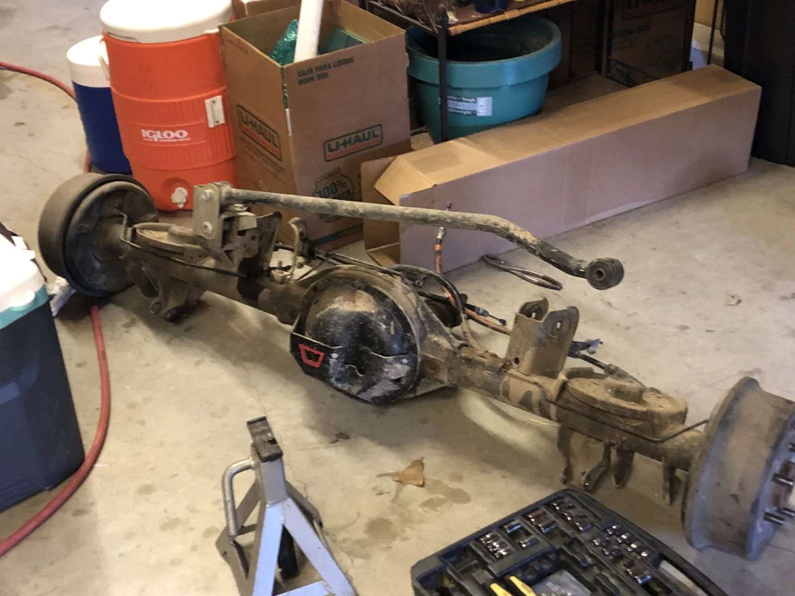

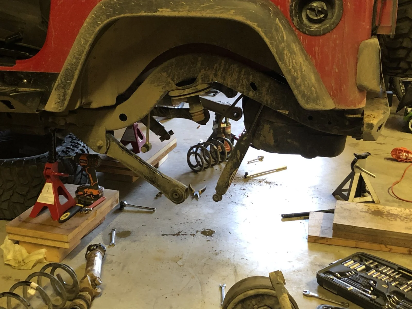

Dana 35 on the ground. A little muddy. I should have cleaned this up beforehand, but then I wouldn’t have gotten this done.

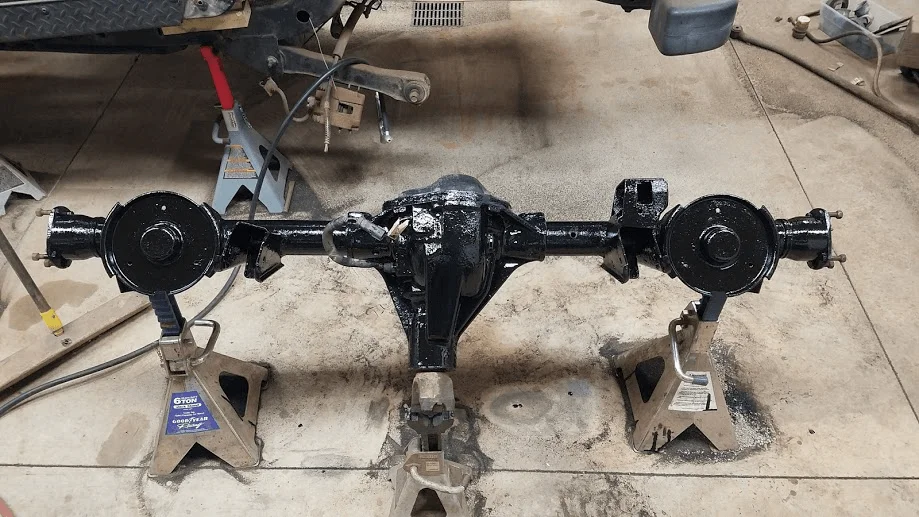

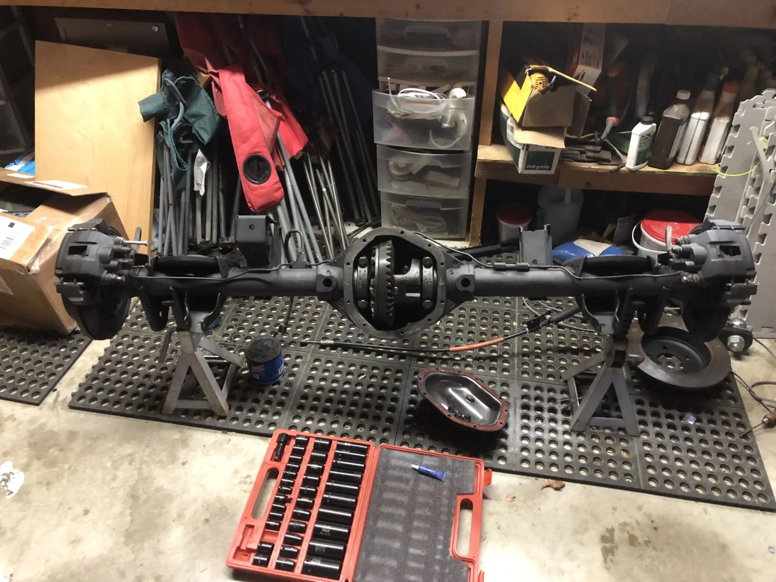

The Dana 44, waiting in the wings! Doesn’t she look purty?!

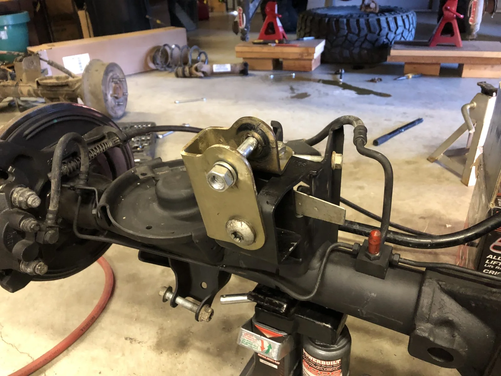

Had to do the stupid relocation bracket, again. It is easier to do in the ground!

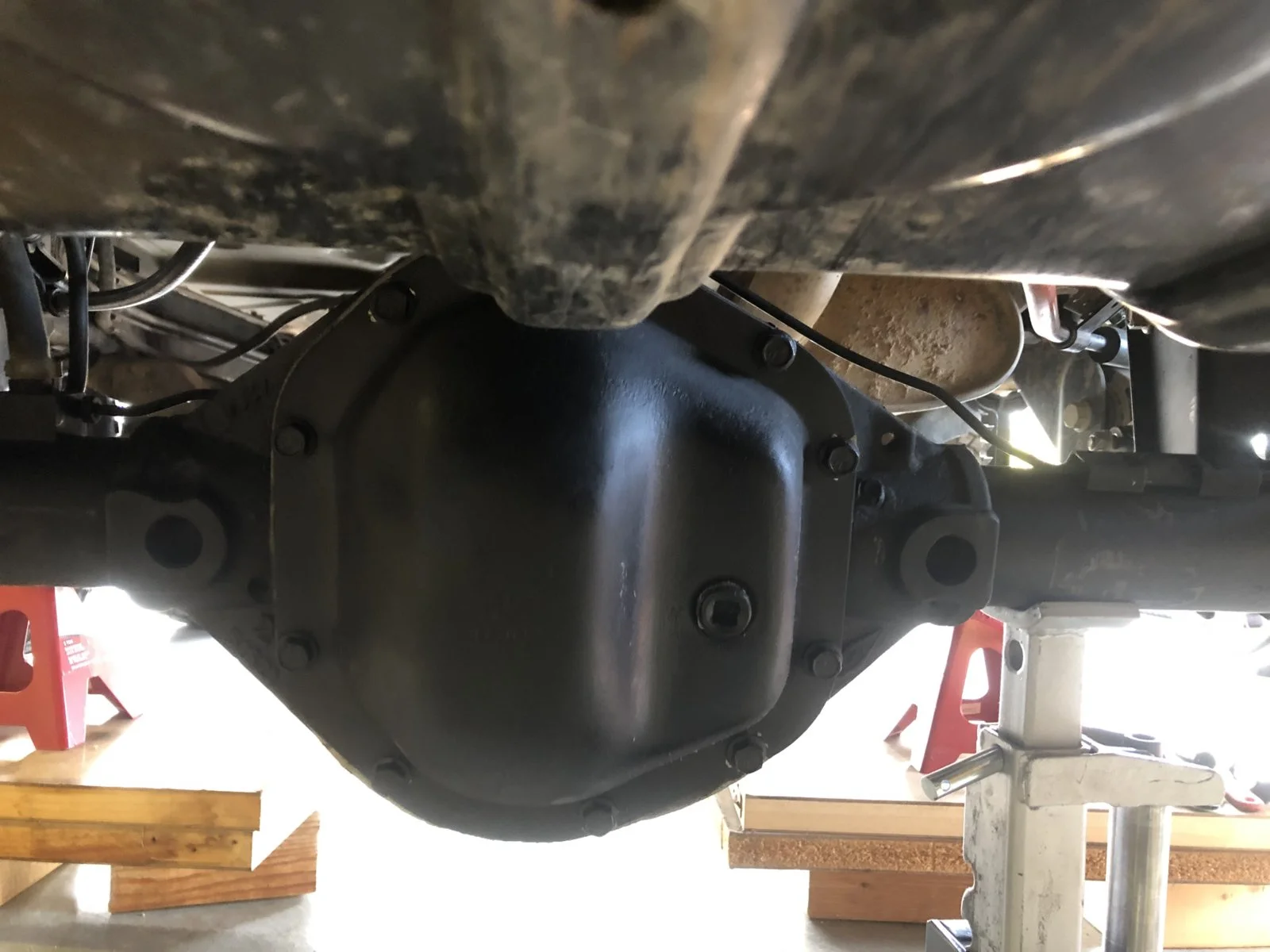

There she is. This is a whole new world!
Side shot, and some of the help toward the end. I’ll polish up tomorrow and report back.
Here she is naked.

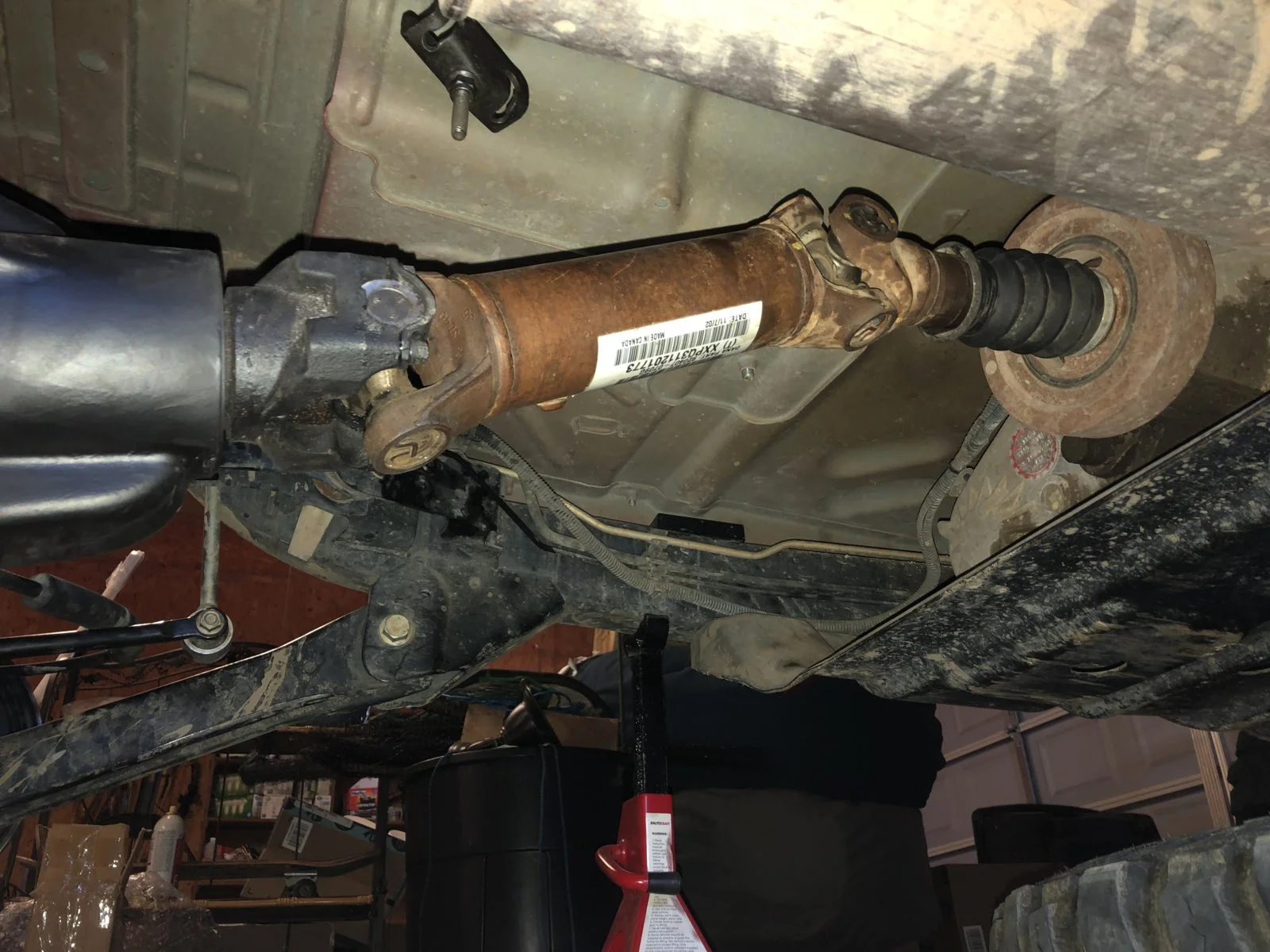

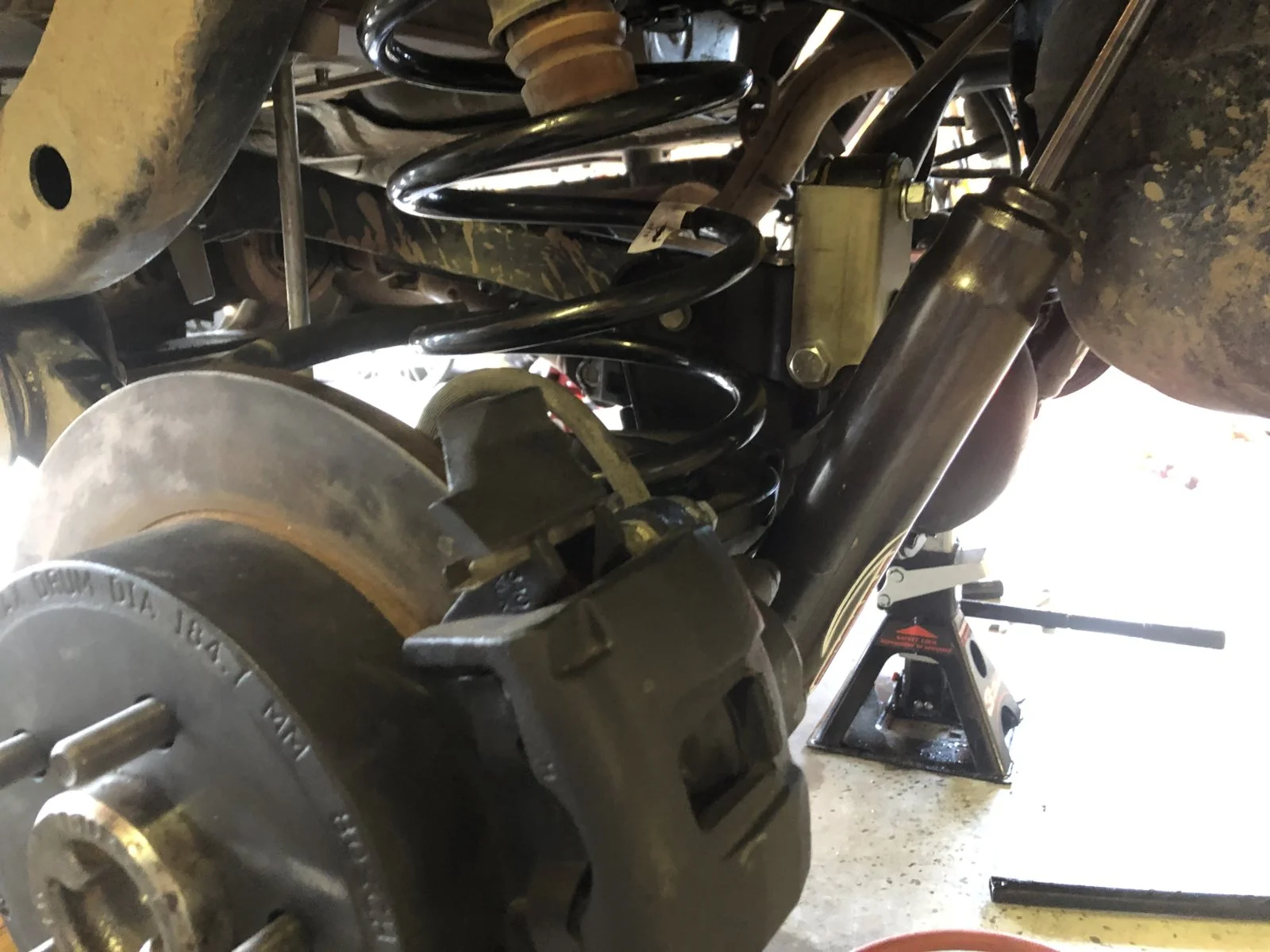

Got up early and filled the diff with 80W-90, tighten up the brake line and a few other things. Away from home most of the day. Got back home around 3pm and went to work. The DS looks good thanks to @bobthetj03!

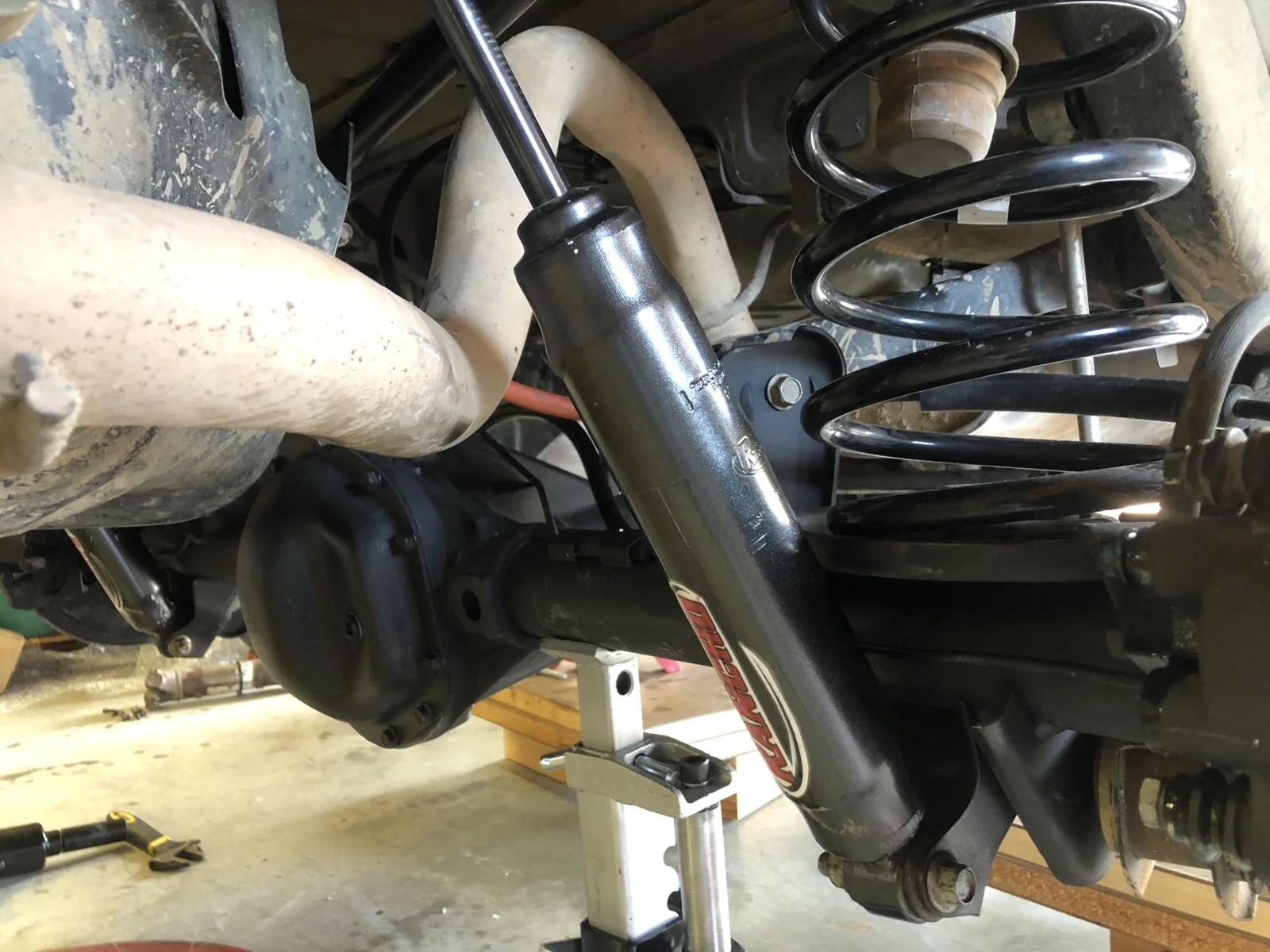

Finished adjusting the Parking Brake, gravity bled the brakes with Dot 3, connected the track bar at the frame and put the tires back on so I could put it on the ground and torque everything down to spec as @Mike_H informed me. Touched up the shocks with paint while I was there.
Have you ever sat on your rig in a Dana 44? There’s something awesome about it, especially coming from a Dana 35. It even makes the rig look better just knowing it’s under there. LOL

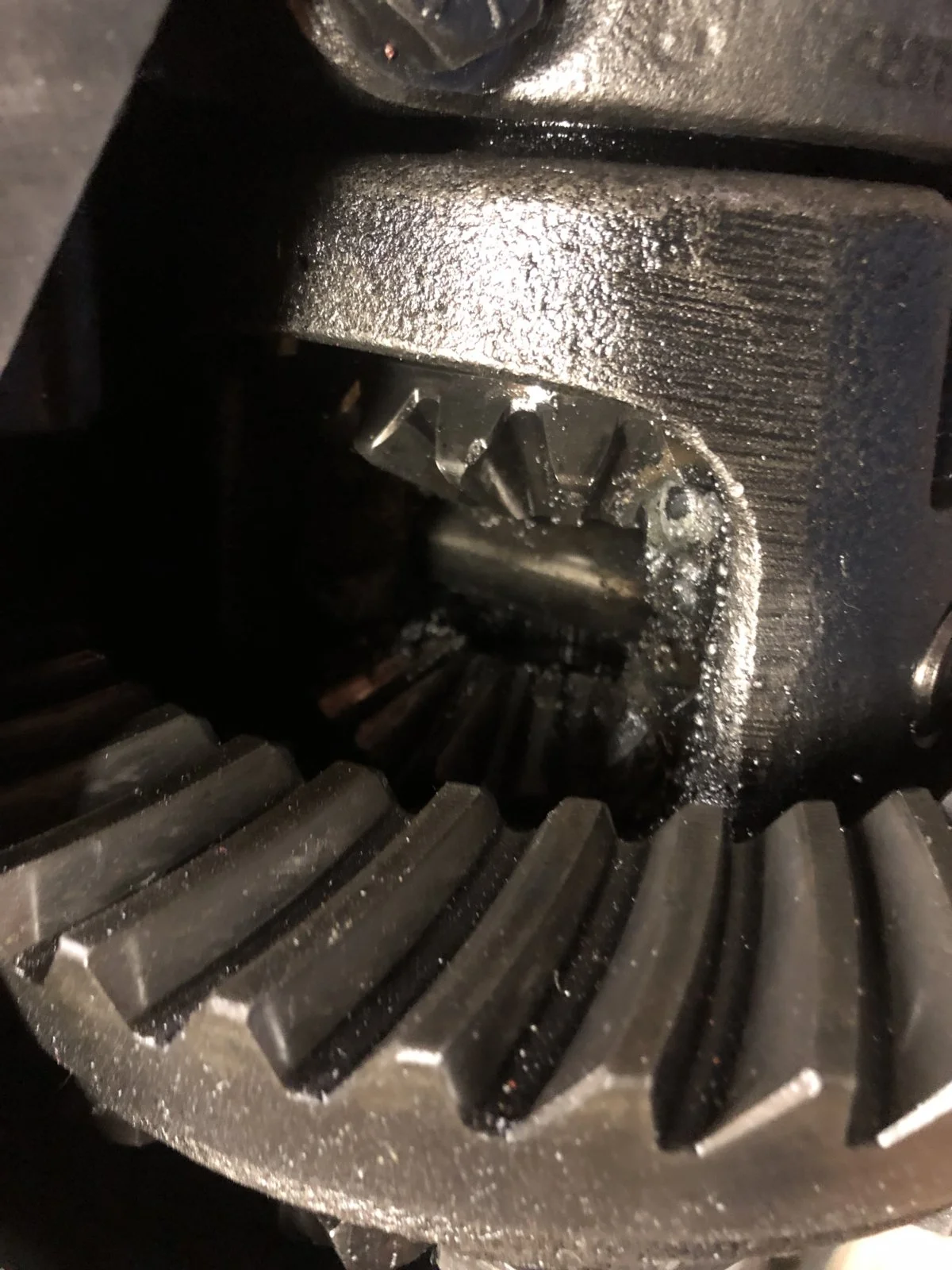

Took it for a spin . I was very nervous since the pinion gear has a badly chipped tooth and another smaller chipped tooth. Also because the spider gears are welded so it’s a spool. Everything worked well, parking brake, disc brakes, and the turning wasn’t bad except if you turn tight. I think I can run this way for a couple of weeks.
It’s time to go to work on the Dana 44. My hopes of the guy who sold it to me helping me regear are over. When I bought it it had welded spider gears so the guy gave me another LSD carrier and sent me on my way. I intended to switch the carriers and run it with 3.73 gears. When I got inside I found a chipped pinion tooth and another slightly damaged. So I bought Revolution gears with hopes of a DIY with this other guy. That’s over. Tonight I put it all back together and torqued everything to spec and am now waiting on a DS from @bobthetj03 who is graciously sending me a shorter OEM shaf. When it gets here I reckon I’ll take a few hours to remove the Dana 35 and install the Dana 44. I’ll be locked, so I’ll chirp for a few days till I can get it to Austin for the regear to 4.56. I’ve decided to go with an Eaton E-Locker, so I’ll be contacting @AOR soon for that. He’s always treated me stellar. If all goes well I’ll be automatically locked up front and selectable rear.
Here she is about midway through tonight putting her back together
