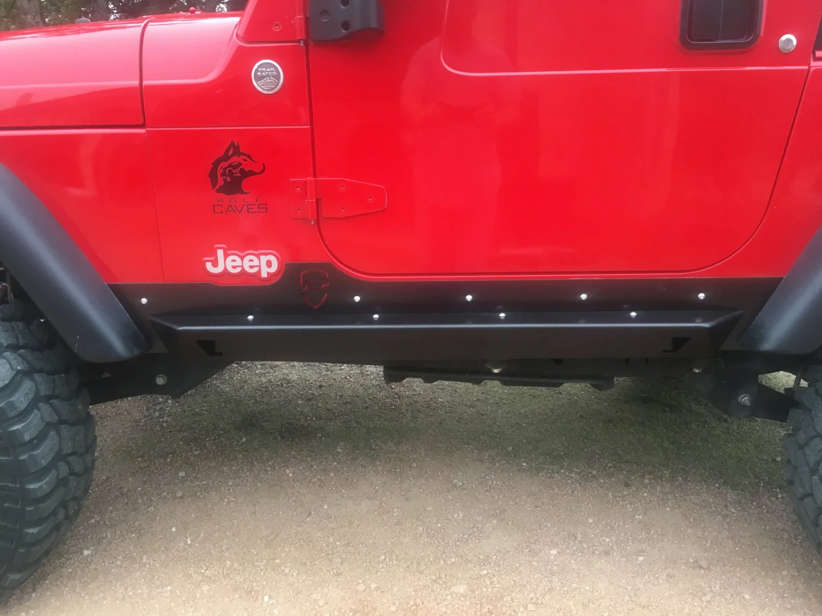

Late nights, early mornings, you do what you gotta do. The old nerf bars are finally gone. One last pic...bye

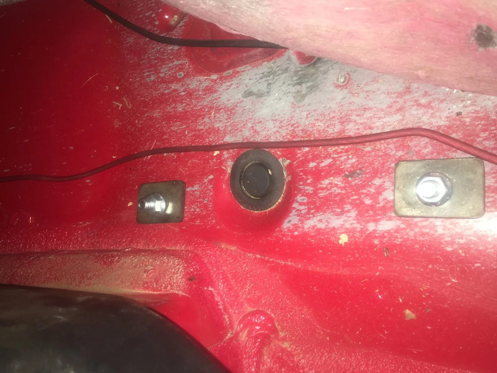

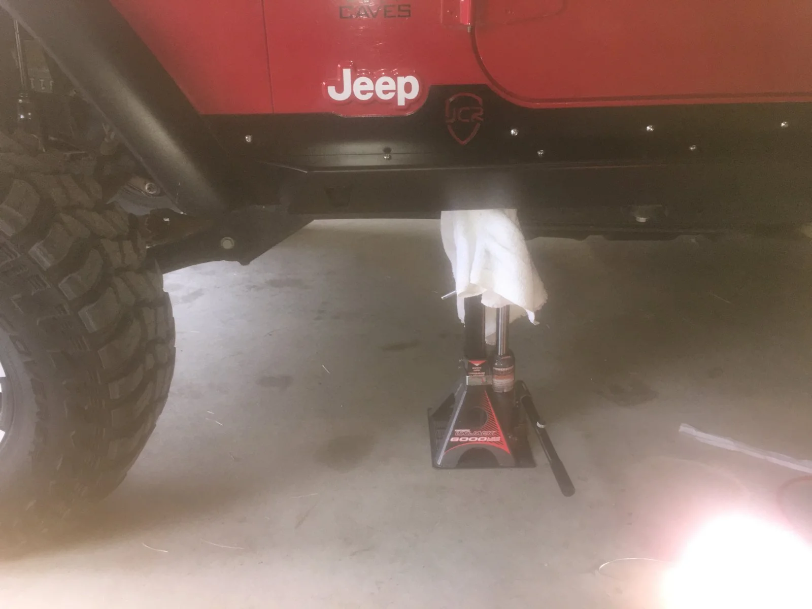

Obviously rock sliders were needed. This morning I mounted the sliders on the backplates. Used the jack to make sure they were fully seated on the tub before drilling the four 7/16” holes/side.
Plates are included in the floors for support.
Added the inner support which attaches to the front two seat bolts.
These are solid. I might prefer some black stainless bolts, but these might tie in well with the wheels. Not sure yet.

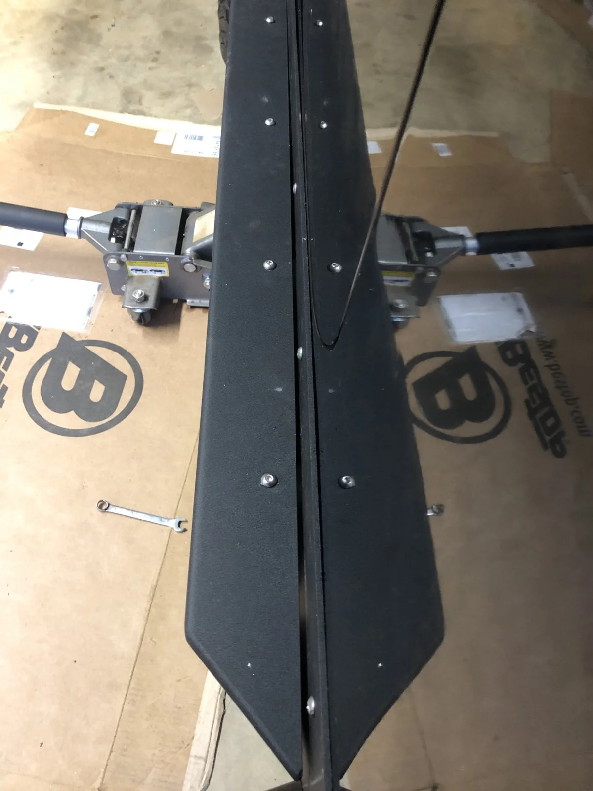

Well... I screwed this up.
Used the jack as directed but I guess I concentrated underneath the tub more than getting a tight fit on the slider/base portion. Pretty frustrated don’t really know how I’m gonna fix this .

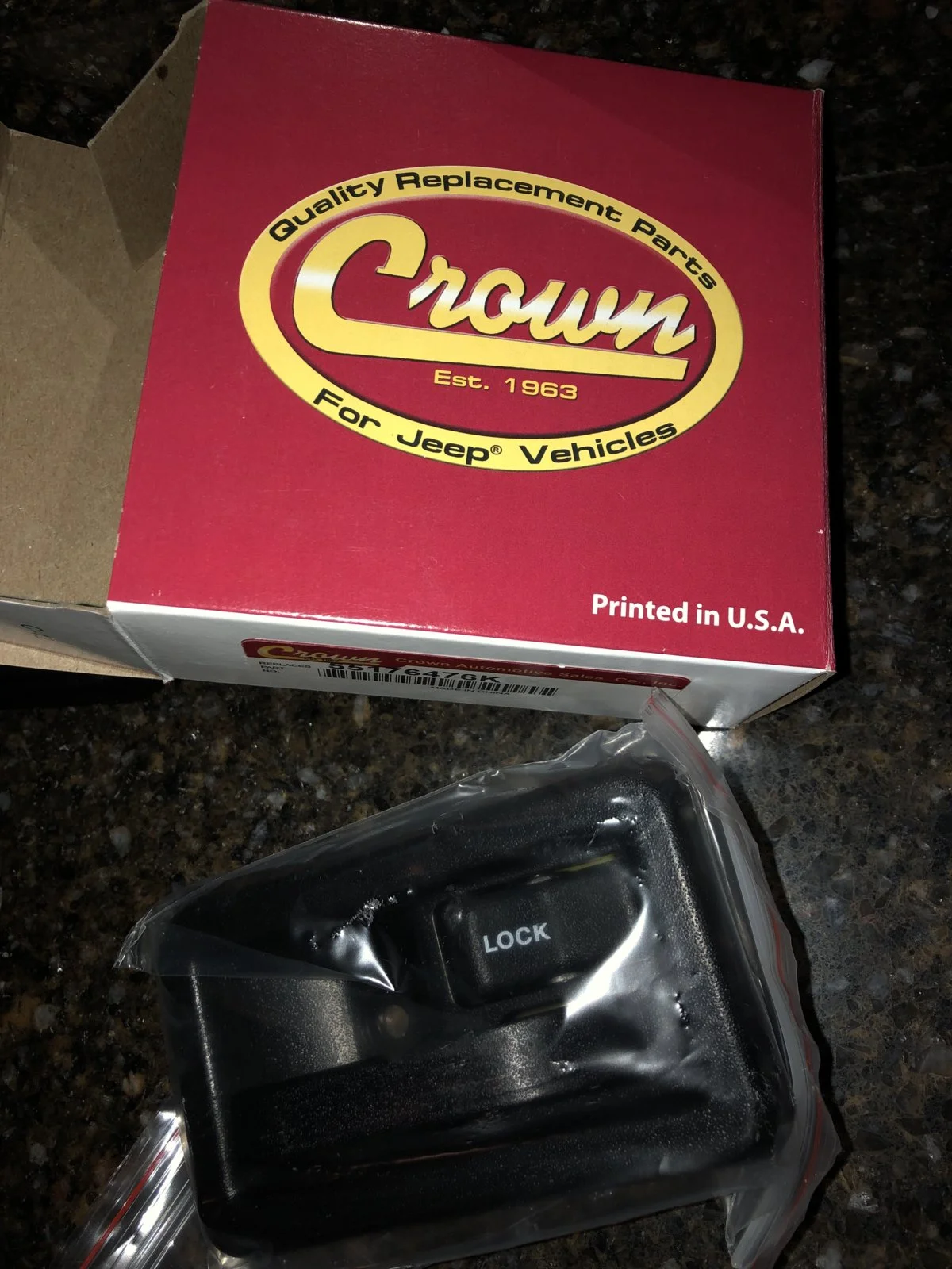

On another note, a few weeks ago my interior driver door latch quit working. I didn’t tear into it right away. I just assumed that the plastic clip that holds the latch to the guide wire had broken. So I ordered some Crown replacements.
One of the stupid things about these new Crown latches is the word lock is on the wrong side. The Stock one’s have it right.

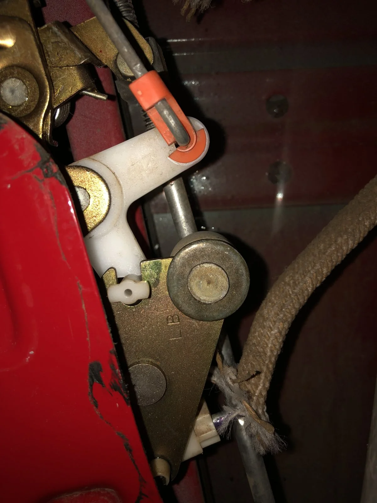

It was a bit of a pain getting into the door but not too bad. With a little help from my son I got the new latch installed. No pics yet. PUt it back together and that worked. Unfortunately, the unlock mechanism didn’t work. It’s been like that ever since I’ve owned the Jeep, so I went back in and fooled around with this mechanism.
The photo below shows the extent of the movement when I tried to unlock it with the latch.

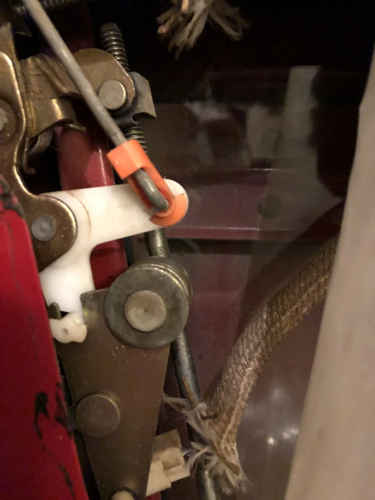

The photo below shows how far it’s supposed to open. I put some PB Blaster on the parts and worked it a bit and now it works pretty well with the latch. Very pleased.
