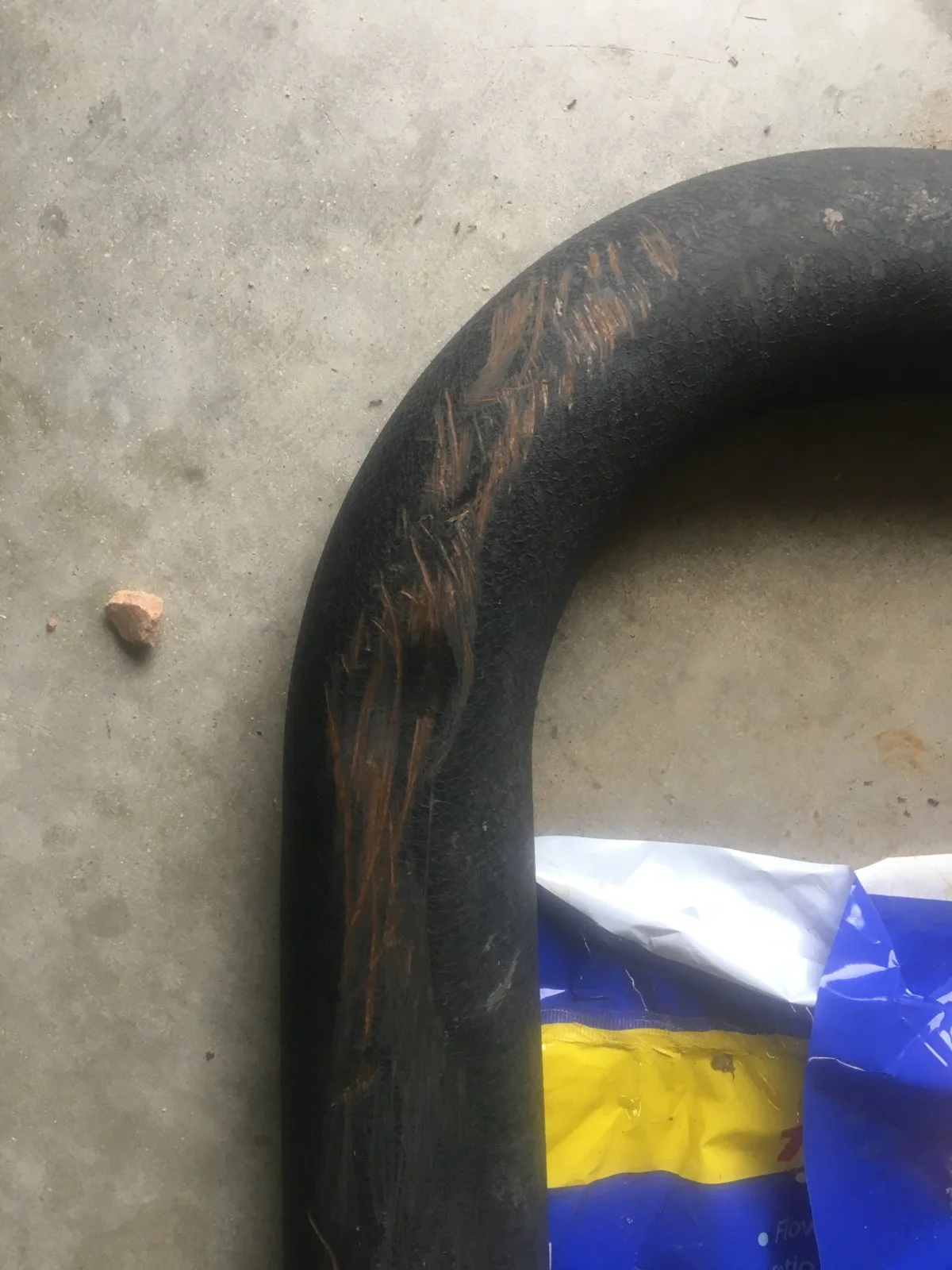

You know, I was hitting the nerf bars. I've got some pics I can share of the damage. In fact, you can have my damaged one's if you come up and run some trails in the Hill Country or when I come to Houston in March of 2019. The nice thing was they were only about $100 and the damage was mostly to the bottom, but not just scrapes, also dents due to hitting rocks (they could be leaned up a bit). Over time they would have been an aesthetically obvious blemish.

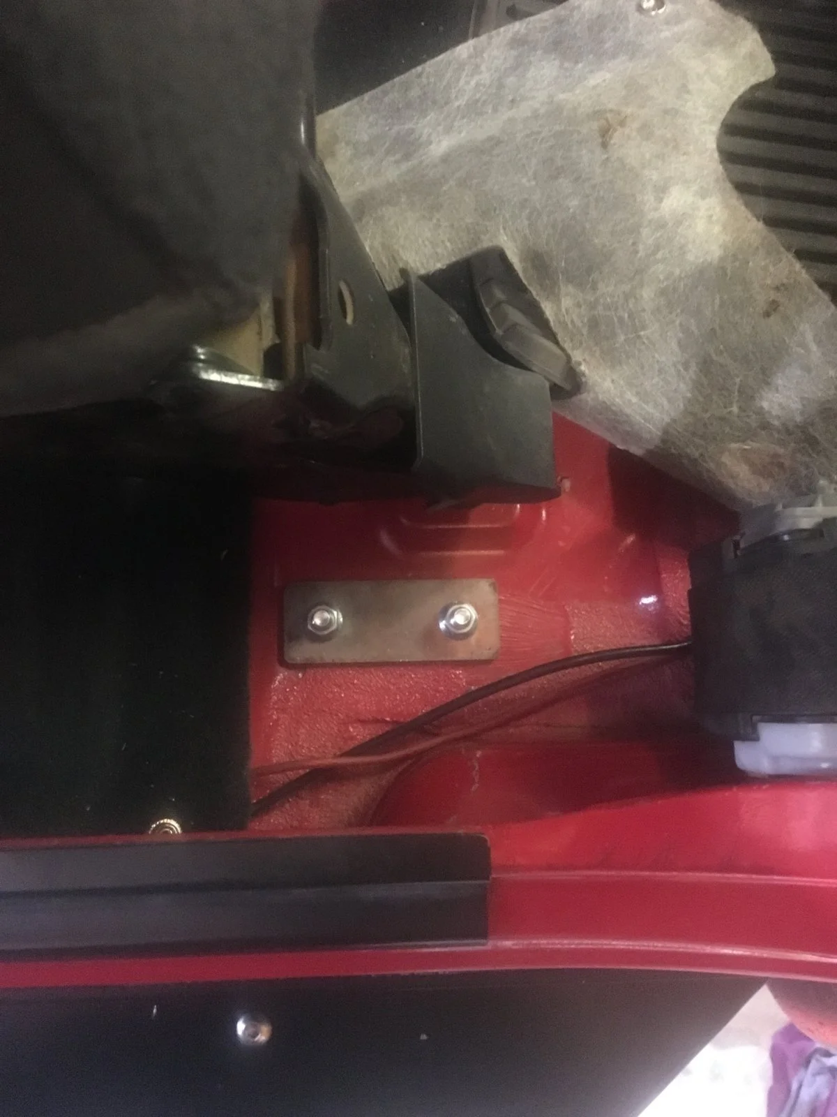

Late nights, early mornings, you do what you gotta do. The old nerf bars are finally gone. One last pic...bye

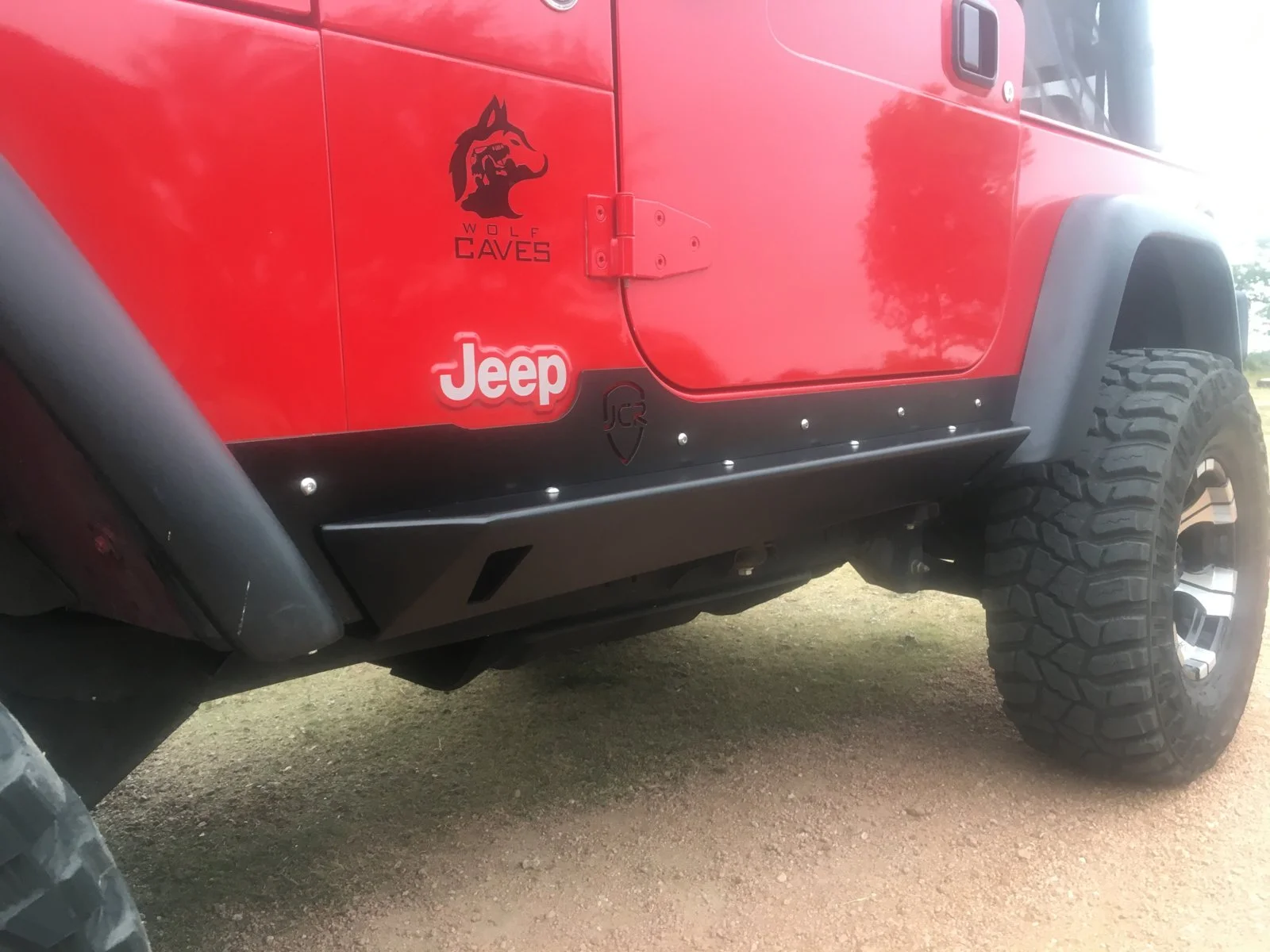

Obviously rock sliders were needed. This morning I mounted the sliders on the backplates. Used the jack to make sure they were fully seated on the tub before drilling the four 7/16” holes/side.
Plates are included in the floors for support.
Added the inner support which attaches to the front two seat bolts.
These are solid. I might prefer some black stainless bolts, but these might tie in well with the wheels. Not sure yet.

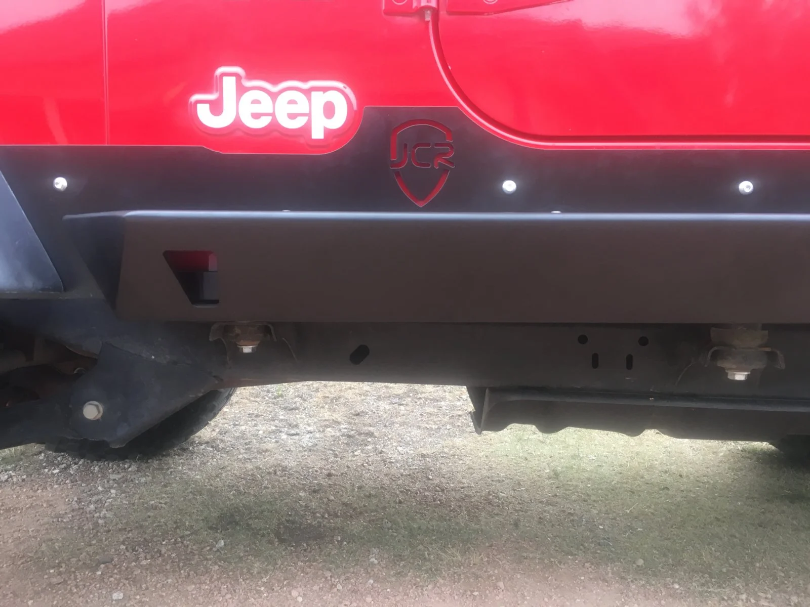

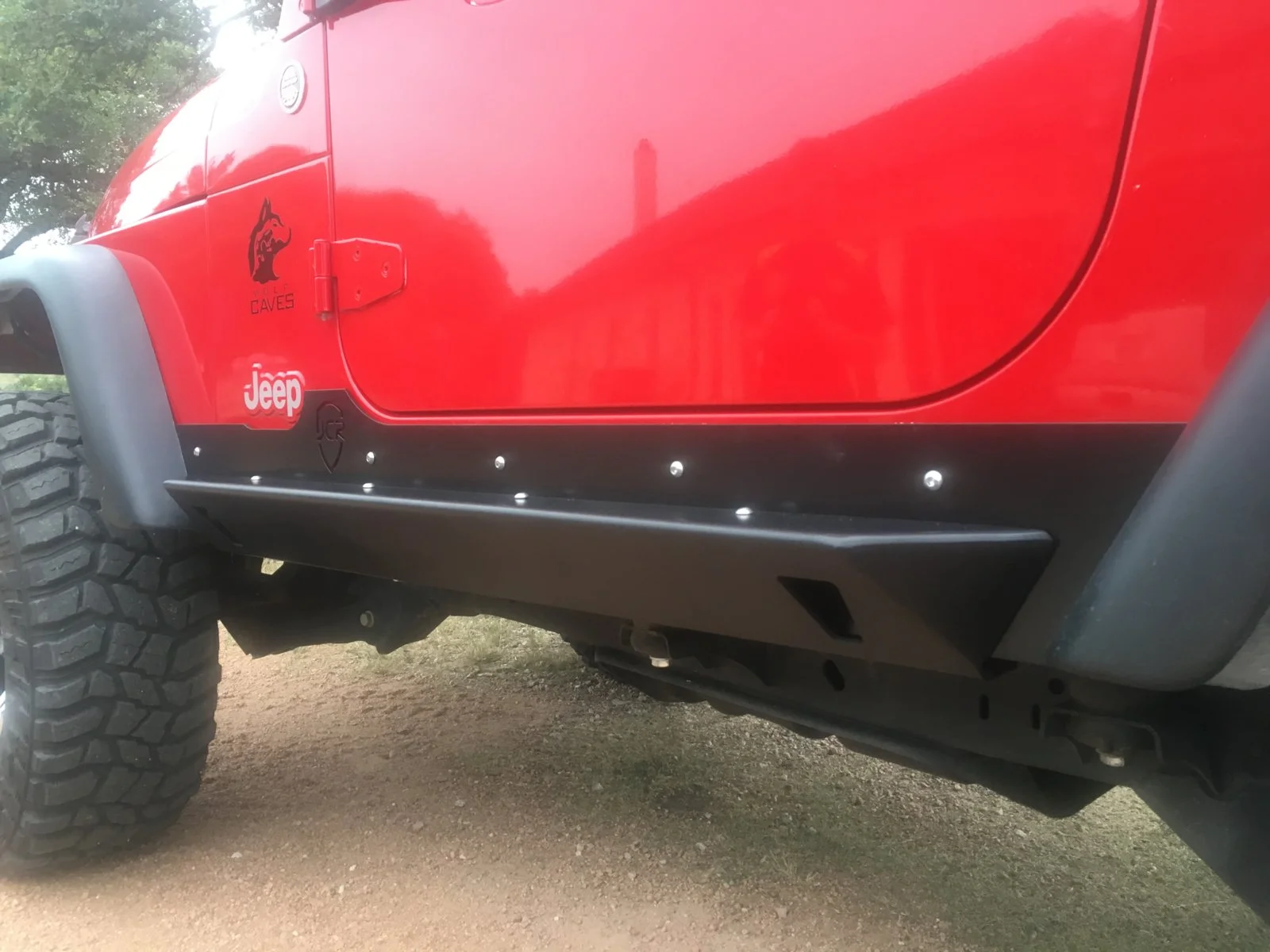

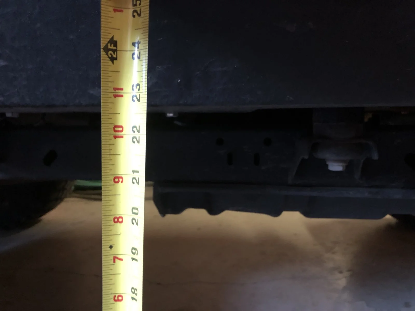

I've been needing to report back. I installed the JCR Crusader Sliders back in June. I've wheeled about 5-6x's since then. Because of the much higher clearance, I have yet to hit them on a rock.
Pros
- The clearance is great. On my rig 23". You can run over a nearly 2' rock with no worries. See pic below.
- The slider is solid, so it deflects debris like mud and rocks that would otherwise fling up on your rig. The DOM tube type sliders don't do this nearly as well.
- The backing plate is ww2ww along the edge
- The interior supports that run under the seat give needed stability
Cons

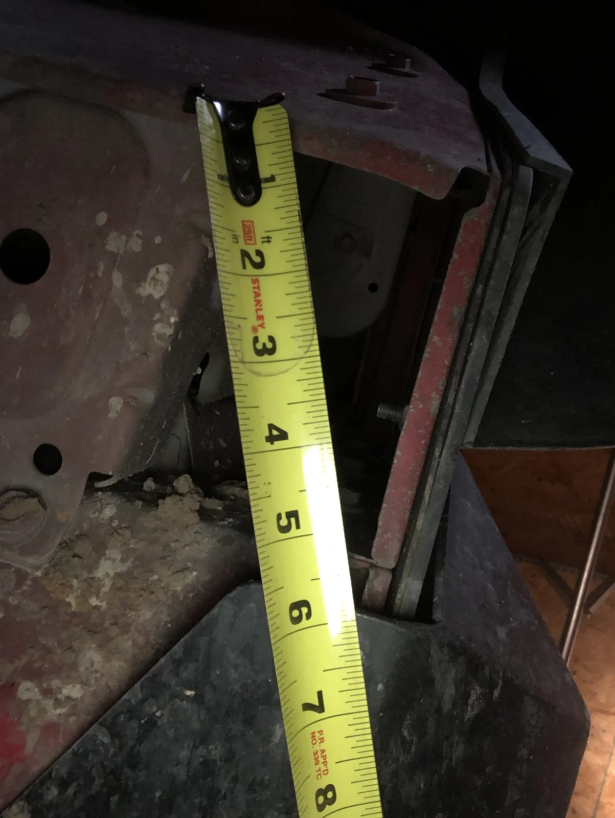

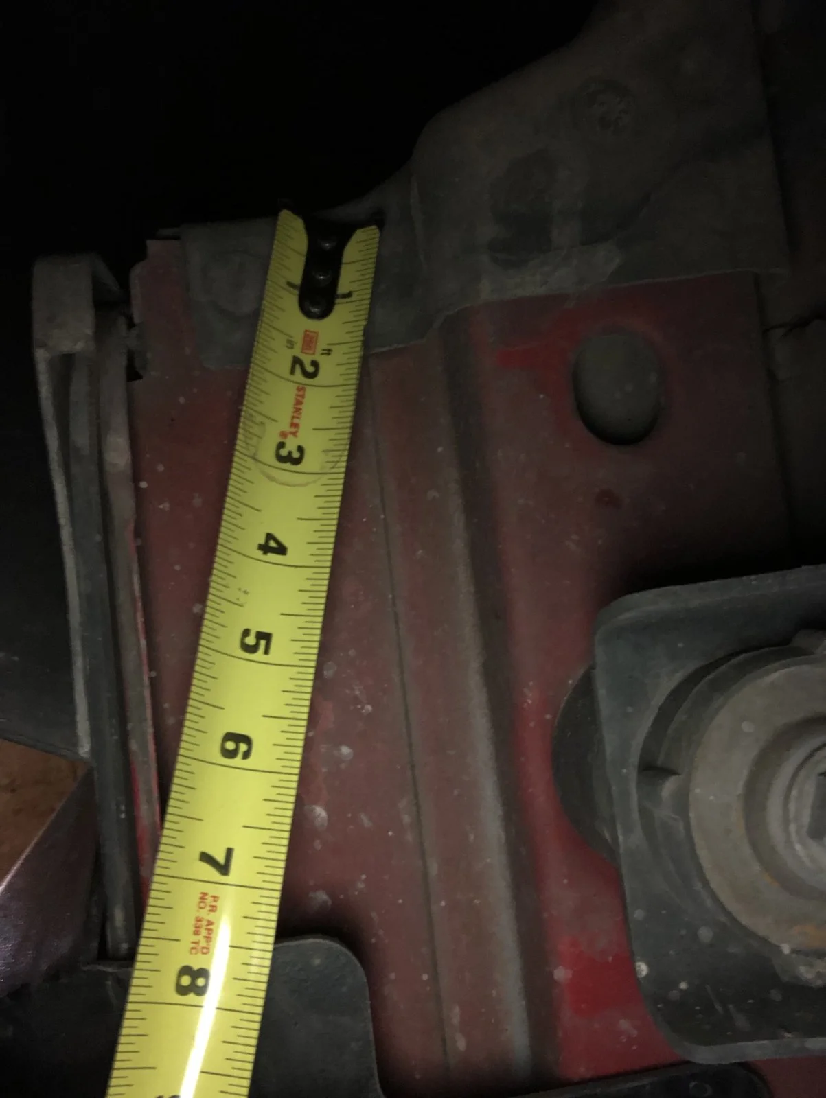

- The slider is not ww2ww underneath the tub. I've posted some pics showing the distance with OEM fenders that is left unprotected. For my purposes this has not been an issue, yet. My thinking is that if you wheel on a lot of larger moving rock you could be vulnerable. Otherwise, I think you're fine. Also, if you're planning on going to a fender that gives more clearance to the rear of the wheel well, then you will cut down on that gap. At least the backing plate is ww2ww there to give you some protection.
- The step is so high its virtually unusable. I just step in now. I'm 5'6" so it's a bit cumbersome. My wife is 5'5" and she quips that she has to 'run and jump' into the Jeep. To ameliorate this issue I'm going to make some stirrups for ingress and egress and hope they work well.
- bolts from underneath that go into the tub are too long. Make sure and cut them off ASAP (an easy fix)
Overall I am very pleased with the JCR sliders. Maybe consider TNT with some backing plates for support on the interior of the tub or go all out with Savvy or Genright.
Clearance
Front unprotected area (~5")
Rear unprotected area (~7")

I really like mine. I've been wheeling a couple of times with them, and haven't managed to hit them on anything yet, either. I will echo JMT's comments about the bolts being too long...though I'm hesitant to cut them down. I don't know how much "compression" is happening in that bolted joint. If I cut them and later remove the slider, will I have enough thread to start them again? I suppose I could just replace the bolts...
They are also far to high to be considered a entry step. That ledge makes a GREAT footrest for doorless driving though. Its also great for standing on and cleaning the top of the jeep! With the reinforcement to the tub that they have, they will make a great pivot point as well, if you get into the shit that far.
I'm not really worried about the unprotected area under the tub. In front, its mostly fender...in the rear, well, I've got rust, so that would just force me to fix it!
