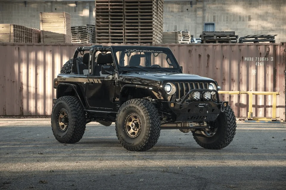

You guys talking about your wives made me think of this...JCR posted some pics of their "Golden Bandit." Its a two door JL that is Bad Ass...
I told my wife that was the stance I wanted eventually for mine. She said...It already looks like that...SMH...I'm getting there...but golly.

You don’t think your rig looks like the bandit? SMH
Look at the front axle on that thing! Talk about high pinion!

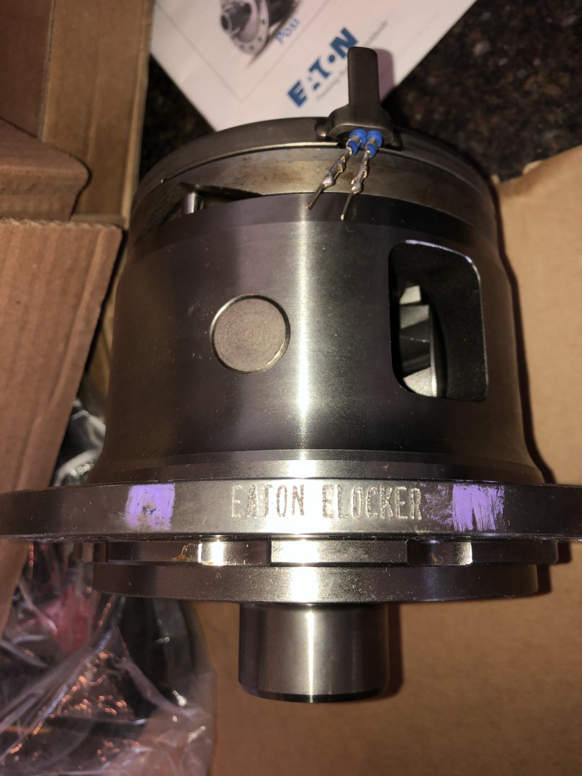

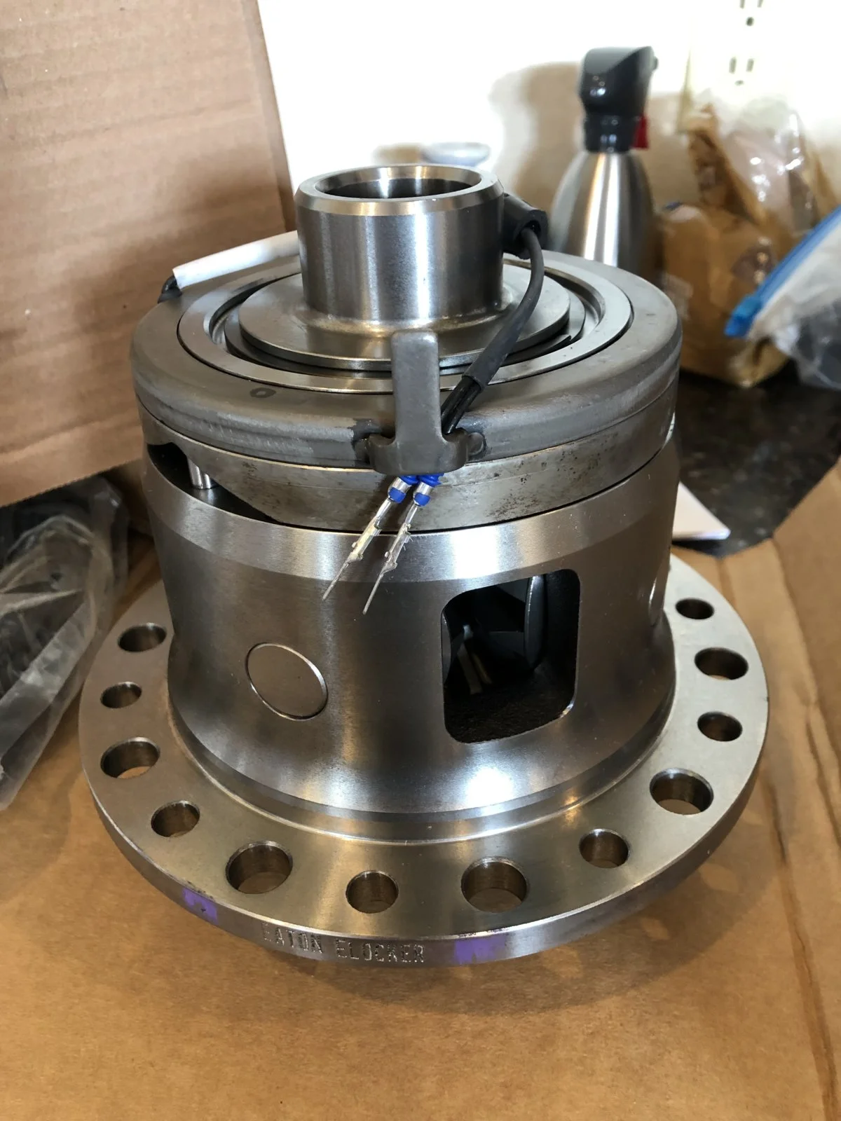

You'll love it! Where are you going to mount the switch?
I’ve got two more slots in the HVAC. I really haven’t thought about it. I’m open to suggestions. My winch on/off and control switch are at the HVAC.
