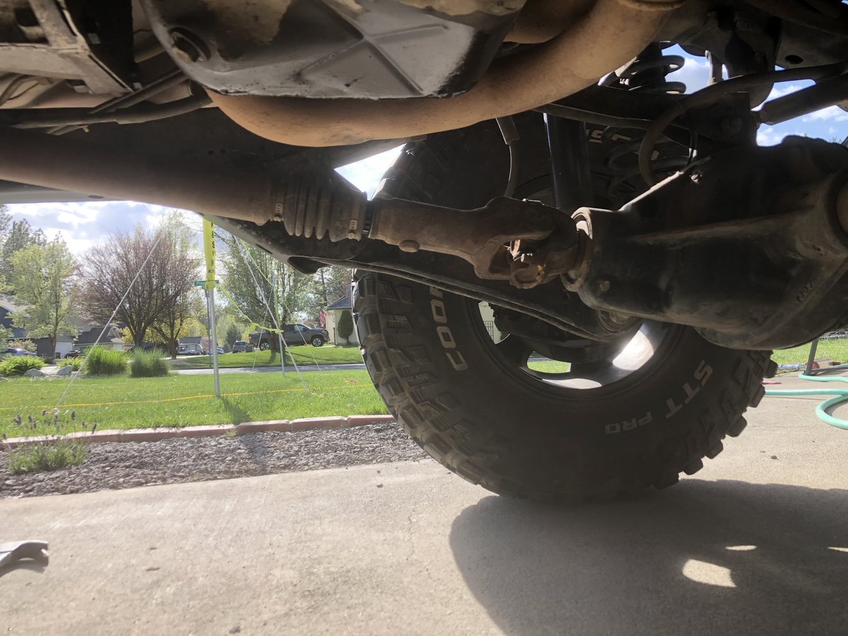

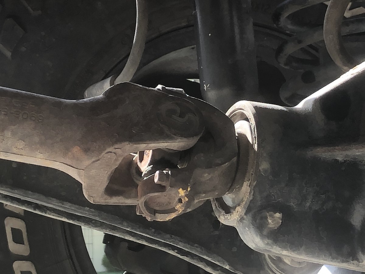

Maybe it's the angle of your pic, does it looks like one of the joints is cockeyed? Sometimes you have to jamb a large screwdriver in the between joint and the inside of the mount bracket when you tighten the jamb nut, otherwise you put a preload on the bushing and it sits cockeyed.
Thanks for the heads up. I just checked and they were all centered. 😊

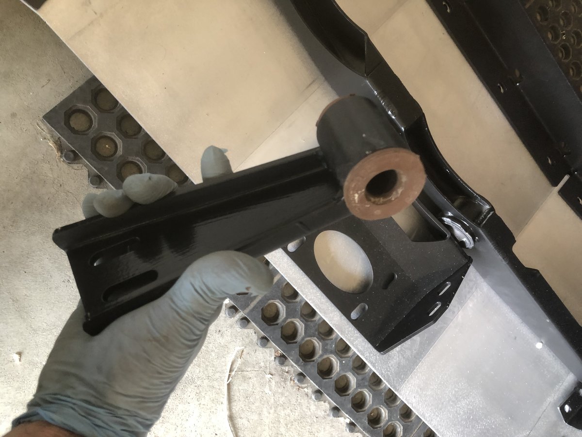

Here’s where I am with the Savvy MUA. If I can get the outer C’s on. This is not tight, this is insane. Someone should do something about this.
TCase is hitting the crossmember

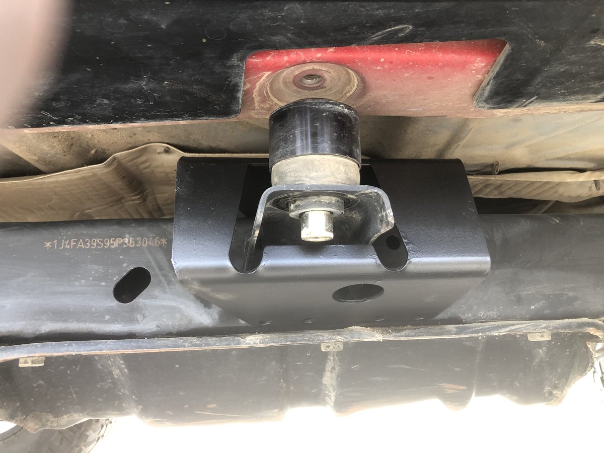

Removing the body mounts to slip the outer C on.

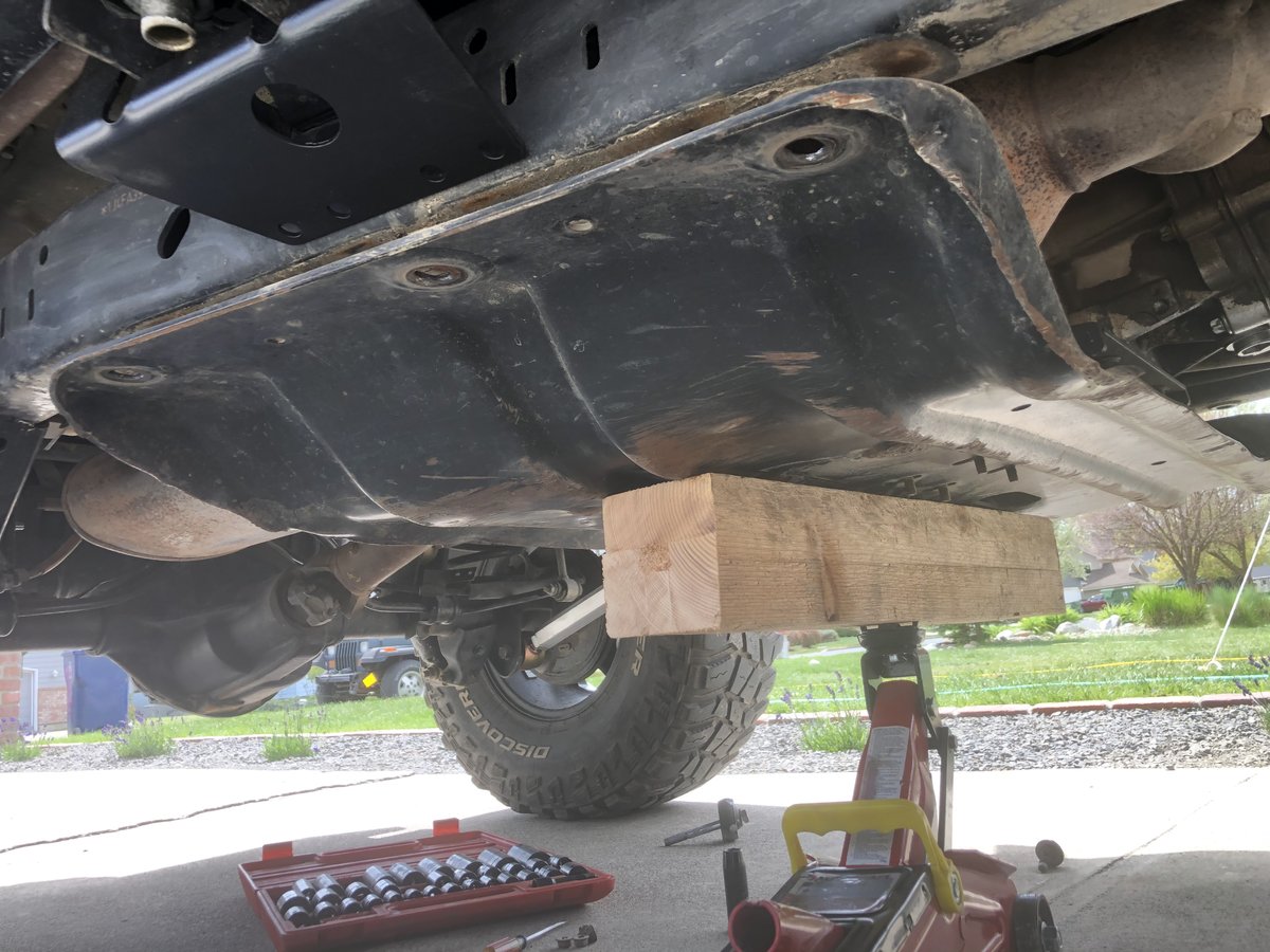

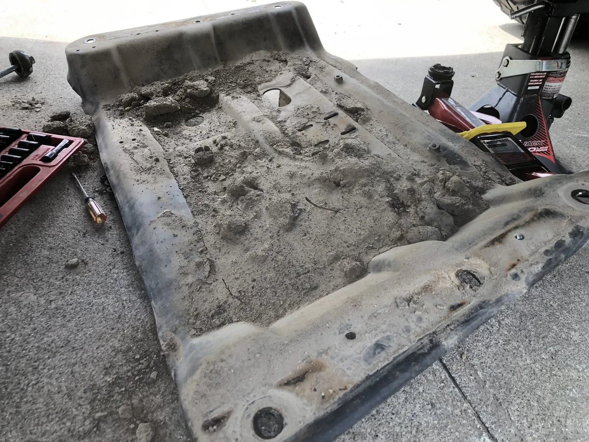

removing the OEM Skid for the last time
whoever first called it a”shovel” wasn’t kidding.

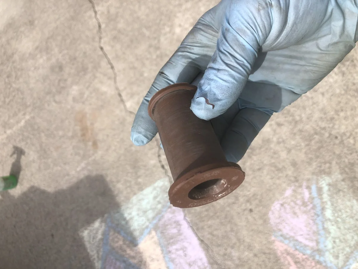

exhaust hanger bushing came out easy.
goes in easy too. I wish the outer C’s were this easy. Geez, another 1/8” wide and they’d be fine.

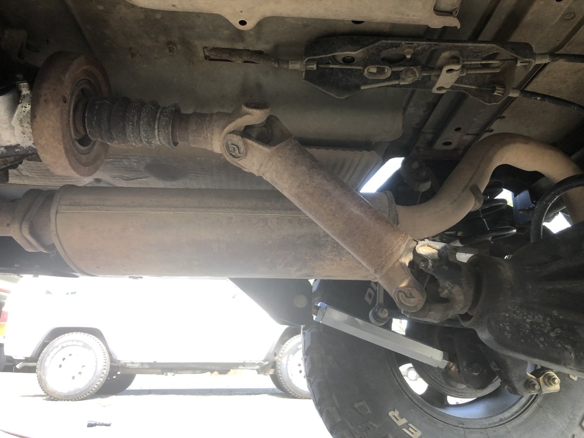

Rear DS. 🤣

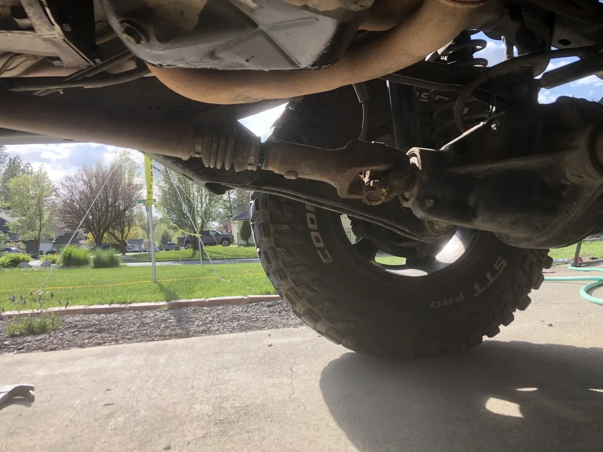

Front DS
close up of Front DS

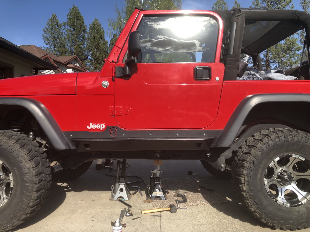

where things are headed.
removing the OEM Skid for the last timeView attachment 157571
exhaust hanger bushing came out easy.View attachment 157572
goes in easy too. I wish the outer C’s were this easy. Geez, another 1/8” wide and they’d be fine.View attachment 157573
Rear DS. 🤣
Front DSView attachment 157575
That rear DS picture is gold.
