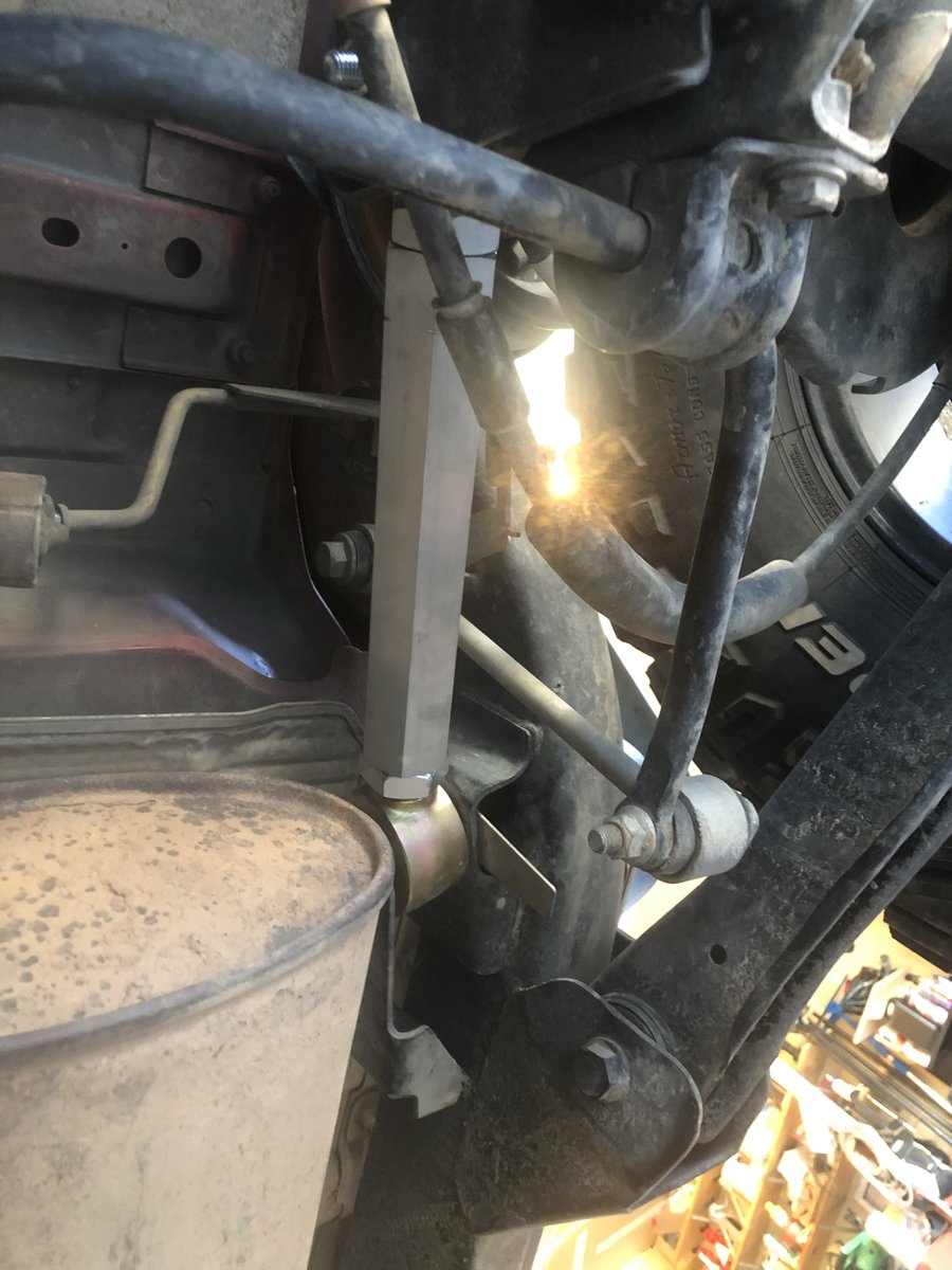

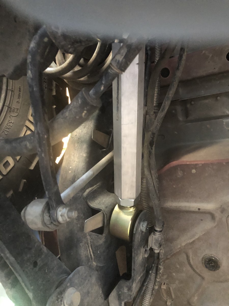

Got the upper arms on. Anyone know what size the nut is on MC’s adjustable arms? My largest crescent won’t quite get on it and I could only get my pipe wrench on one end. Also, what to do with the parking brake line that was attached to the upper on each side? Just let it hang free?
Also, I used the flag nut rather than MC's replacement, seems so much easier for that space. If I'm totally off base here, let me know.

Flag nut should be fine, use the oem torque spec with it. I can’t see an issue with the brake cable but you could zip tie it up if it interferes in cycling.
Flag nut should be fine, use the oem torque spec with it. I can’t see an issue with the brake cable but you could tie it up if it interferes in cycling.
I just went with the spec'd 55 ft lbs for the uppers. I could zip tie it to the arm, but I think I'll wait till I get it dialed in, then take a look and zip tie it if it needs it. I doubt it needs to be tied up. It doesn't hang down where it could get snagged on anything.

My brake lines are free as birds :p and they have been fine. I think the nut for the aluminum double adjustable is 1.875
I only have the steel, single adjustables. But the torque for the jam nuts is exactly stand-on-the-end-of-cheater-bar.. foot pounds
I'll check tomorrow. I have the same exact arms and a crowsfoot to match it. Trust me, I've adjusted the pinion more than is sane.
If only you were still sane without those vibes. That's my dream at least Jim.
It's got to be 1 1/2". My crescent is so close, and it's about 1 3/8". Good enough....Thanks...
