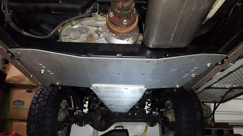

Seems like the exhaust on a LJ is a little more forgiving. Don’t get me wrong I still needed to get exhaust work done but at the same time I was able to button everything tight and drive to the shop.
I did have to take a little out of the cross member that was hitting the transfer case.

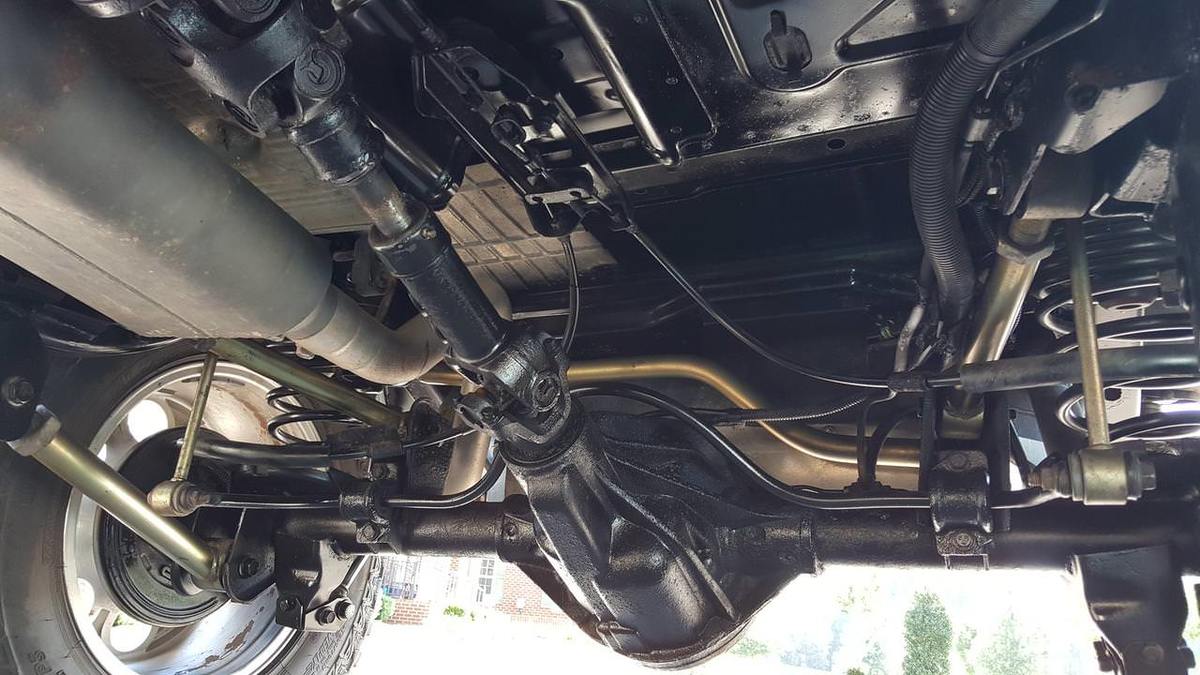

thanks for posting that picture of the drive line WOW that is insane.
it’s a lot of work but it’s worth it. When you walk out of a gas station and don’t see the old skid hanging down you’re going for think to your self man that looks good, also when you don’t scrape or bang it that’s even better!

I can already see where it will be and it is amazing. So far I am glad I went the full tuck route. I kept saying to myself, why spend all that money for a mini tuck. If I’m doing this I’m going all the way or no way. It’s amazing how much longer and slimmer the rig looks. Takes some getting used to!

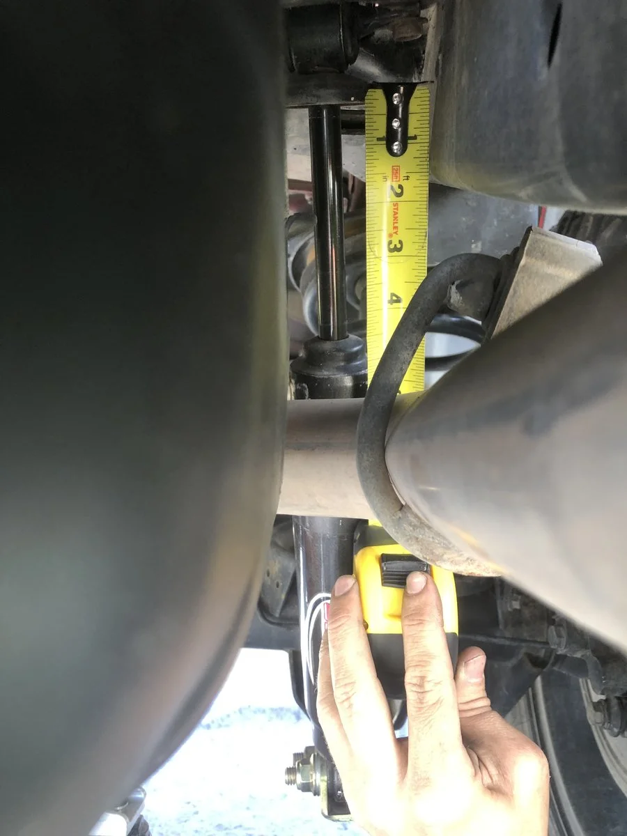

lots happened. Cleared the exhaust at the crossmember, but it’s clobbering my shock body.

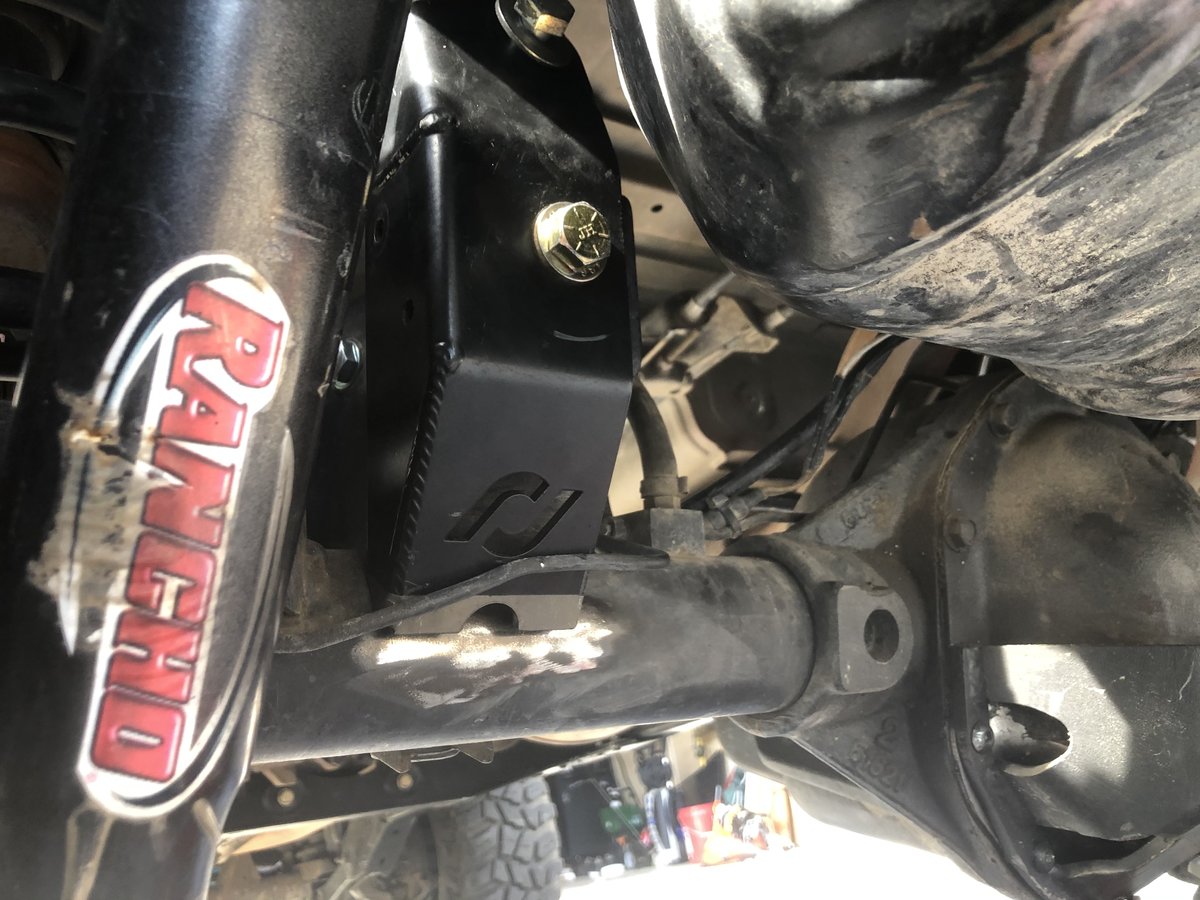

Rotated the pinion to point at the harmonic balancer. At least I’ll be in the ballpark when the JB SS is installed. It was super easy to adjust the double adjustables, and I will do more when I get the JKS trackbar installed and check clearances. Went ahead and installed the Currie angled trackbar bracket. It’s ready for welding when the time comes. Always a bit of a pain to deal with relocation brackets, but I’ve got the hang of it. Looks like my driveshaft will be about 19” long! My rear shocks have about 4.75” up travel, which is an improvement.
