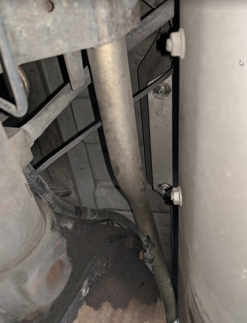

I have stock length lower arms on right now with no lift and savvy uppers, Savvy TT and Savvy gas tank. Rotating the pinion twisted the rear stock track bar bushing, so I got a MC stock replacement as a temporary solution. Went out just now to see how much clearance I had and glad I did as I am missing a bolt and the other is loose on the tank.

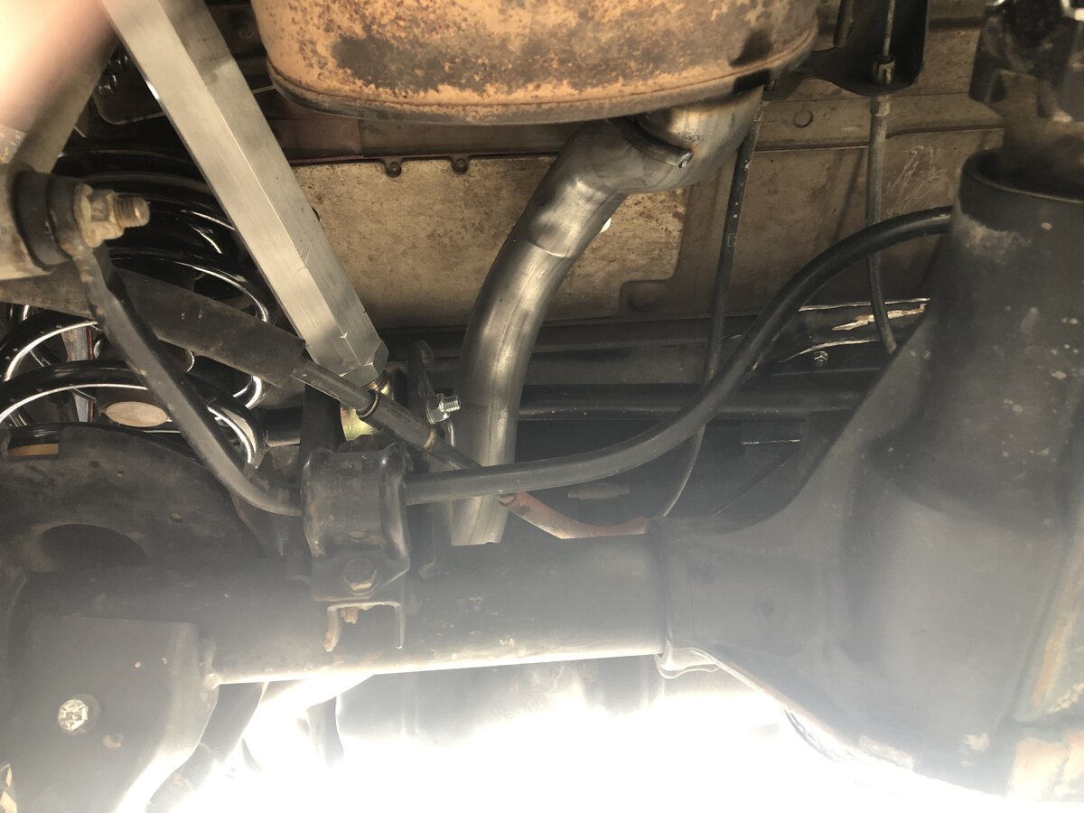

Started to set pinon angle and didnt even get close. A number of different factors on mine. Currie rear trac bar and relocation bracket on the way. We'll see.
Kinda thought this would happen.

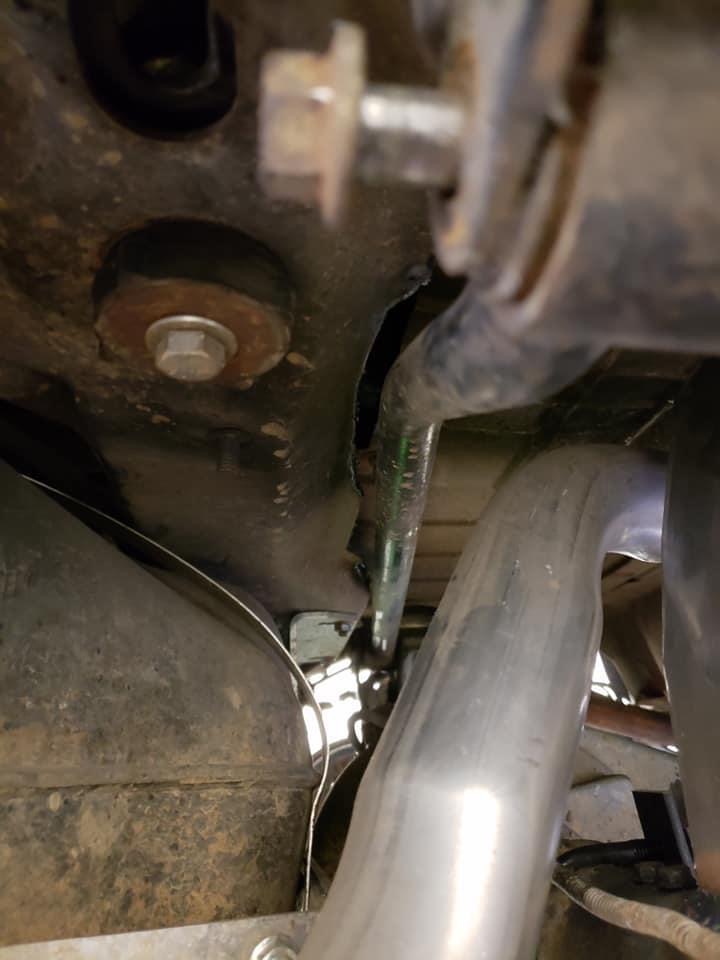

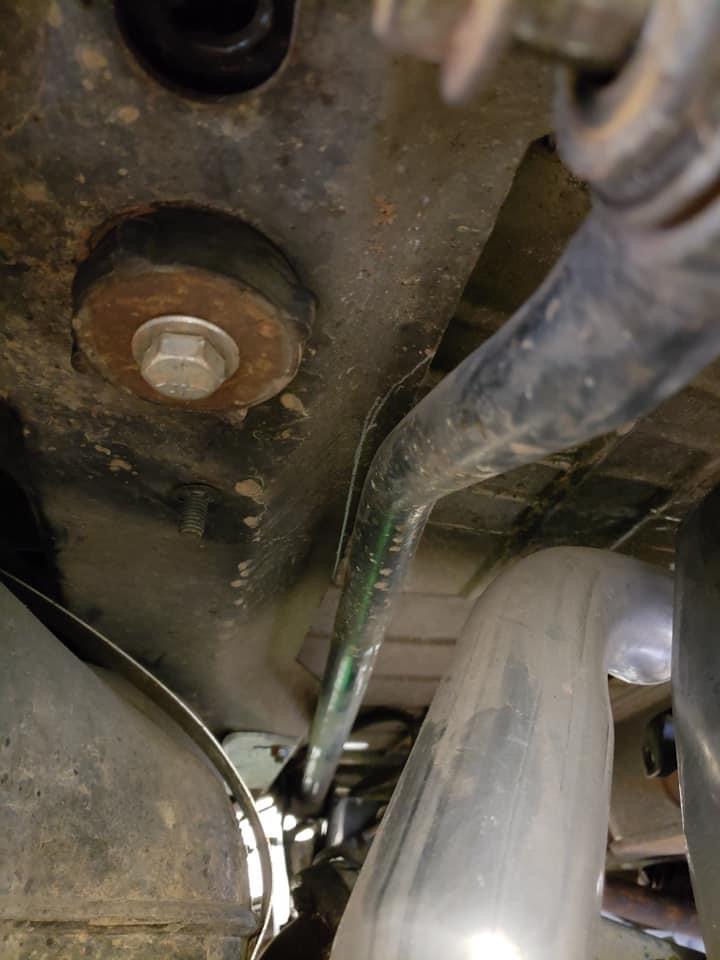

@BuildBreakRepeat, this part I have circled below, is the steel split open at that part so there is a gap in between? I'm trying to get a feel for how much I can trim there.
Yes that lip is welded together and open inside. Wouldn’t be difficult to cut it back and weld a plate to connect them back together. Also the tank bolts can be moved back an inch or two when you trim. @Wildman or I can weld it for you if you visit either. Essentially it’s just boxed steel that can be notched and welded. I would just bend the bar for clearance, but if you don’t have a press then it wouldn’t make sense.
Yeah, I'm pretty much up a creek without a paddle at this point since I don't have any of these tools. I'm okay with that for now. I'm pretty tired of messing with all this and I have several other projects ongoing. I will get it corrected in the future. Next I will start with a bushing from JKS that will work on the other end @Wildman sent me. Then I will push the tank bolts back as much as possible. Then I will see where I am. If I still need more to get 93" wheelbase, I will see about trimming that crossmember. Apart from the JKS bushing, those are pretty much free adjustments I can make. Thanks for the help. It gives me something to mull over for awhile.
