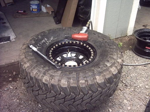

I've been running some type of beadlock wheel for a long while. Getting them mounted is easy since you are the one that mounts the tire onto the rim. The hard part is torqueing all the bolts. And then depending on the type if beadlock you use every month you need to check the torque on all the bolts. So if you have a 32 bolt beadlock that is 160 bolts you will be checking is you have 5 rims.
I used my 3/8" air gun and then torqued them. I never had any balancing issues and didn't have any vibrations or such. I know some people run balancing beads or you can find a local tire shop that will balance them for you. But my Jeep wasn't my DD either.

i have DIY's w/36 bolts and them suckers take about an hr a piece to put together and torque properly. like 5-6 times around that pattern to get to 30# down evenly torqued.

Yes but when you are doing your monthly-bi-monthly check you are just checking your torque so it doesn't take as long. I found that after the first 6 month I could then check them every 3 months and not have any issues.
With my dual beadlock rims I checked them every other month for the first 6 months and then only every 6 months from there on out.
