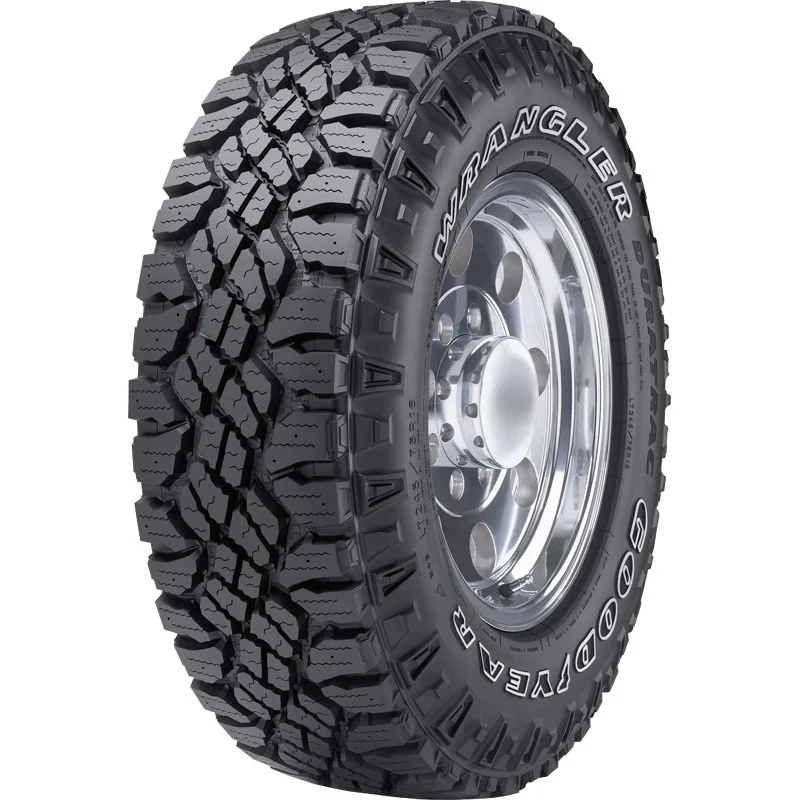

Yup, these-

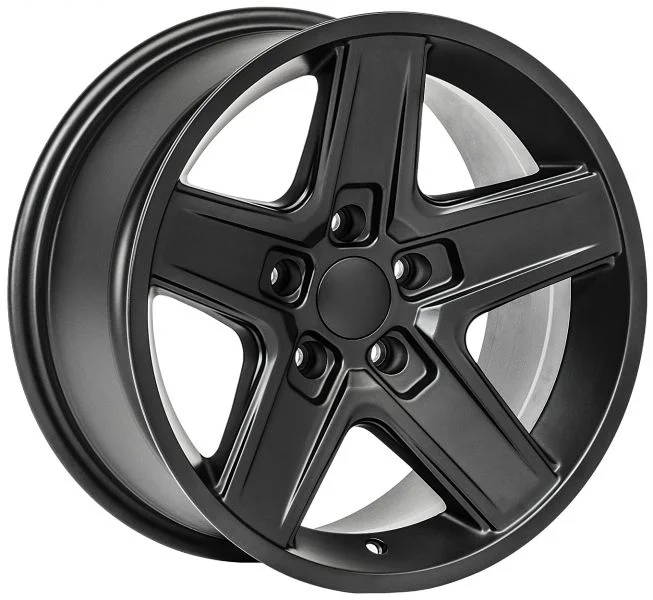

and these -
The wheels are 16"x 8" with 4 1/2 inch back space...the tires are 265/75R16 load range C.

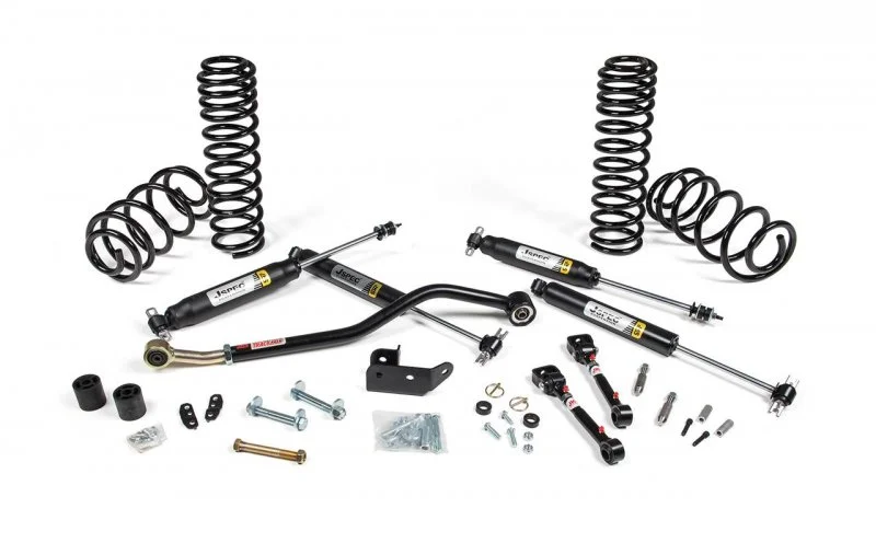

To support the wheels and tires, as well as to give me a little more ground clearance-
Suspension Lift, JKS Jspec 2" TJ Lift. Not 100% sold on this particular one yet, but it's the leading contender at the moment.

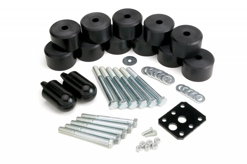

And this -
and this -

That's the runner up so far, subject to input from the experts. Everything I've read on the OME springs that DPG uses indicates that a 2" OME spring actually gives you somewhere in the neighborhood to 3 - 3 1/2" of lift on a light TJ. The OME springs, and DPG, have a sterling reputation though, and the JKS stuff is really new in the TJ world. JKS has a pretty good rep in the JK world. We'll see if that translates. I have it stuck in my head that I want a small lift - 2" or so.

Just don't make the mistake most do, thinking you'll be 'lightweight' forever. I made that mistake at first only to then start adding winches, bumpers, etc. and before you know it the weight starts piling on. Of course if your goal is to stay lightweight (and you have a reason to with the 4 banger) then I could see your concern.
When I had my OME lift on with the Wrangler was bone stock, I feel like the 2.5" they advertise was indeed accurate.
No problem! Just make sure you don't make the mistake so many of us made and assume that it will be enough. Maybe it will be, that's certainly possible. But it wasn't for me... I had to keep going!

I made the mistake of going with the 2.5" OME first. Not so much a mistake because it is a FANTASTIC lift, but then I started realizing that I should have just gone with a 4" so I could solve all the potential clearance issues associated with a 2.5" lift. I wish I'd listened to everyone else's advice when I started because I would have just saved the money and went right to the big lift from the start.

I like the Grizzly wheels, I have the same on mine and they dress out nice with bigger tires. BTW you can get the center caps for cheap on Ebay, just picked up a set of 4 for $12.
