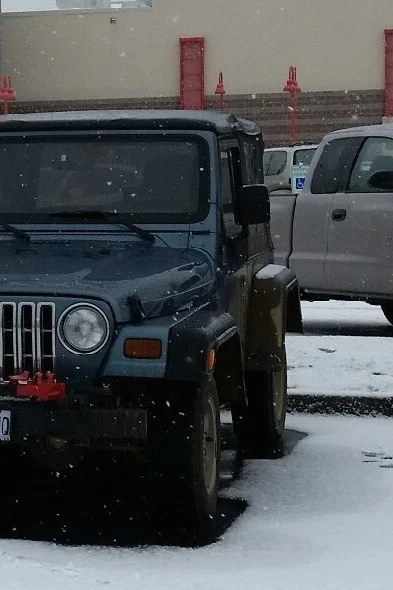

1999 SE from stock

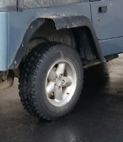

Those flares are screaming for 15x8 rims with 4.25" backspace... and maybe 31s with the SE/4.10 ratios.
Those flares are going away... The PO put them on, and I'm guessing that she had bigger tires and wheels that the stealership replaced with the stock Grizzlies and crappy tires.

Oh god... Those wheels need to come out much, much further!
Really thinking 16x8"s with 4.5" backspacing. 265/75R16 shoes. The wheels would be a hair wide for the tire size, but the backspacing and width would be about right for the eventual upgrade to 285/75R16's in the future. After suspension work.

Really nice clean SE.
Best place to start... bone stock.
Isn't that the truth! I just had a scary thought...what if this is the last stock TJ on the Left Coast? What if she is actually a collectors item? Naahhh...
That should be right about flush with the fender flares which will look good!
That's what I was thinking. I was also thinking that that wheel and tire combo would give me time to do the axle and suspension upgrades needed to support 33" tires. It will probably take a couple of years to get all of that done and by that time, the tires would have some wear on them.
