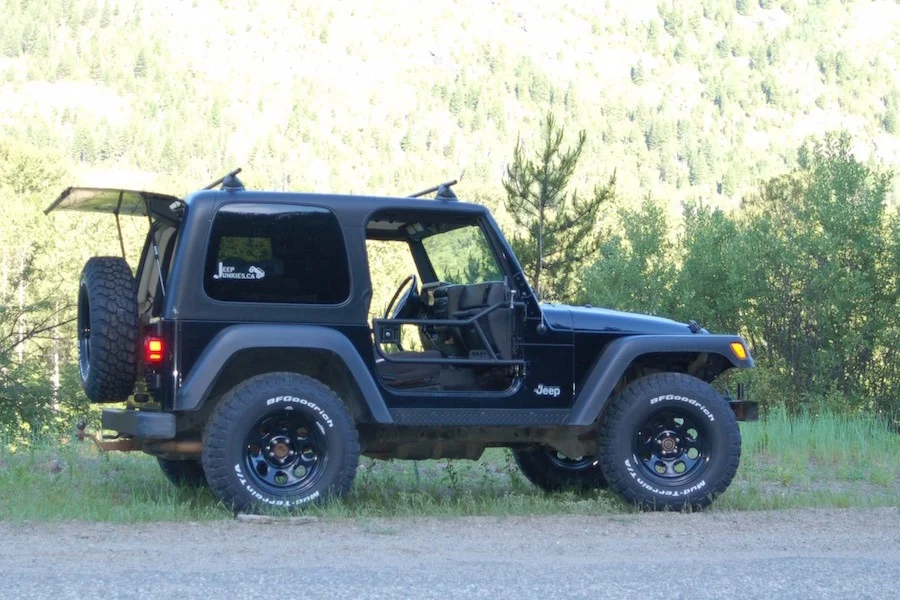

Instead of a 2" lift... go HighLine. Lift the fenders 2". Stock suspension. Here is my TJR with 33s, stock suspension and AEV HighLine.
No driveline issues. Stock ride. Unless you will need maxflex... AEV still sells the HighLine hood. All they did with the fenders was cut off the tops and fill the 2" gap with a 3" strip of steel. Unfortunately they do not make the plastic flares anymore so that would have to be a custom item..x4.
