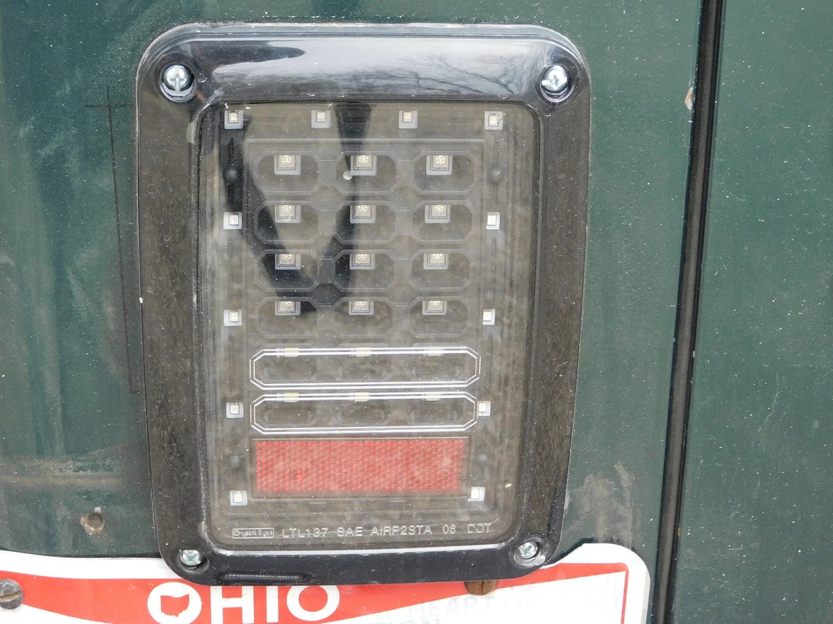

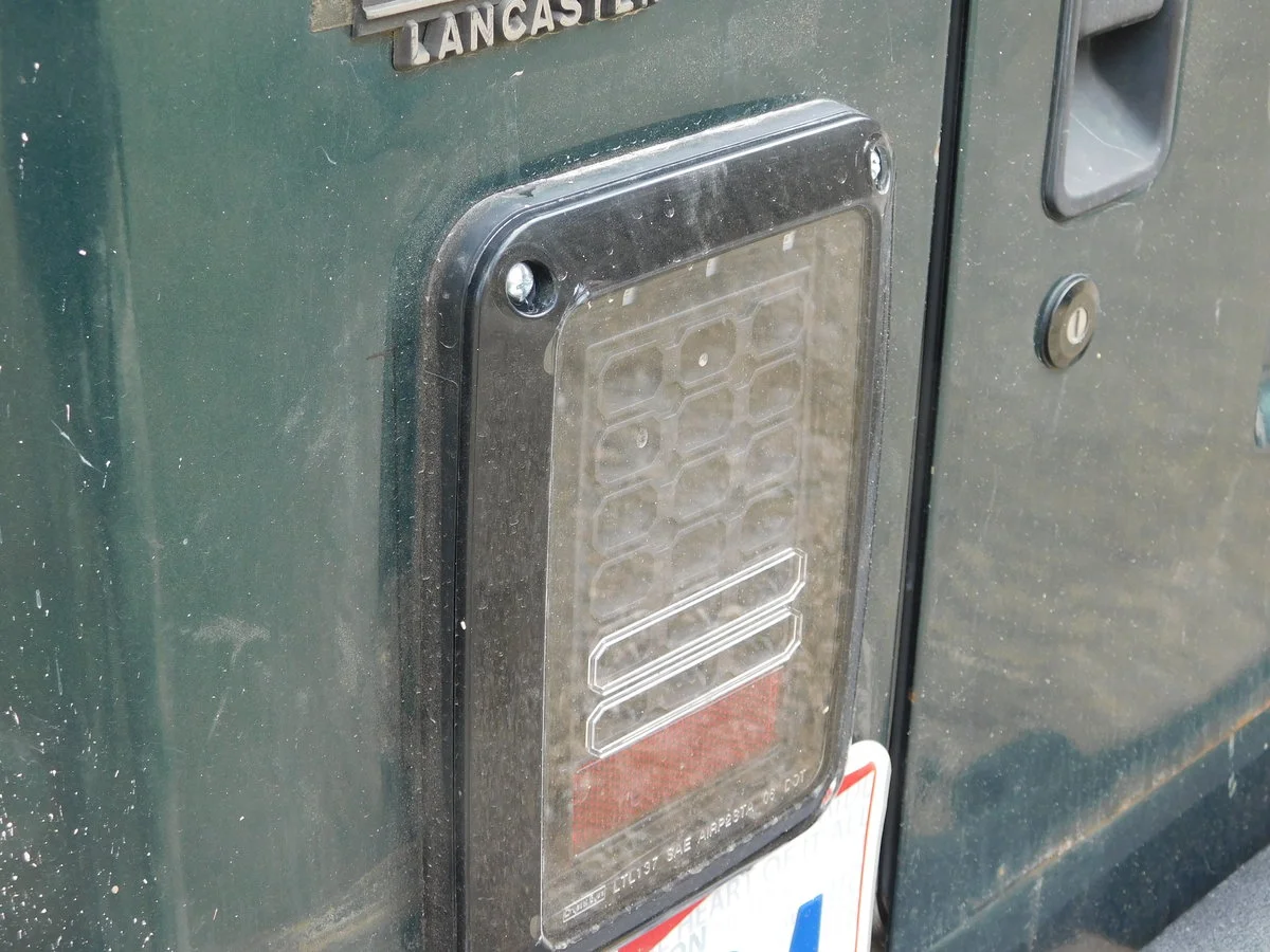

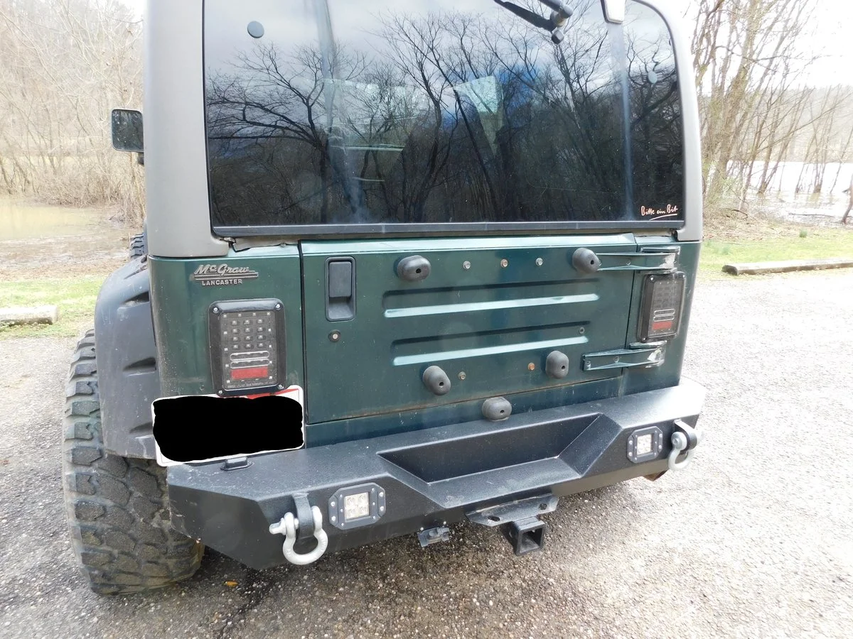

I also swapped my generic tail lights for LED JK lights...
