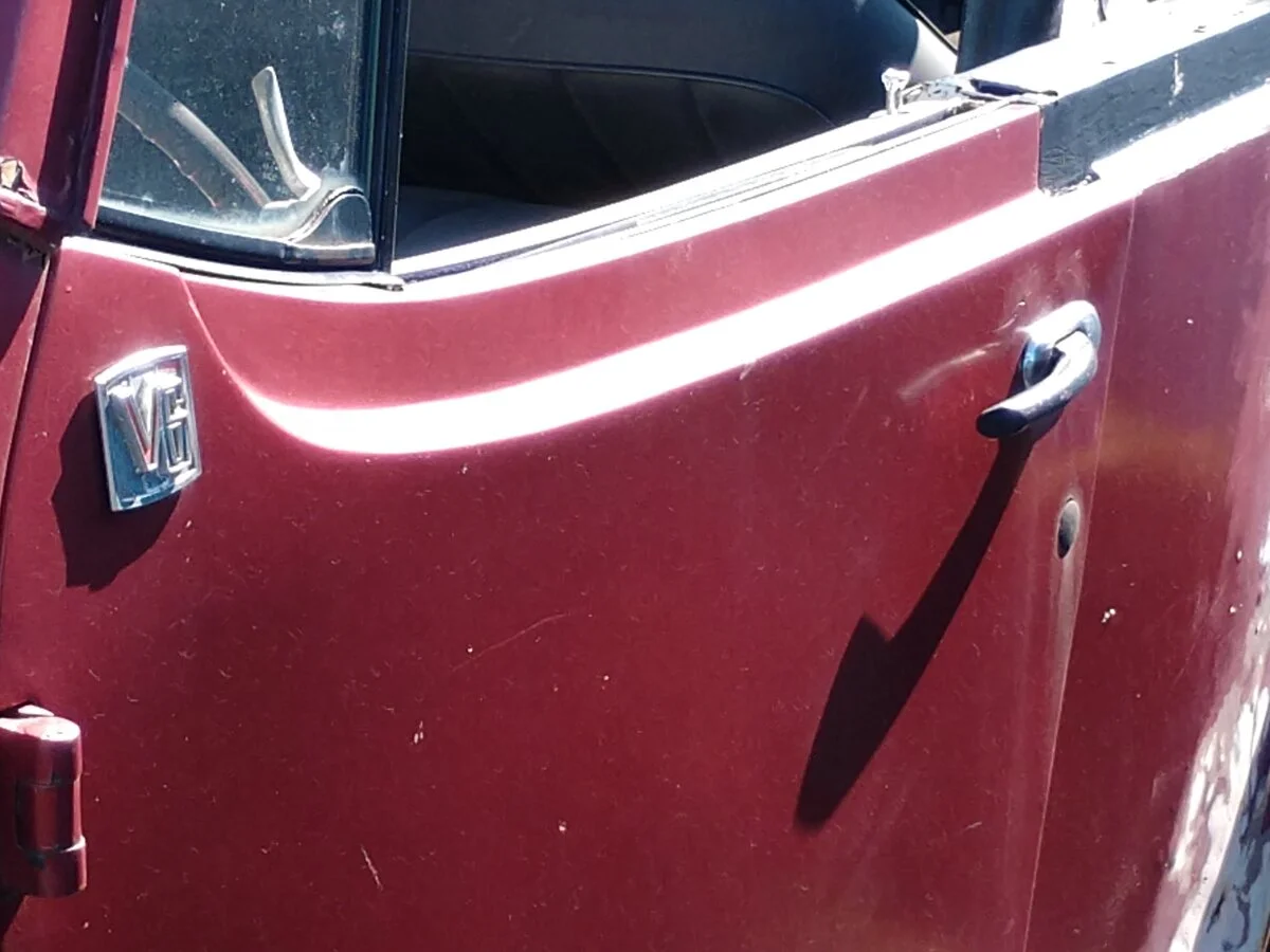

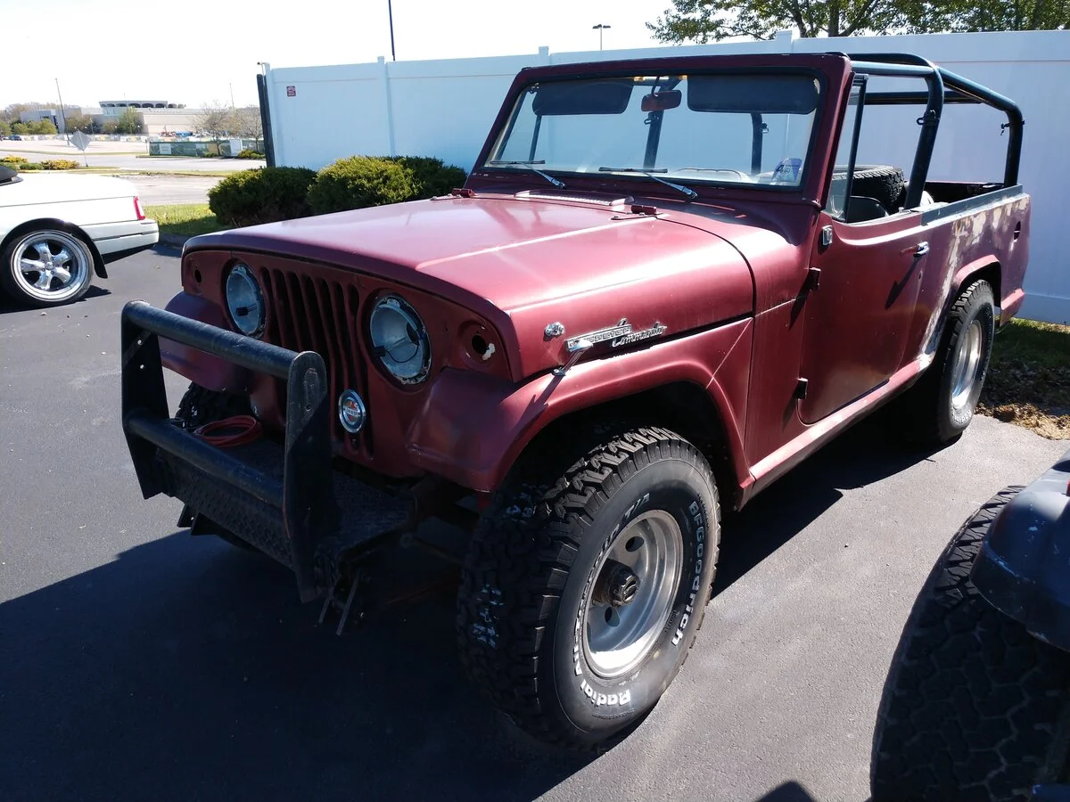

Earlier today I saw a very old and somewhat abused Jeepster Commando sitting at a used car lot that seems to be permanently closed. From what I see I'd say the CJ/YJ style door handle design was a huge improvement in stopping tree branches from snagging the handles and opening the doors, if not ripping the handles completely off.
I also think that somehow my phone led RustyAutoholicGuy to add to this thread this morning as I took these pictures.

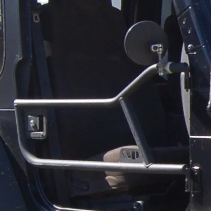

I just did this mod today. First door took an hour or so and second door took about 20 minutes.
I replaced the door handles at the same time.
You only have to make two easy bends in the existing actuator rod to get it to line up properly. It took me three times with the first door, but on the second door I got it right the first time.
The difference in walking up and opening the doors is amazing!
Thx for posting and for the help HondaXR250.
Very happy you got it done, and like it!
