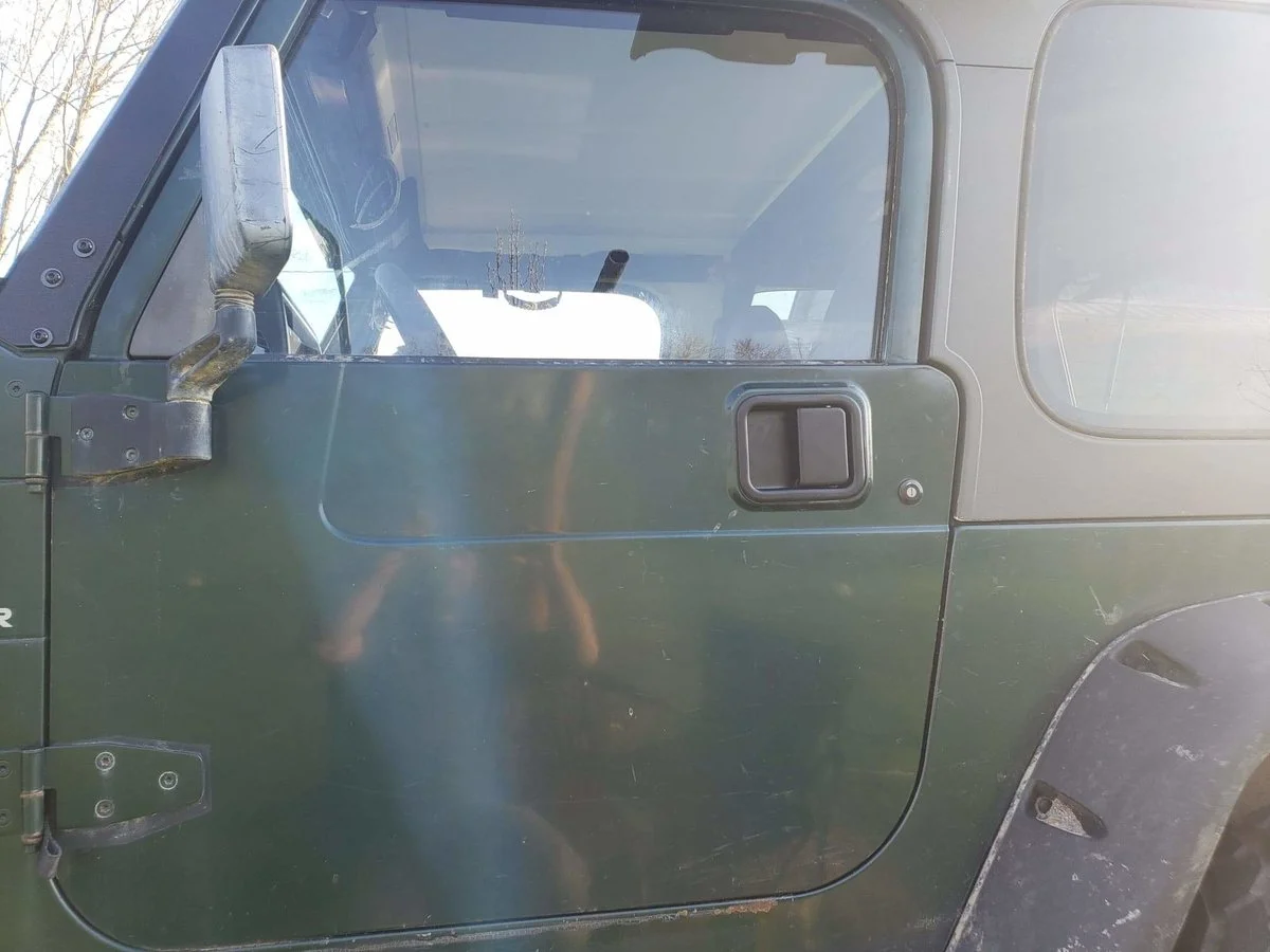

I needed new handles so I went ahead and reversed them when I installed them. It feels so much more natural when opening the doors now. This has to be one of my favorite mods.

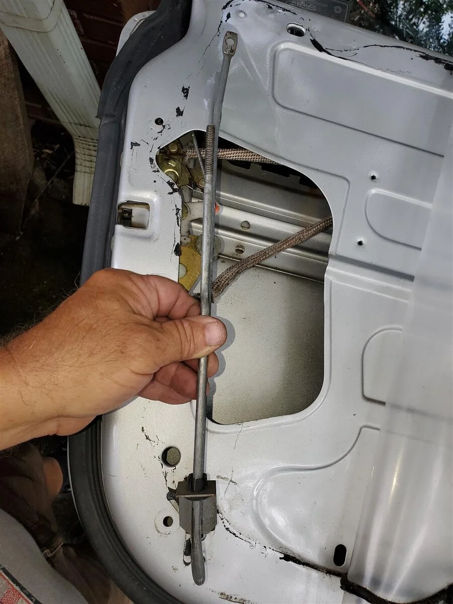

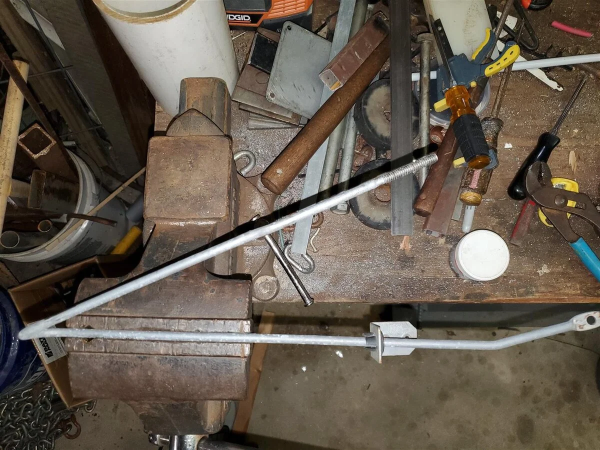

Someone asked for pictures. I swapped my handles last week and made a few pictures. I removed the doors and worked on a table for better access and viewing. I mounted the rod in my vise with the tab that attaches to the door handle peg parallel to the floor.

I bent the short arm of the rod parallel with the long side in the vise. Then I bent the short bend at the top of the rod slightly back in the opposite direction from its original bend. You can see how that looked when laid on the door to check fitment.

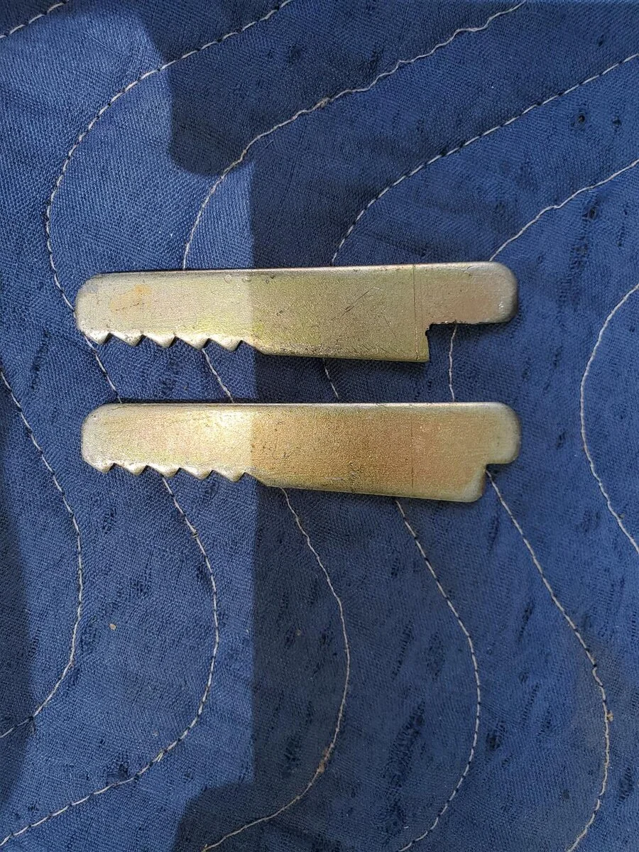

The very hardest part of the job was getting the handle clips back in. I had to grind the one that was used closest to the door jamb to allow me to insert it into the slot. Then I used the elongated hole in the door and a screwdriver to push the clip back down into place.
The other side, I was able to get to with my hand and push it in.

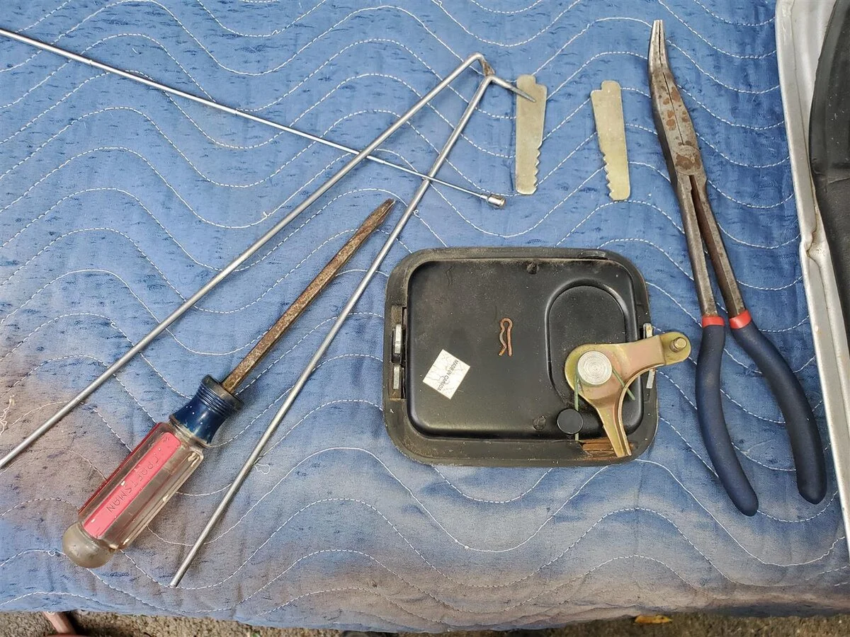

I made a couple picks from arc welding rods to help me release the tabs and pull the cotter pins.

By the way. Dont break the little tabs the lock the clips into place. I used the flat pick I made to carefully push the tabs out of the way. But I broke one trying to bend it a little for a better hold when I reinstalled it. So, I had to make another to replace it (PITA).

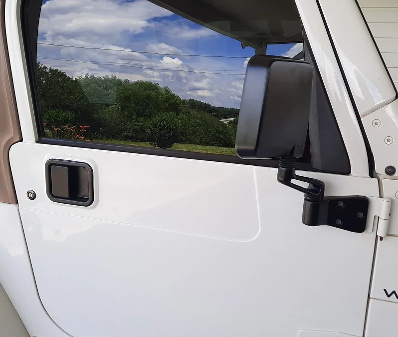

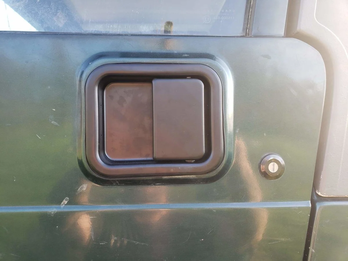

I am really glad I did this. The door handle feels much more natural to open now using your hand to open it rather than turning your arm awkwardly and hooking your thumb into it. My wife immediately noticed the improvement.
I have had my Jeep since 1999, and I never could remember which way to turn the key to lock or unlock the door. This mod now makes it very easy to remember. With the door handles now opening from the back, it seems very logical that turning the key BACK unlocks the door. It is now a very fluid, natural movement to insert the key, turn it *back* to unlock the door, and reach into the door handle and be able to pull it *back* as well.
Exact same here. And if all you know is the way of opening them with your thumbs, than you cant imagine what your missing. It blew our minds how much better it is.
I have now lived with my door handles reversed for a couple of weeks now, and I could not agree more. My mind is completely blown on how much better this is. It is blatantly obvious that the TJ door handles were indeed backwards before. I would never go back to the other way. Hell, they even LOOK better this way.
If you have full doors, you MUST do this. I rank reversing the door handles right up there with re-gearing my axles as far as one of my absolute favorite improvements to my Jeep.
