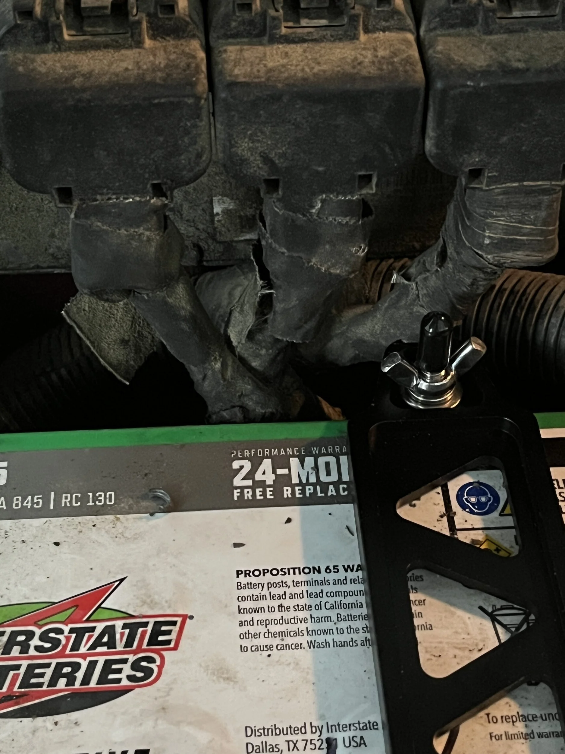

Fancy $11 Amazon battery tie-down went on today. I think I'd like to make some sort of rash guard out of Kydex or ABS sheet to protect these harnesses from constantly rubbing on the edge of the battery. I must have some scrap laying around.

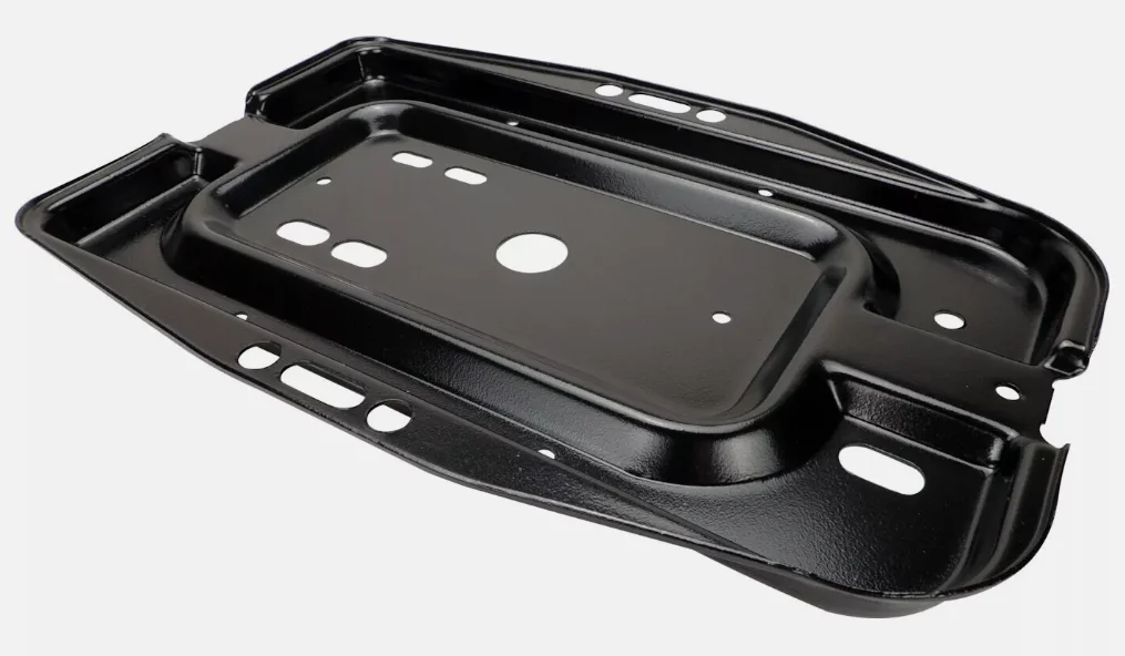

Did you have to drill the tray to accept those long j-hooks or whatever they’re called that the wing nuts are screwed onto?
NO, actually! What I did was I ordered a Crown replacement battery tray (p/n 55174728AB) from a '97-'04 TJ:
...and then I ordered the aftermarket tie-down with 8" J-bolts. I didn't want to use the newer-style wedge hold-down for two reasons:
  1. They suck
  2. The original tray was corroded enough to warrant a replacement
I can't take credit - I got the idea from this video. Contrary to what he says about the cheap-o Amazon mount, though, my battery won't budge even 1/8" inch after installing it hand tight with wing nuts. And I didn't have to cut down the bolts since I ordered them in an 8" length.

Makes sense... it doesn't take much rocking to wiggle the battery loose, especially with that POS wedge hold-down. I consider it $42 well-spent.

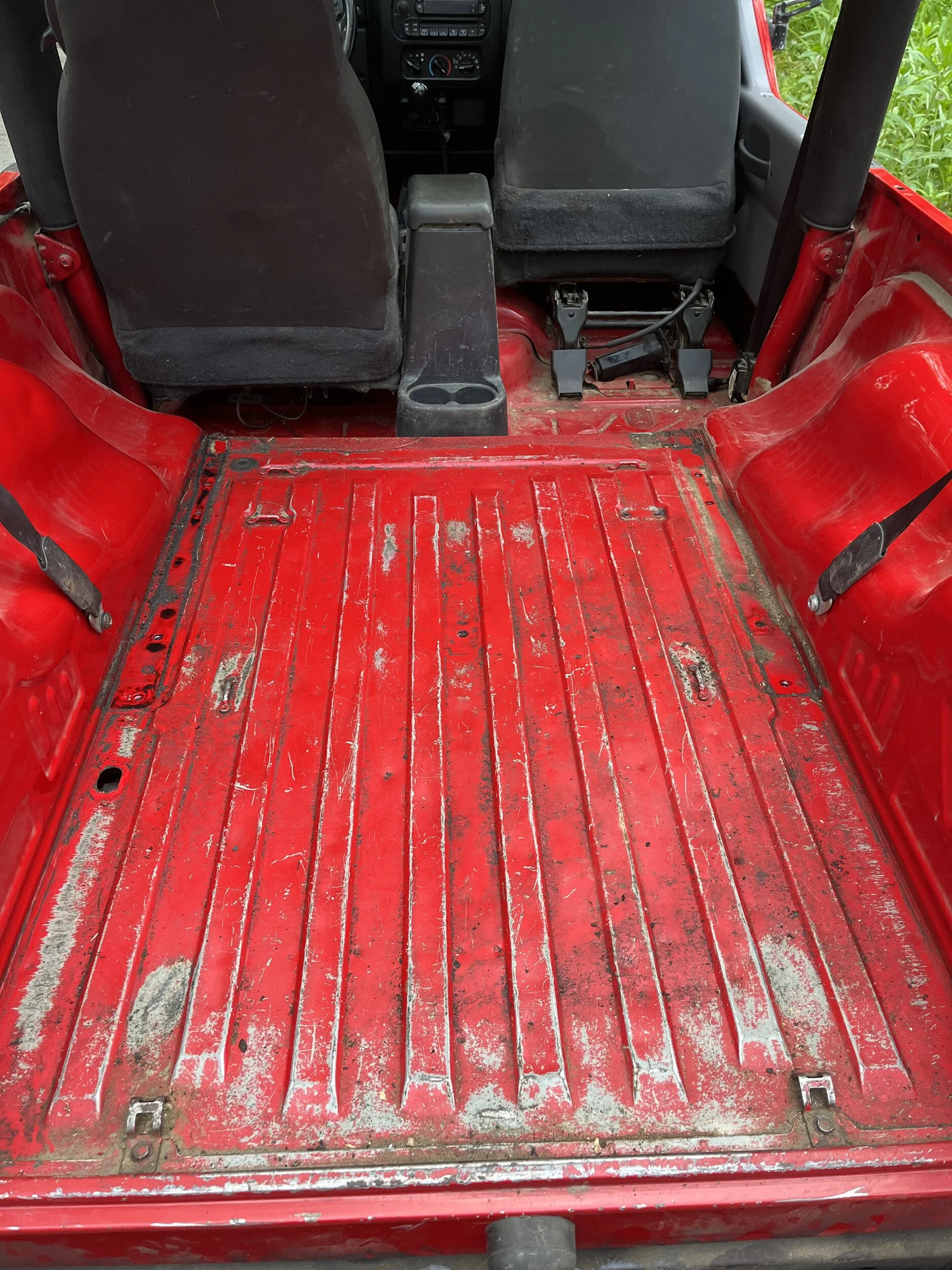

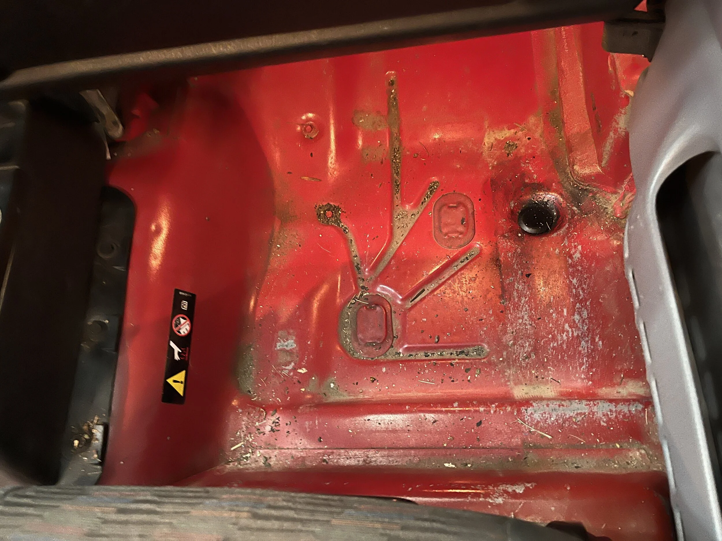

The old carpet came out in 5 minutes. All in all, the tub looks pretty good:

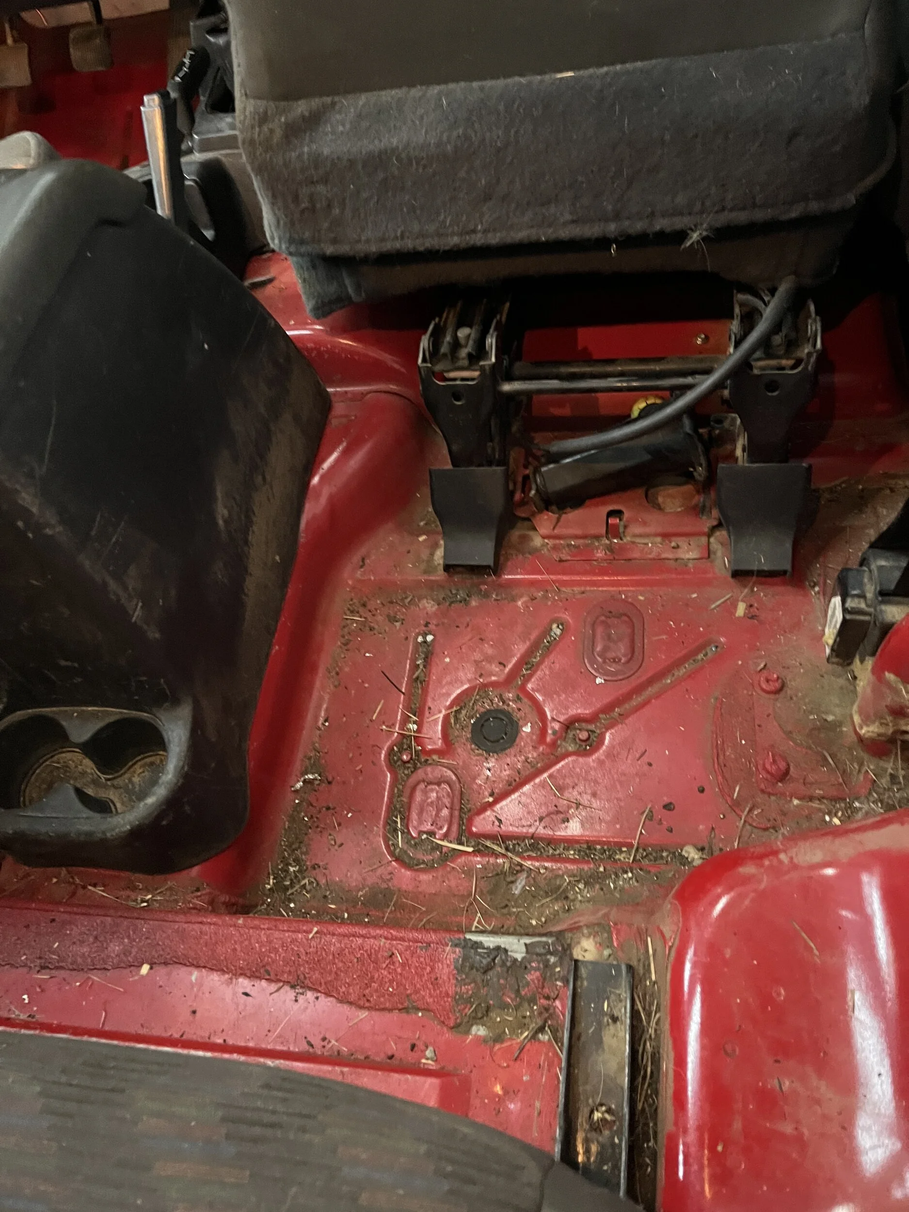

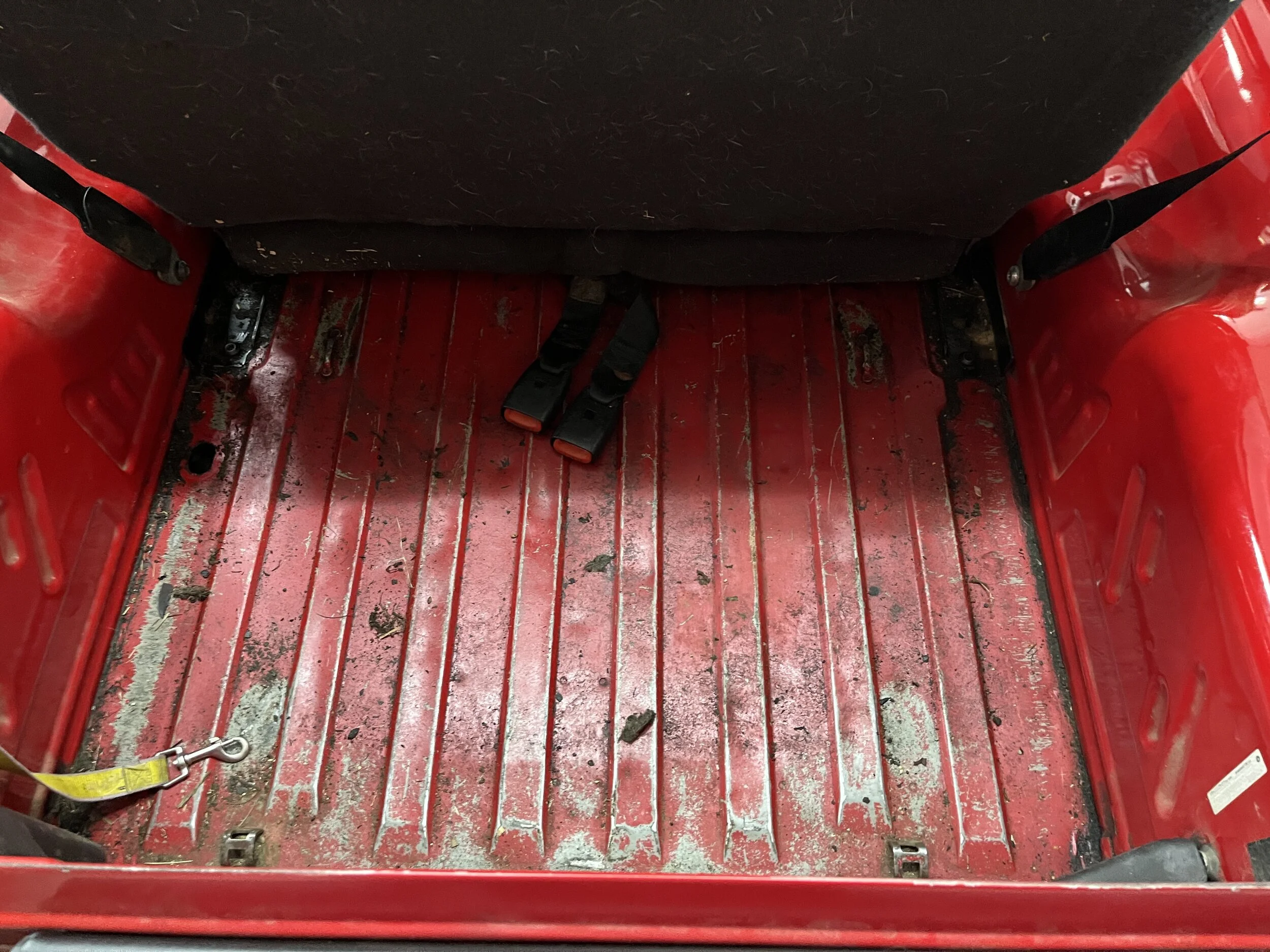

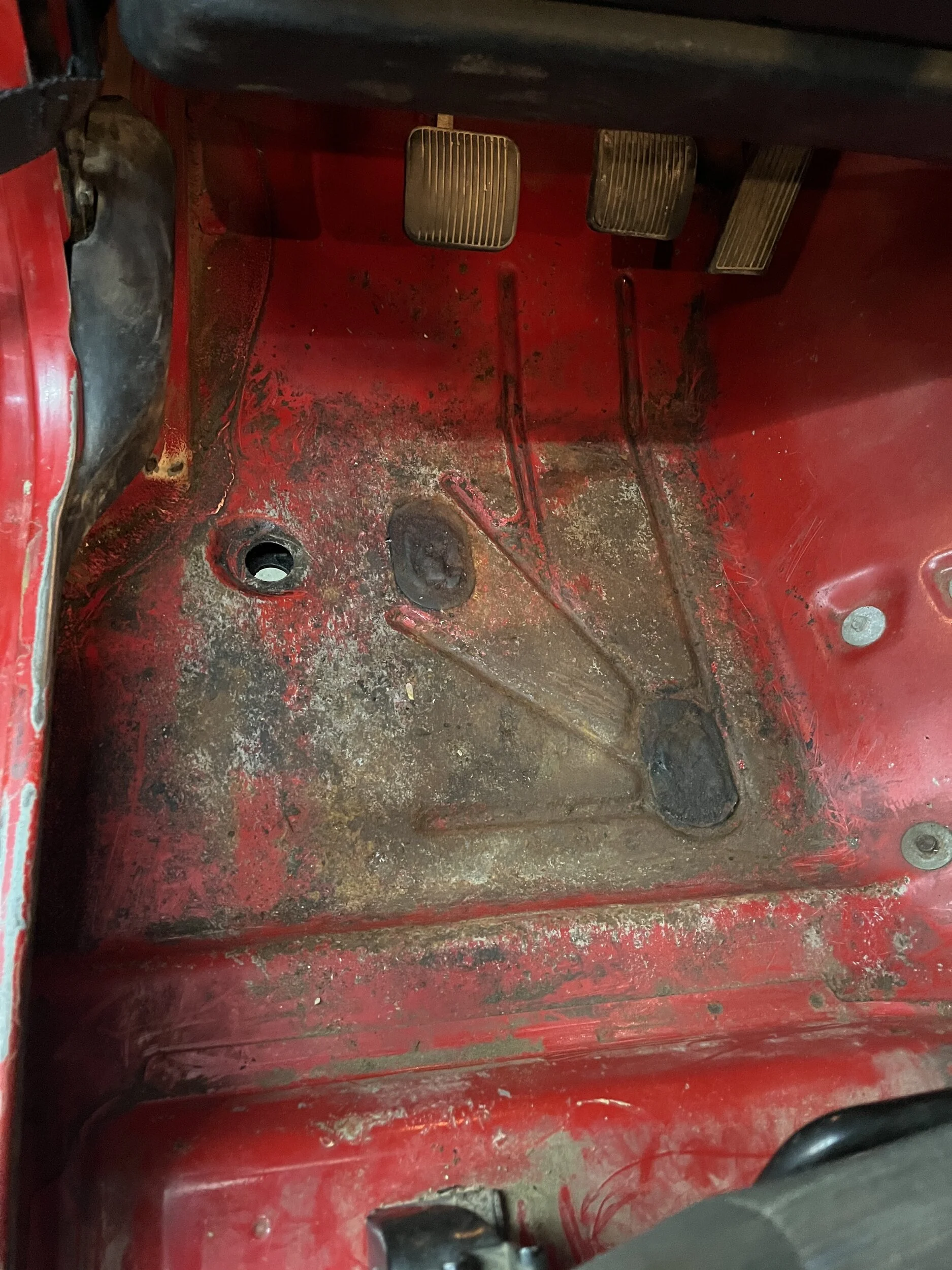

Saving the worst for last:
I went at it with a plastic trim removal tool and the shop vac... until the shop vac literally caught fire. It was on its last leg anyway.
The rear seat belt bolts came out pretty easy with heat. The rear seat brackets on the other hand... lots of heat, PB Blaster, and alternating with the impact (CCW and bumping CW) and the breaker bar (rocking CCW and CW), thankfully got them all out intact.

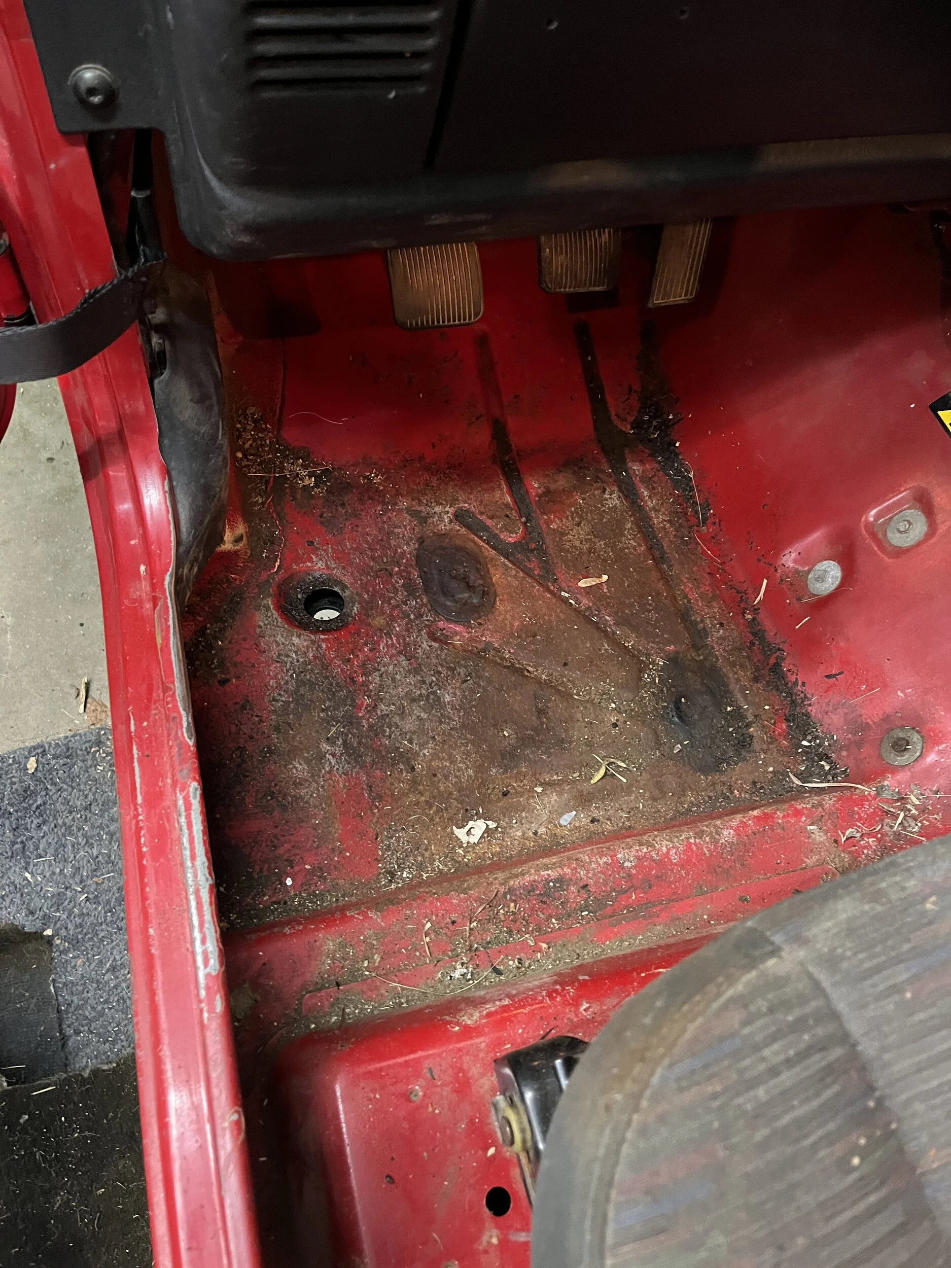

After the console comes out, I'll wire wheel where needed and degrease everywhere. I'll have some Eastwood Rust Encapsulator on hand tomorrow to coat the rust in the driver side floor. I'm considering getting some Rustoleum Professional Oil-based High Performance Protective Enamel in Regal Red to do the tub... I saw a thread on here somewhere where the owner used it and it looked good. I'm open to ideas.
There's one footman loop under the rear seat that's been torn out; I will probably just put in some self-tappers and coat over them.
The full BedRug is sitting on my porch ready to go. I'm waiting on the insulation. The Savvy transfer case cable shift kit got here today. I ordered straight from Savvy and it was packed loosely in newspaper and shipped in a flat-rate USPS box that came complete with a hole punched through from the inside. It looks intact, though, so that'll go in this weekend, probably.
Gotta be the least rust on a jeep in Maine!! I’ll be stripping my interior this fall/winter and I’m scared …
How do your roll bar mounting points look? The “b pillar” ones often hold a lot of rust between the seam sealer on the interior and the typical rocker panel rust on the exterior.
Reactions: DeltaNu1142
They look new. It’s insane. And, for what it’s worth, I bought it in NH. 😄
The last owner had a lot of vehicles, and there’s no sign that he drove this Jeep in the winter. The underside is entombed in applied engine oil. The frame is near spotless from what I can tell. I lucked out.

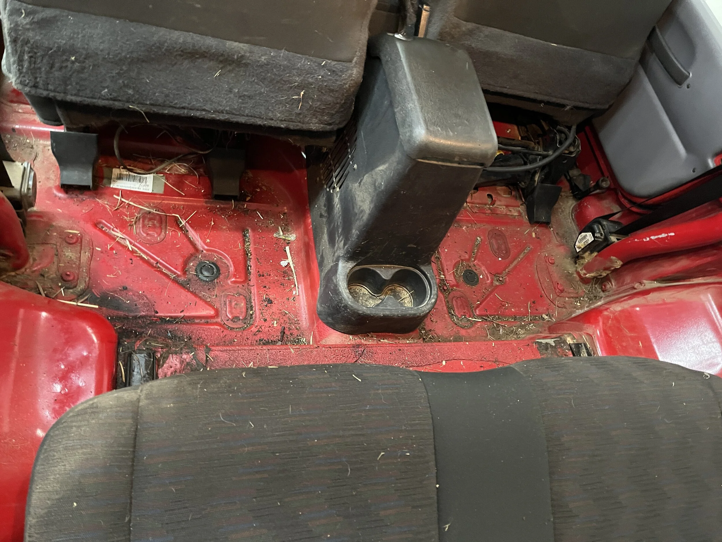

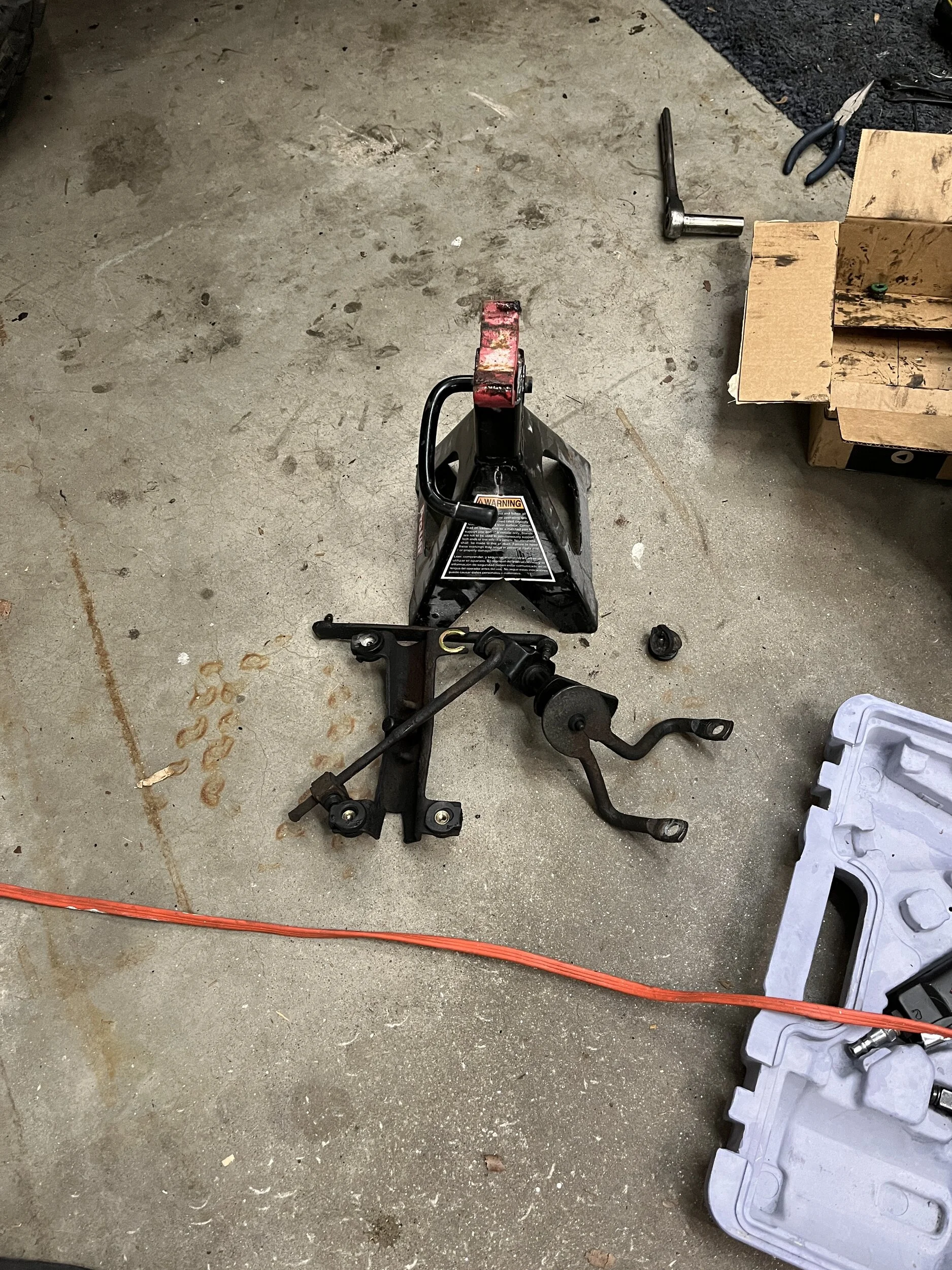

I'll make this quick... the Savvy transfer case cable shift kit is in and running from 2HI to 4LO. Shortly after posting this, I went out and got to work... so, all-in, from setting foot in the garage to popping a post-shower beer, it was about 5 hours including maybe an hour of vacuuming the tub, removing the console, and other nonsense. I don't think I've ever been so happy to remove a part from a vehicle in my life:
Oh, and that little green bushing in the cardboard box... yeah, the one from the transfer case lever... that thing induced as many foul words as the upper bracket nut. I ended up slicing an open-ended wrench in half and going at it with that. Not sure Craftsman will warranty that.
I really wanted this done today so I can clean, degrease, and paint tomorrow. If I make good progress, there's no real reason why I couldn't have the Bedrug in by Sunday afternoon. It'll be a slog, but I really want to get this stuff out of the way.

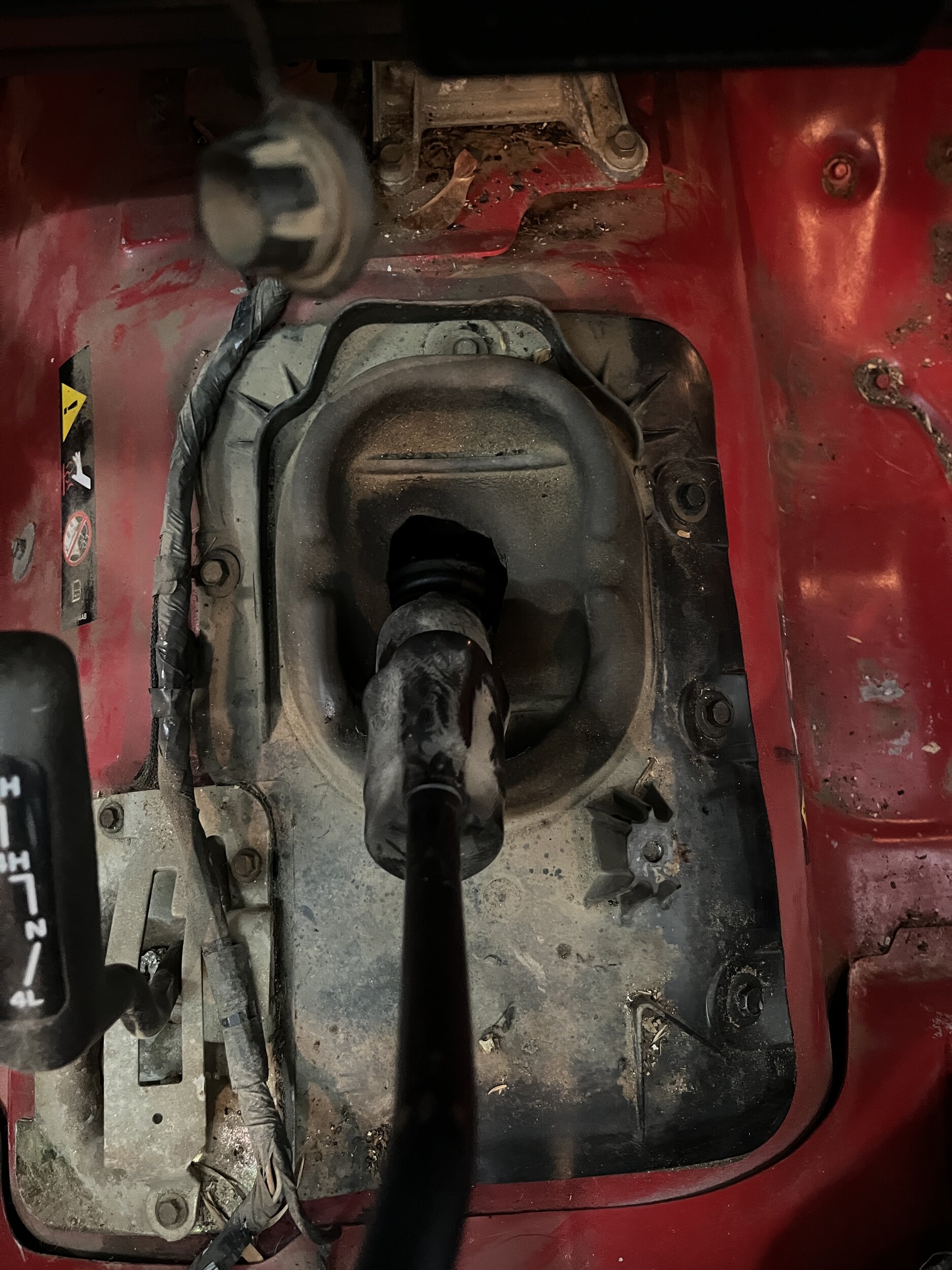

This is the condition of my inner shift boot:
I ordered the Drake D9ZZ-7138 boot to modify for installation here. The smaller bolts around the transfer case shift lever will not come out. They’re installed in nutserts that all want to spin.
I started to remove the assembly to access the top of the transfer case for that cable install, but those bolts stopped me. I’ve already put the skid plate back on… but I may end up taking it back off to remove those, especially if it makes modifying and installing that shift boot easier.
I’d anyone has insight into those bolts (sizing, nutsert installation, maybe using self-tappers instead…?) I’m all ears.
