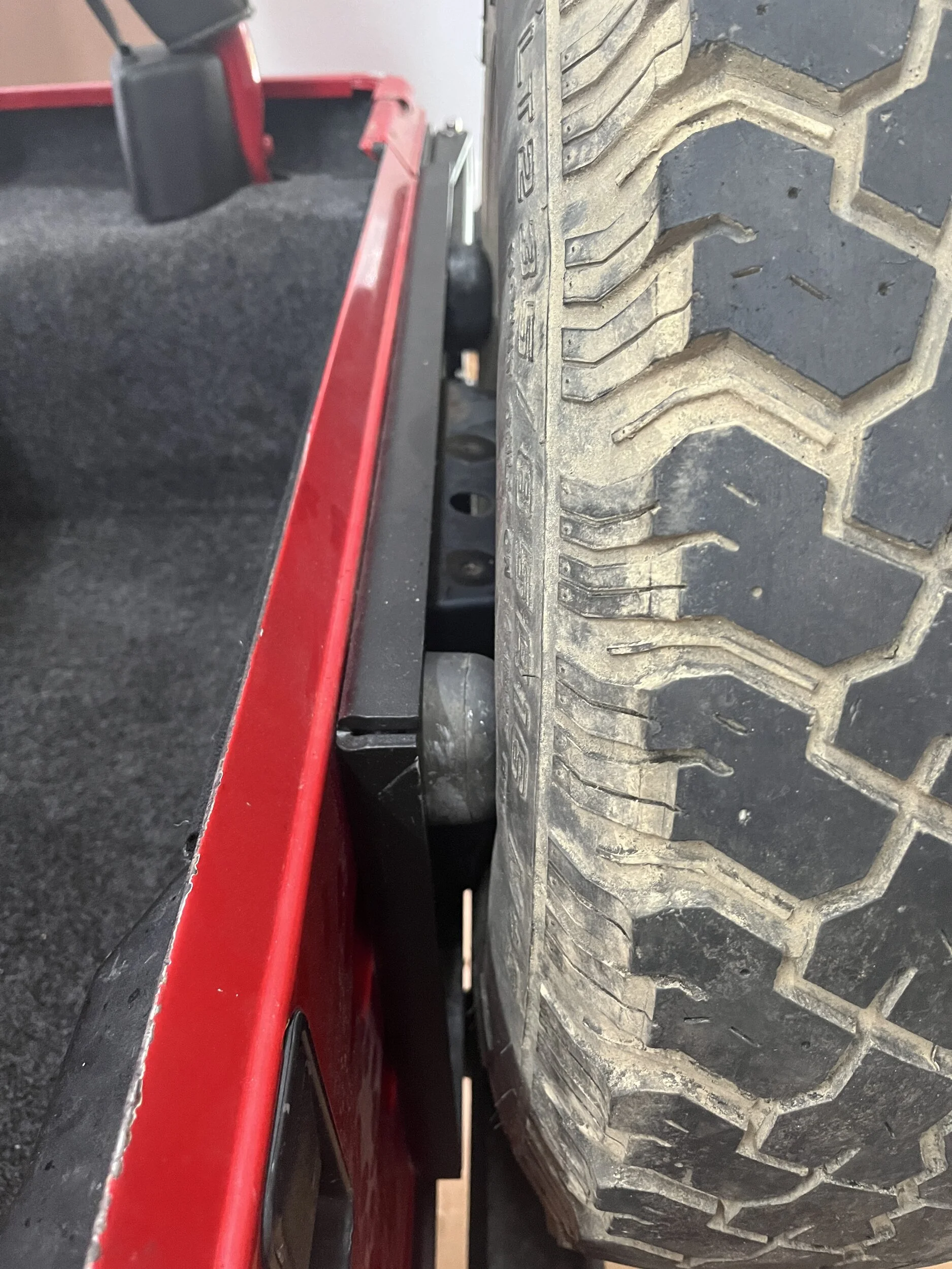

To prep for the trip, I've installed the OEM carrier back on the MORryde tailgate plate so I can carry a spare tire. Of course, it wasn't as simple as throwing the carrier on there... the snubbers didn't reach the spare due to the added thickness of the MORryde plate, so I had to cut up some spare snubbers as spacers:
They're a little thicker than they need to be. With the lug nuts tightened down, they're squeezed quite a bit. No worries about the spare moving around, that's for sure. I'll need to remember to put the OEM jack & stuff back under the passenger seat. I topped off the coolant. With all that done, I think it's good to go.

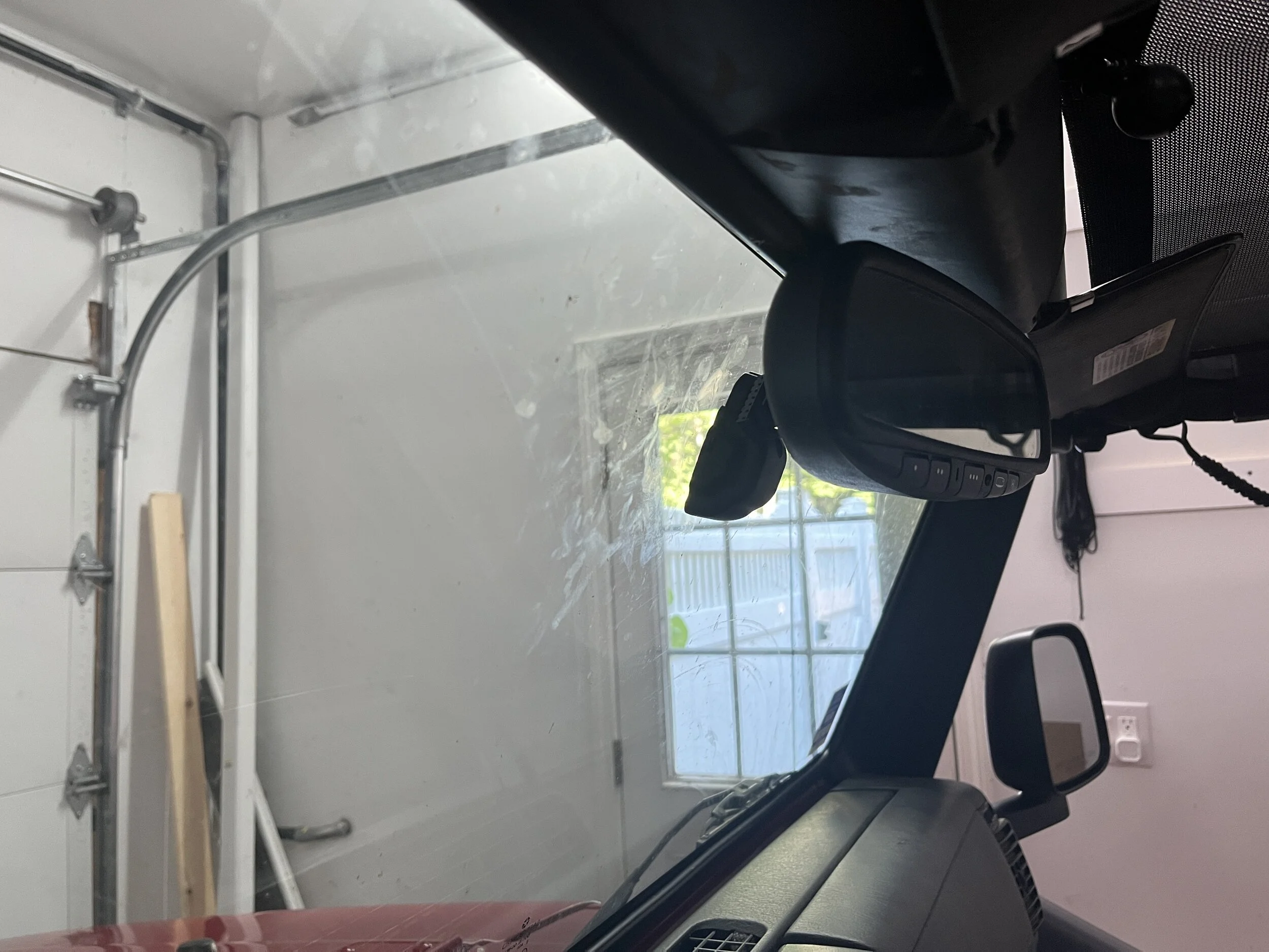

I might move the rear view mirror button up so I can see better. I got a Gentex 341 mirror from a scrap yard and it arrived in less-than-great condition. I got a refund, but I might test-wire it on the "bench" (i.e., someplace on the garage floor) with a 12V power supply to see if it works. If so, I may install it while I try to find a replacement. BUT, even without any functionality the 341 sits way higher than what's on there now (OEM, probably), and so even if I don't wire it up or move the button I might run it on this trip.

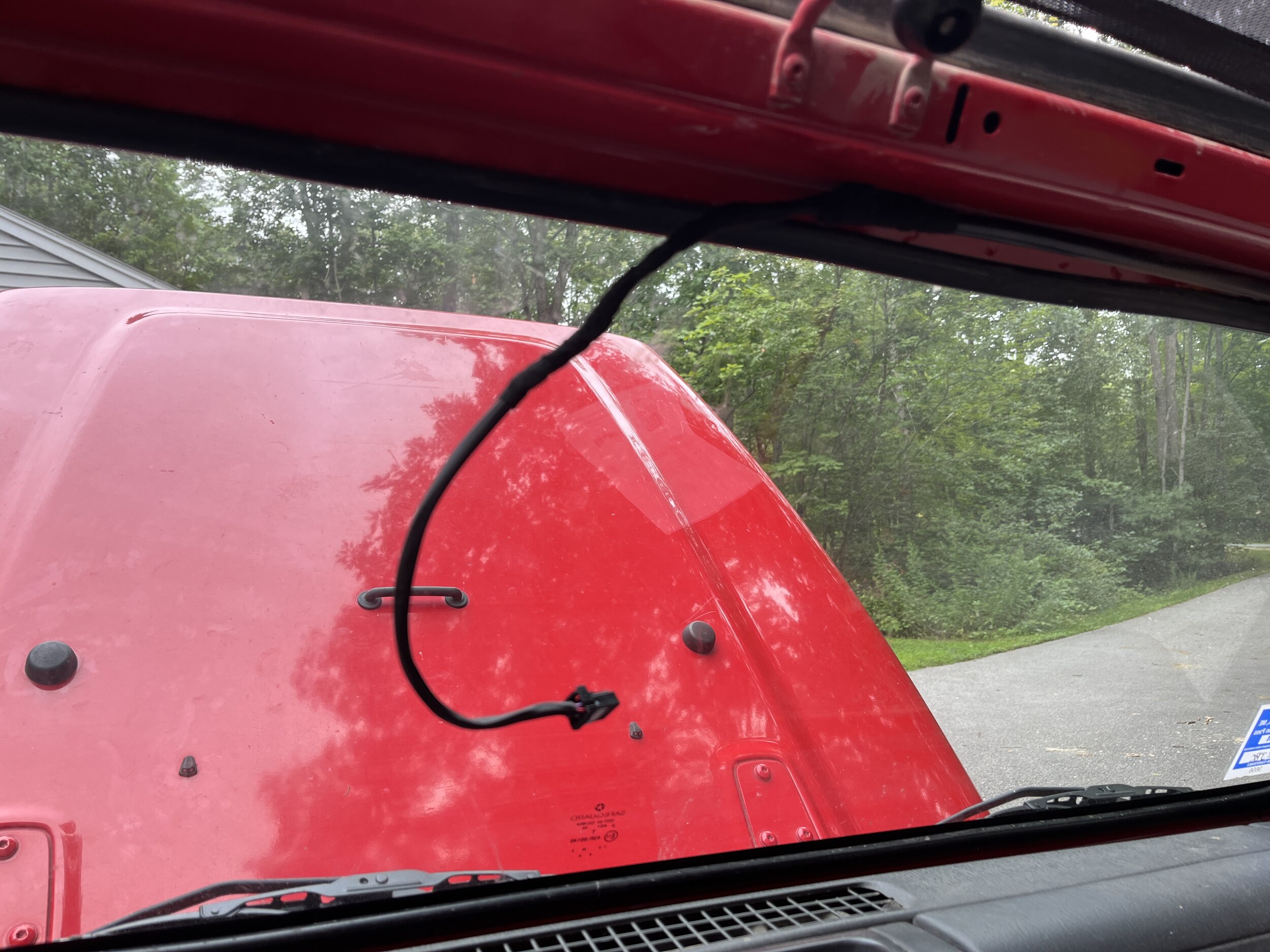

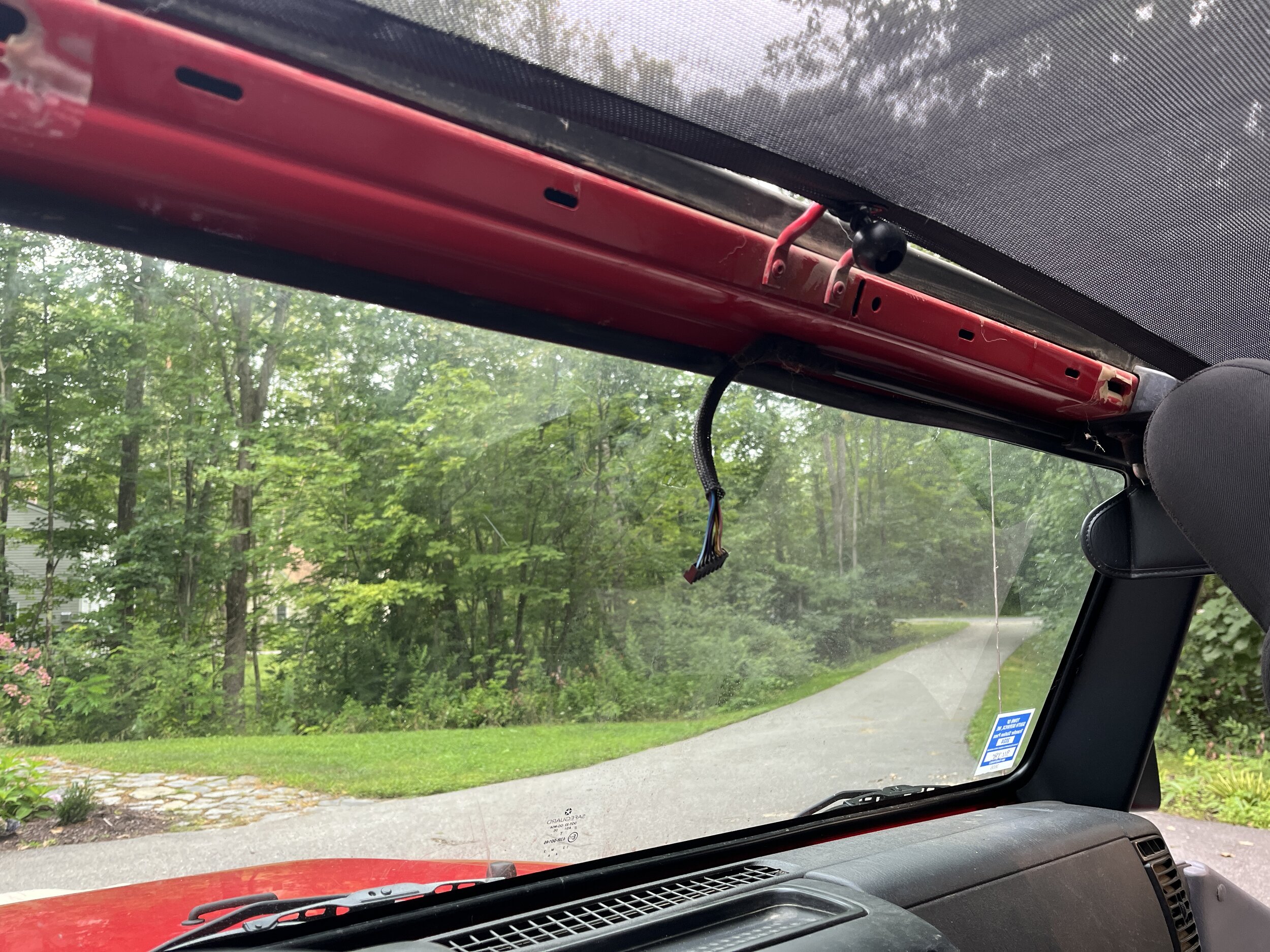

Got a wild hair... couldn't let the rear view mirror thing go after I started thinking about it.
It's not wired in yet, but it's sitting tall... and finally centered. From what I can tell in the comfort of my garage, visibility is vastly better. It'll be good to have garage door buttons once I get the harness done.

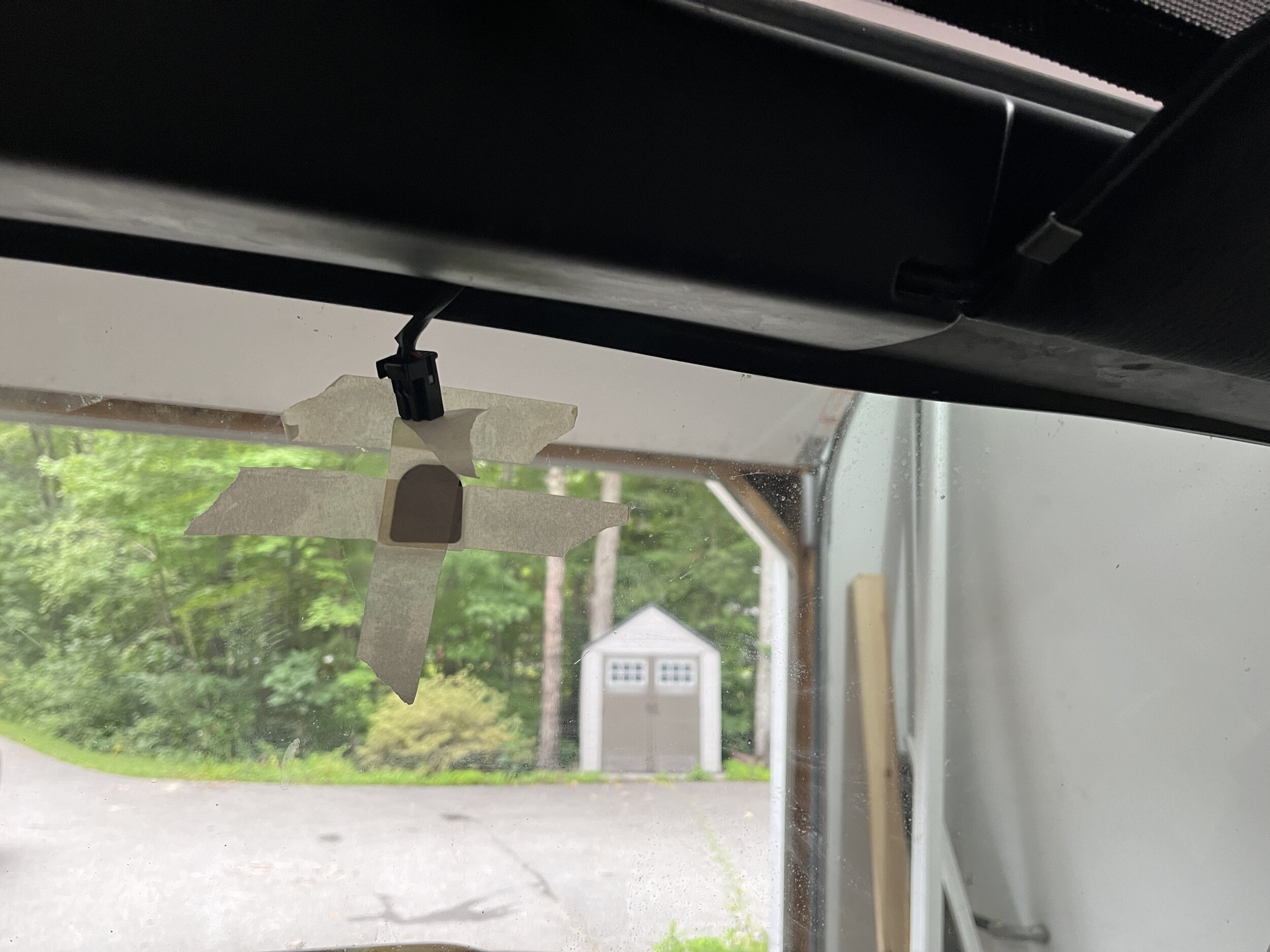

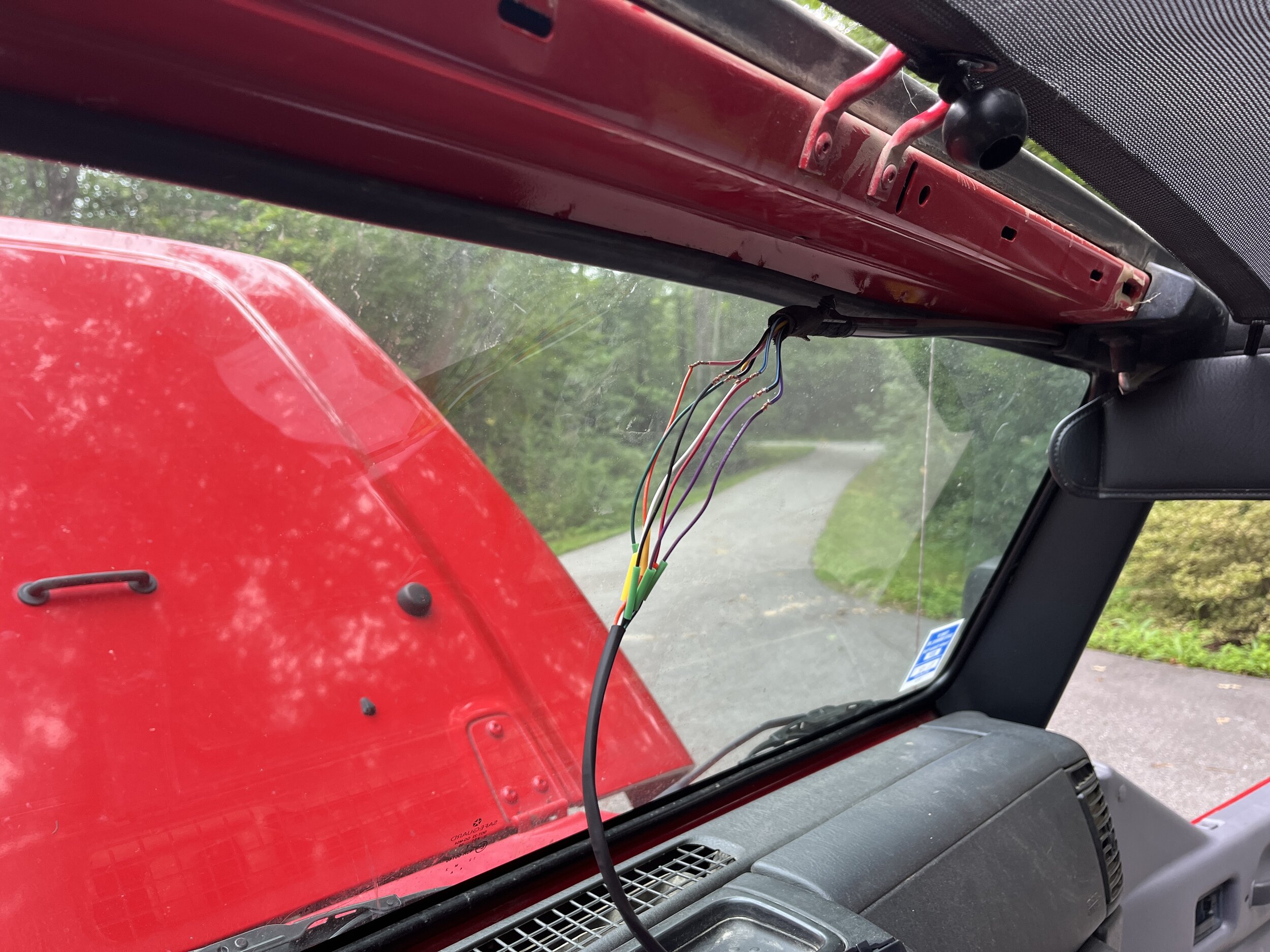

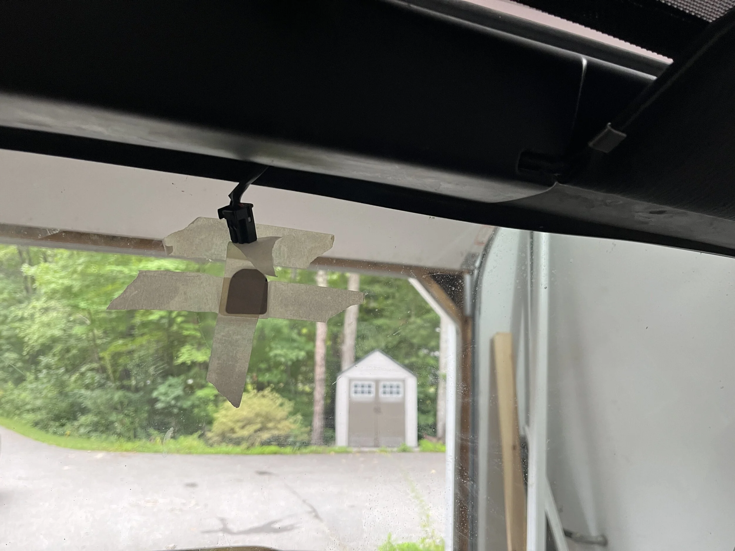

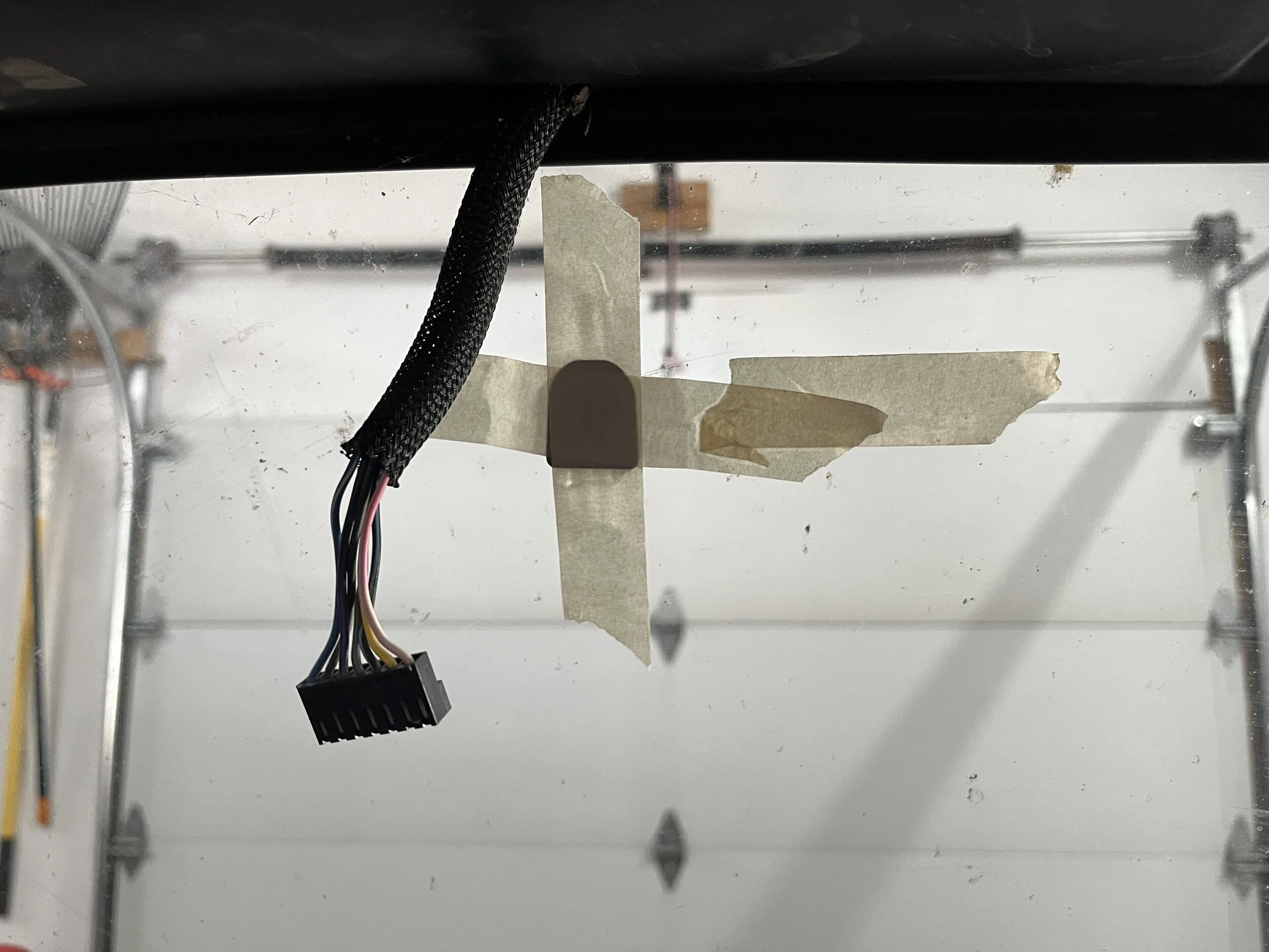

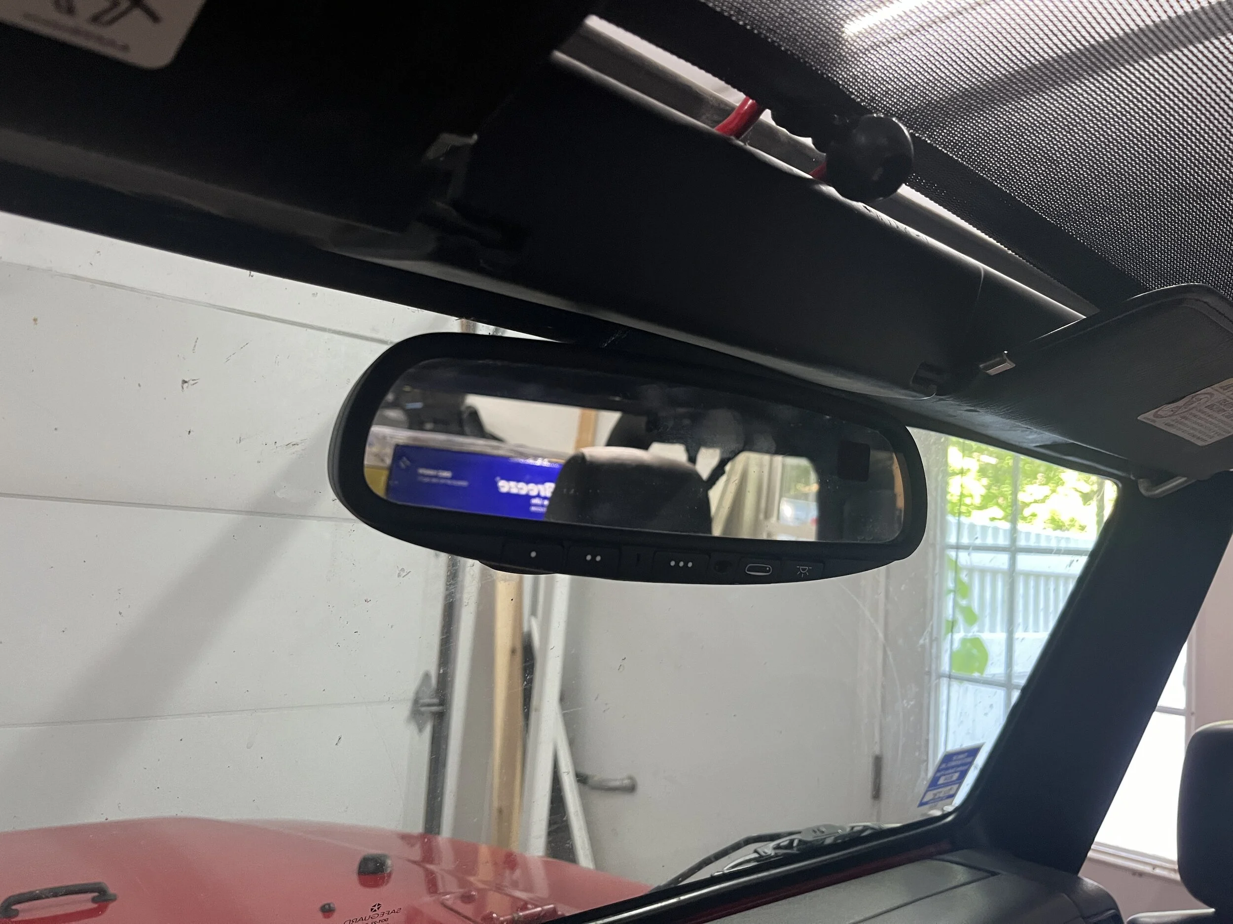

This morning, I decided to wire up the Gentex 341 mirror. The upper windshield trim came off easily enough, but...
...note the lack of mirror button. Yeah... I knocked the whole assembly off the glass when the trim came off. Awesome.
Bob's Automotive documentation was great, and along with what I found on this forum I got it wired up quickly.

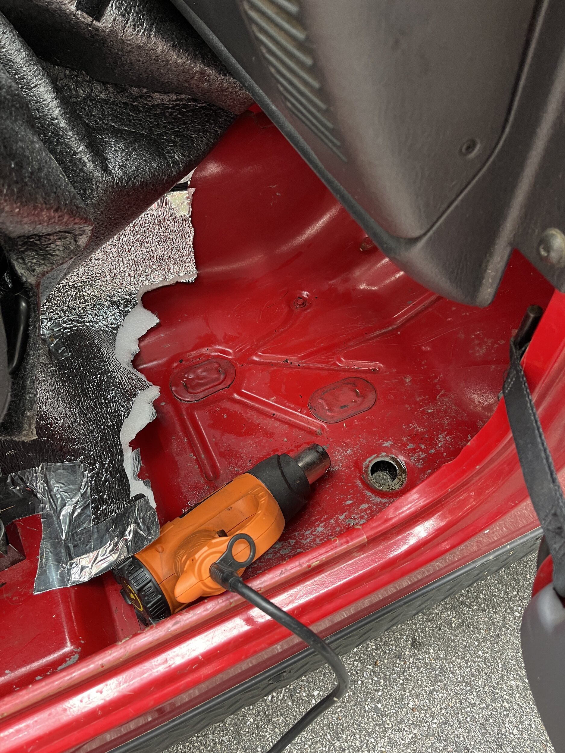

However... while fooling around with the soldering iron, I noticed that the carpet was way more damp than it should be after sitting for a couple of days. I didn't smell mildew until I started pulling the carpet up. There was water under the carpet, as well as under my insulation. I ripped out most of the front floor pan insulation to get to the moisture and soak it up. Yep... I'll probably replace the tunnel insulation, but I'm not going to put it back in the footwells. It's just too low, and there's no way I can keep the water out. I was extra careful with the aluminum tape during installation, and there was still lots of water under there.
I dried everything out and then took a run to Napa for the mirror adhesive. Now I'm waiting for it to cure for reinstallation. I tested the harness, and everything seems to work: temp, compass, map light. I'll program the HomeLink after I get the mirror back on.

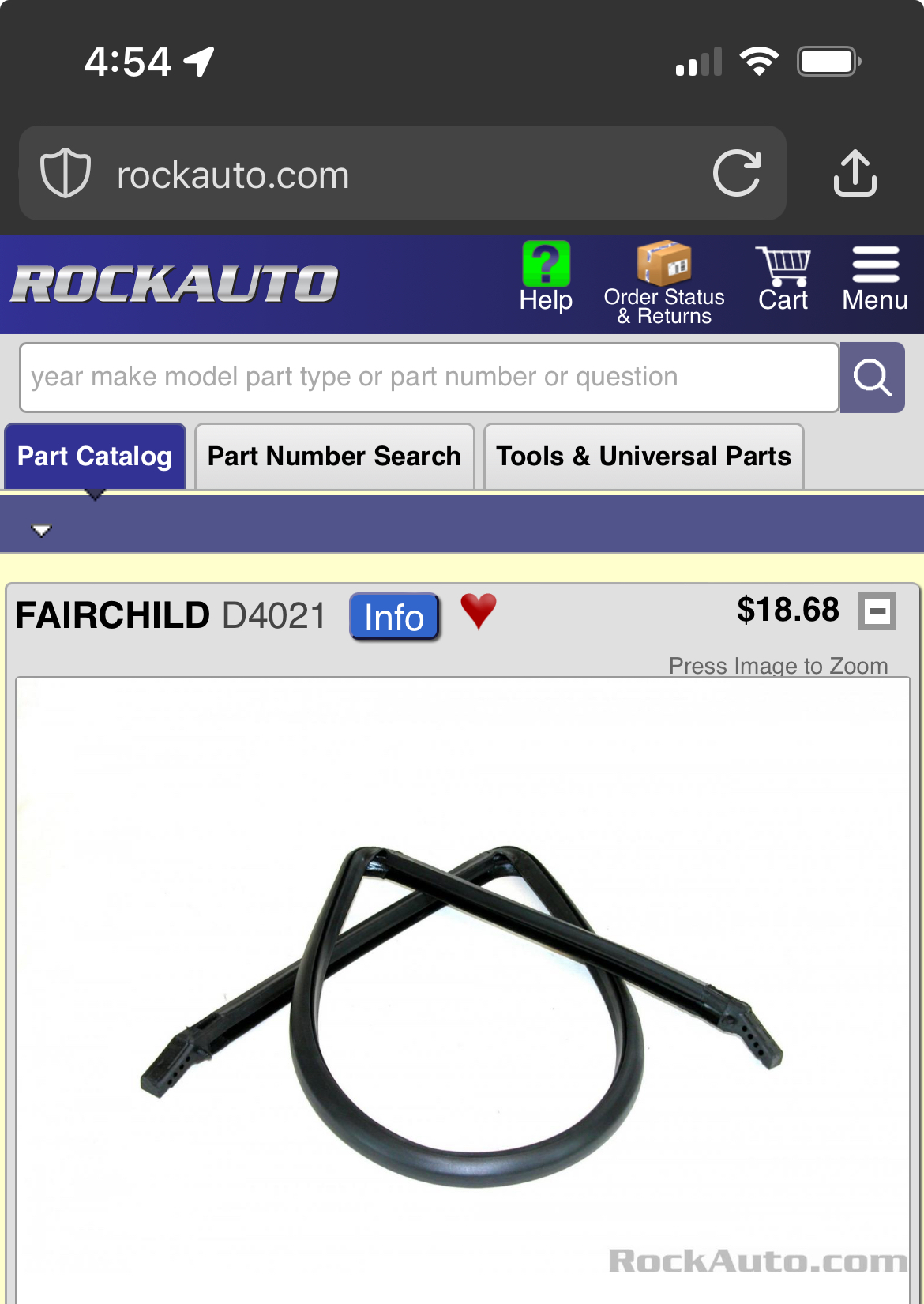

The Fairchild tailgate seal arrived today. I'll get that on as soon as I can get the old gummy adhesive off.
You mentioned the Fairchild tailgate seal; is that the lower seal for the metal gate? All I see from rockauto and fairchild is a seal that says “upper tailgate hardtop seat” part number D4084.
I need the lower seal that wraps the gate itself; which one did you purchase?
That should do it; it wasn’t showing up on my search for 2006 Wrangler because it’s listed 1997/2005 for whatever reason.
Thanks!
