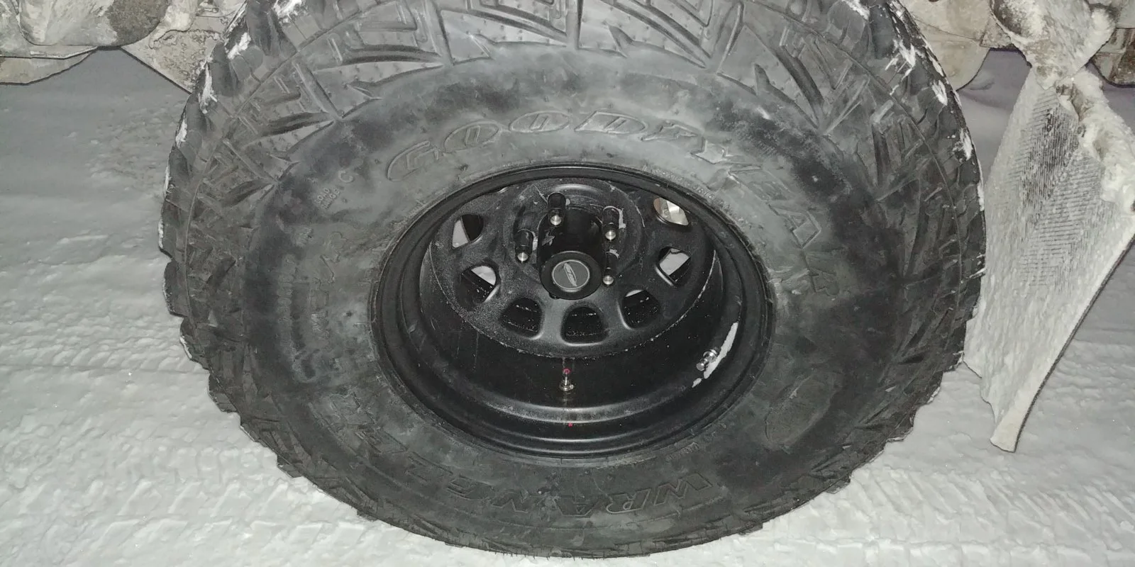

Just kind of an FYI if anyone decides to do the internal beadlocks by Coyote be ready for a lot of prep work to get the bead on the tires smooth so it doesn't cut into the inner tube inside the tire especially if you plan on running Goodyear MTR Kevlar. It takes a great deal of time to prep the MTR's.
On another note, I've been informed that the 4 out of the 5 are ready to go on my jeep finally. The 5th beadlock was missing some pieces (called Coyote in California to get these pieces sent to me) but I was also able to find the pieces that are missing locally (parts have been shipped already from Coyote).
I'm hoping to have the new shoes on my TJ tomorrow as long as they don't run into any problems.
I'll keep ya posted....

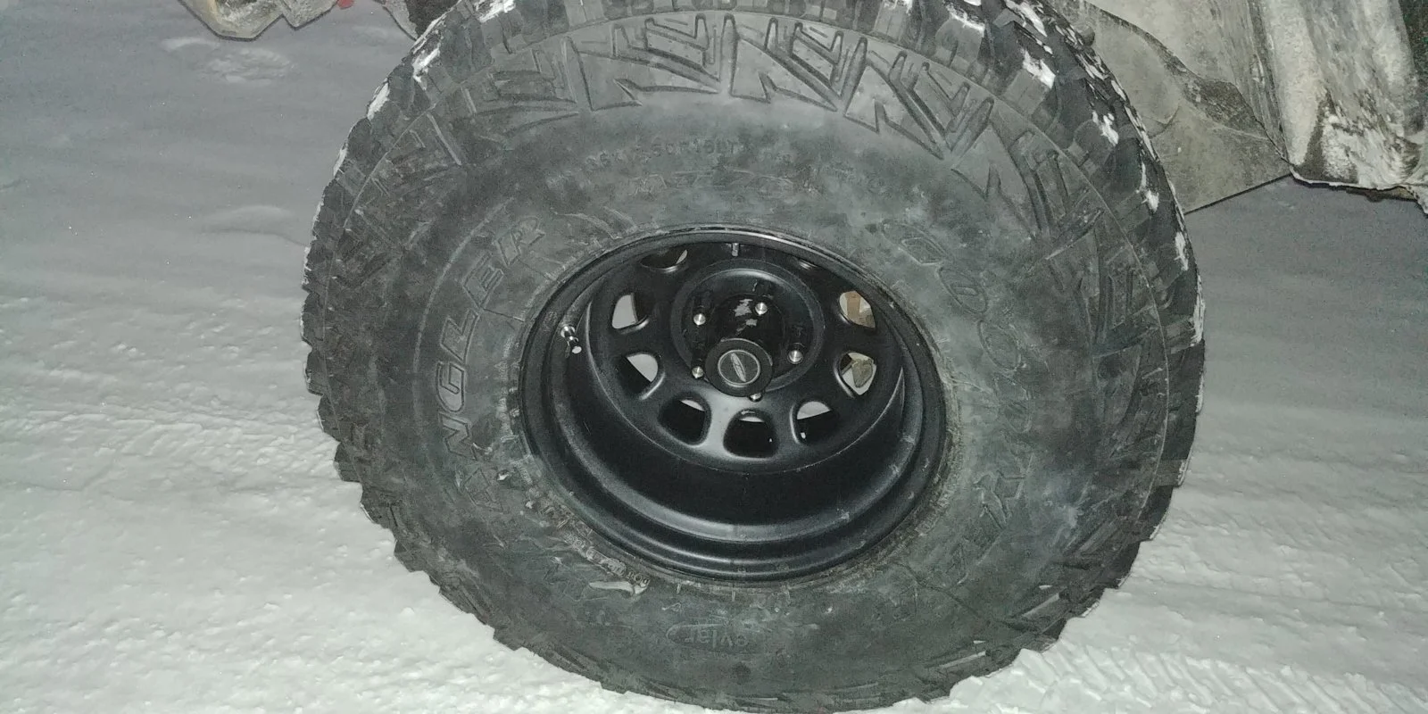

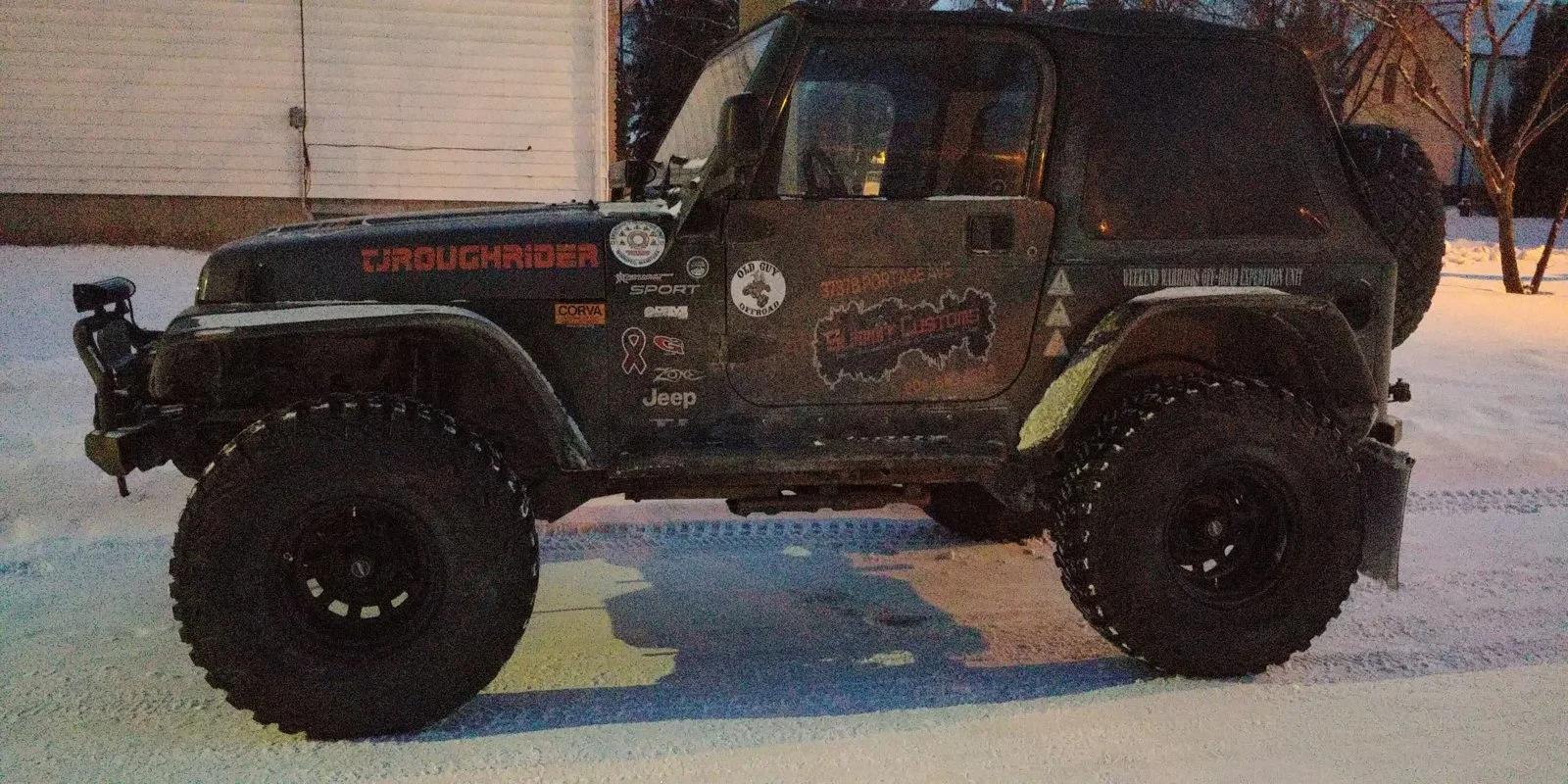

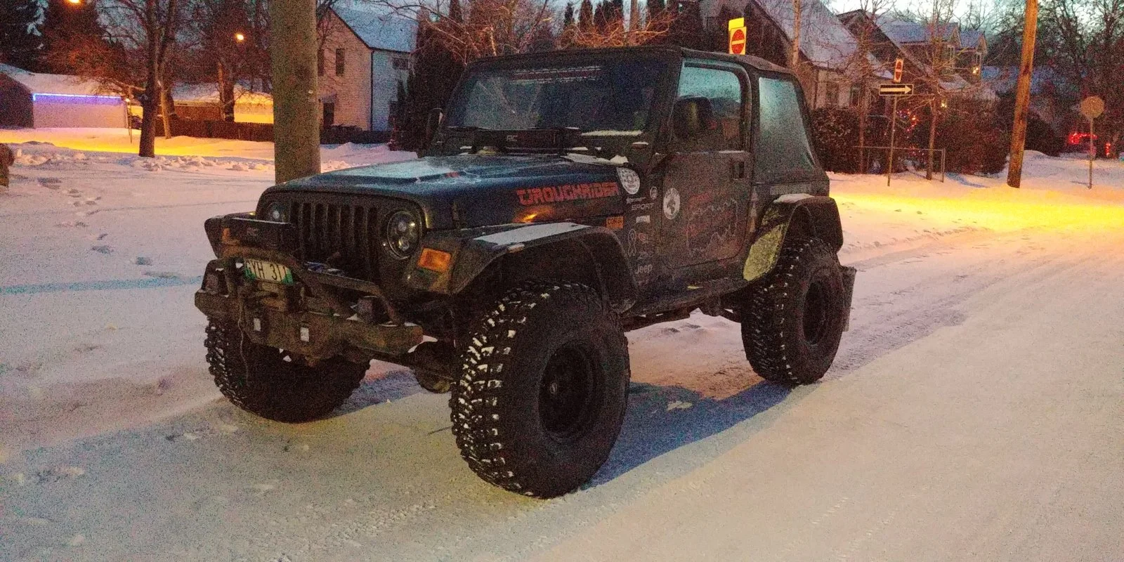

The day has finally come....
New boots on the Jeep.
Well all parts are in now, now the fun begins of installing it all. The deadline to have everything painted & installed is March 13th (March 14th the latest).

Damn those tires are huge!
You're going all out with this thing, huh? Do you daily drive it?
