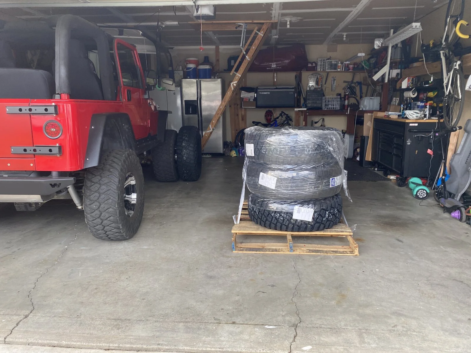

@glwood and @Ryan Thomas . There are trails around here that could use 33's. You don't have to take them. My wife loves bigger tires. She says do it. She even said 43"s on one TJ were not too big. I know she doesn't understand all that would be involved to go 35" or bigger, so 33's would be it for me. But I was just wondering how you guys with 33's felt, bc some implied you didn't like them and some (@Nashorn101) are trying to go back down to 31's and I'm right at that decision point. Appreciate the feedback...
I went from 31s to 33s and never regretted it for a second.
