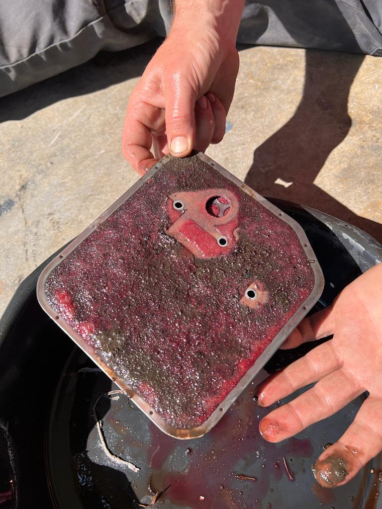

Found some mud in the filter

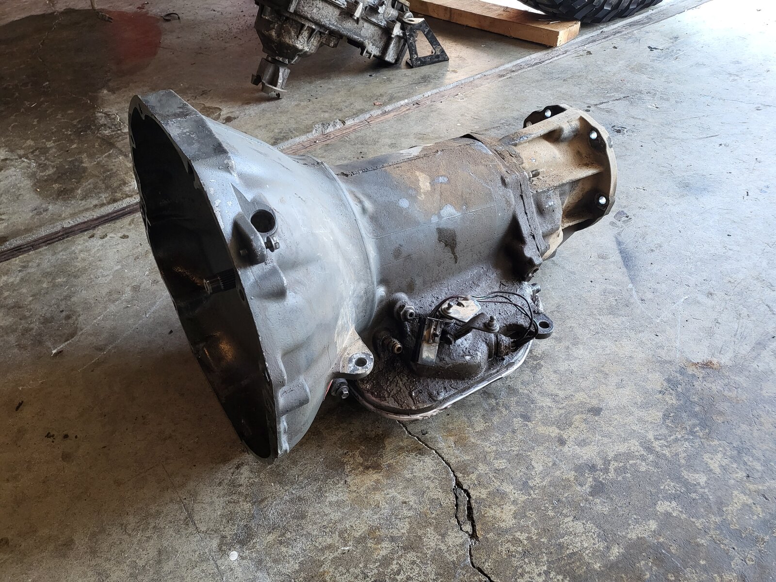

Let the journey begin! She is out and ready for an operation

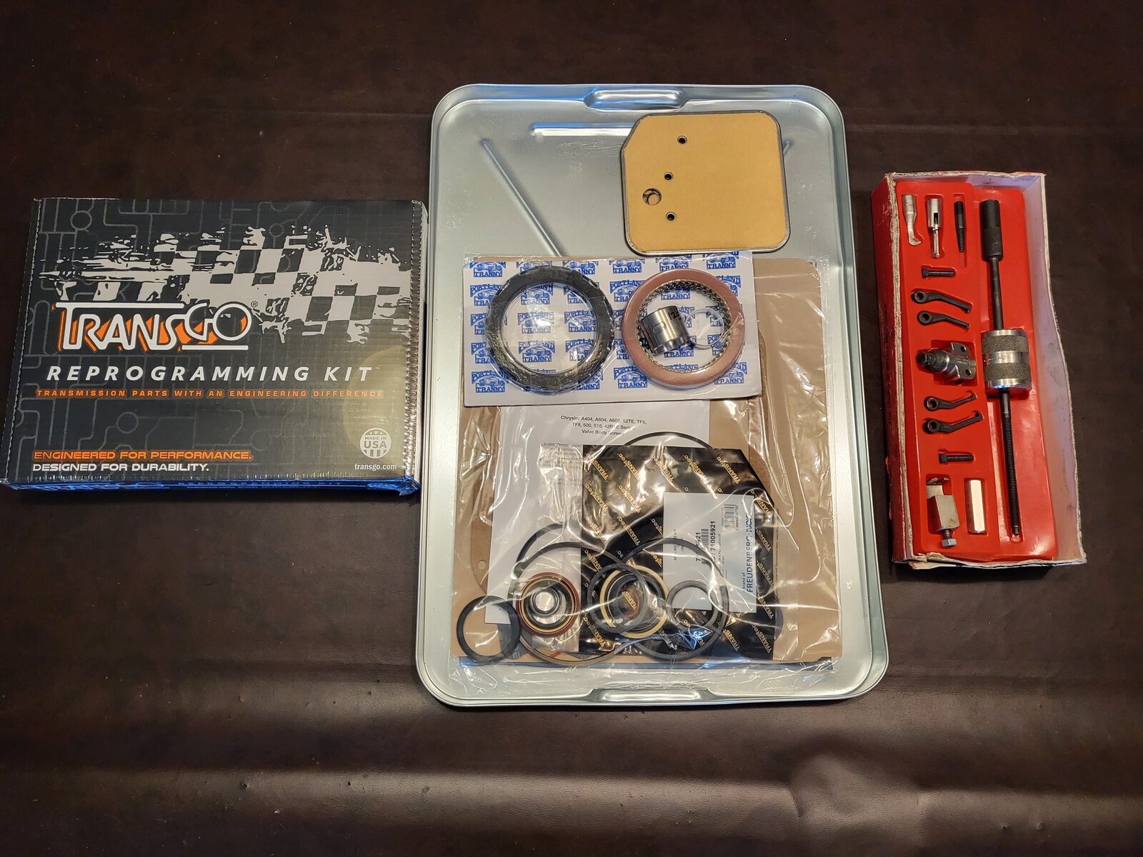

I got the rebuild kit from Oregon Performance Transmission, Kit # OPT-A904-RBHP "A904 HP Rebuild Kit A998 A999 Master Banner Overhaul Automatic Transmission Dodge Chrysler Jeep".
https://www.oregonperformancetransmission.com/product/OPT-A904-RBHP.htmlThis HP transmission overhaul kit comes with the following rebuild parts:
  • Raybestos HP Red friction clutch plates
  • Alto black Kolene steel plates
  • Kevlar intermediate kickdown band
  • Internal fluid filter
  • Pump bushing
  • Output shaft bushing
  • All rubber clutch piston seals
  • All paper gaskets
  • All O-rings
  • All metal clad seals
  • Teflon and steel sealing rings
I also got the Transgo TF-2 shift kit. And I am trying to source a torque converter from Pro-King CR69 with a 2300-2600 stall (this torque converter has an offset bolt pattern so one of the flex-plate bolt holes needs to be elongated slightly to work. Not a big deal as I have already modified mine for this TC.) Pro-King CR90 is a direct replacement.
Oregon Performance Transmission was about the only place I could find the pump gasket. I'm super excited to see this happen.

I have been looking at rebuild kits all over the place and I came to the same conclusion about Oregon Performance. I like the kits and I also like the add-on checkboxes for things like the reverse band, bushing kit, etc. Let us know what you think once you get it, and how everything goes together, and of course how it all performs.
I don't need or want a higher stall converter, so I'd like to either have mine re-man'd or buy a re-man. I'm not sure who is reputable to deal with for this yet, I'm still searching.
Edited to add:
In looking at the "HP" kit, they only list applications up to 1999, while the "non-HP" kit of the same part number otherwise, lists applications up to 2003. I have an 02, so I have contacted them about any possible differences, though I'd be surprised if there are any.
I like the HP kit with the raybestos clutches and kolene steels.

Will definitely keep you all updated as I go. I just got my slide hammer, some gnarly lock ring pliers and the kit will be here Friday so hopefully I will be tearing down the transmission this weekend.
The Pro-King CR90 is a direct replacement for the TJ with the stock stall. I used the Pro-King CR69 for about 3 years and had no issues so I would assume their CR90 will also work well. And they're cheap, about $130!
As for the rebuild kit I would be seriously surprised if this same kit didn't work on an 02 but please keep us informed on what OPT says.

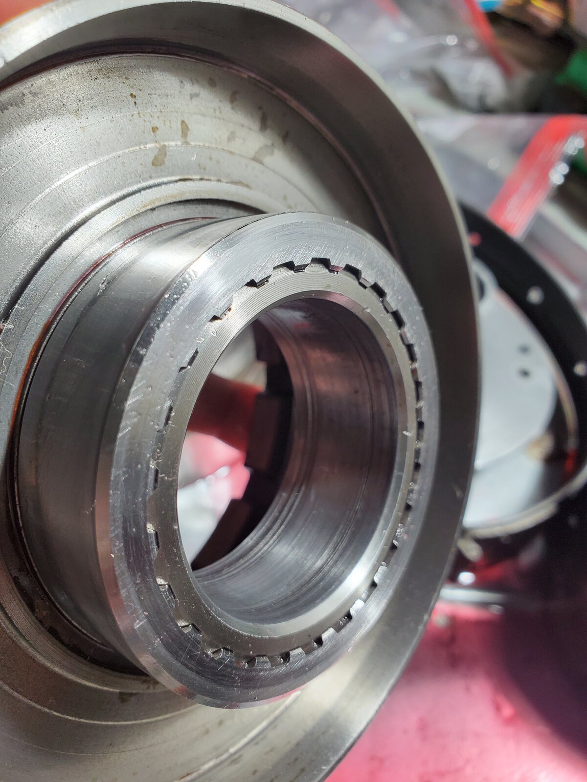

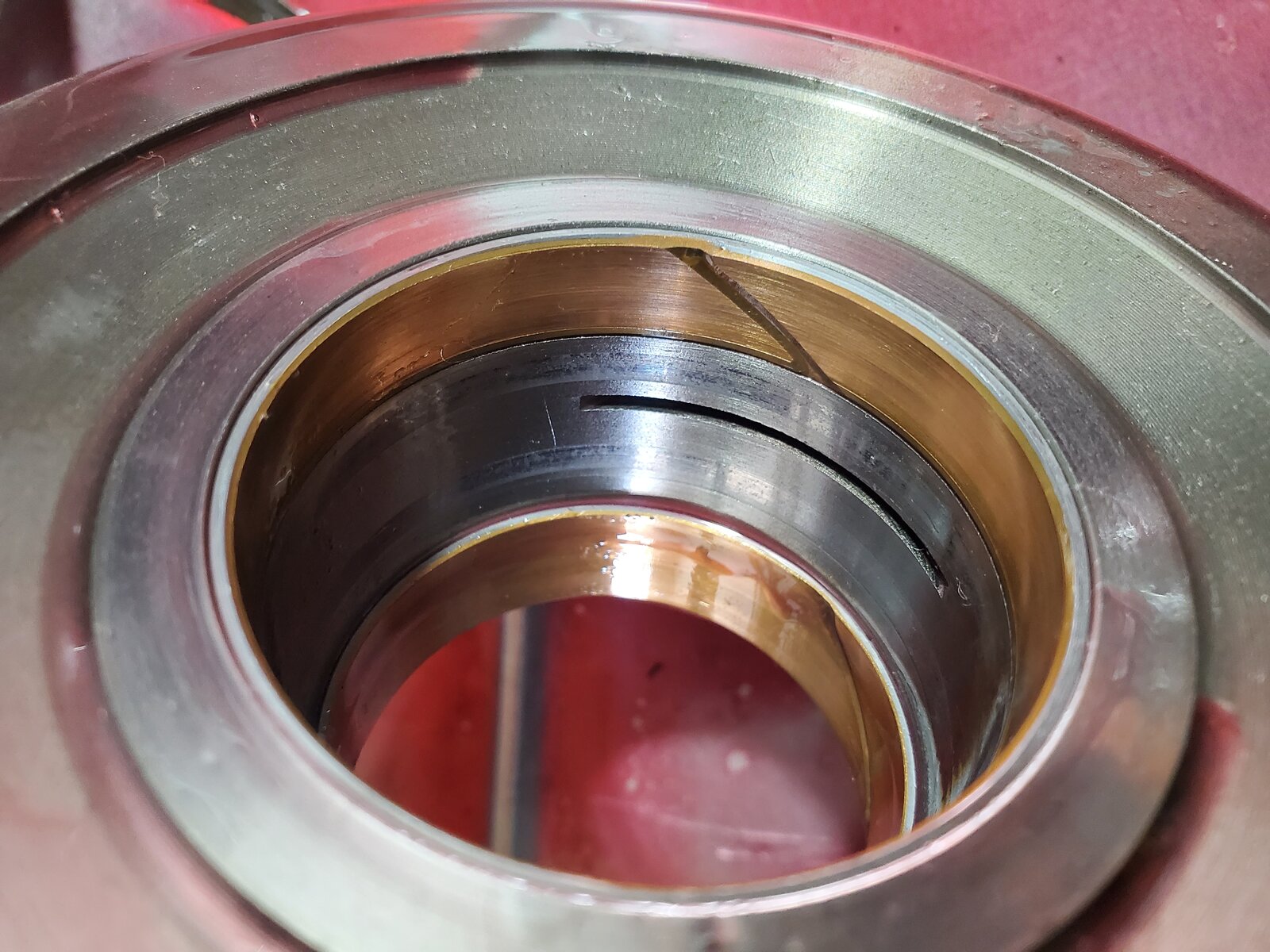

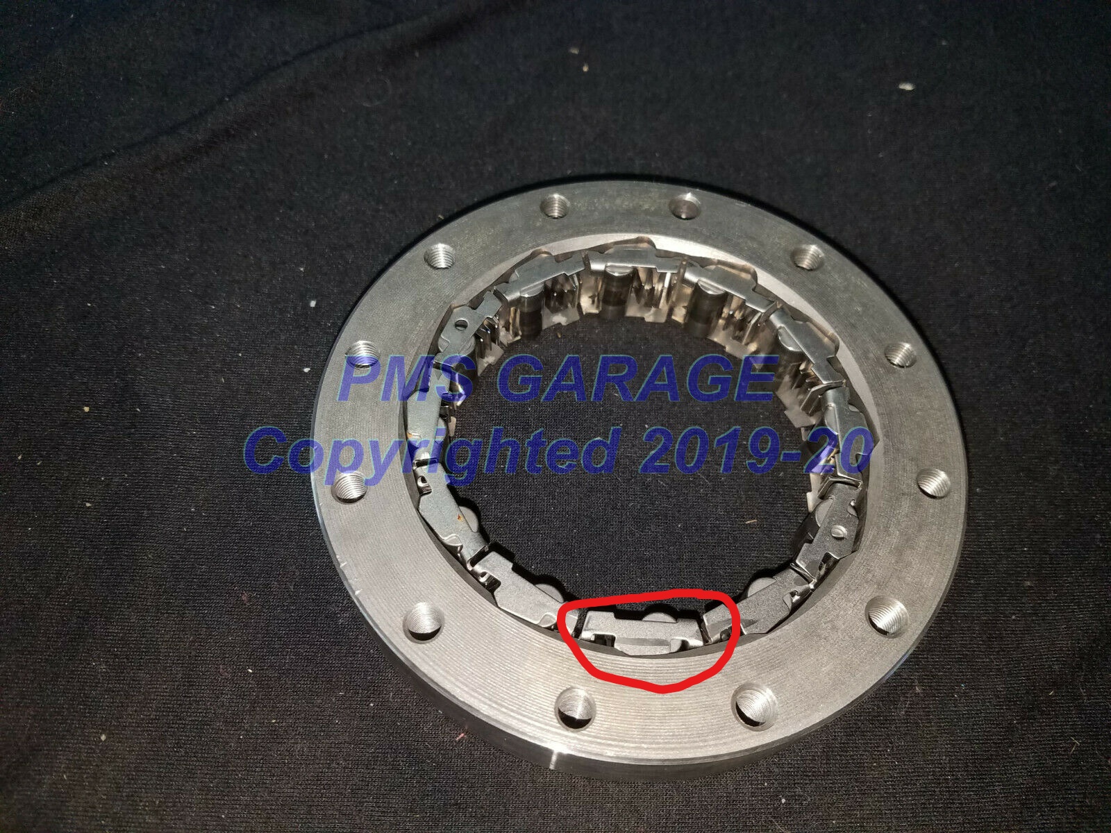

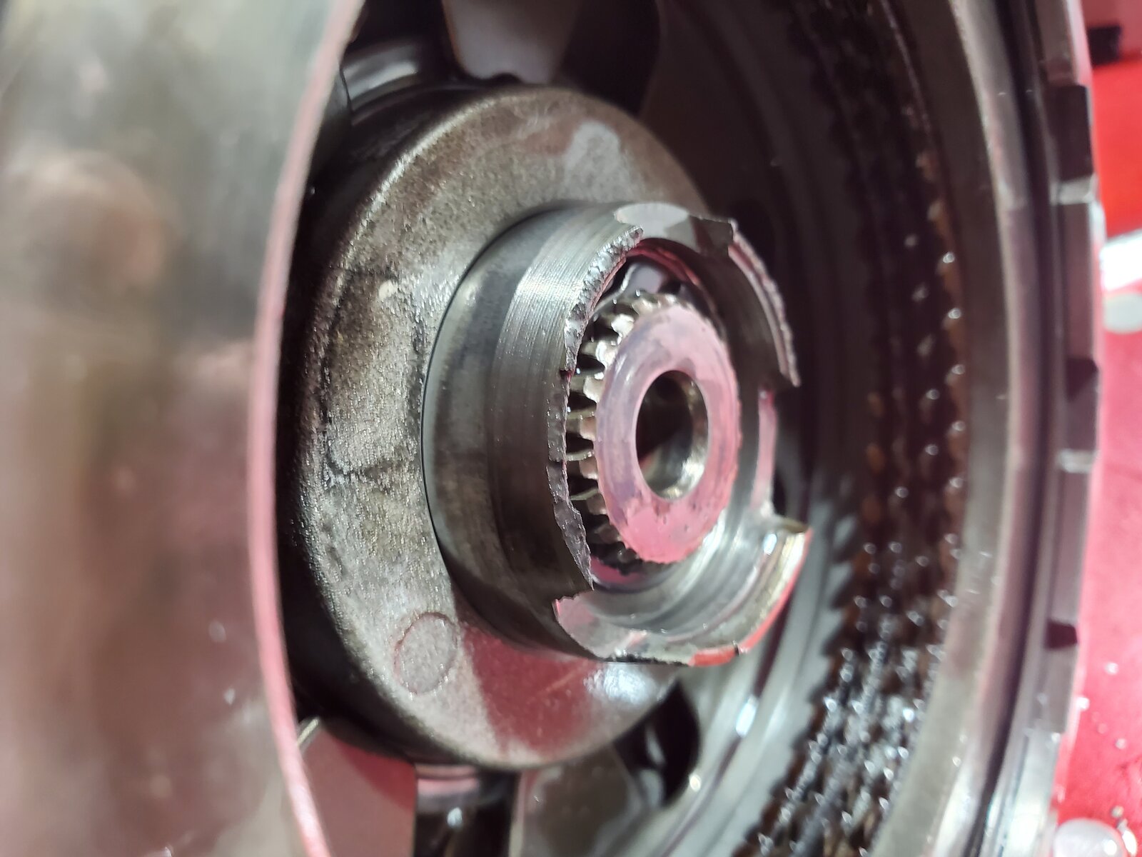

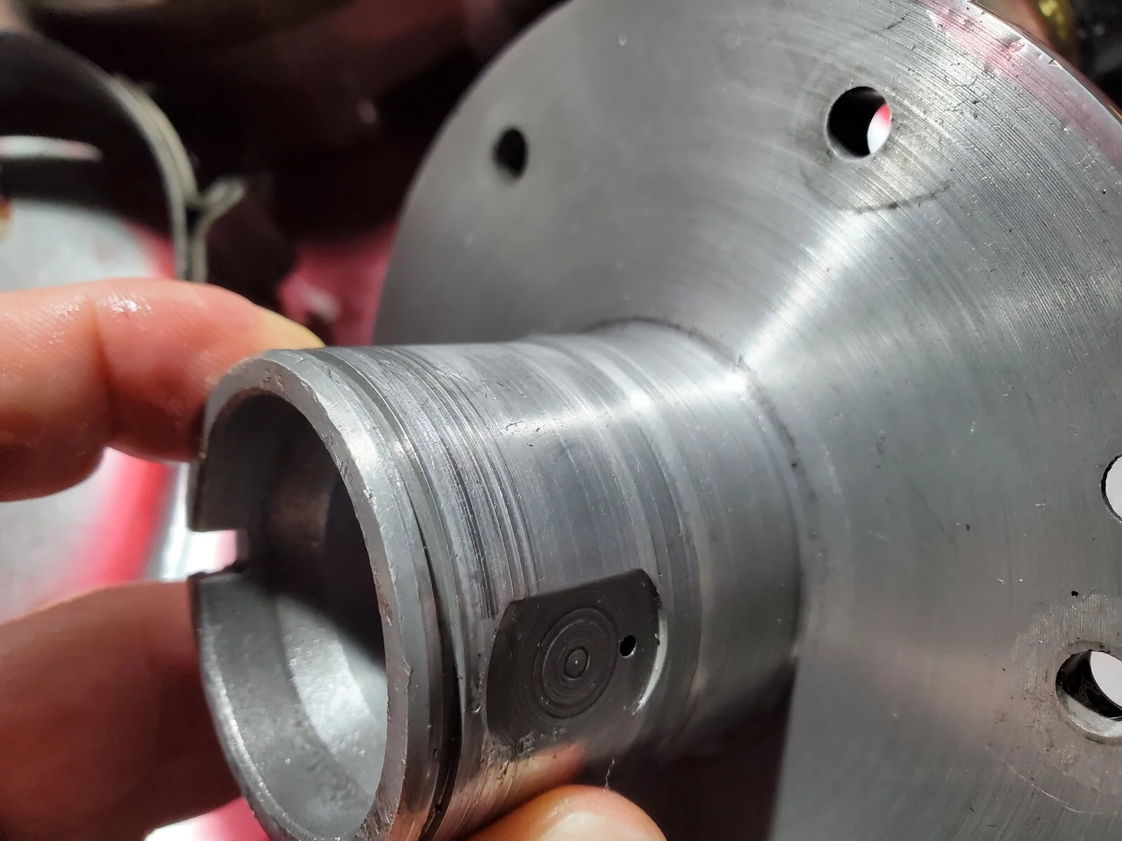

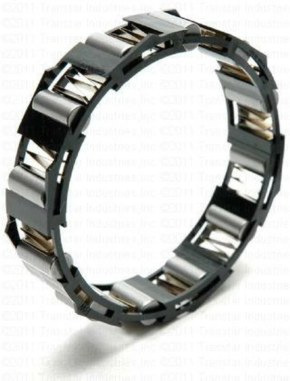

I did start to wonder how I could have all this destruction without any signs of metal shavings in the pan or on the magnet. Then I found a very telling little piece of metal wedged into one of the clutch assemblies. It was a piece of the metal cage that holds the overrun clutch springs and rollers together, but the overrun assembly I have in my transmission is the newer style with a plastic cage. So how the hell did I get a piece of an overrun assembly that isn't even installed on my transmission? Then the light bulb went on... The MF'ers that rebuilt my transmission last did a nasty hack job and didn't even bother cleaning out the broken parts from original failure or replace the other broken components in the transmission. Then I notice a "Jaspers Engine and Transmission" sticker on the side. SOB! Jasper has a 80+ reviews on BBB with a 1 star rating. Complete hacks. At this point I am glad I sucked in water before this thing grenaded from the terrible rebuild it got.
I found a piece of this:
But the one installed is plastic like this:
Damn, I'd installed a few Jasper transmissions and engines in rigs when I worked at a Ford garage. Good to see all the shit talking we did about them was warranted. Can you get it hot tanked anywhere close to you? Might be worth it to try and clean it as good as you can.
