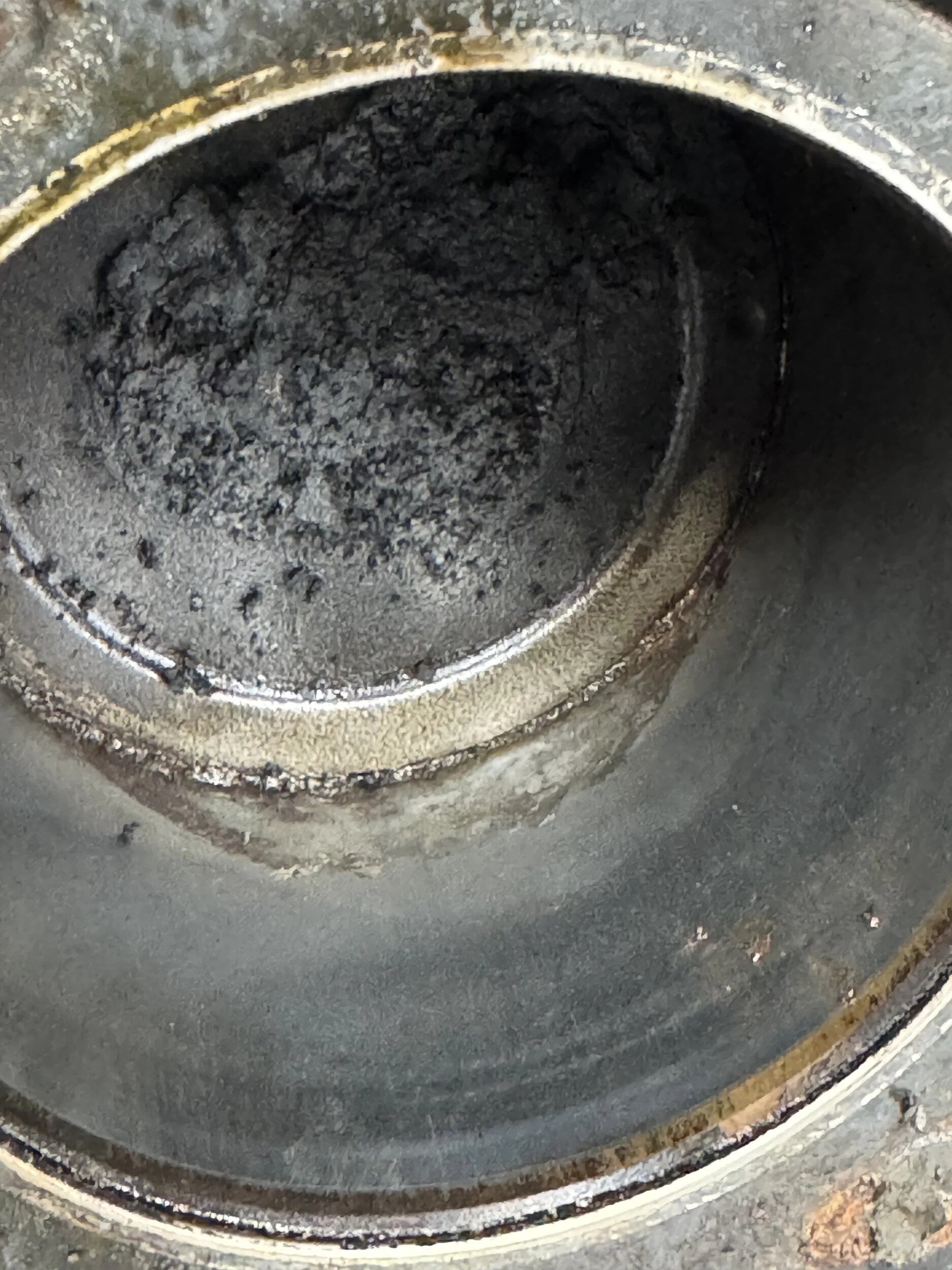

You had water sitting in a bore? Same thing happened to my 6.0l.

Well, the 4.8 was ran for a race season and we determined today it spun two rod bearings so back to the drawing board… or do as you say and use my crank and rods (if good).
Check the 4.8l block, if the bores are good you have a block at least. "Race season" and "spun bearings" make me wonder though. I know a couple guys who have trashed cammed 4.8's treating them like 2 stroke motorcycle engines

Bores are reasonably good from checking. I have seen this engine race multiple times, I am familiar with it’s life.
My 5.3 also at least spun two rod bearings so it is also a boat anchor. Going to look at another short block, if it doesn’t pan out I will likely order a crate engine (5.3 reman).

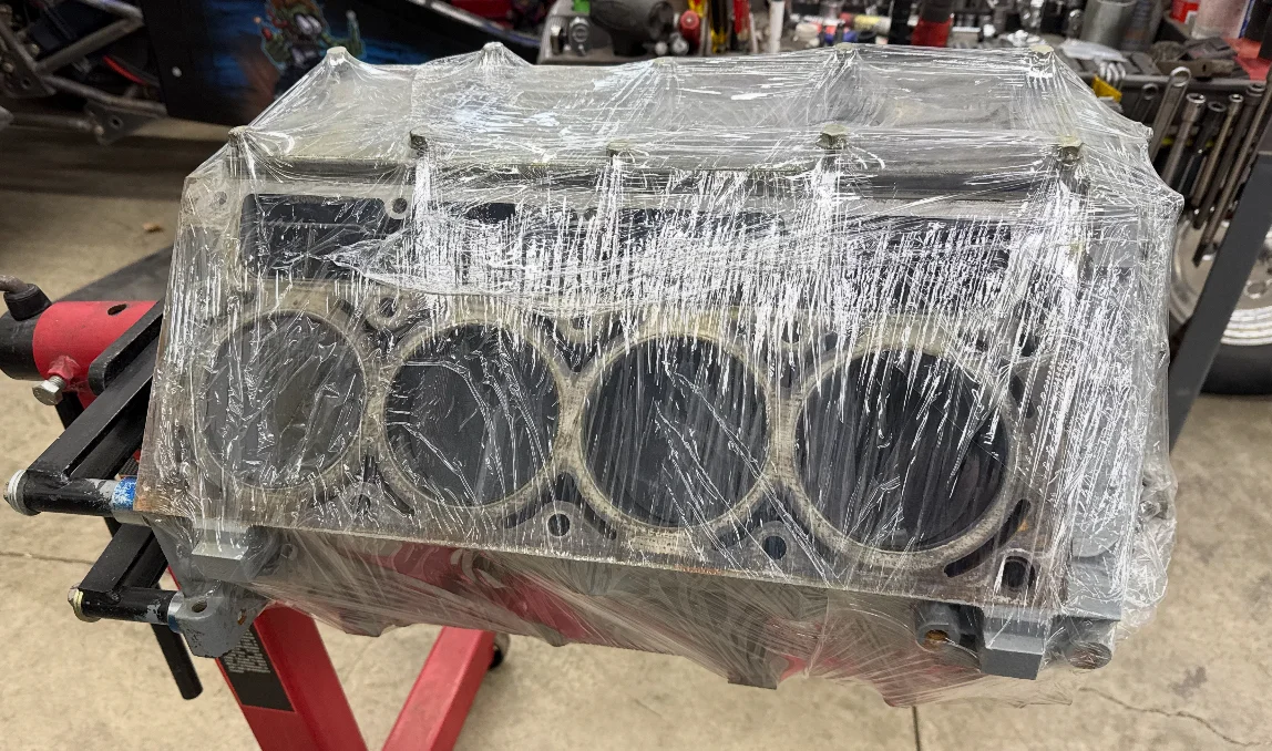

Ended up picking it up, 4.8 short block. Bearings look good, bores are pretty good. Debating new rings and honing or not. Obviously new seals throughout.

4.8. Spun rod bearings on 5.3 crank means machine work (if it can even be saved) and new rods. Ill just run a 4.8. Debating a small “towing” cam.
