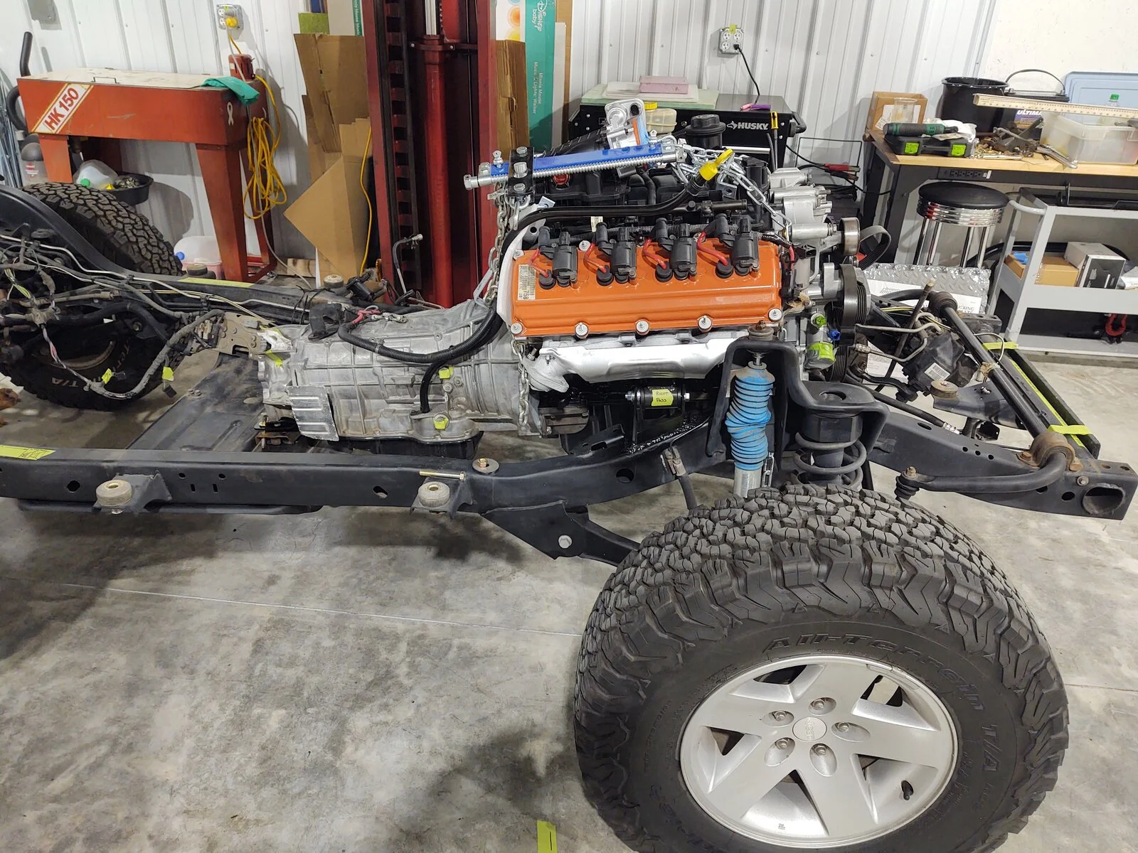

Still sitting at this stage right now waiting on some parts to come in to build a transmission cross member.

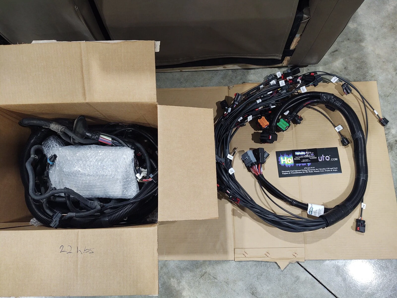

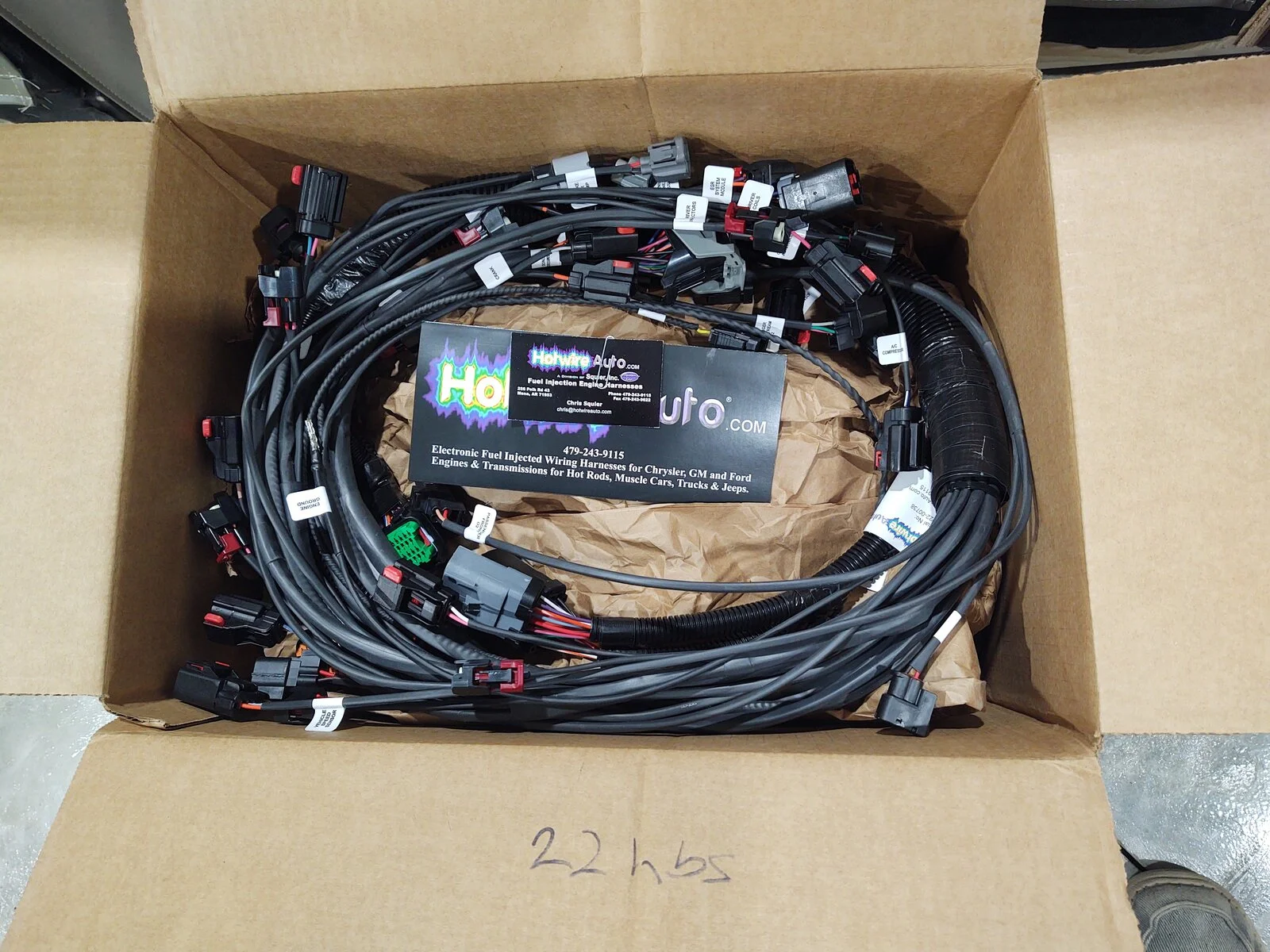

So out of nowhere I received a notification from UPS that my harness is to be delivered today.!!
Definitely not ready to install it yet but am very happy to have it for when I am.
Hotwire turned it around about 6 weeks quicker than they quoted me.

You send them the engine harness and trans harness along with the fuse box. It comes back with everything labeled and ready to go how you see it there.

I went with Hotwire for my current build for a 6.1 and a 8HP70. I couldn’t be more impressed with the quality and ease of install. I ordered it in September and got it in November, 4 weeks ahead of est.
