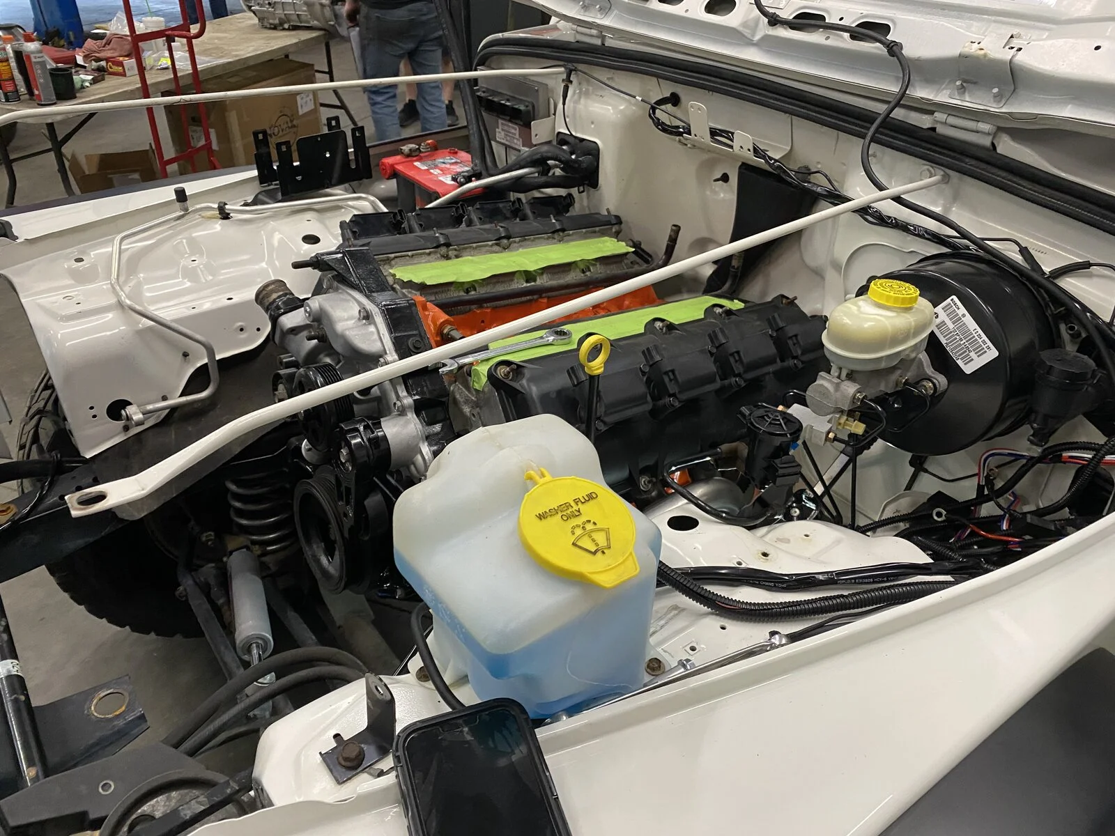

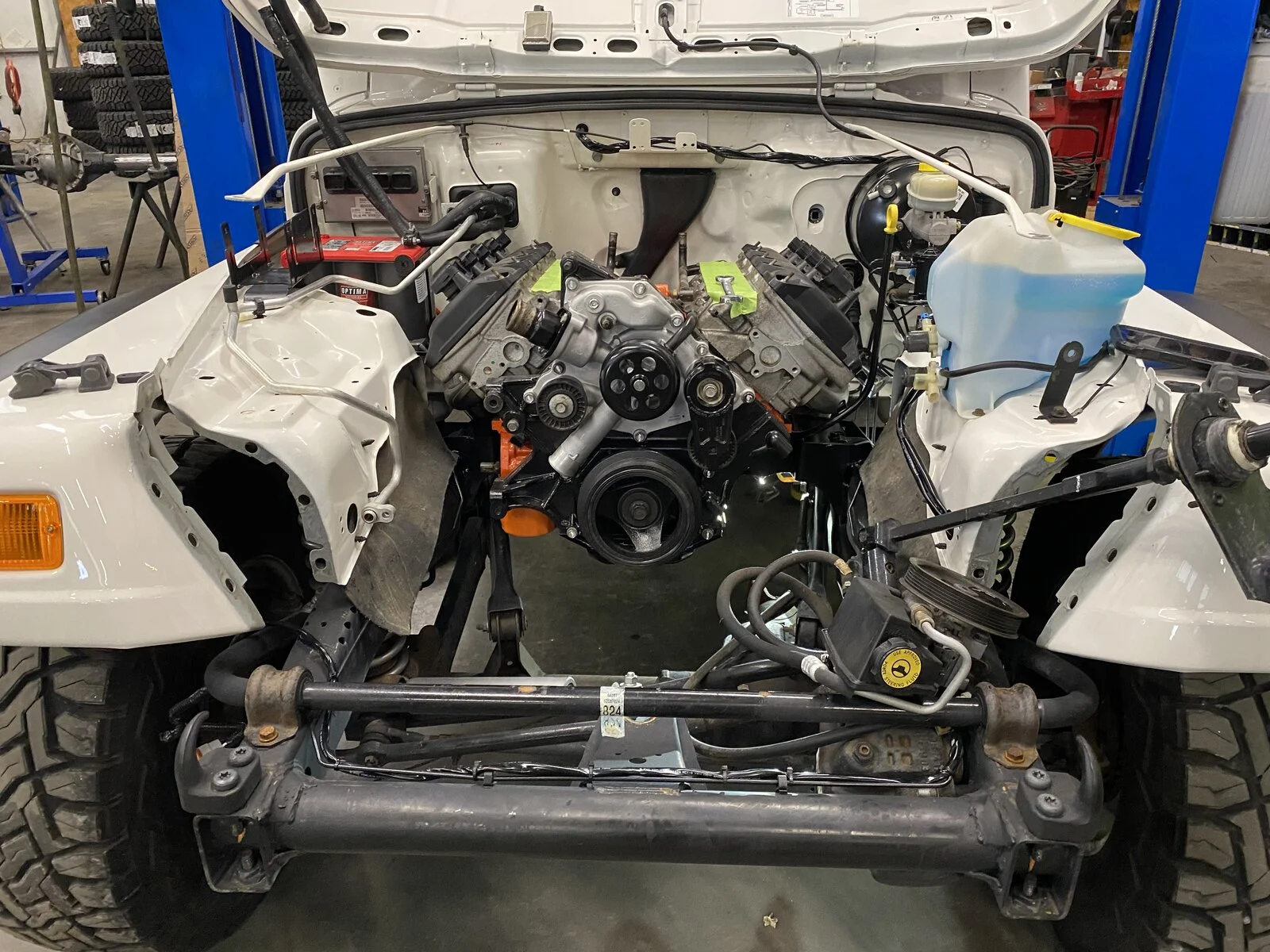

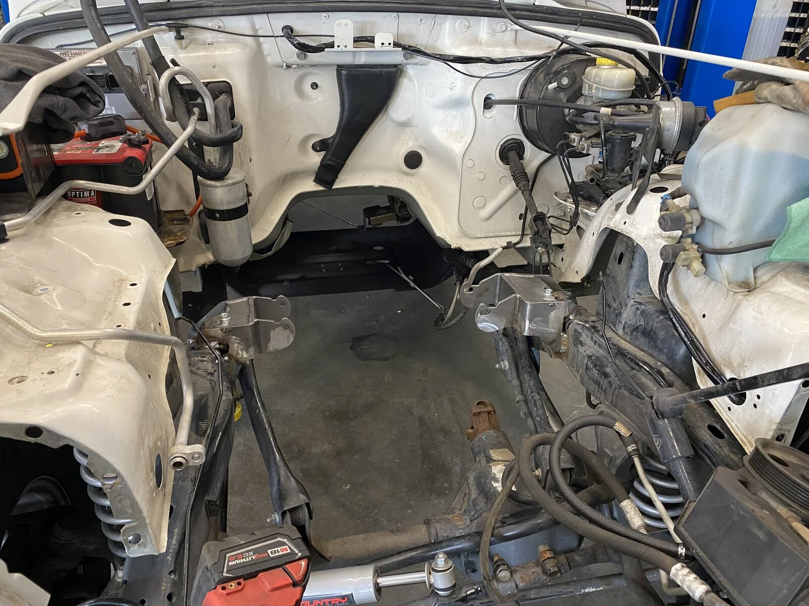

Here we go!!! So got bumped a day on getting pulled in for assembly. But they got started on it this morning. Motor mounts are in and quite a bit of wiring done. Doesn’t look like a lot but plenty has been done. Realized we were missing a bracket for the steering column but it won’t slow progress and it should be in within a couple of days. Modifications on some accessories that need to be made are getting done now and chances are the motor and transmission will go in for the first time tomorrow so we can see where everything is and if any adjustments need to be made. I told one of the guys that I honestly can’t believe it’s finally happening because this is something I’ve been thinking about for the last 15 years. Hopefully within a week it will be finished and running and on its way to Injected Engineering to get tuned.
Looks good...
I'm sure they already know, but if not, the AC accumulator can will definitely have to be removed before the HEMI will sit in place.
Easier to remove now without the motor in the way.

Yup. They moved it about 5 minutes after I took the picture.

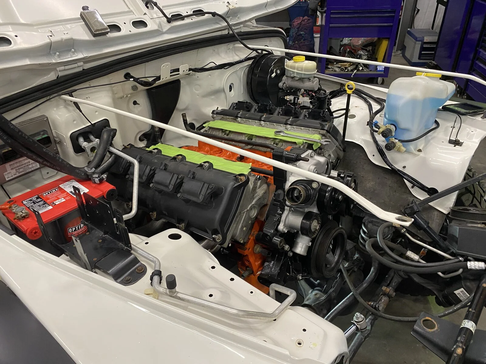

Motor is in! Cleaned up the engine bay before dropping it in. At this point it won’t need to come out again unless something were to come up along the way. Bell housing is mounted up on the AX15. After the first test fit, the gearshift arm is a little bit forward of where the hole is in the center console. They’ll have to make a small bracket to adjust for it, but it won’t be an issue. None of us remembered to find a fly by wire gas pedal so I’ll have to find one at a junkyard, but it shouldn’t be an issue. A little more wiring was done also. Once all the main parts are installed, things will appear to come to a halt since you won’t be able to see much getting done visually but they’ll be making all the AC lines and piping for everything. Dang near brought me to tears seeing the motor mounted up when I walked in!

Looks good in there.

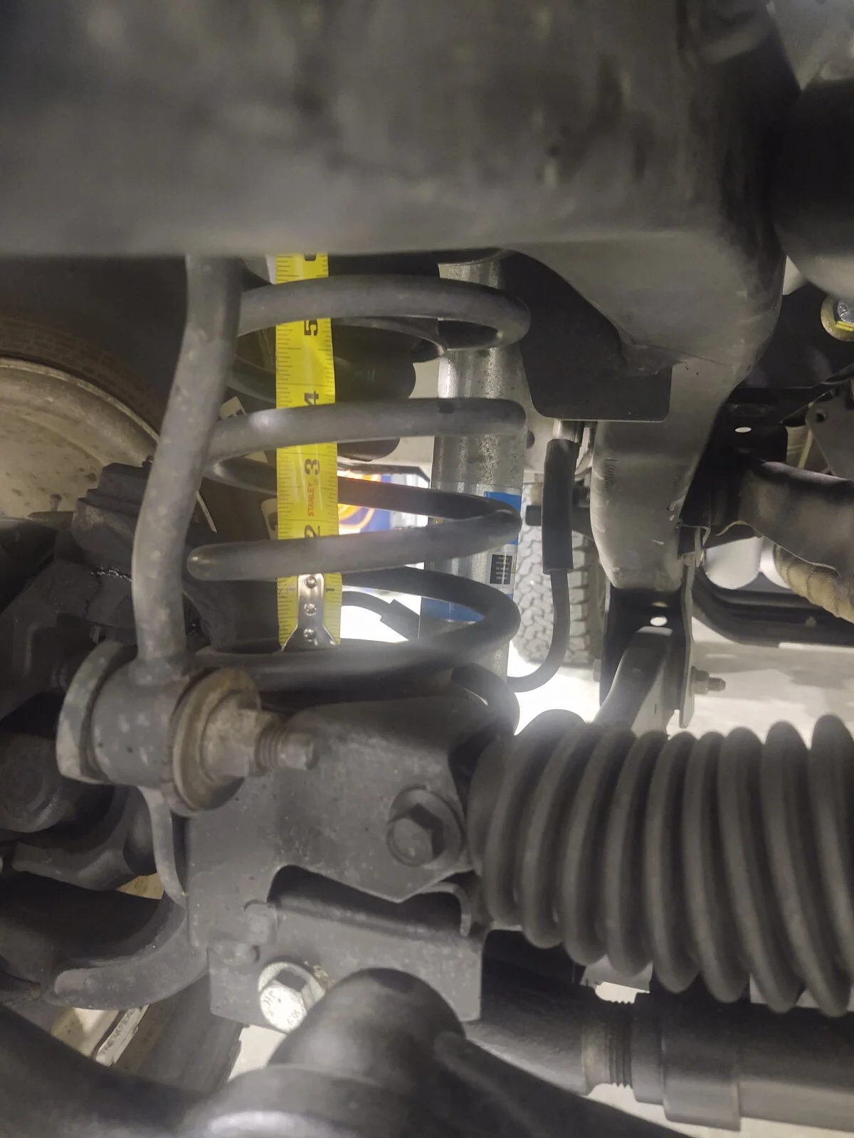

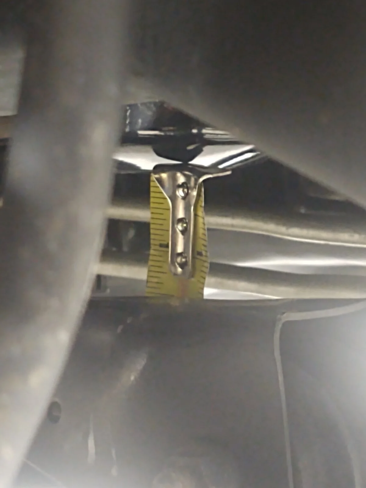

I rechecked mine and I'm sitting at 3" up travel to bumpstop and 2" from control arm to bottom of filter. With the distance from bumpstop over to filter it won't have the full 3" of up travel, I'm figuring closer to the 2" range, but definitely not any extra clearance. Don't know that the 45° offset will give much extra clearance. Remote mount might be the best option for maximum clearance. I don't plan on doing much heavy offroading, so I'll just keep it in mind if I do any.
Pictures here show bumpstop distance 3" and control arm to filter distance 2".

NO! You have 5” of Uptravel … measure metal to metal. The rubber FULLY compresses …
Reactions: Jamison C
Yes, that is true on full hard uptravel. I just don't plan on doing anything that extreme with mine.
