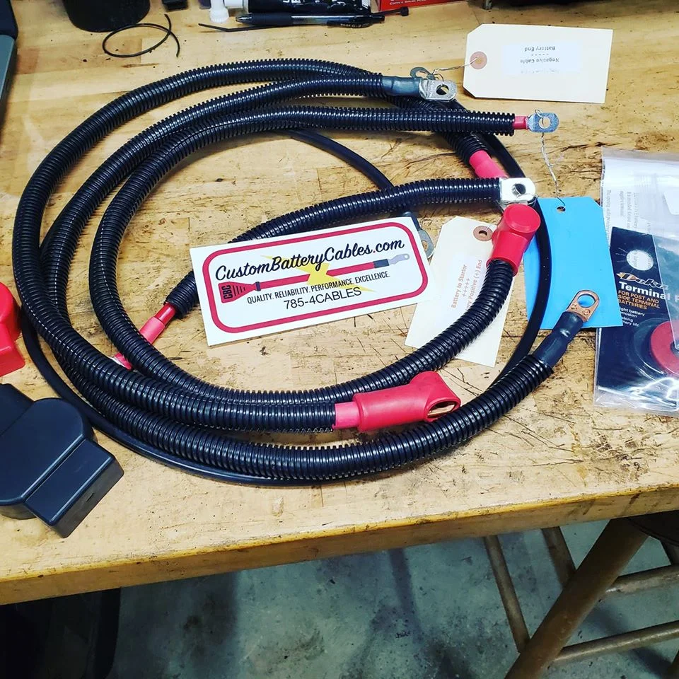

Started mocking up where some of the components will go on the new inner fender. Didn't make it very far.
