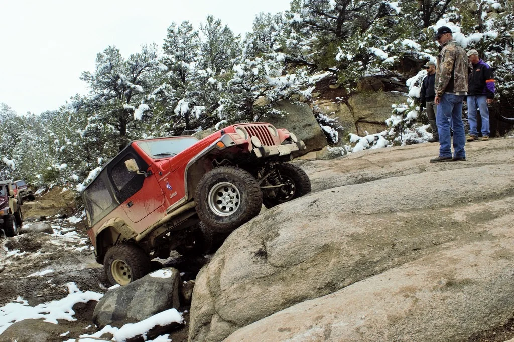

33s can go anywhere 35s can if you build it properly. Just like jjvw's rig. If I was starting fresh, I would look into the super 35 kit from revolution gear and axle. An 8.8 is not as cheap as some people make it out to be, plus the housing is huge, offset, and hangs lower than a 44 or 35. A hpd30 would also give you more clearance. Tummy tuck to get rid of the stock shovel, an antirock to keep you balanced and maintain traction, and lockers just like @jjvw mentioned. Until recently and aside from his mid arm suspension, we were built fairly similar and we hung with the guys on 35s. Careful line choice helps too.
