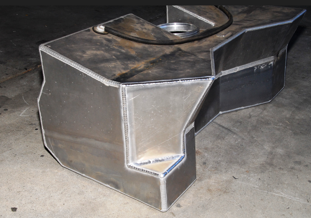

Beautiful. The farther I get into this hobby, the more I want to do everything myself. The welding on that tank would be a very lofty goal, though.

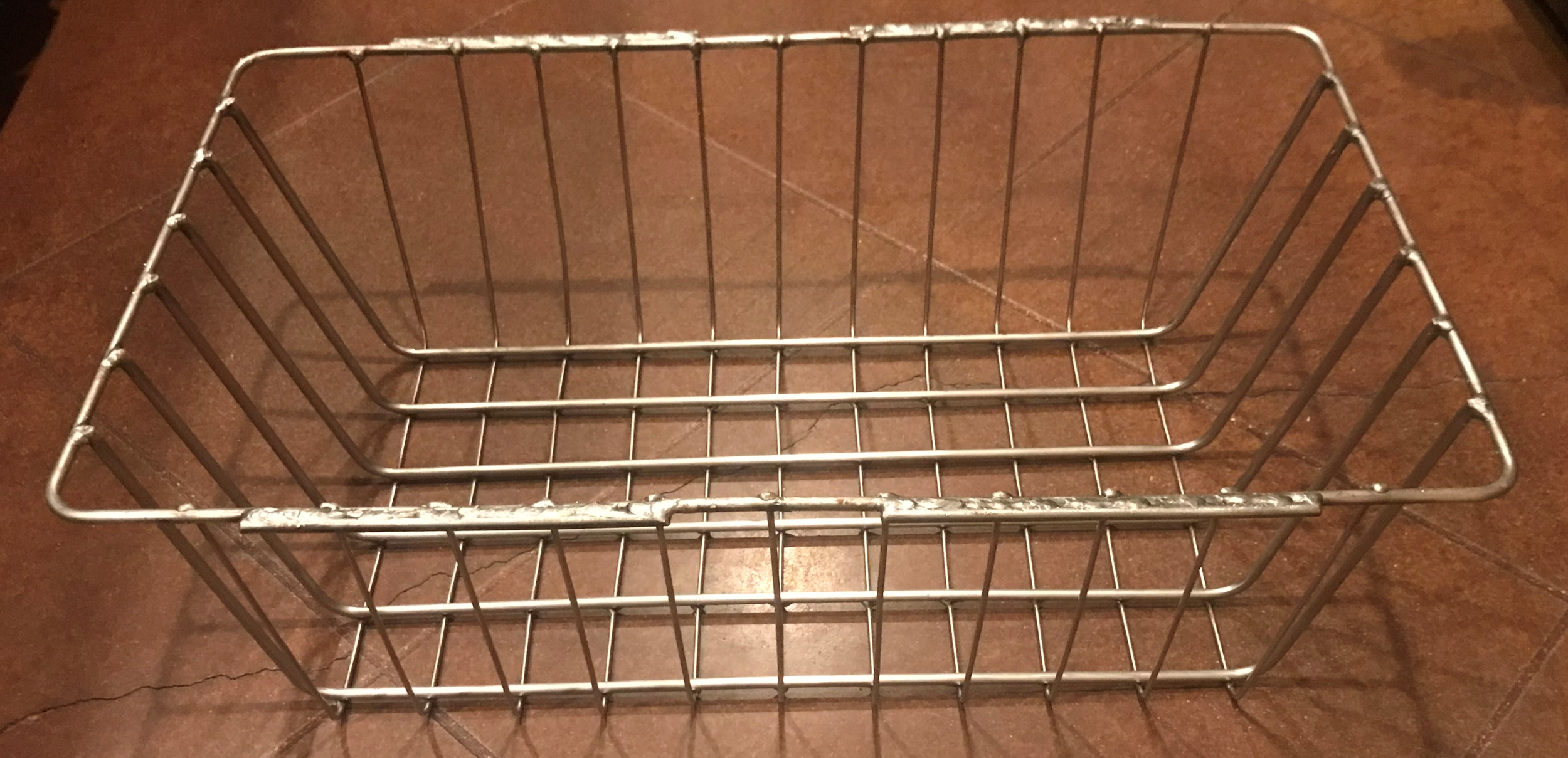

I have a 2 lb roll of stainless wire that I've used twice over the years. Like you, I also didn't want to buy another bottle, so I thought, what can it hurt to try on a simple project where failure is no big deal? I have a large Yeti cooler that I use to age small white-tail deer quarters in, so I built a drop-in cage out of small diameter stainless rod which was welded with normal 75/25 gas and stainless rod. It welded just fine, but corrosion was a possibility. I haven't used that cage in years, so I'll have to take a look at it. The last time I looked, the welds were not corroded. It's got to be going on a decade old now.
I built this cage in fall 2015, so it's about 8 years old and has been sitting on a shelf in the garage most of that time:

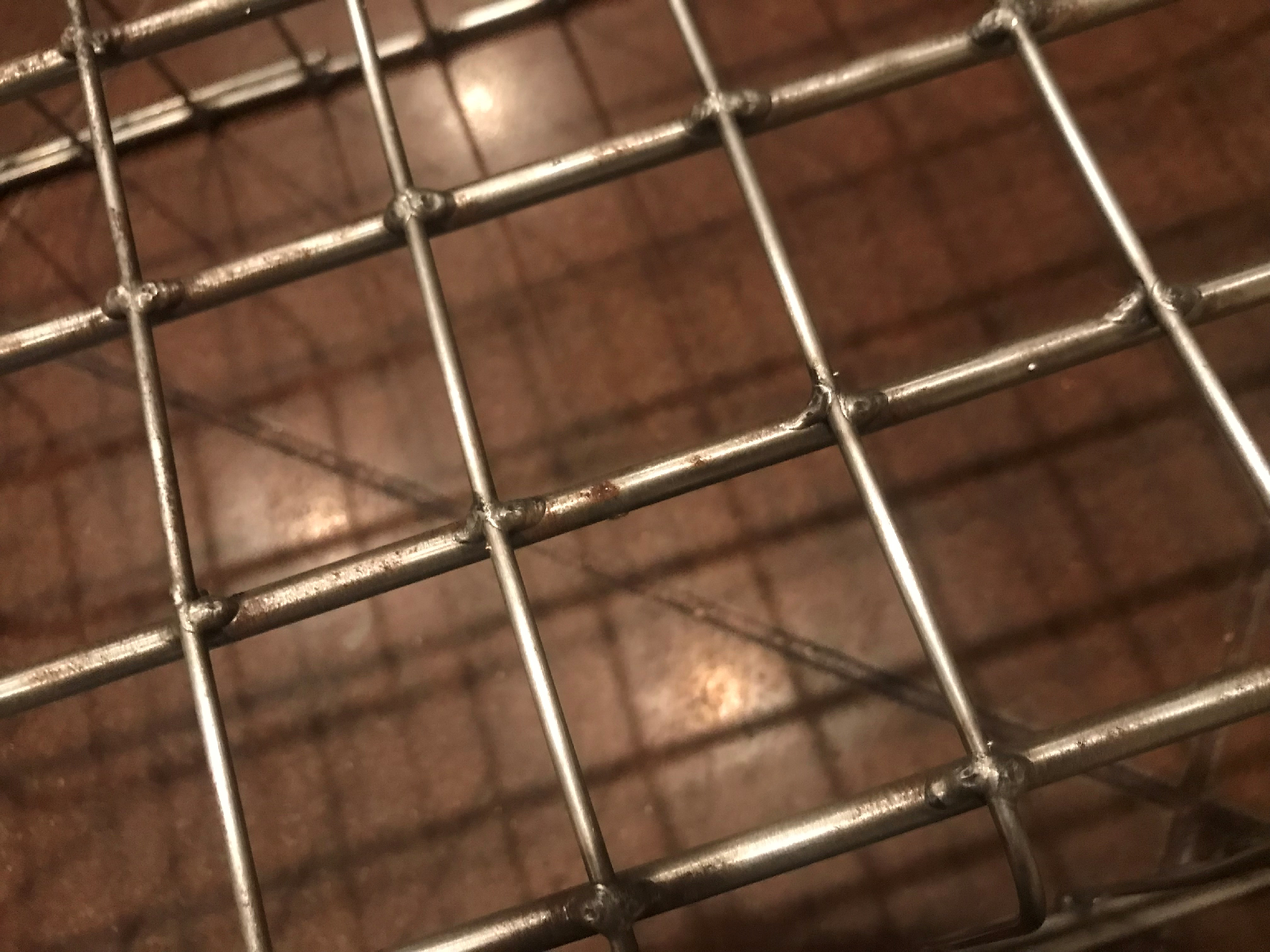

Here's a close-up of the bottom welds:
There's no more rust on the welds than on the rods themselves. The 75/25 gas was definitely not recommended, but for this application, it worked just fine.
