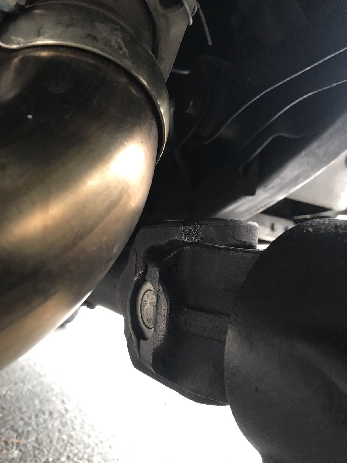

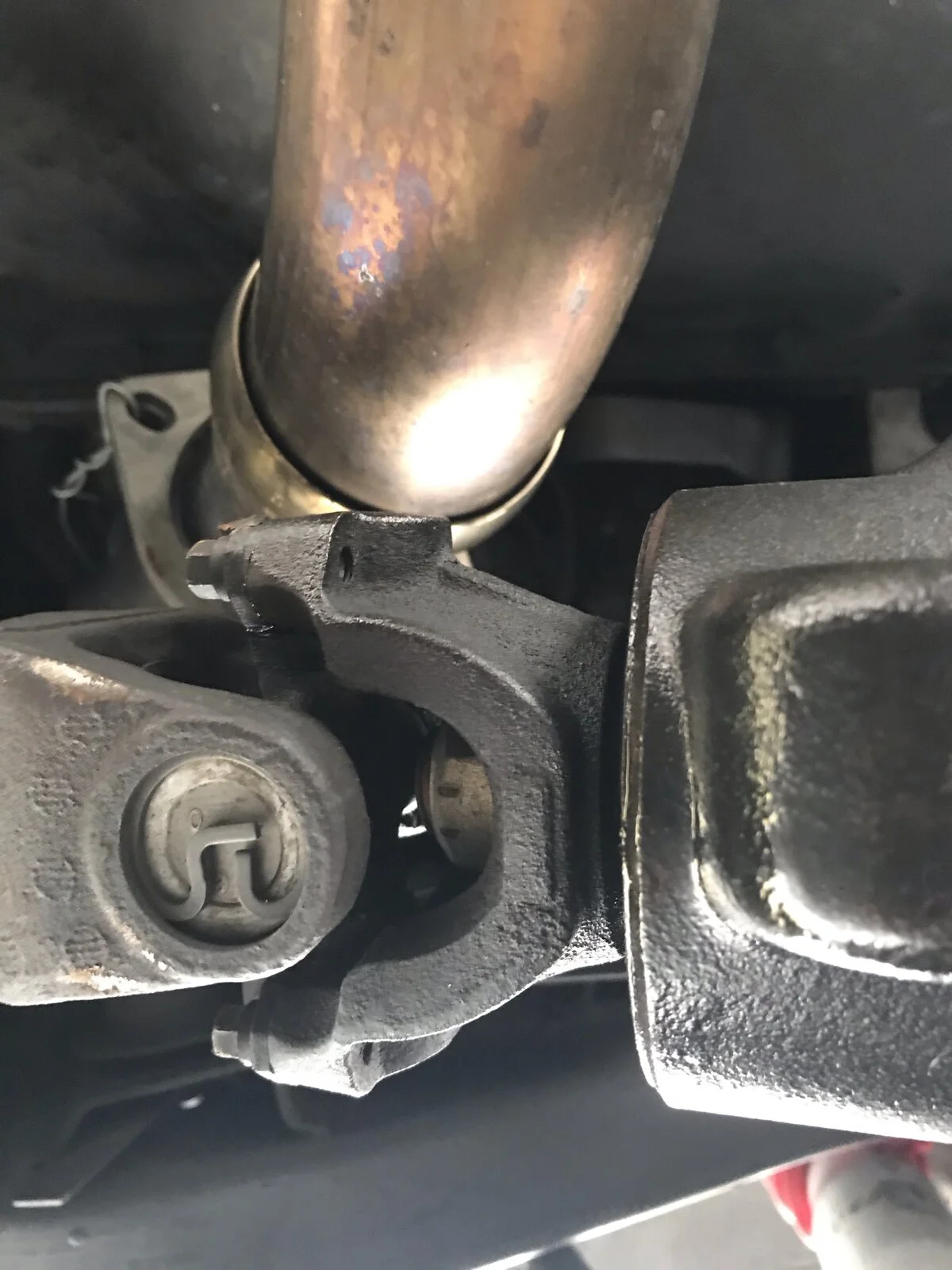

My stock TJ had/has clearance issues with the collector joint and the front driveshaft. I sent it back in and they put it on their jig and said it was up to spec. I ended up putting about a 1.75” lift on it and it still will get whacked by the driveshaft if there’s more than a little suspension up travel. I replaced the motor mounts also since they said that might be an issue even though mine weren’t too bad. It’s less often that I experience it, but something to consider. And I’m not talking about getting flexy off road either.
Reactions: SkylinesSuck
Thanks for the insight. I remember reading about that. That's why I was hesitant, I did call ARH and I didn't get his name. He answered some of my questions. I did pull the trigger on it, we will see what happens when I get it on. If anything, the driveshaft will beat into shape. How close is the distance now?
I used a ball and socket style exhaust connector instead of the factory one and it just barely clips it just enough to make a horrible grinding crunch when they bump uglies. I wired the stock clamp up and out of the way for now. I’ll have my muffler shop cut and weld so that the connection is up a few inches higher and it shouldn’t be a problem there. I’ve been waiting to do that until I replace my rear main seal. It shouldn’t have any issues clearing the pipe without the clamps.
I used a ball and socket style exhaust connector instead of the factory one and it just barely clips it just enough to make a horrible grinding crunch when they bump uglies. I wired the stock clamp up and out of the way for now. I’ll have my muffler shop cut and weld so that the connection is up a few inches higher and it shouldn’t be a problem there. I’ve been waiting to do that until I replace my rear main seal. It shouldn’t have any issues clearing the pipe without the clamps.View attachment 244102View attachment 244103

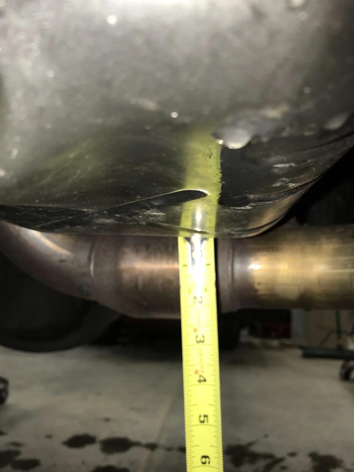

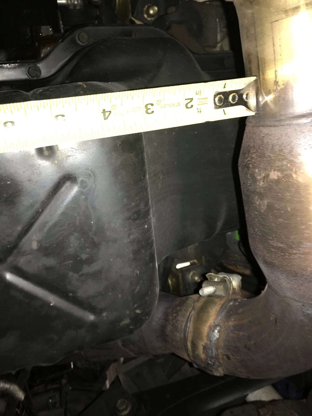

Can you post pics from the front showing how low this thing hangs down around the oil pan?
