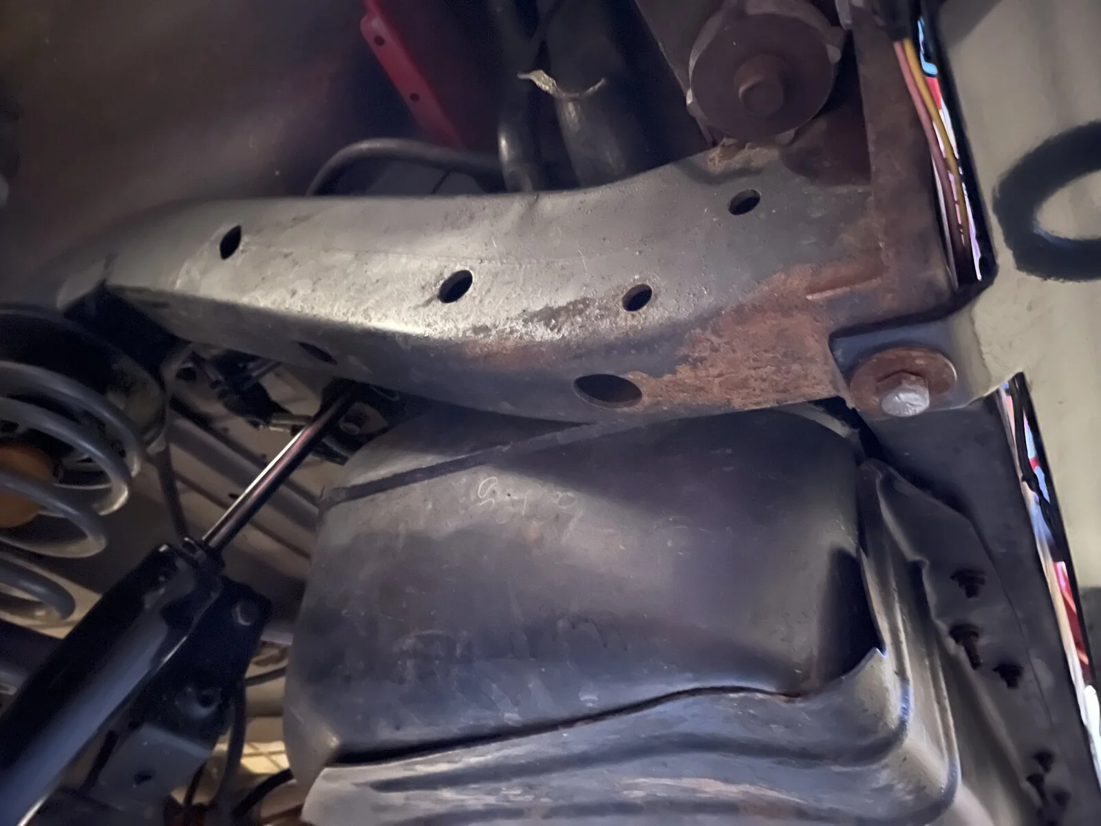

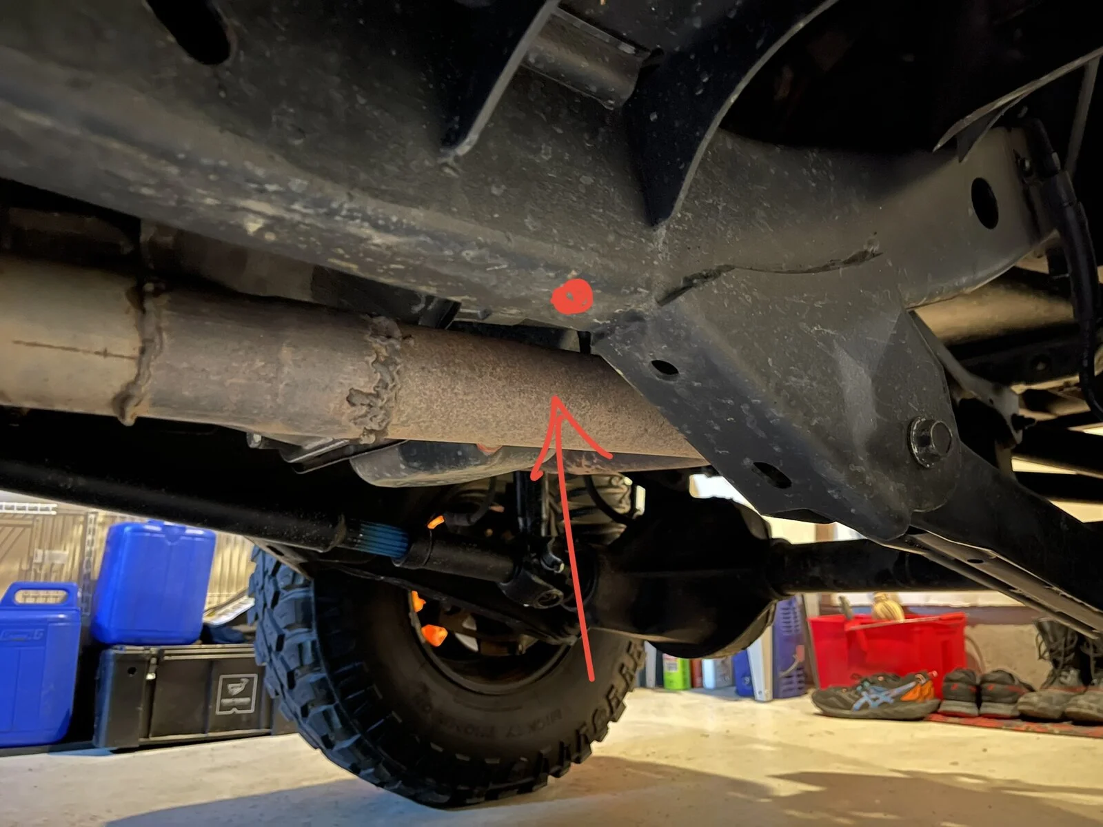

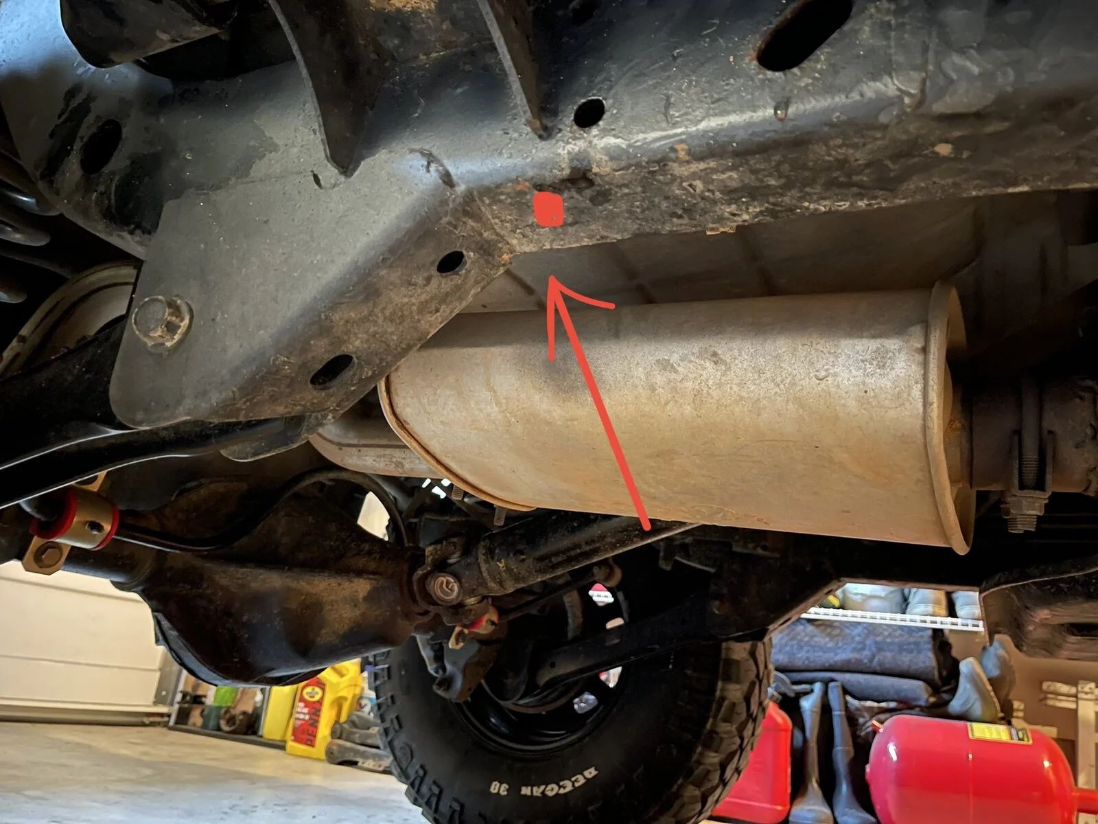

I’ve read a bunch of threads on the topic. Any last advice I should know before drilling drain holes in the frame? I plan to drill four holes total, one front and one rear drain hole per side.
I’m also seeing lots of mud getting trapped in the front part of the torque boxes. Any advice for the best way to wash that out without having to blast it all the way out the rear of the tub? That first big drain hole is stamped upwards so it doesn’t drain mud well.

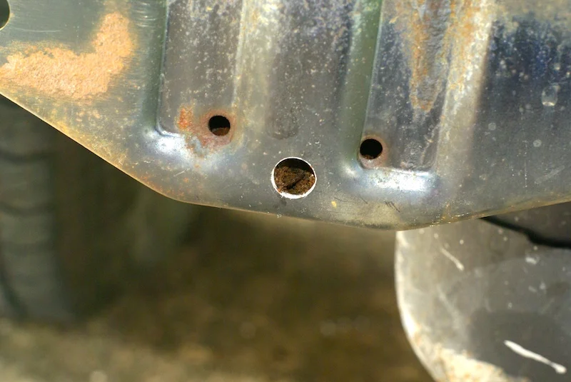

0.5” should be sufficient. Paint the hole after.

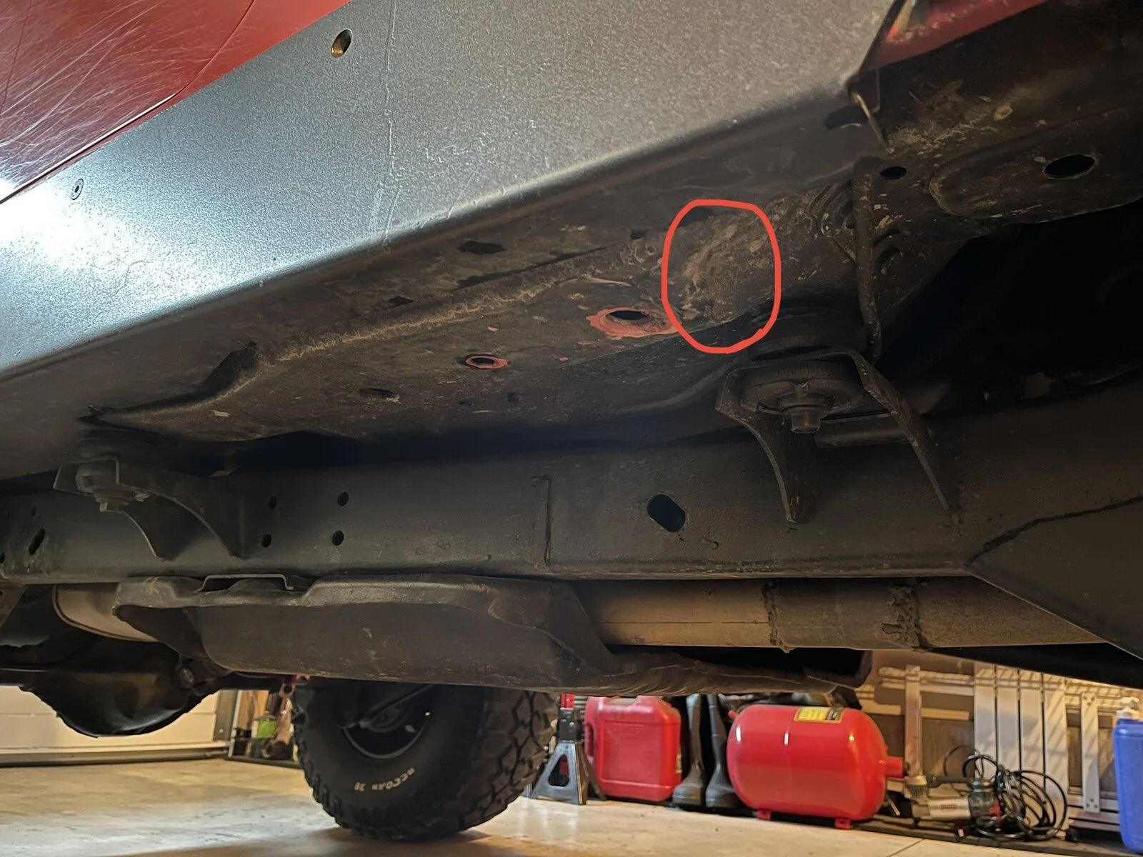

Remove the rear bumper and drill two holes (1 per side) like this (Note the crud!):

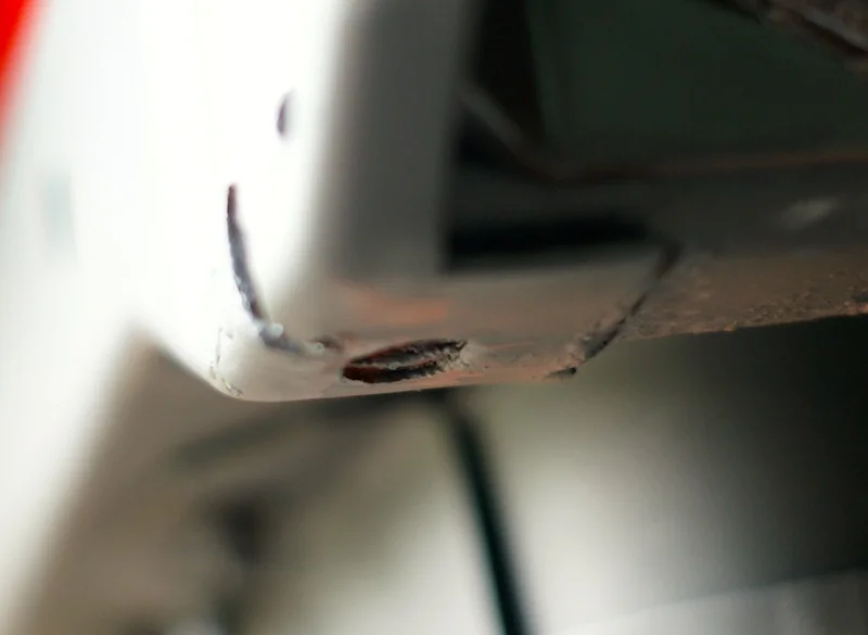

THEN - this out of focus picture sucks - but shows well enough to slot this hole down as shown. Otherwise, there's yet another rust vector...
The large hole is where the bumper bolts onto - no drain there. The slotting will enable water to run out below the level of the bottom of the inside of the frame as the rear crossmember wraps UNDER it.

I wish I knew before also. I had to replace my frame. Make sure you put holes in front of the rear bumper/crossmember also. I didn’t see it in your photos.thats where mine rotted out first.
It drains well here. Nothing is trapped behind that hole. No water or mud. I think this is a factory hole. Is this what you were saying?

Yes, drill it. You want drain holes in the locations shown on the frame in post #1.

Lol. It must be inside that rear crossmember where I can’t see it then? Inside the frame rail rearward of that drain hole is clear of water and debris.
Mine wasn't - but its really hard to describe in words. The rear cross member wraps under the bottom of the frame. There is - at least on mine - a 1/8 inch-ish gap between the end of the frame and the inside surface of the cross member. This cannot drain unless a slot is cut. Overkill? Perhaps - but I'm paranoid about rust! YMMV and all that...
