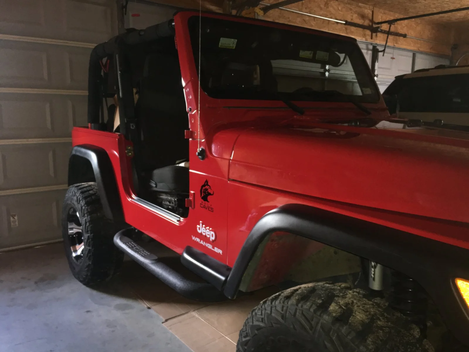

31" tires are a good choice, check out my Rubicon on 31" tires and a 2.5" OME lift:
Honestly, I think it looks good this way. Not too extreme, but not too wimpy. You won't break the bank like this at all, and believe me when I say that even on 31" tires, you'll be more capable than you can imagine off-road with just the addition of a winch and lockers!

Here's a not so great pic of mine with a 2.5" OME and 31x10.5r15:
