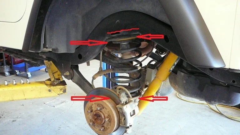

Hey JMT, where are you measuring the rear coils. The upper spring perch is at an angle and is higher towards the rear, so are you measuring from the front of the perch or rear? If I measure mine from the rear I get the proper lift height.

I measured mine at the rear and I'm at 11+", at the side 10.5" and front 9.5". So yeah, perch is angled. Front spring is level and I'm getting 14 3/4". That means I'm getting more than the advertised 2" from an OME, especially in the rear, but where do we measure from? Right.

The front is cut and dry. My question was concerning the rear springs. The upper perch sits higher on the frame and is angled, so you get a longer measurement when measuring from rear of the perch vs. the front of the perch. Pic is for reference. I know you measure with the jeep under its weight.

If it was me, I would measure the rear spring from the middle of the perch if possible, that way you'd probably get something more accurate.

Guess that makes sense. If the jeep is sitting level and you measure the front, logic would suggest the lift height.

Yep, that's how I've always done it at least. Once I measure the front, I know the lift height. Sitting on a level surface of course!
