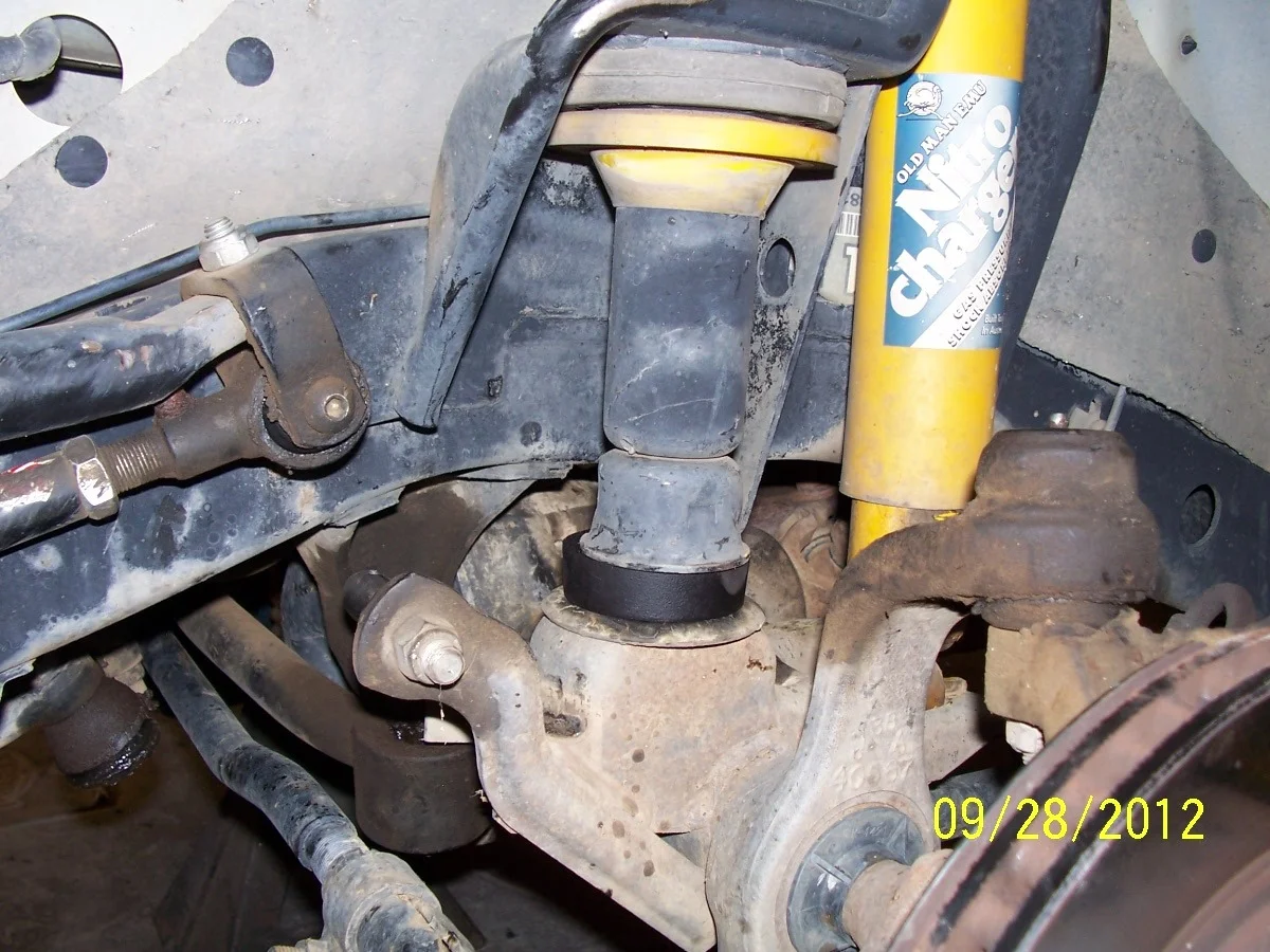

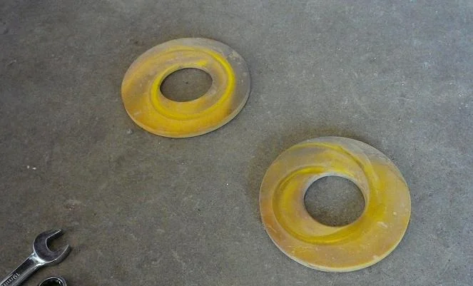

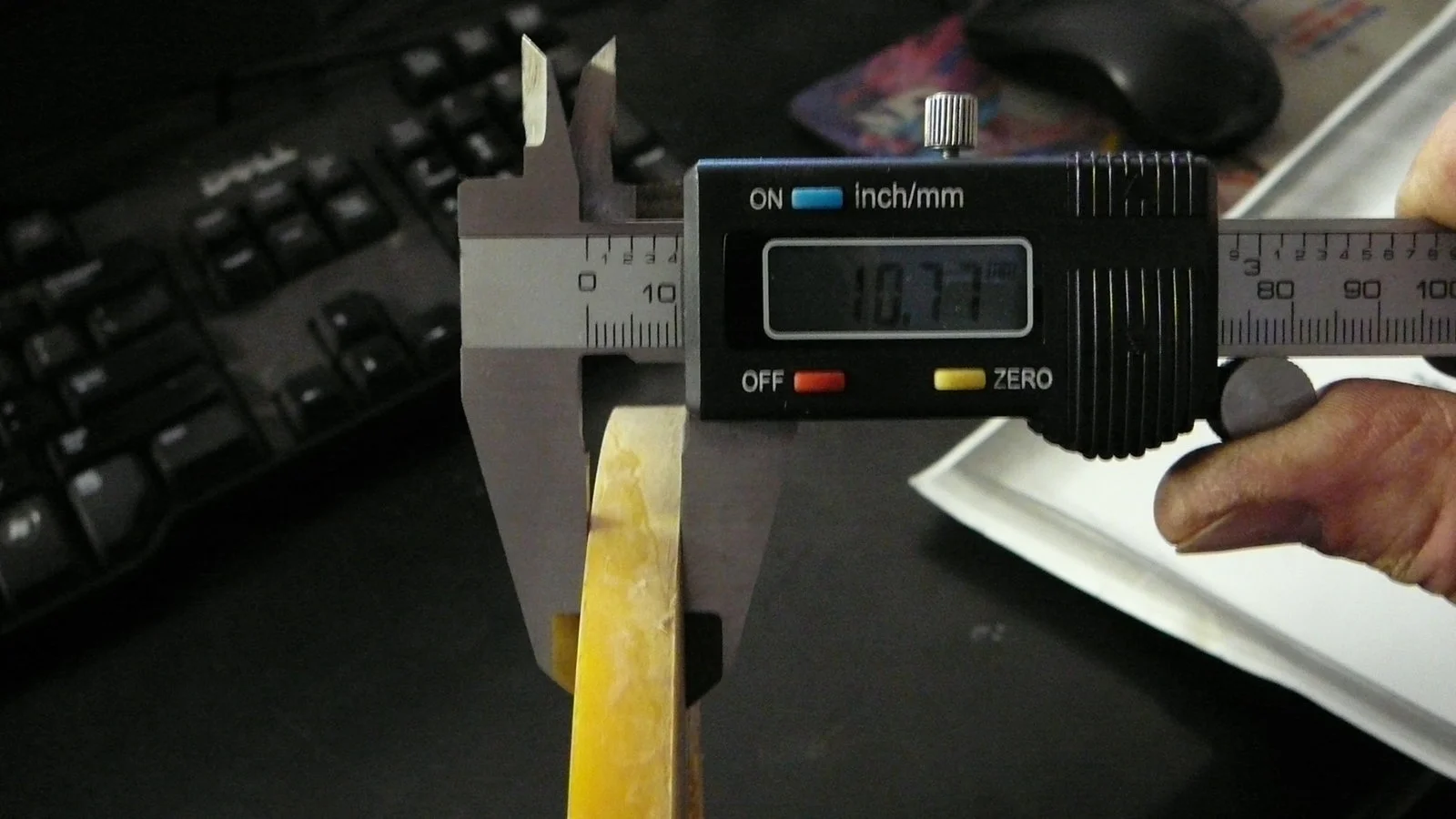

With the OME lift kits, the springs are 2" lift springs. To make it a 2.5" lift kit OME adds 10mm coil spacers to the kit which essentially gives you the advertised 2.5" of lift.
In this picture you can see the yellow coil spring spaces installed, minus the coil spring. This pic illustrates putting the front axle at "full bump", so I can measure for the appropriate added bump stops. For 31" tires, you shouldn't need any additional bump stops in the front, but you'll need 1" bumpstop extentions for the rear. Those should come with the kit.

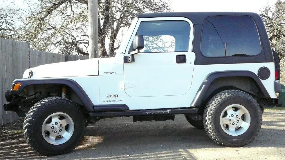

Just for reference, here is a pic of my jeep after installing the OME 2.5" lift kit on 31" BFG mud terrains.
If you don't know how to measure your ACTUAL lift, or stock sag for that matter, the front stock should measure 12" from the bottom of the coil spring inside the perch to the bottom of the coil spring isolator. Following the same measurement procedure, the rear should measure 8". My stock were sagging 0.75" so when I put on 1.75" budget boost spacers I actually only got 1" over stock...Everybody was like, "What lift?" Once I got my 2.5" OME (really 2", right!), it looked like my Jeep went way higher, and it did, because I got rid of those saggy stock springs. It changed everything and rides great. I don't have the Nitro charger shocks that come with the OME kit, but I hear they are great. I paired the springs with some Bilstein 5100's. The ride quality is in the shocks, so always get good shocks. If you don't get the full OME kit you could buy the pieces you do need (2933 and 2942 springs, 10mm yellow spacers, rear trackbar re-location bracket) and pair with some RAncho 5000X shocks. Guys around here swear by them...Might save you some coin, just have to do the math...You don't really need the OME steering stabilizer, as it's a 50/50 valve, and they all do basically the same thing, whether they're $30 or $100.
