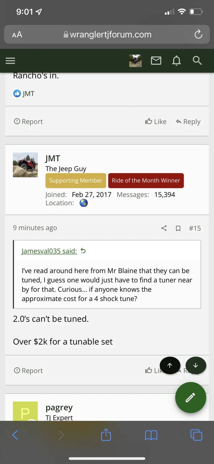

Big tough guy behind a screen. I read just fine. You actually only said the following from this screen shot that I was responding too.
2.0’s can’t be tuned.
Over $2k for a tunable set

2.0? The reservoir has nothing to do with it. Be more specific.
2.0 without any qualification is not tunable. That is specific.
