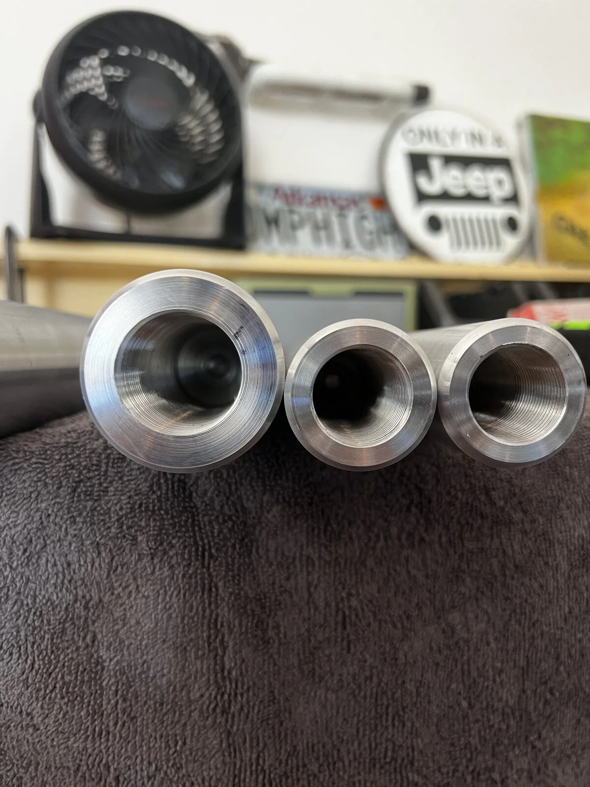

2” diameter links are FAT. The left is the 2” lowers and the right is 1.5” uppers. 1.5” is the same diameter as the short arm lowers that savvy makes.
Just so folks don't get confused as to why different diameters of material are used, the concept is simple. As the length increases, the diameter has to also increase to achieve the same or similar resistance to bending. Also why you can get by with longer 1.5" diameter uppers, they are very unlikely to get levered by a big rock with a tire off the ground.
I explained that same thing to the guy that placed my order. He was like wow 1.5” links really don’t have that much meat on them are you sure? Yes, how often do you hit your upper links on a rock?
Reactions: HornedToad
Try explaining that even though they are triangulated, they only operate in tension and compression.

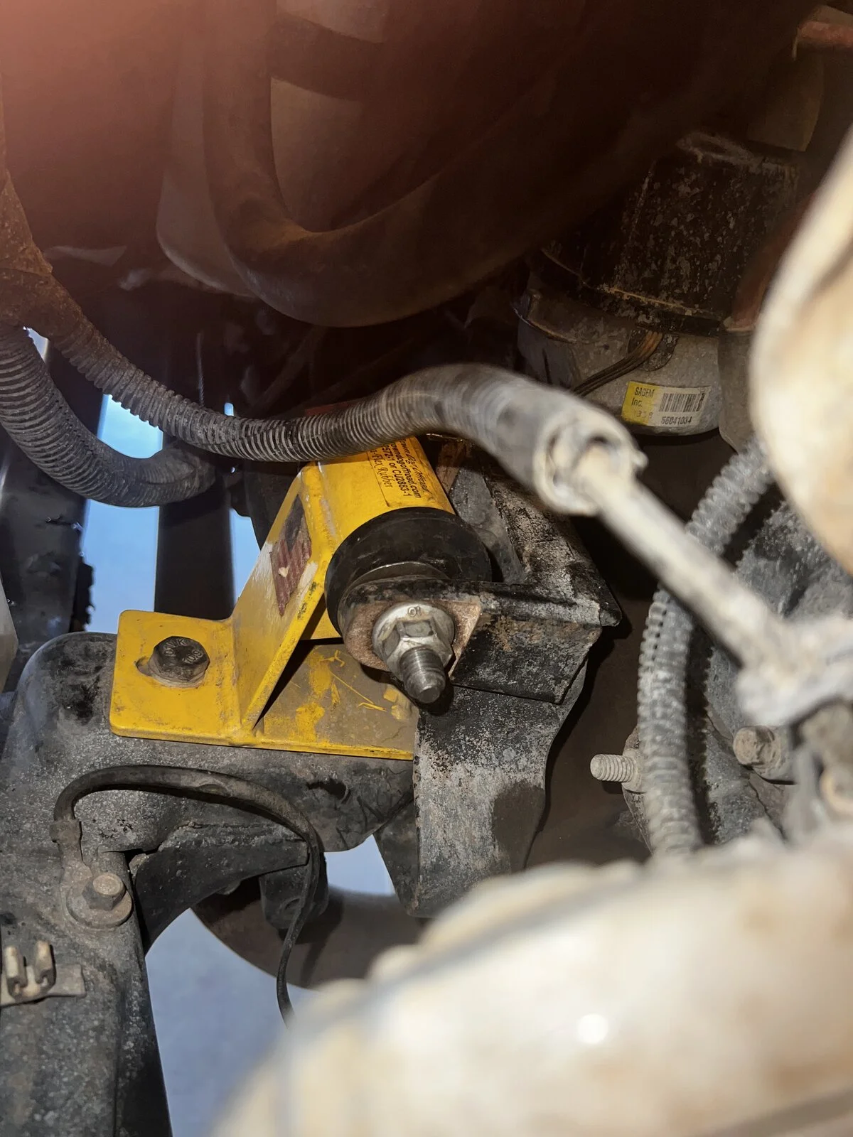

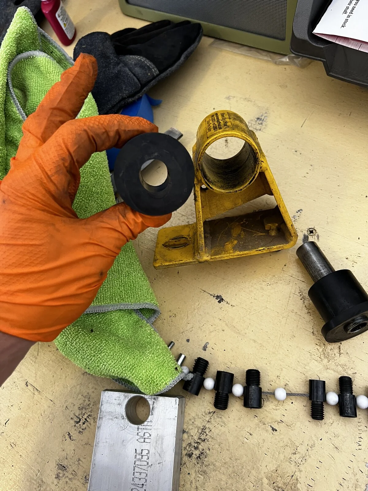

I wanted to like brown dog motor mounts. I originally got them because they are made locally in my hometown. Nice people. The bushings suck. This bushing was sagging exactly like this a few weeks ago. I picked up a new bushing from them for a few bucks and it is already badly sagging. My idle vibes are worse than I would like so it’s time to fix it.

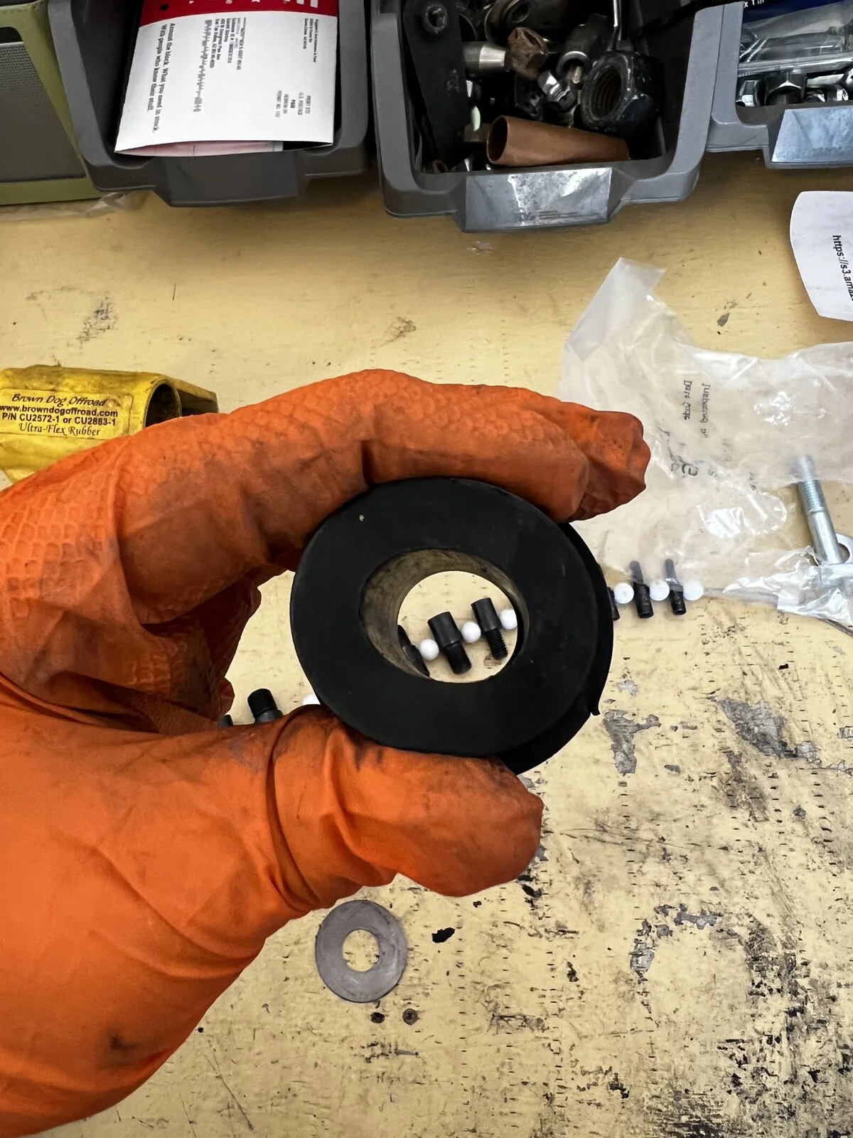

They weren’t kidding when they call these ultra flex bushings. They are so flimsy and fell right out of the mount.

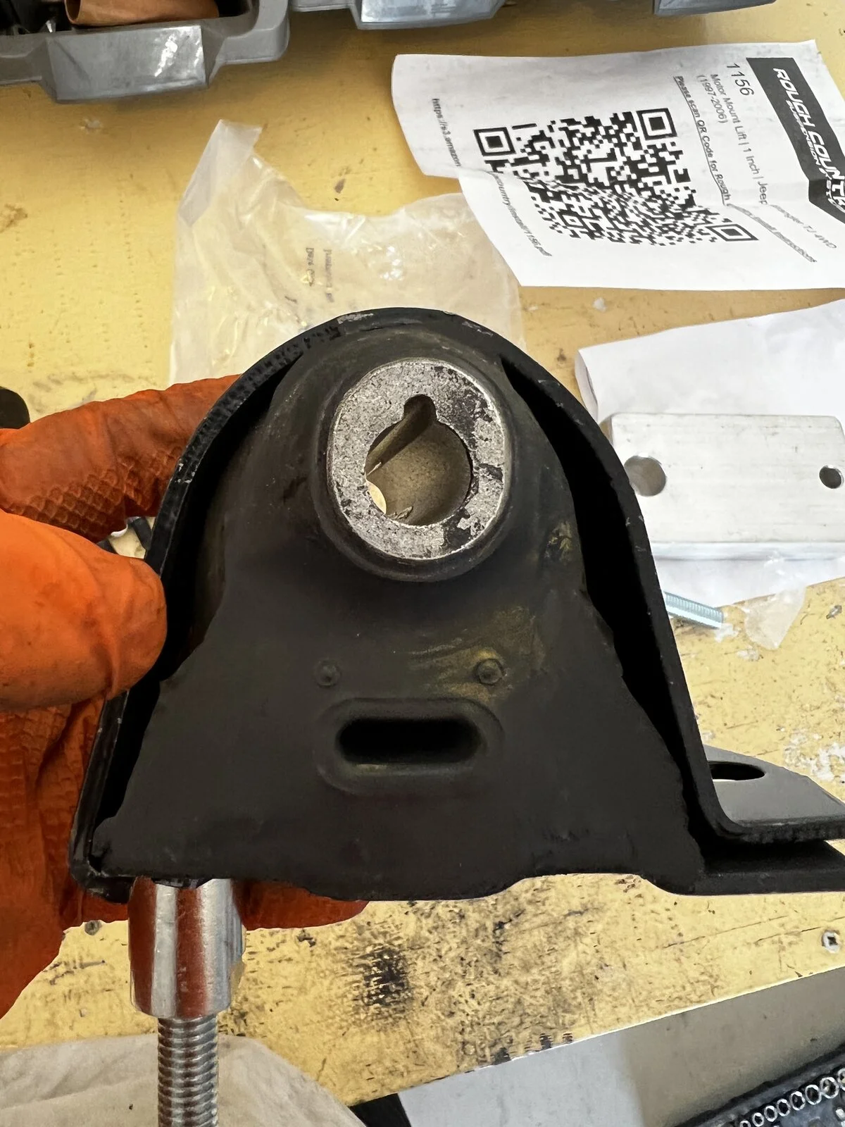

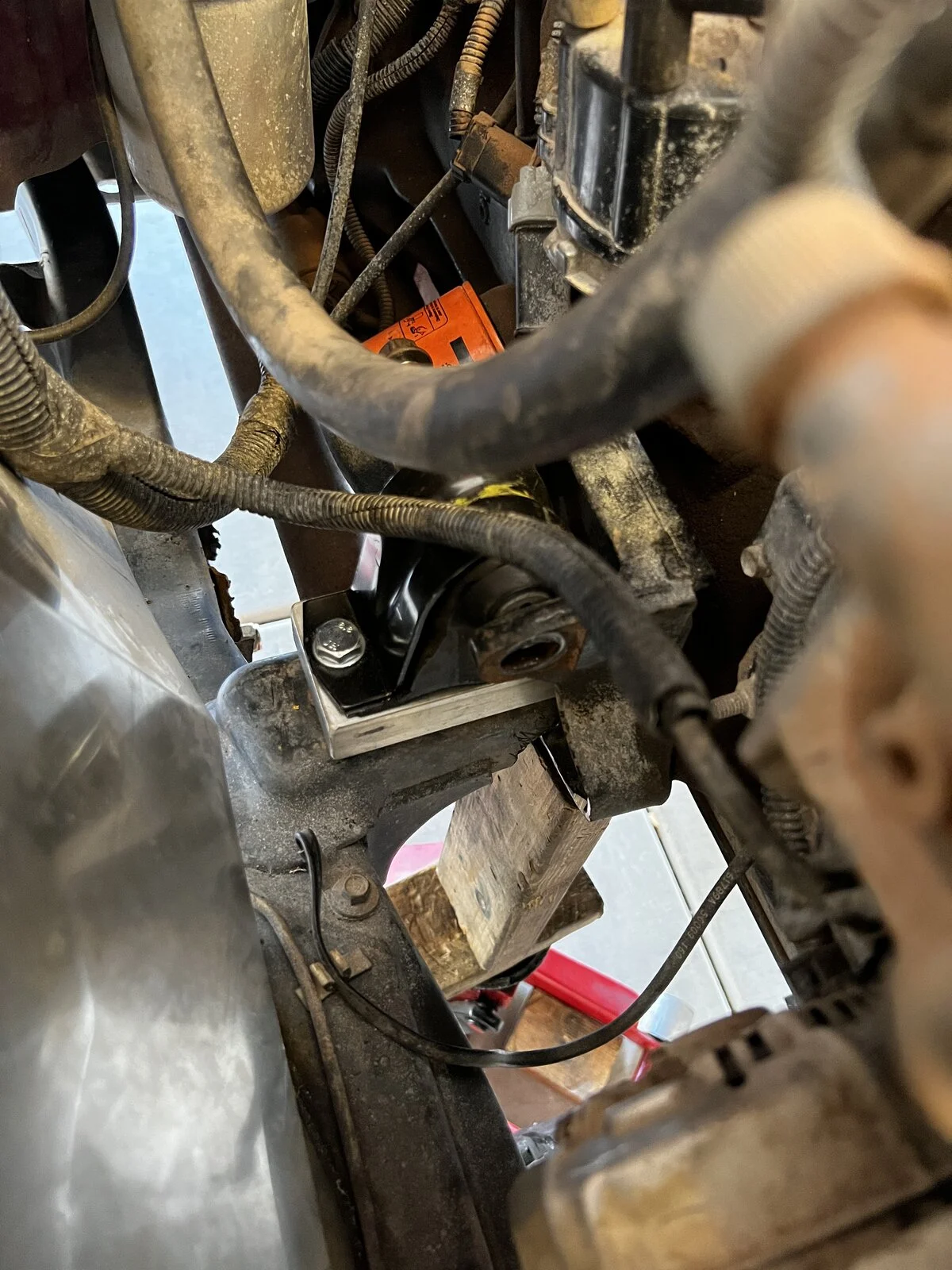

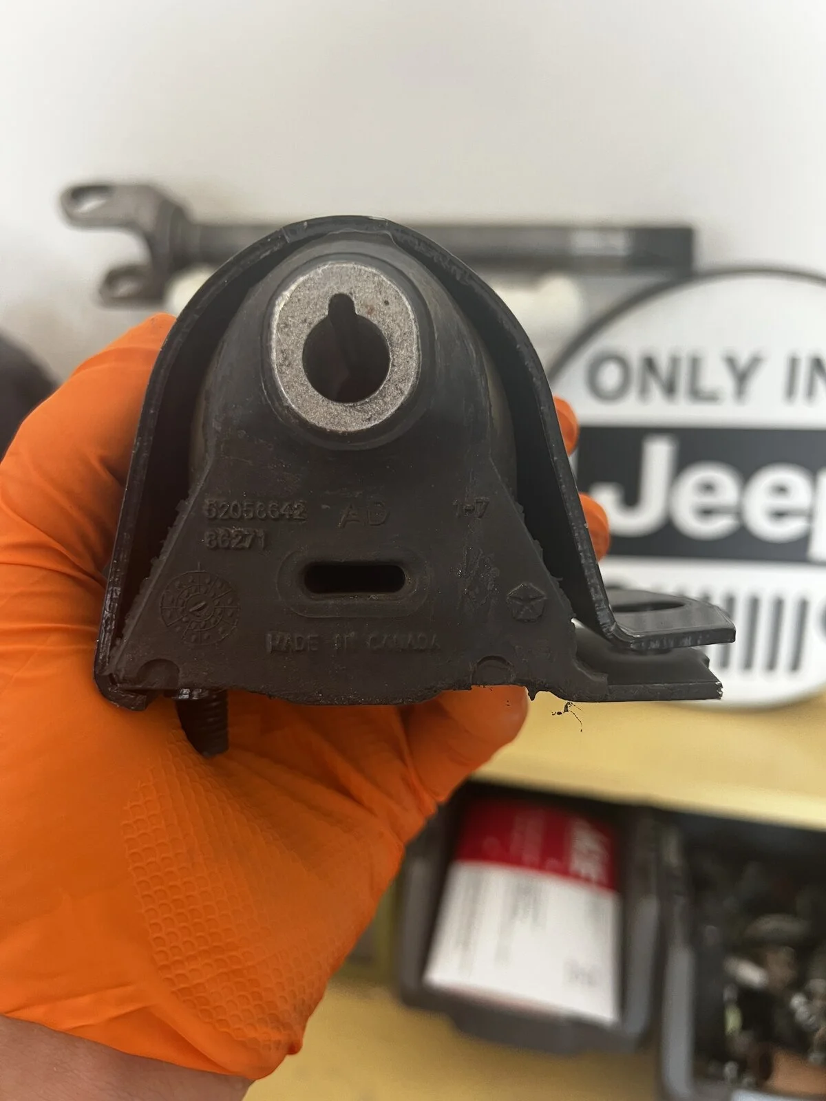

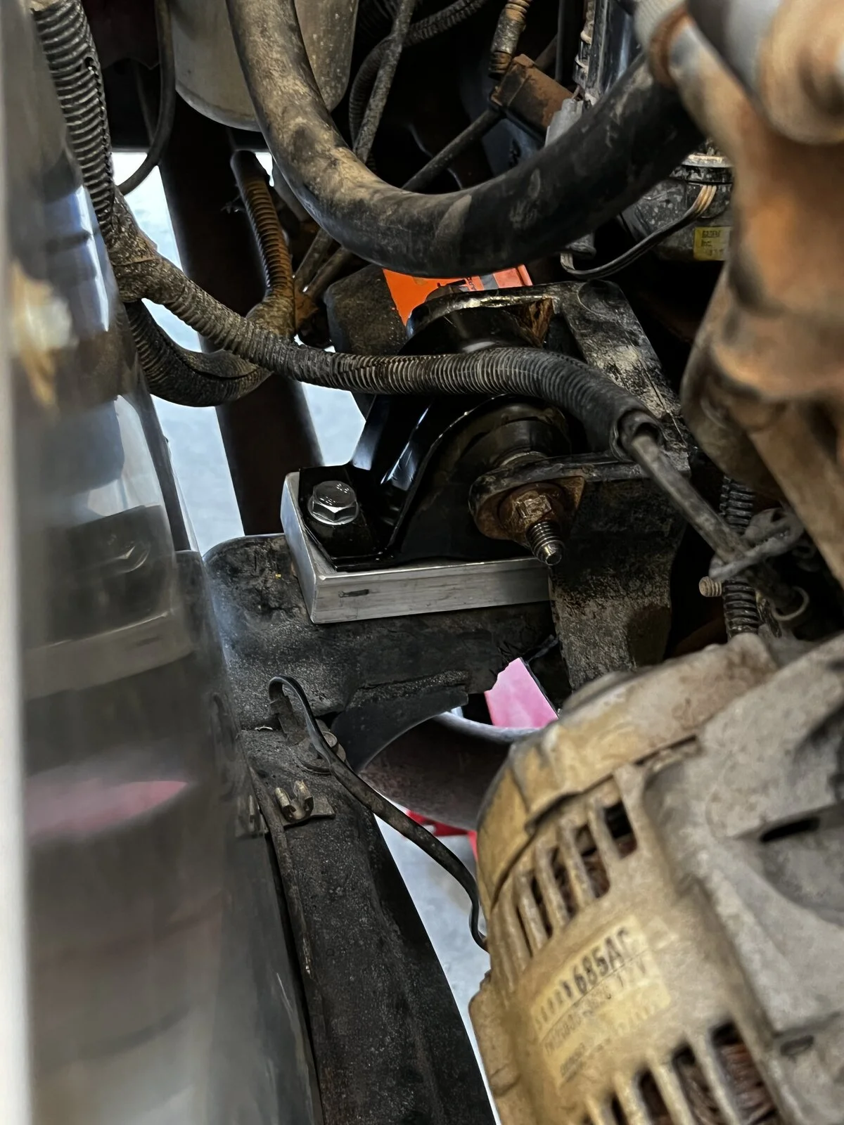

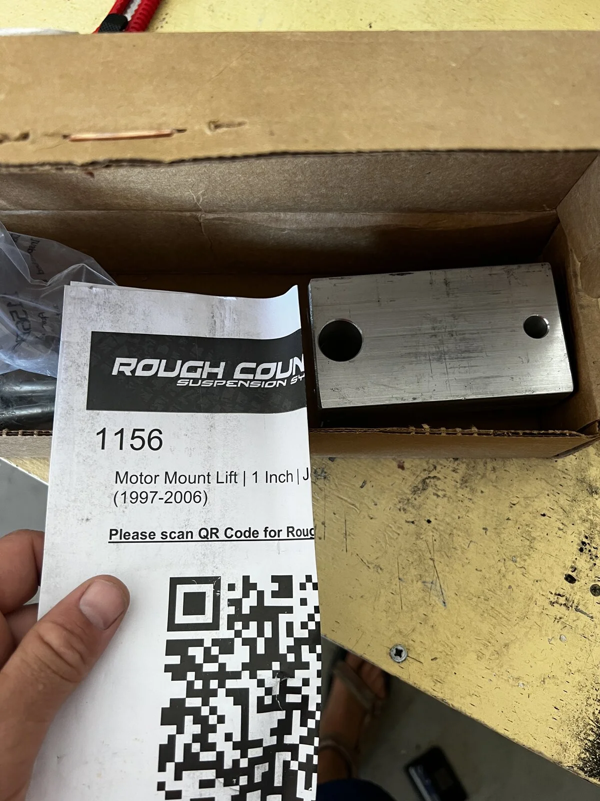

I am swapping these out for some mopar motor mounts and a rough country 1” motor mount lift. The RC lift was the cheapest and fastest delivery. The blocks are aluminum like others and the fasteners seem fine. It will do the job.
The new mounts are in and the results are astounding. It feels like an electric car compared to the way it was. Idle vibes are gone. Floor board vibes I was getting at varying rpms are gone. The Jeep is overall much much quieter at all speeds and just plain smoother to drive. Mopar mounts are the way to go.

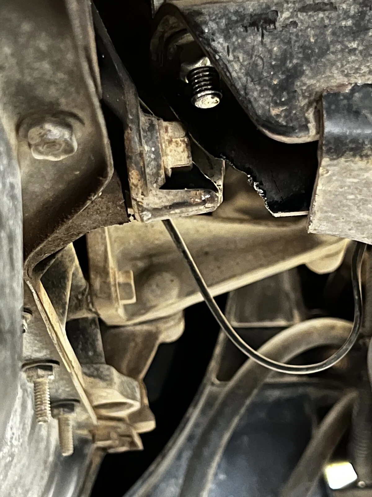

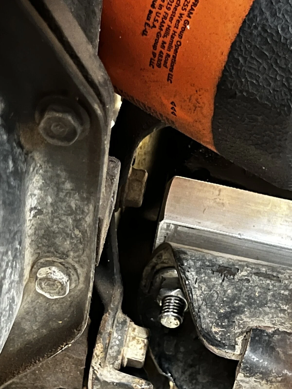

I also trimmed the frame bracket for the mounts because the motor bracket and frame bracket were touching. Getting a grinding wheel in there was a bitch so the cuts aren’t beautiful. But I have lots of clearance there now.
Sounds like the rough country lift blocks are already cut and clearances for the bolt head on the passenger side. I think some other brands you need to trim the lift block to clear

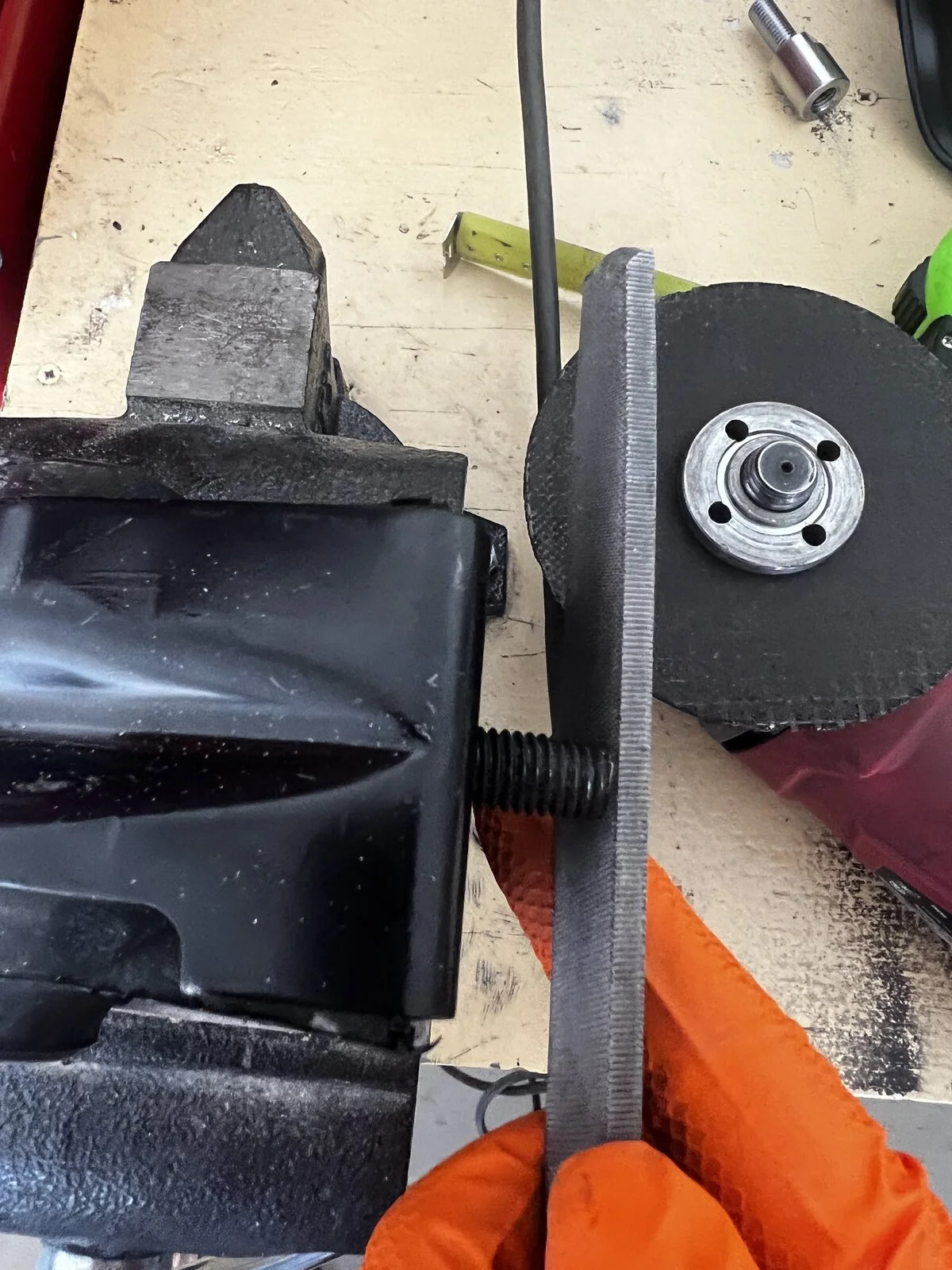

When installing motor mount lift blocks like this, don’t forget to cut the motor mount studs enough that the extension bolt fits snug against the motor mount. I cut about 1/4” off with a cutoff disc, then used a filed on the edges so it would thread on nicely, then some red loctite.
