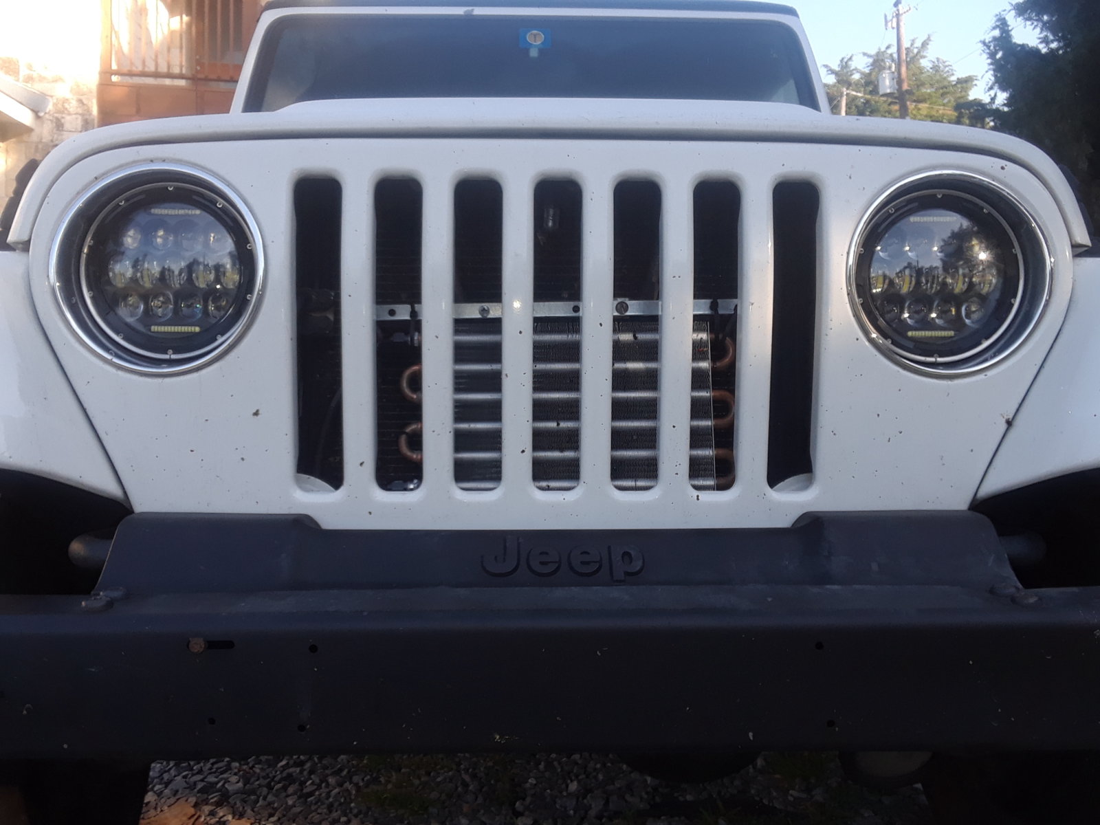

Great discussion, I installed this cooler a couple months ago.
I use my TJ as a DD and wanted to give the tranny some longevity in the Tx heat.
I chose a basic Flexalite, with AN6 fittings
and plumbed it in AFTER the oe radiator, just seemed to make the.most sense to me.
No problems post install after a couple thousand miles

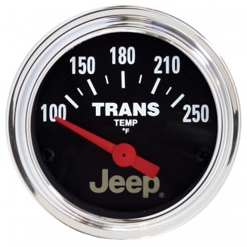

What temps do you see on the gauge?
I have not installed a temp gauge on the transmission yet, but watching the radiator temp, it has always been normal.
And during my 1st wheelin at Wolf Caves last month, cooling temp gauge always remained normal.
That's like putting air in the tire on the tailgate when you get a flat. The only way to know what the trans is doing is to put a gauge on it.
