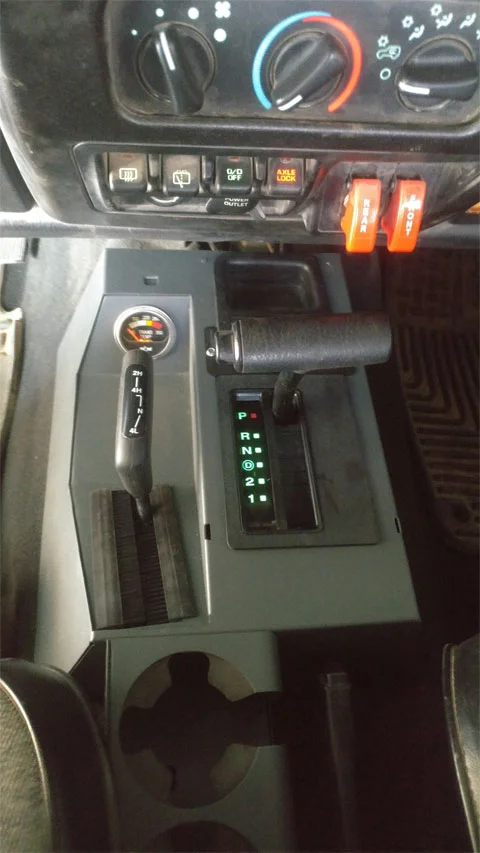

On the forward console's flat spot just ahead of the tcase shifter works well for a transmission temperature gauge.
This shows the gauge on my Tuffy console but the OE console has the same location available on it.

My '06 OEM center console has a junk tray that spans the width of the console just forward of the t-case and transmission shifters which prevents a gauge from being located there. I looked when I first saw the photo of the Tuffy console with gauge. I miss the old school flat steel dashboards. Switches and gauges were a lot easier.
I somehow ended up with one like that in a trade or similar and once I noticed that, trashed it and found a slightly older version with the flat face cheap on eBay.
Doesn't matter anyway. The face of the console right in front of the shifter handle is too vertical to put a gauge in that you can view easily. The Pre-05 consoles are angled right there so it works perfectly for a trans temp gauge. On the 05-06, we mount them right beside the switch panel for the lockers and OD button. Not the best but certainly better than the console.

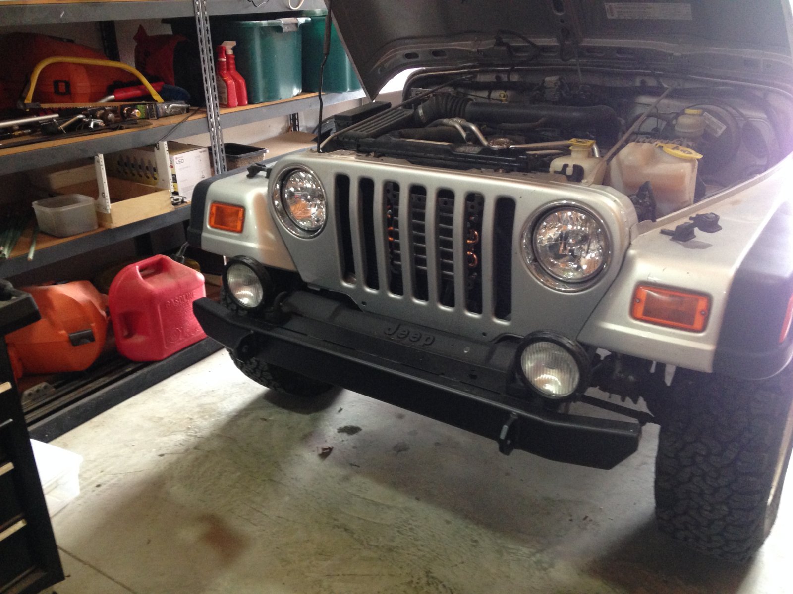

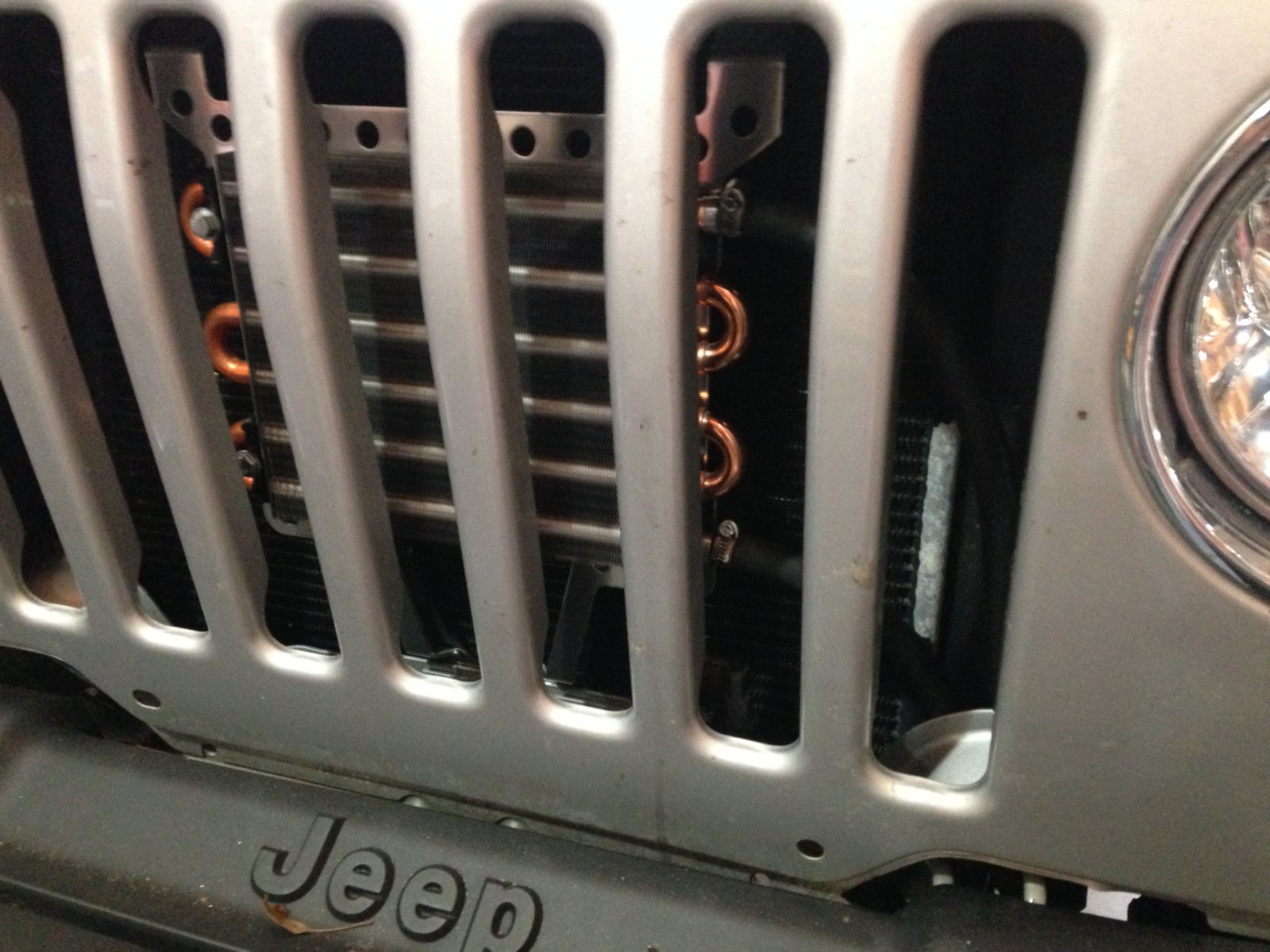

I installed a Flex-A-Lite 4116TJ auxiliary automatic transmission cooler today. I noticed two discrepancies in the installation instructions. For my 04 Rubicon the cooling lines need to run on the driver's side not the passenger side as in the instructions so I had to install the radiator to the mounting bracket 180 degrees. The instructions tell you to cut and double flair the metal factory return line to receive the rubber hose returning from the auxiliary cooler but you can remove the factory rubber section of hose and install the new return hose using the spring clamp. I called Flex-A-Lite questioning the double flare instruction and was told the flair helps hold the return rubber hose on the cut metal line and the double part is to insure a smooth edge. I guess that makes sense sorta but not really. Now that I see it I wish I had painted it black to hide it but live and learn.

Did you have to remove the radiator to install that?
Yes the radiator and the V shaped brace have to be removed. The fan blade shroud and AC condenser have to be unbolted then held back against the engine while installing the cooler with mounting bracket between the V brace and Jeep then reinstall everything. Not hard to do just extra time.

Any concern about installing a trans cooler on the front of the radiator and having it rob the cooling air to the radiator?
No concern whatsoever. @KCsTJ did this I believe (at least I think it was him).
If this was the case, your AC condenser wouldn't have been put there by the factory.
Reactions: MonkeyMike
None. Even sitting in traffic in the sweltering Florida summers I have no cooling system issues with my auxiliary trans cooler mounted in front of the radiator (and a winch).
Only if it's a cheap store-brand radiator that only has sufficient cooling capacity for easy/optimal conditions. The OE Mopar radiator has more than enough excess cooling capacity to easily handle a transmission cooler or big winch being mounted in front of it.
