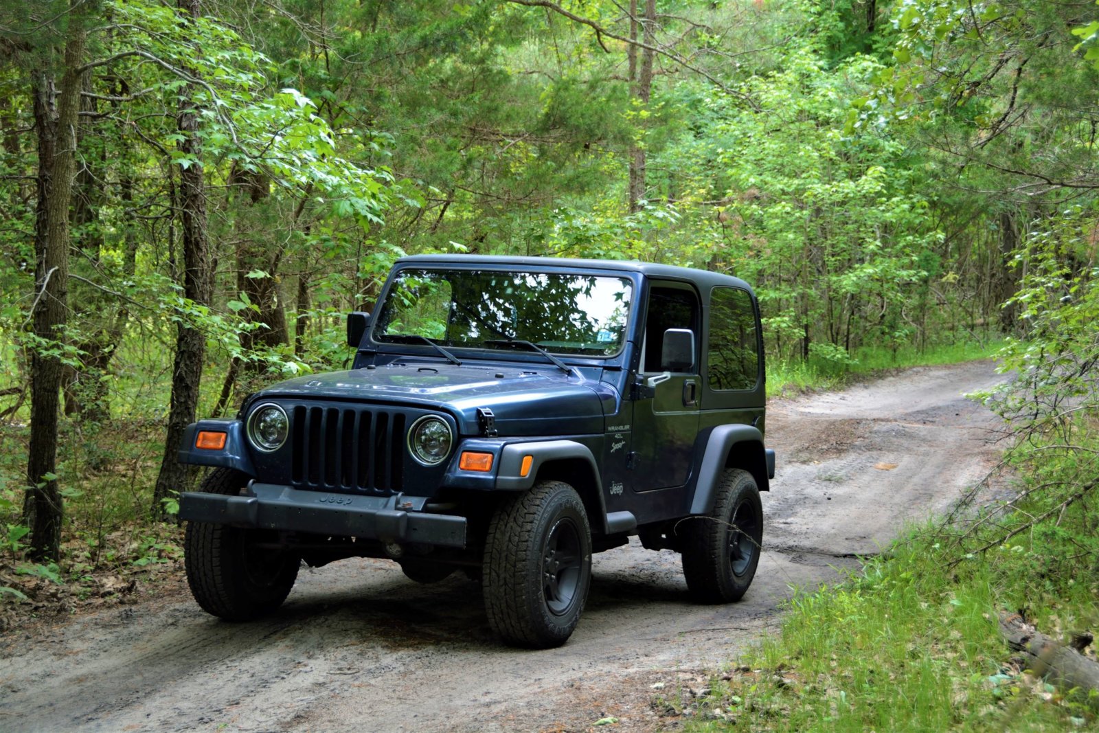

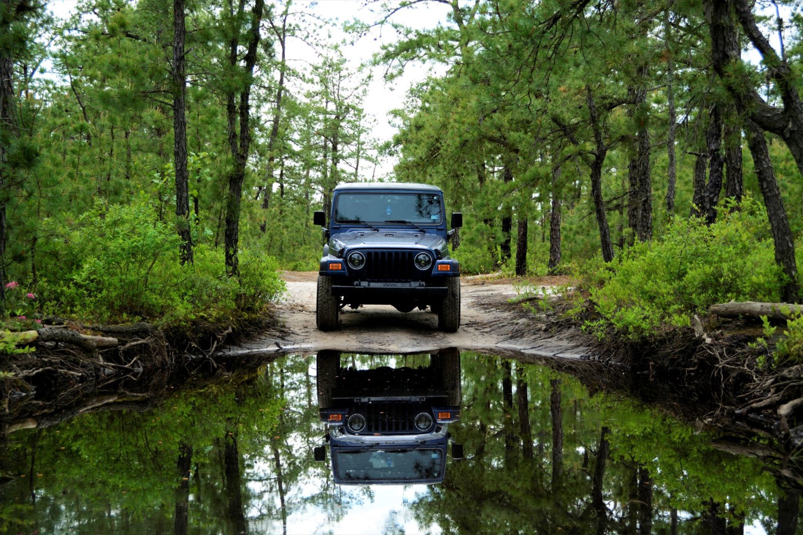

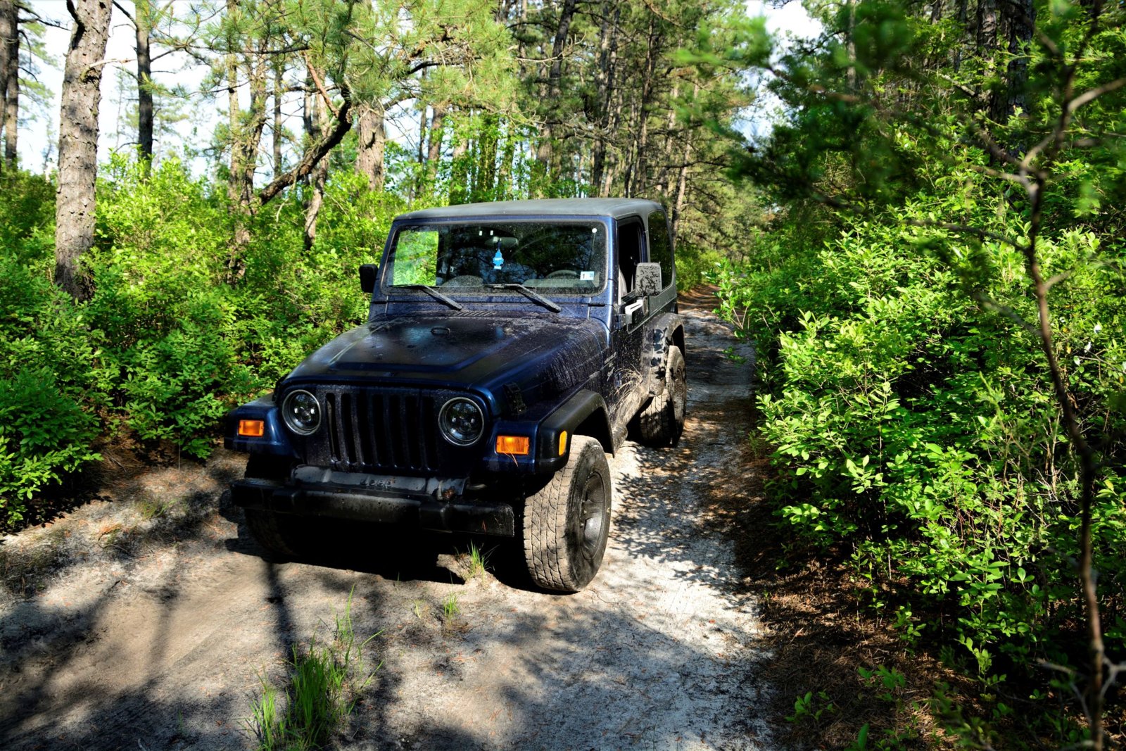

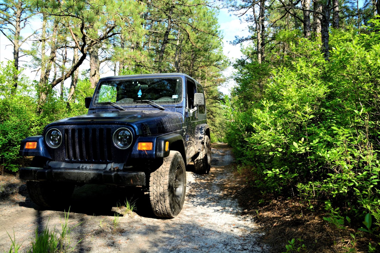

Took Barbara out on her maiden voyage today at Wharton National Park, NJ. Gotta say she handled it all like a champ from mud to sand. I would have been a bit more daring if I had people with me but still had a great time.

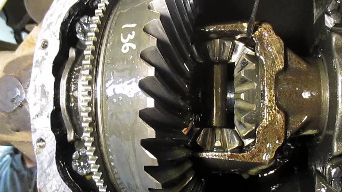

The gear set doesn't really pull together for either high or low pinion depending on which end of the vehicle it is installed into.
If you look at the profile of the tooth, there is a sloped side that is not parallel to the axle shaft and a straight side that is parallel. When the gear is driven on the straight side, the force to turn it delivered by the pinion is transmitted to the gear at a nice right angle to the gear rotation and the effect is relatively neutral deflection.
When the ring gear is driven on the coast or sloped side of the gear tooth, it is as you said, trying to push the two teeth apart or away from each other. To keep the deflection to a safe minimum, the axle needs to be much larger in a rear application to keep the teeth from walking out of pattern far enough that the ends of the tooth see too much force and break off.
