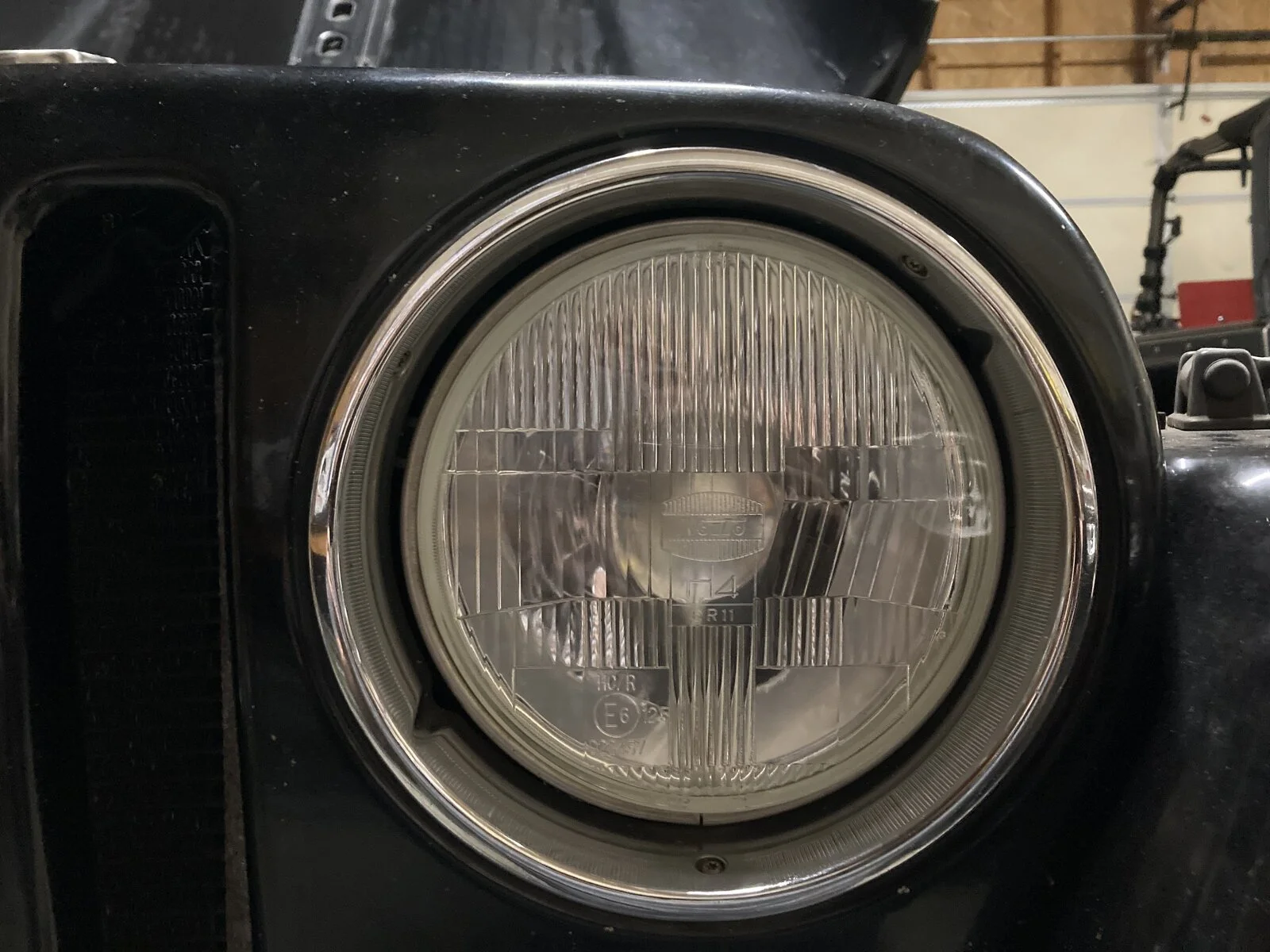

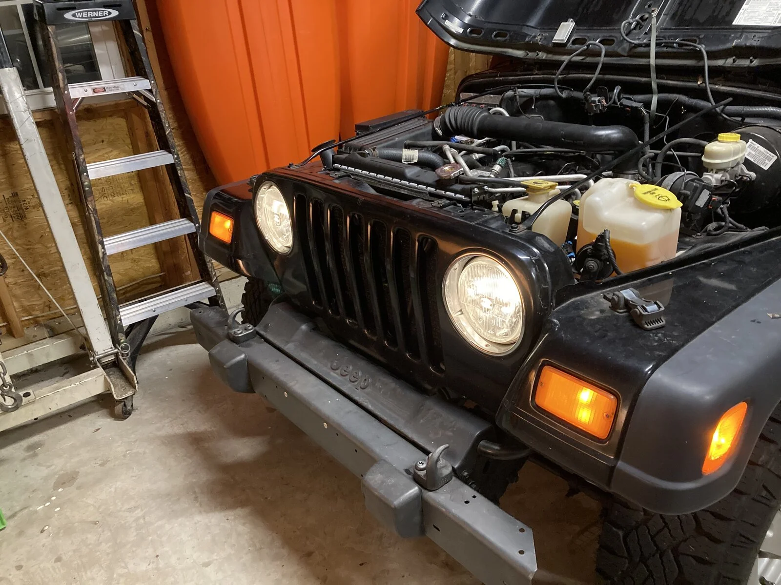

Installed the Toyota halogen light conversion. Pretty easy install, can’t wait to get it out and seeing there is a lighting improvement.
Reactions: JMT and Irun
I've been pretty pleased with it, but admittedly, I didn't have much nighttime seat time in before the change.
Yeah I’ve driven on sealed beams before switching to JK housings in my TJ and it helped. However I’ve never liked the light pattern, hoping these are a bit better.

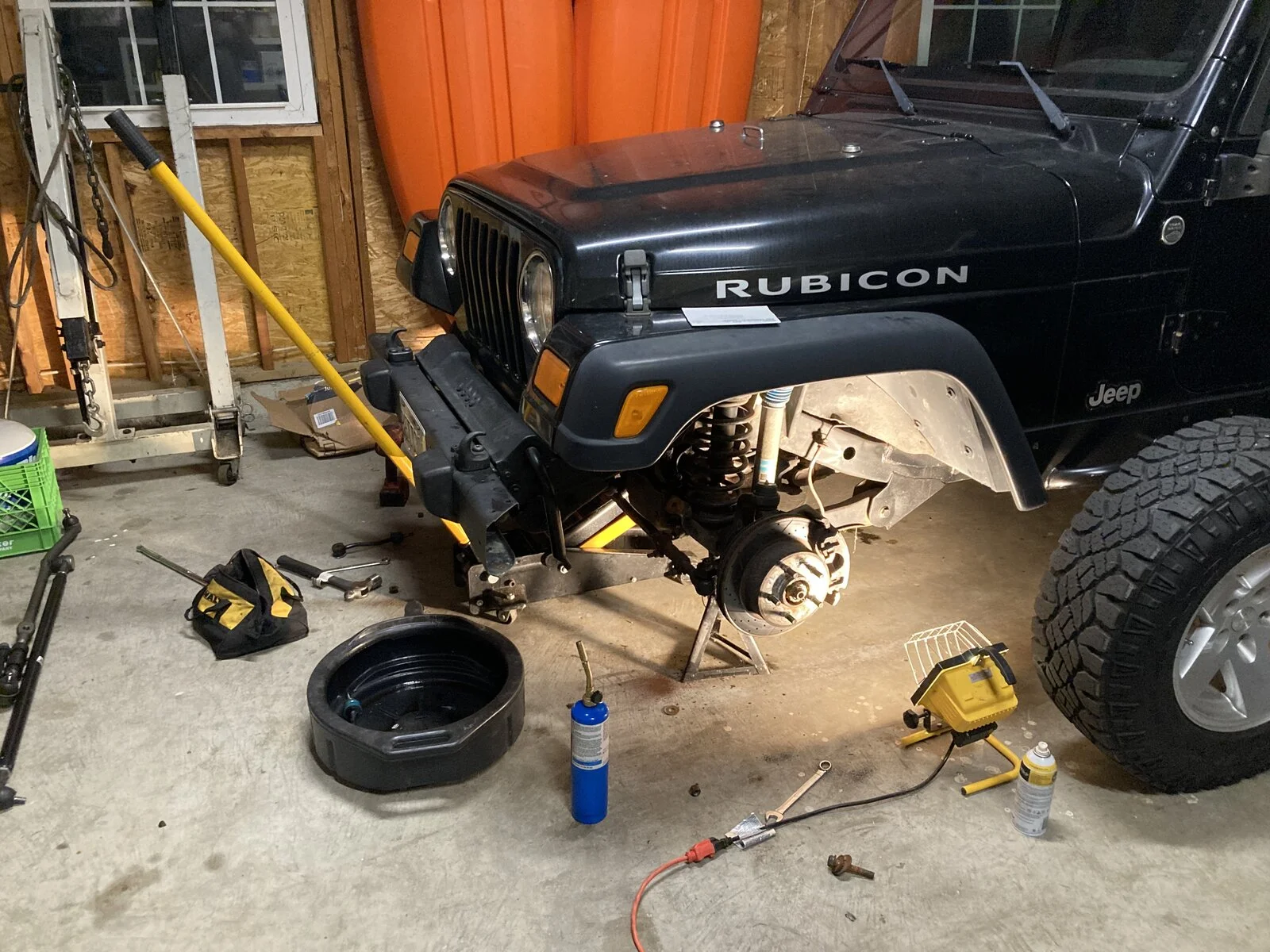

I have been working on the front end to sure up the steering and ride quality. It’s been a fight but it’s coming along. The previous owner, or their mechanic, used red thread locker on every nut and bolt, which has made removal of parts a challenge. Lots of heat has helped, but the shock stud nuts are enough of a challenge without having to overcome the thread locker so they had to be cut out. Maybe they mistakenly used thread locker in place of anti-seize? Who knows.
Anyway one more lower shock nut and bolt to remove and I can finish installing the rancho shocks.

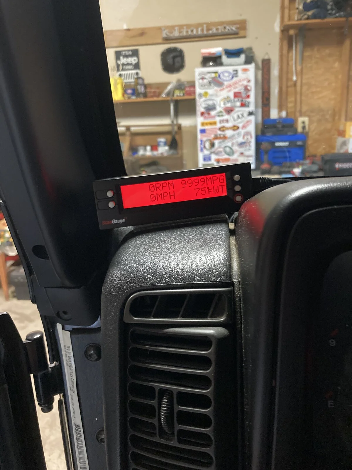

Not a whole lot to report. I had a scan gauge II sitting around from when I had my Tacoma. I used it to monitor trans temperatures because the truck did not have a factory gauge. My current F150 has built in gauges to monitor things so I figured I put it into the LJ.
Nothing special, programmed it to monitor RPM, MPH, Water Temp, and MPG. I mounted it with some heavy duty Velcro and it looks OK. Anyone else use one of these things?

Yeah, I’m not a huge fan of the interface on this either, but it was just sitting on my bench so I figured I might as well use it. Maybe it will help with fuel mileage and maybe I’ll add the average MPG to it.
I did try it on my TJ once and hoped to get a trans temp reading, but it was not an option and could not be added. I am also installing a separate gauge as well.

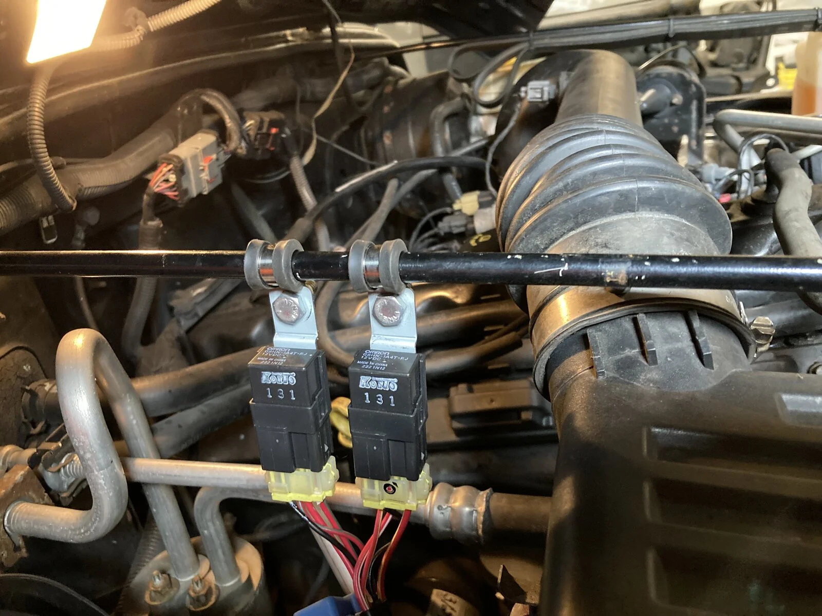

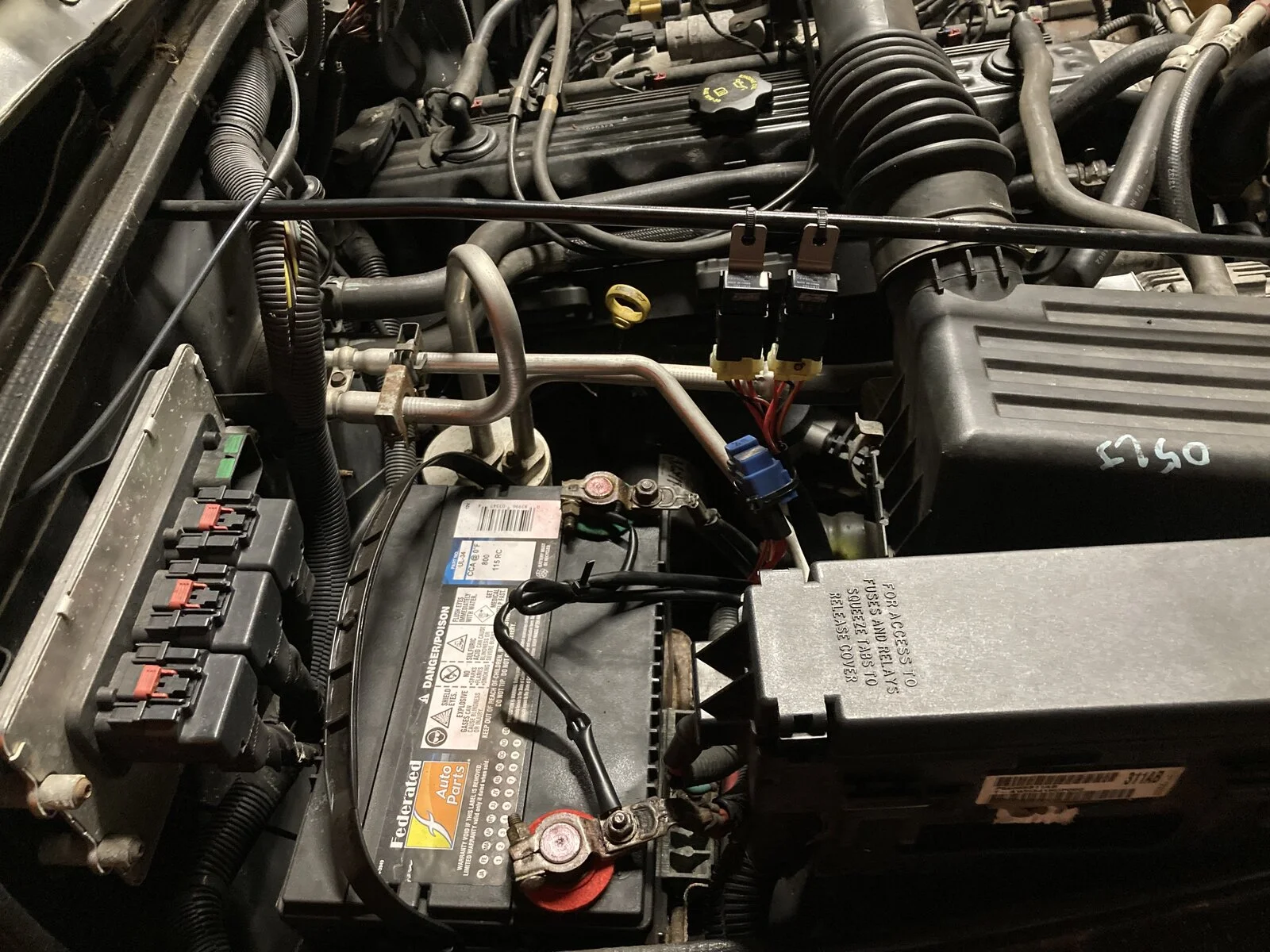

A small but satisfying alternative to drilling holes to mount the relays for the Toyota lights. Before I had zip ties holding them on the grill supports. This looks much cleaner in my opinion.
I did the Toyo light conversion (plus an set of aux driving lights and have been waffling on where to mount the three relays. This might be the answer..
