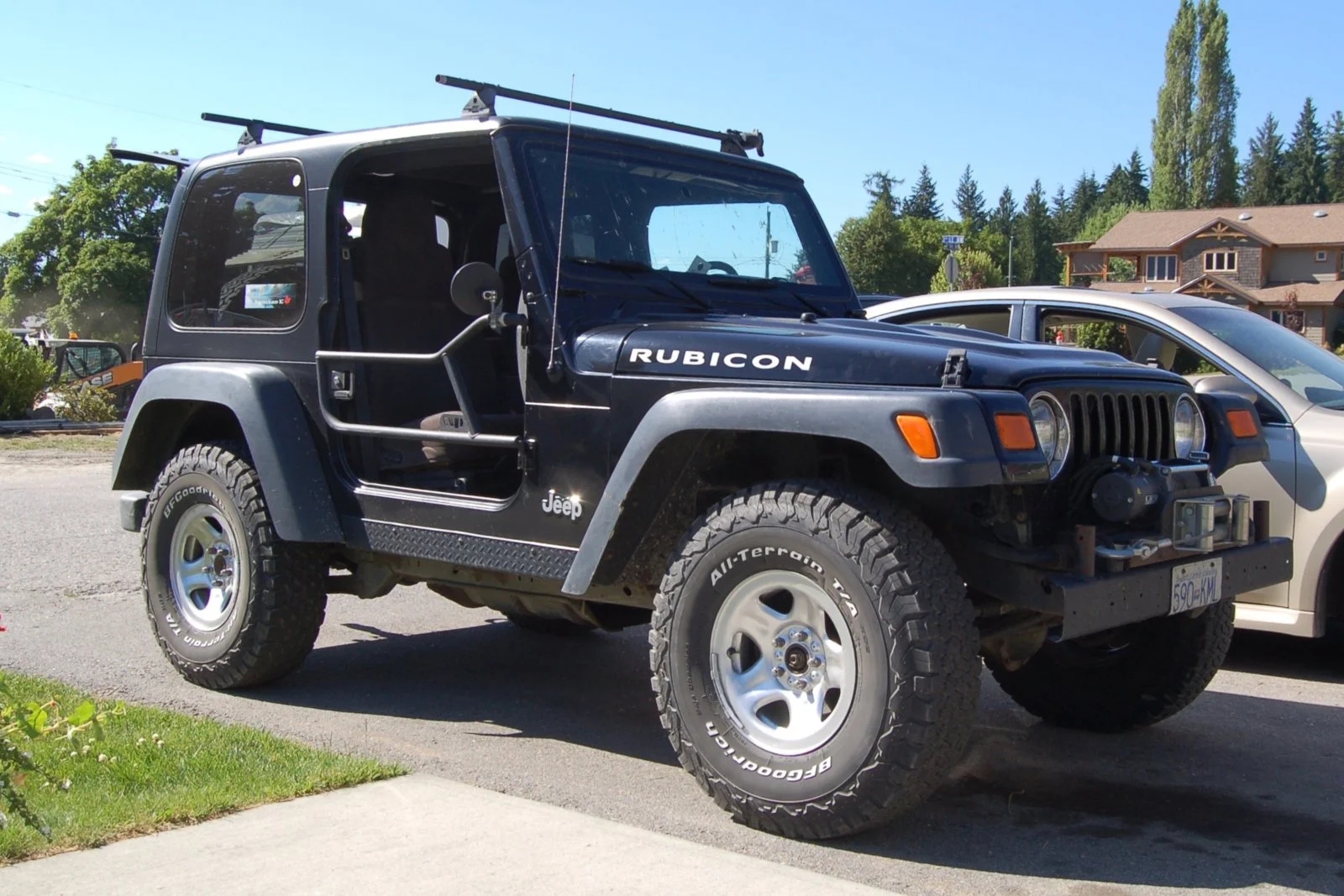

This is what I've done to my Jeep so far and it's very road friendly and I can go any place "I" want to go off road. I like to drive trails, overland, Low maintenance roads, just basic off roading nothing too wild. I looked at a body lift but decided to go with the suspension lift instead. would like to get a slip yoke eliminator some day so I can lift the belly pan back up.
Stainless Steel Black Powder Coated Windshield Hinges
Black Hinge Mounted Spotlight Brackets
HID Headlights
HID Spotlights 300,000 to 400,000 Candle power
240amp 6 phase Alternator up to 160amp at idle with 2 gauge copper wire.
all Aluminum welded Radiator from "Northern" equal to a 4 row."Because the stock radiator had a small leak" The new one is Double the capacity of the stock Radiator. Added Grill inserts and bug screen to help protect the Radiator.
drilled and slotted rotors with pads
brake drums, shoes, spring kit, wheel cylinders, rear brake lines, had the backing plates remover and sandblasted and powder coated.
driver side and passenger side Front U-joints. replaced with "Spicer" greasable U-joints
drive shaft U-joints replaced with Spicer" greasable U-joints
4" suspension lift kit.
anti-sway bar quick disconnects.
5 Black steel 15"X10" rims with 5, 33"X12.5" Hercules Trail Digger tires M/S, Tires have been siped to increase traction which will also help with longer tread life.
Spicer 4:10 gears. 1900RPM @ 55MPH in 5th gear
Axle bearings,
Heavy duty rear axle shafts,
Rear locker and front E-locker, and front and rear diff guards.
Iridium spark plugs
Fluids that have been replaced, Transmission, Transfer case, Brake Fluid, Antifreeze, and Axles.
