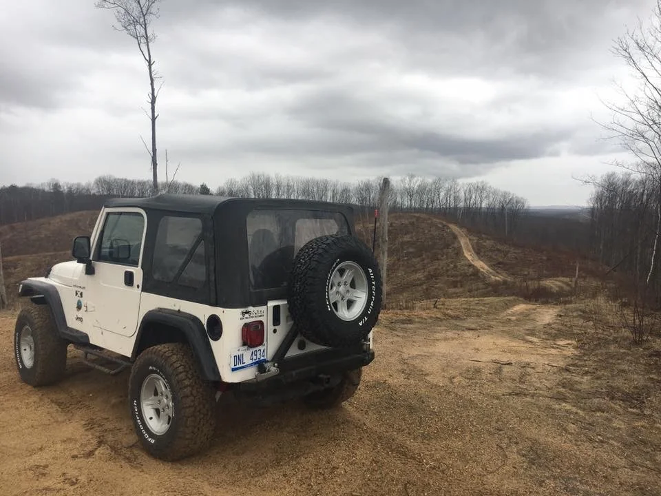

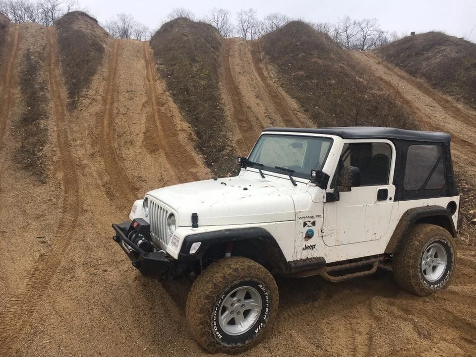

Really liking how well this combo works. Had no problem going where everyone else went even though I was getting picked on for making my Jeep smaller lol

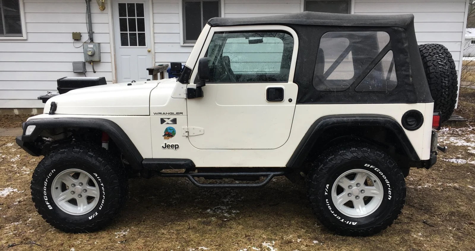

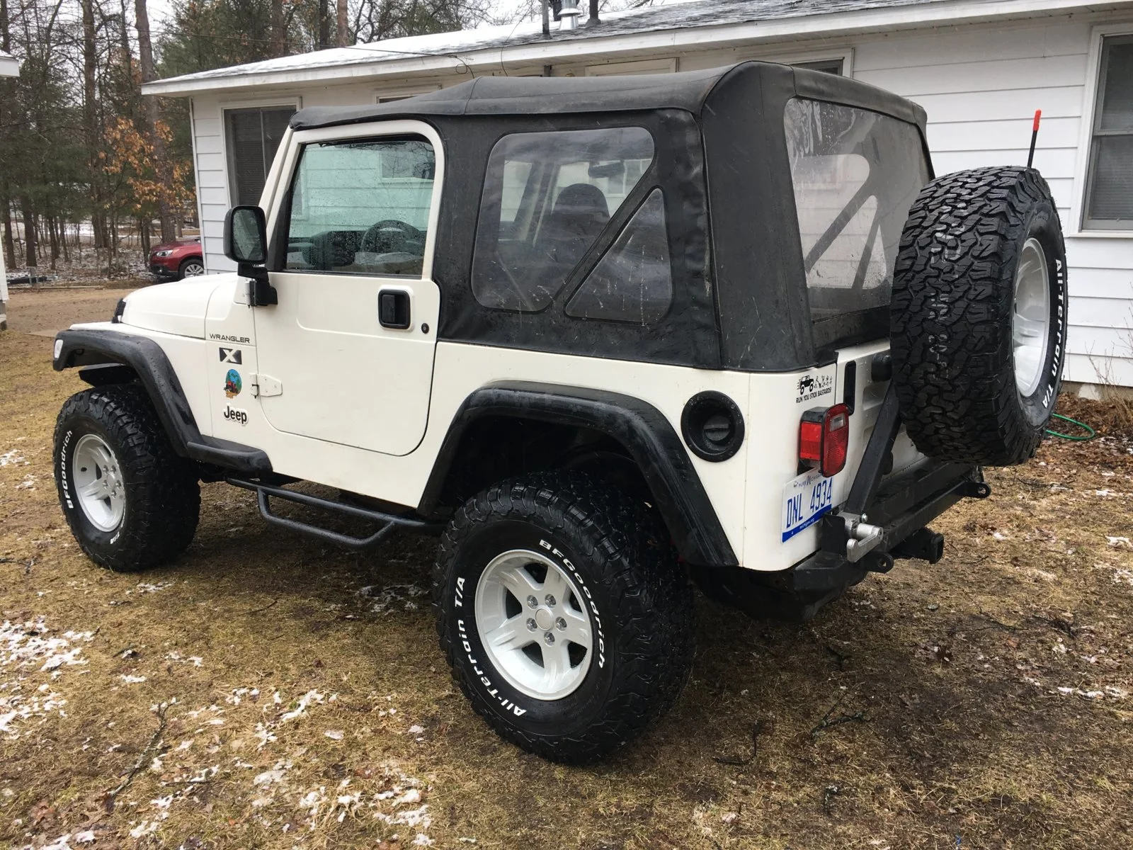

Details on the leveling spacers?
When I bought the Jeep the PO had these rubber spacers that went above the front coil springs. They are good for about a 2" lift. I removed them when I put the new 4" lift on (when it was on 35's). When I went to the 2" springs the front was down about 1.75" from the rear. So I removed the factory rubber isolators and replaced them with the 2" risers ai previously removed to give a 1.5" lift. Now the rear sits 0.25" higher than the front. Hope that all made sense lol

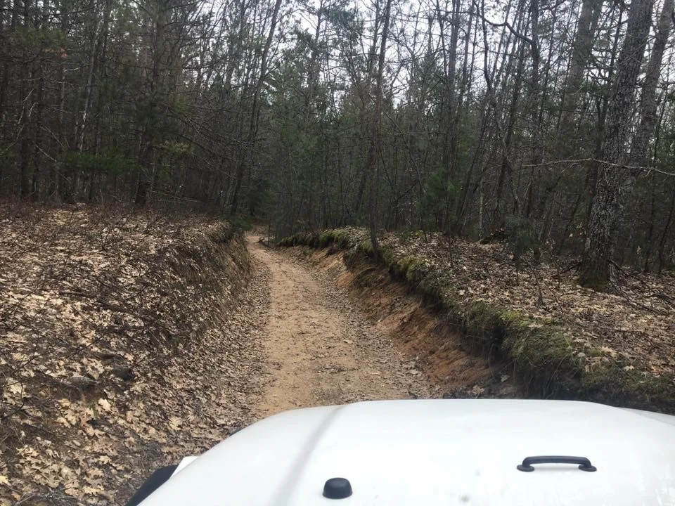

From yesterday after work:
