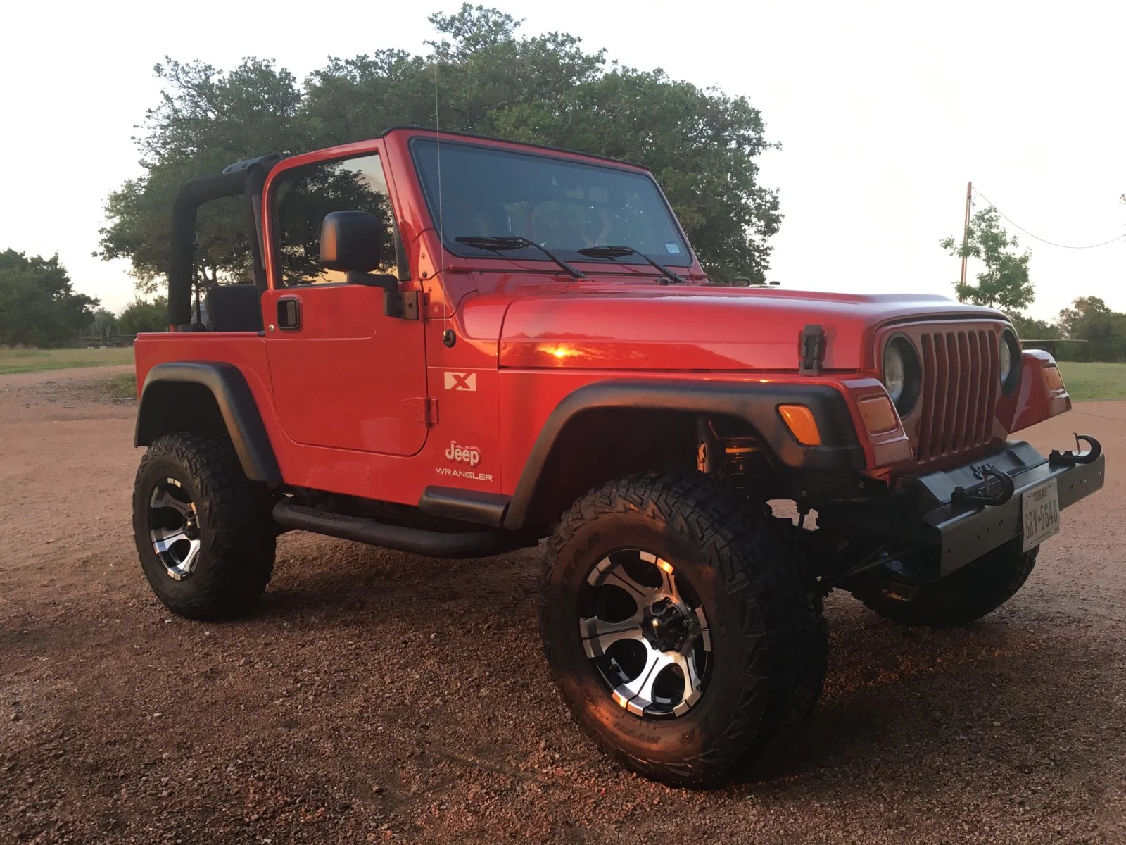

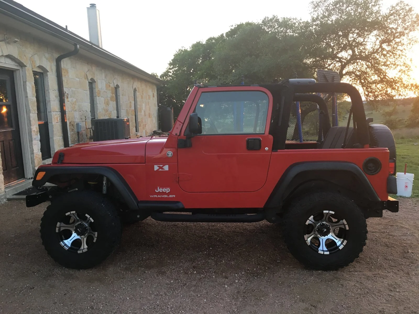

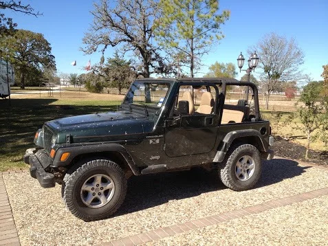

This is what I used to have (31" tires, and nothing else). Very tempted to go back.
Like others have said, ditch the body lift and MML and keep the 2". To me a 2" is just about right for 31's, you can flex it without any rub and you get to keep the belly clearance.

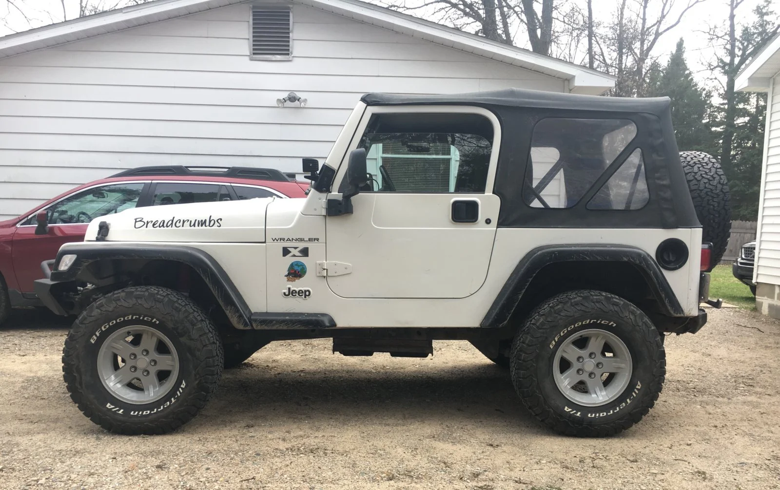

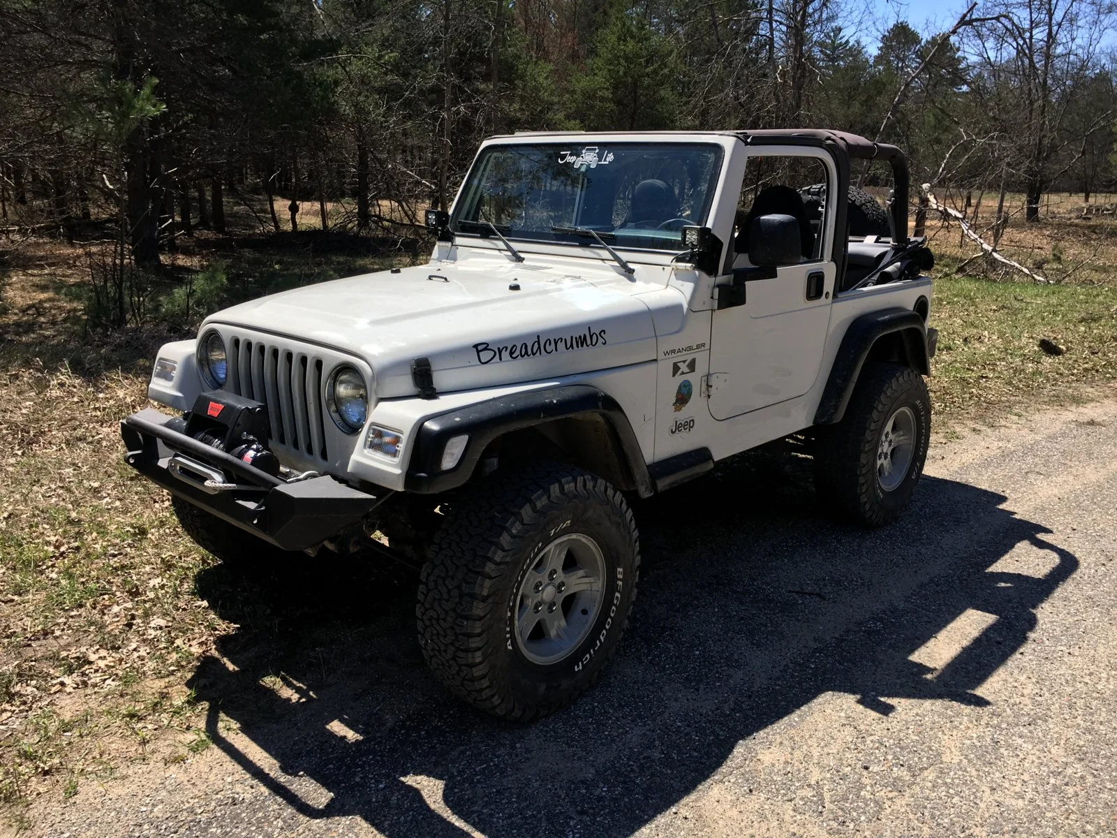

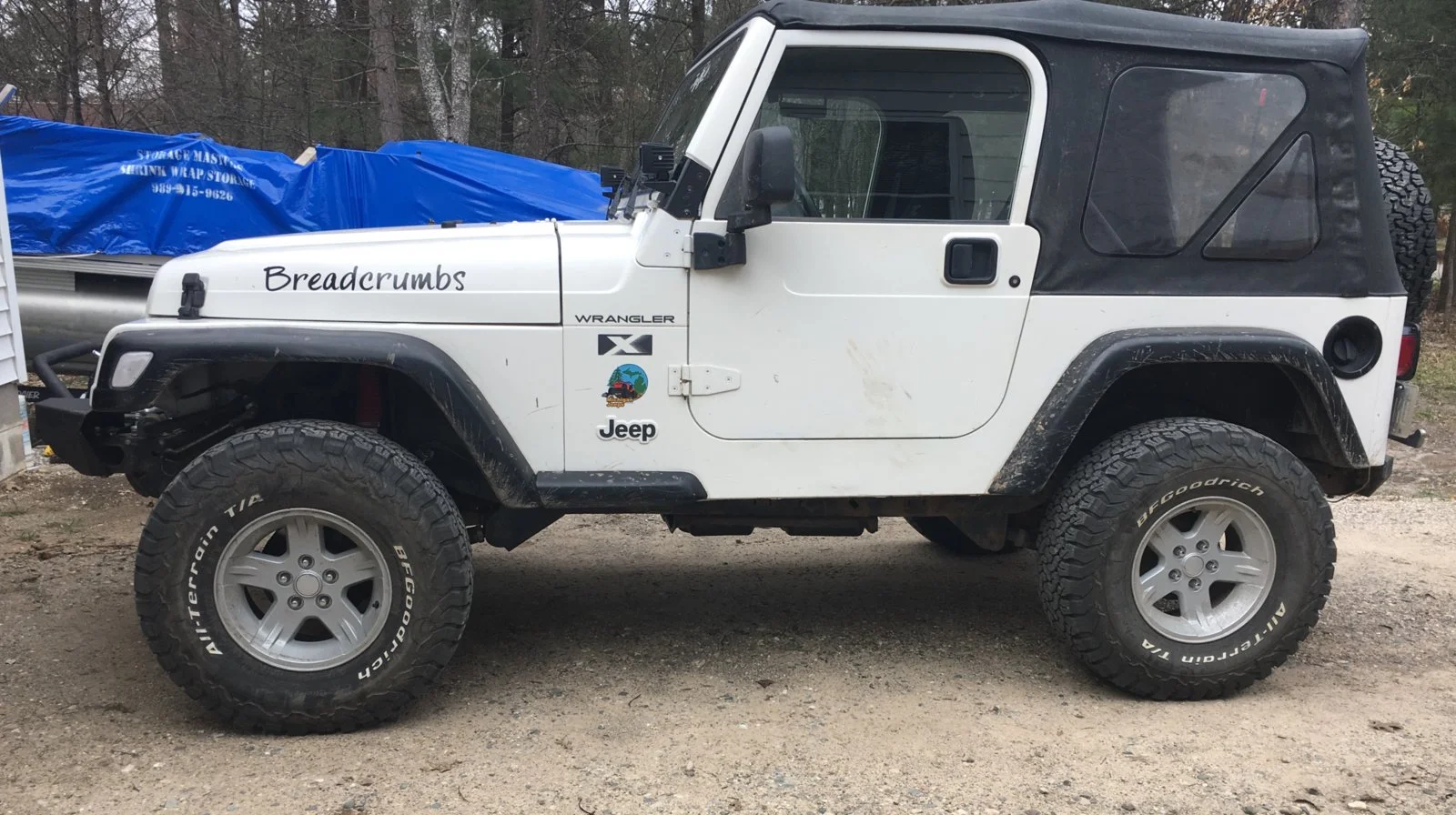

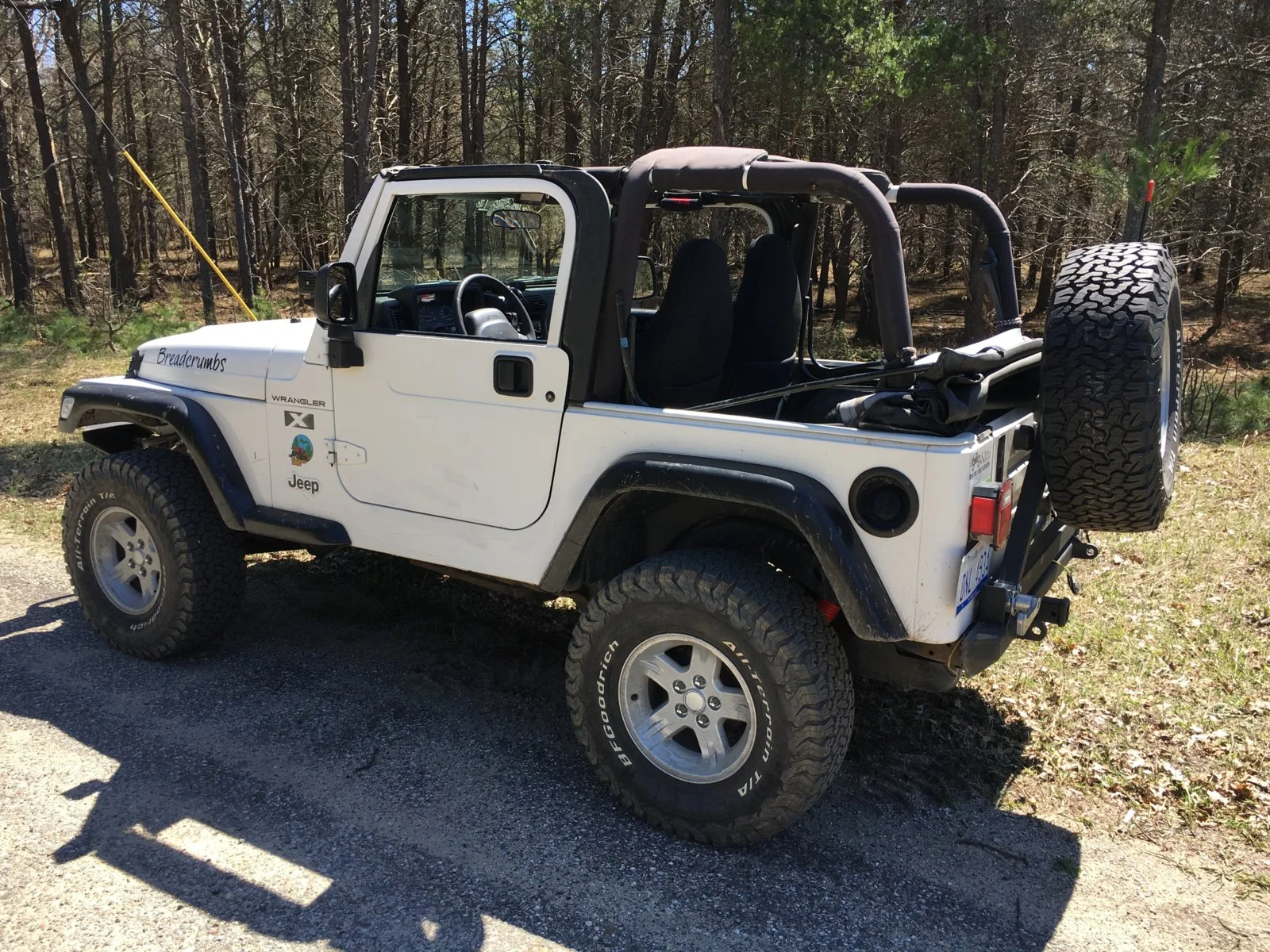

Here's mine on 32's with a 2" lift and added spacers to the front to level it out:

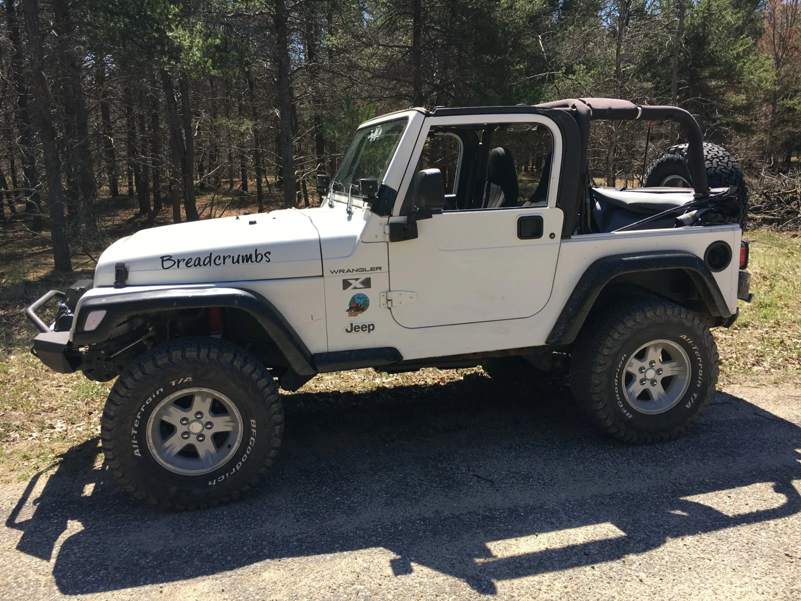

@Nashorn101 I really like my 2.5"OME with no BL or MML. I'm actually getting 2 3/4 in F and 3 3/8 in R with hardtop. I'm light though. Can't decide now whether to do fenders and regear to 4.56 for 33's, or stay with a 31 build and tummy tuck

@Rob80x - Are you running 32x11.5? On the Ravine's, are you rubbing at all or are you running spacers? Also, if those are stock flares, how is the coverage?
Yes 32x11.50's with 1.5" spacers. Slight rubbing on the control arms w/o them. Coverage is pretty good. May add some Rubicon flares down the road.

Sure. Heres a few angles
