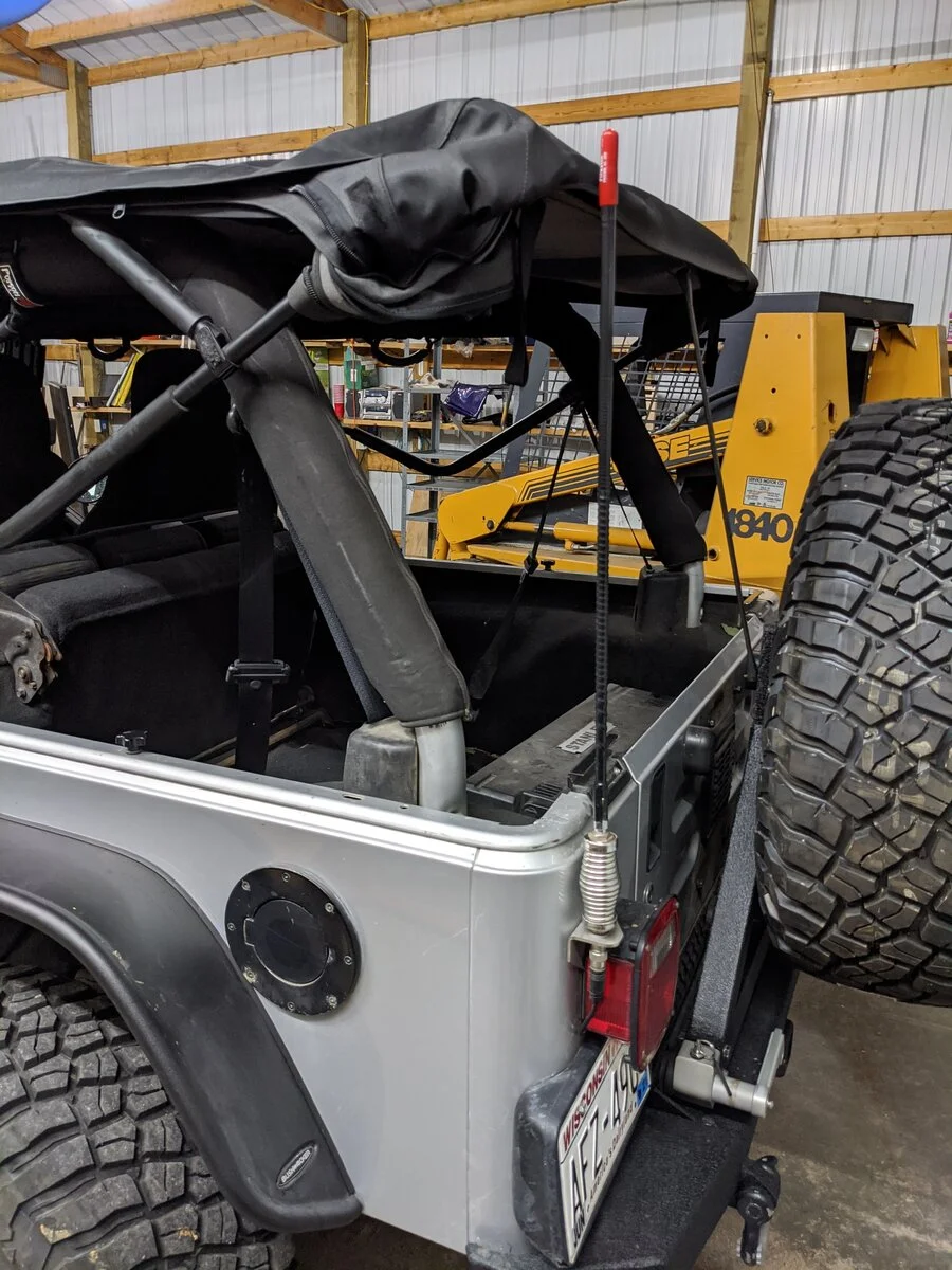

I started out with a firestick FS-3' antenna with a Firestick heavy duty spring on a stainless steel taillight mount bracket. You can't go offroading with this setup as the antenna whips too bad and beats up your top. Plus, the antenna hits when i pull into my 7' garage door.
On my second attempt, i lost the spring and went with a 2' FS antenna. Plenty of reception for jeeping in groups, doesn't beat up my jeep from whipping, and does not hit my garage door. I think this is a great way to go.
BTW, grounds are so important, I grounded thru the stainless bracket (Quadratec Part #: 96080.111), to the jeep and also ran a ground strap from that bracket to inside the jeep fender well.
With a good ground, a Uniden 510 CB, the 18 foot cable from CB to rear taillight for jeeps, stainless taillight antenna mount, and FS-2' antenna, the system works great and was "tuned" from factory. I also mounted my cb with a dash mount that mounts on the left side of the dash. Seems like a great spot - out of the way and looks good.

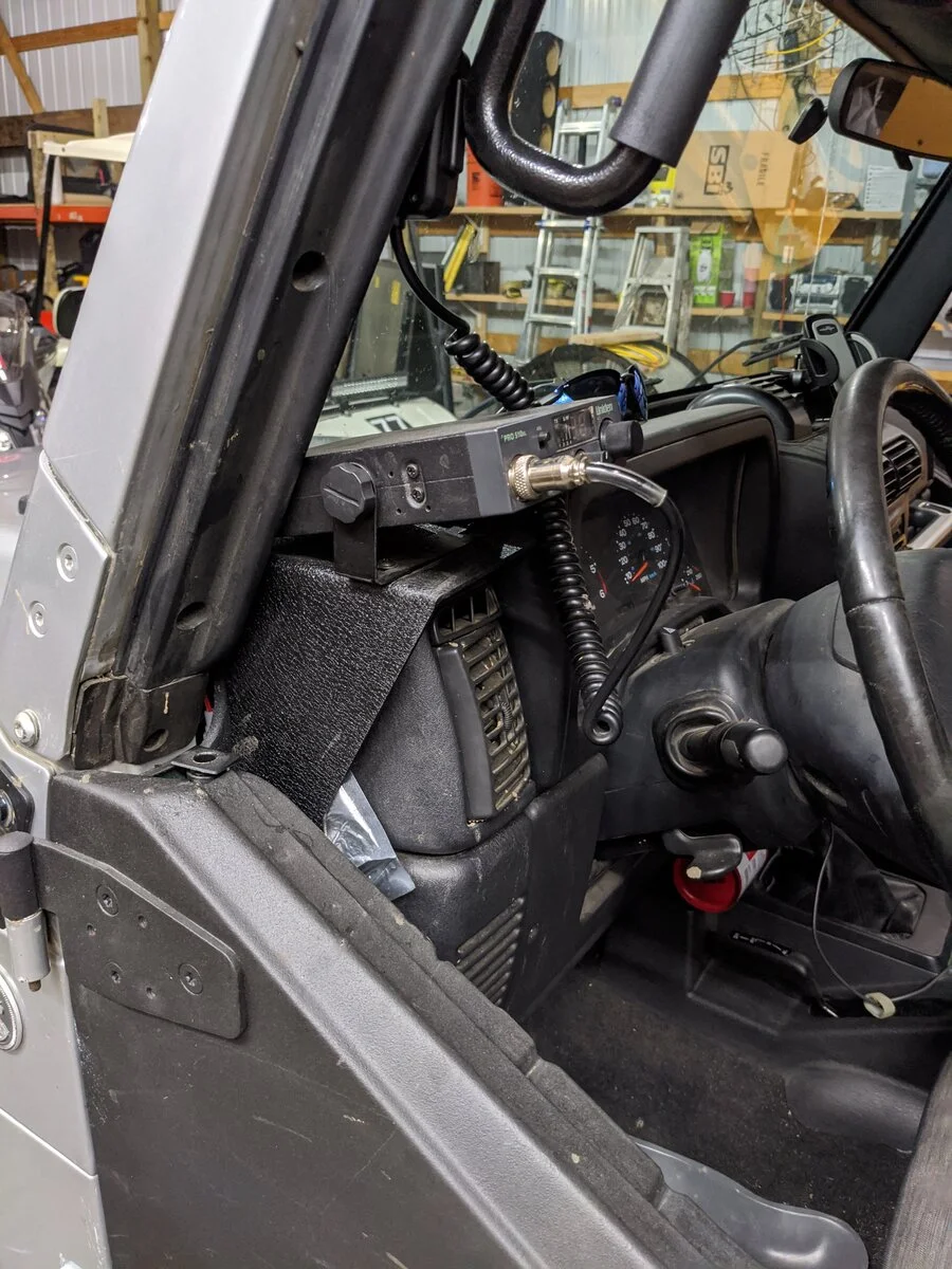

Any pics of the setup? Clearing 7’ garage door is a priority. I’d love to see how it looks.

I do have to make an adjustment to my original post, my 3 ft FS antenna was tuned. The 2 ft I had to adjust about 3/8 of an inch out on the tip. Also, my buddy found a spring at a gas station for 10 bucks that is about three times more stiff than the FS heavy duty spring. I did install that
Thanks for sharing! I like how that looks a lot. I wasn’t sure if the antenna would get sufficient reception being that close to the roofline. I’d think it would probably work similarly with a hard top? If so that seems like a winner to me.
I also have a hard top. And it works just fine with the hard top. Don't get me wrong, the 3 ft that gets the antenna a little above the roof has much better reception, but if you're within I will half mile a mile of other Jeeps, the 24-in antenna is fine

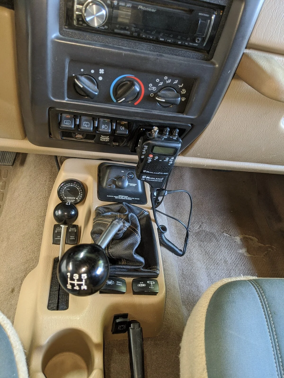

If I already did not have my Midland 75-822, I would install this one.
I stumbled across it a few weeks ago on Amazon and picked one up. Very nice radio and truly amazing how small it is. Would highly recommend this to any Jeeper.
