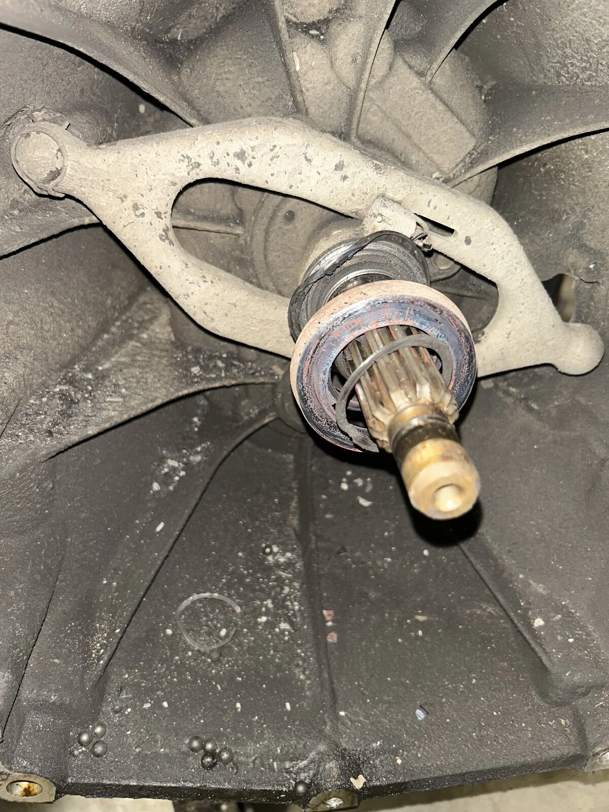

First and foremost my issue was most definitely my Throwout Berring!

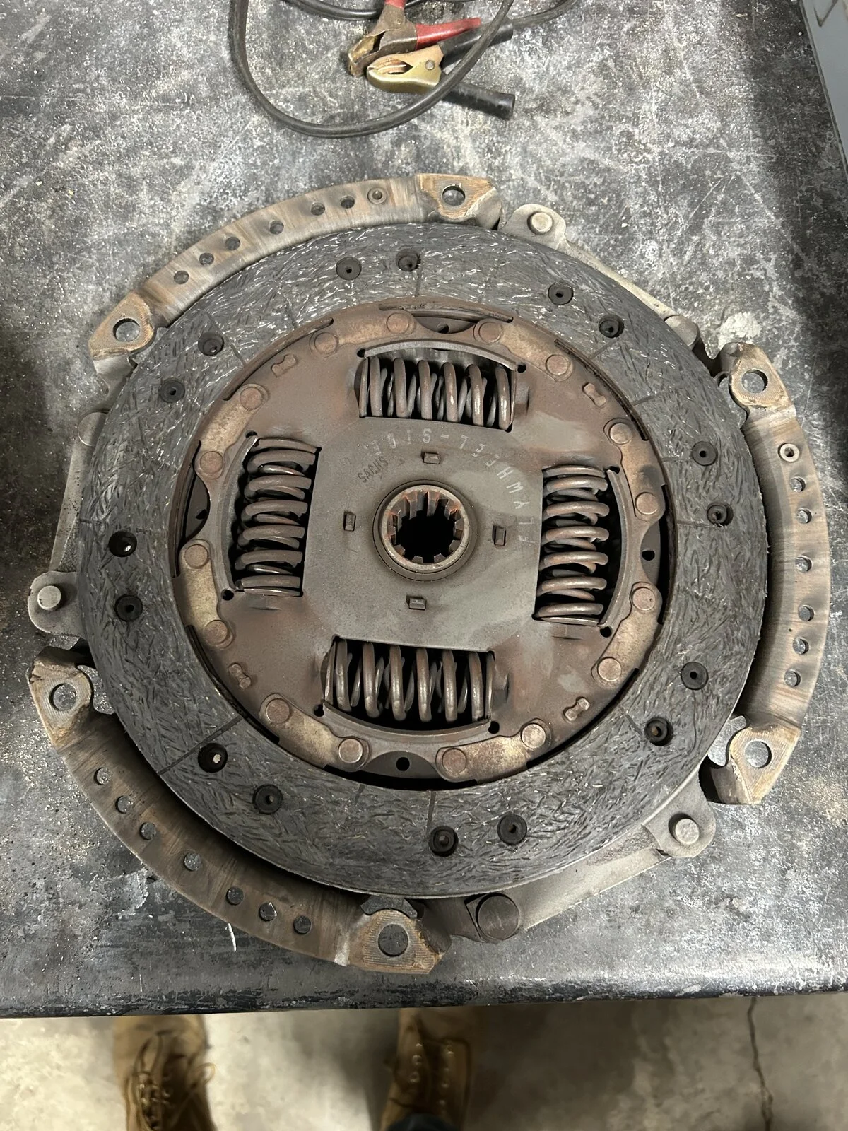

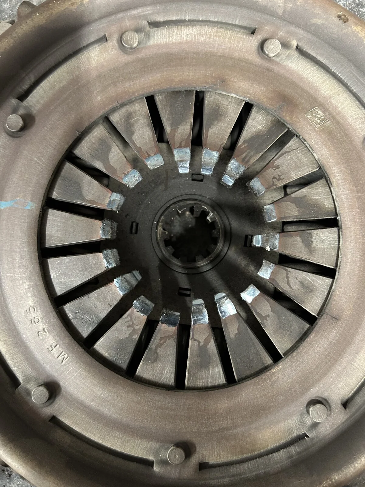

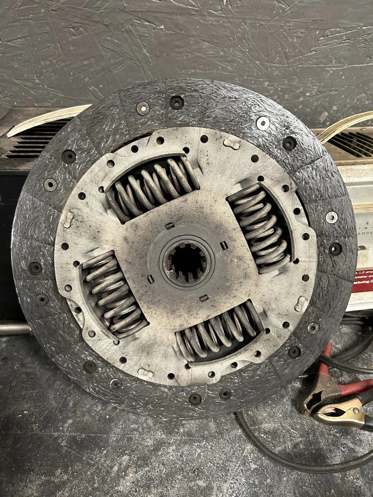

Next was the clutch which had some pretty good wear and tear as well. Down to the rivets on one side and more than a few broken teeth as well.

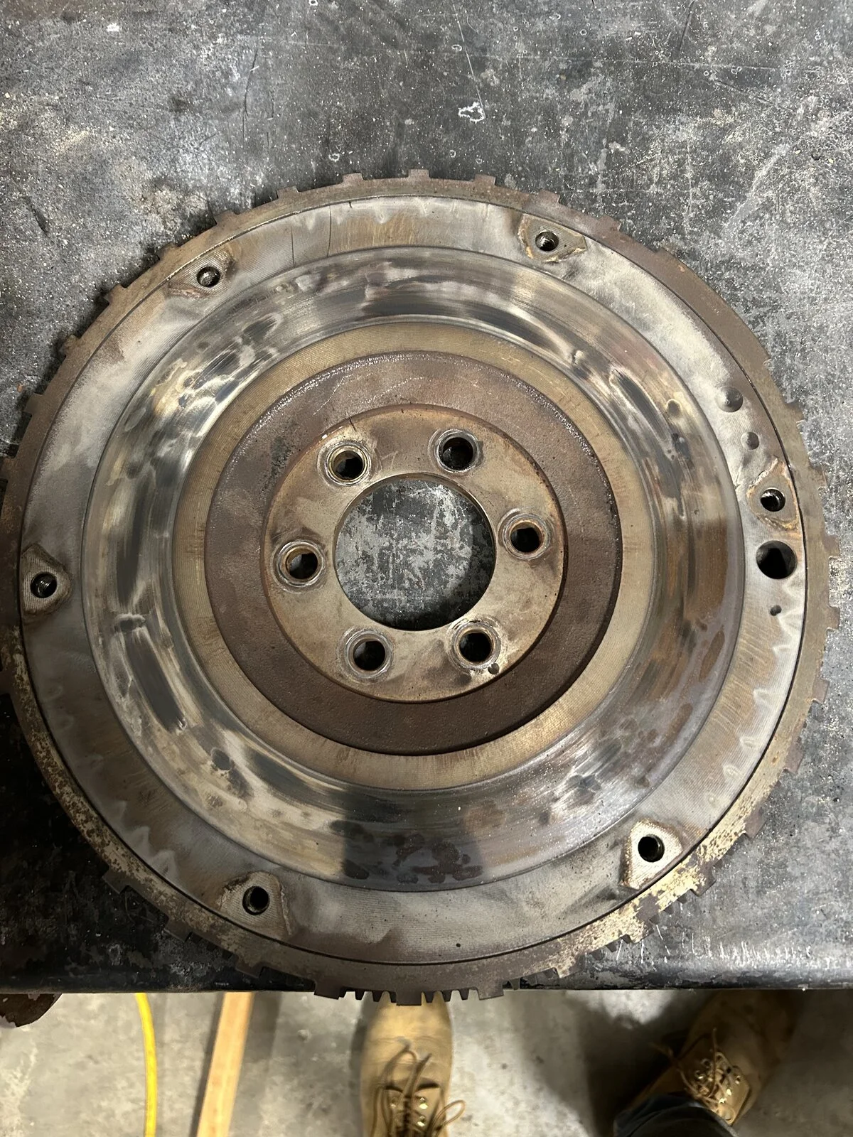

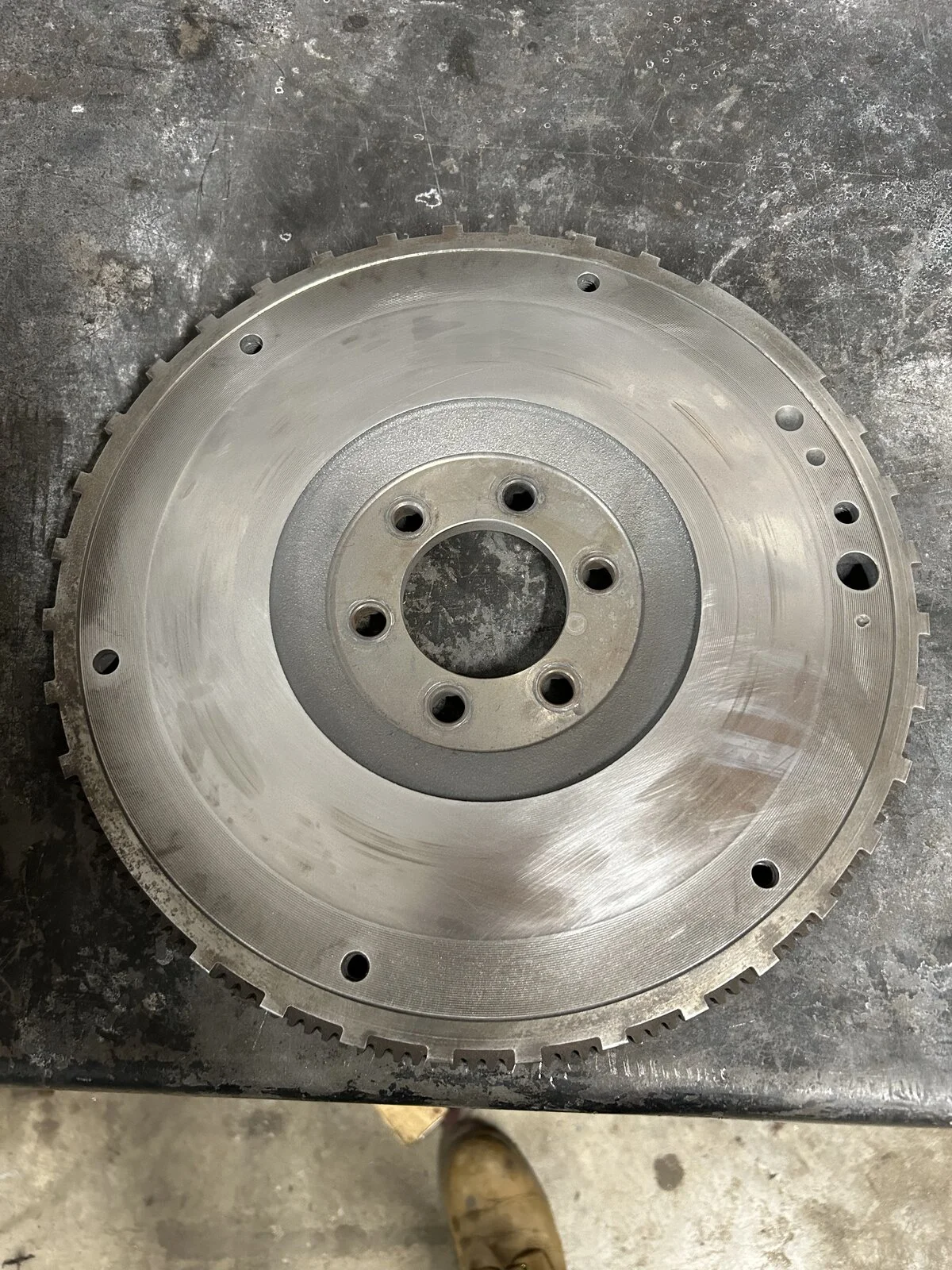

Next is the flywheel before and after a good cleaning and sanding. It cleaned up very nice and as far as I can tell there is no deep cuts or grooves and should be reusable! Much like @Jerry Bransford mentioned.

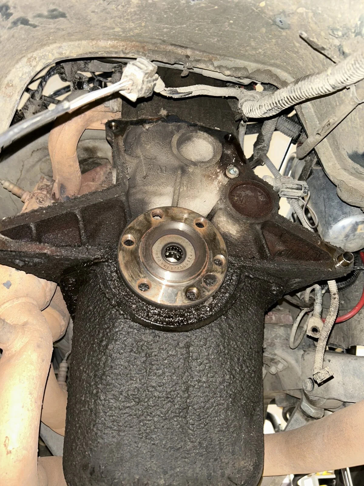

Lastly is what I believe is the rear main seal leaking? Going to buy a gasket kit for this and the oil pan. Overall not a terrible job to do but pretty time consuming. Happy to get the TJ all sorted out and refreshed where it counts the most!

1. Can you confirm the flywheel looks good to reuse?
2. Is that indeed the rear main seal leaking?

Definitely rear main seal...it's a 2 piece and requires removal of the oil pan and rear bearing block. Lots of good posts on the topic. Use a Mopar seal and rear loctite on the block mating surface. Felpro oil pan gasket. Might be fixed using high mileage oil and there's a post on AT-205 reseal "fixing" the issue.

Before going to the trouble of replacing the rear main seal, try this first. Simply change your engine oil to a High Mileage conventional 10W-30 engine oil like from Pennzoil. That can restore the condition of the seal and stop the leak. Some synthetic engine oils can dry that seal out and cause it to leak. Doing this cured a massive rear main seal leak in my previous daily driver BMW that had only seen synthetic engine oil.
It took my BMW less than a week of daily driving for the leak to completely stop.

Appreciate the recommendation but unfortunately I’ve been using 10-w30 high mileage for as long as I can remember. Still leaks pretty good. I don’t mind the extra work just wanna get it done while I’m under there.
As far as the flywheel goes though, it’s good to go back in so long as I can’t run my nail on it and catch any scratches or chips right?

Yes your flywheel sounds like it's good to go. And you have been running a conventional not synthetic High Mileage right? If so yeah your RMS is toast lol.
