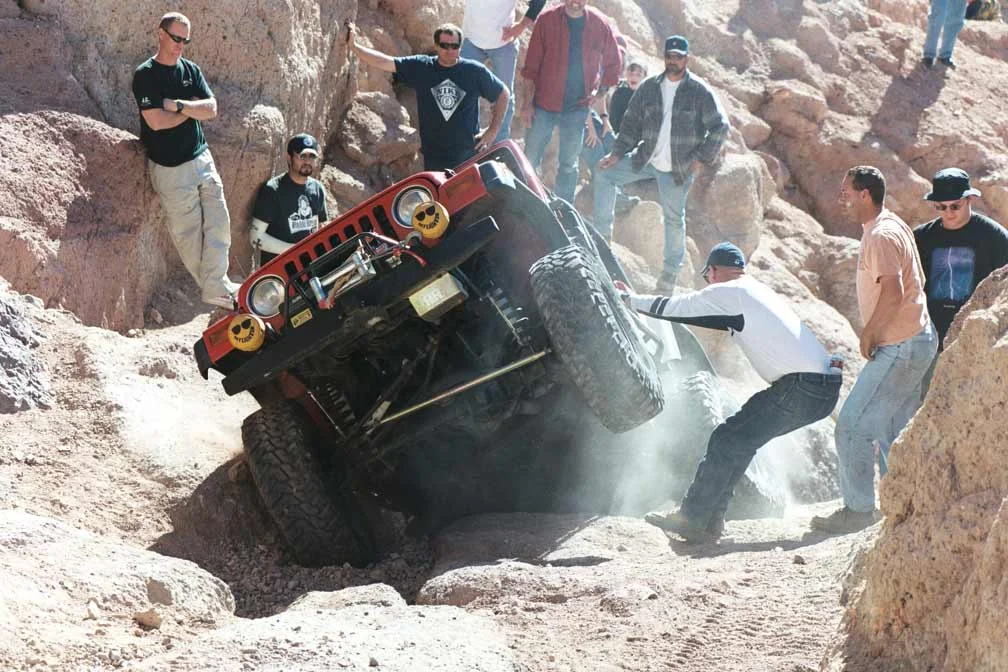

The Luk is still the best choice for you in my opinion and to me, overlanding is not nearly as hard on a clutch as you might think it is.
The below smoke is from my Luk clutch, it regularly sustained such abuse while rock crawling and I doubt yours would ever experience anything like it from overlanding. Uses like the below is why I finally converted to an automatic.
Jerry_up_in_smoke.jpe
