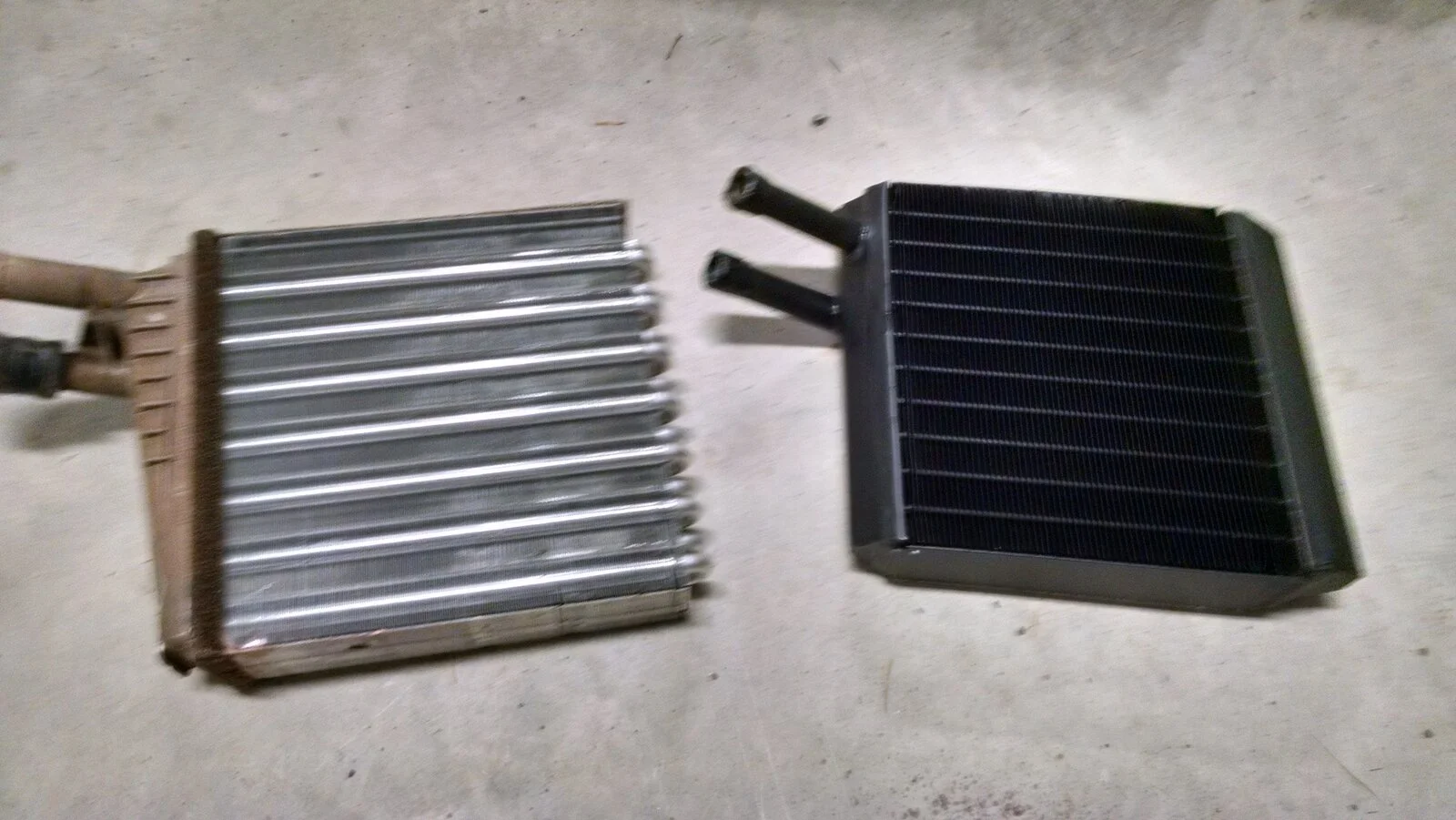

Heater core is fixed! Ordered one from Brass Works, swapped out myself. Removing the dash is not a light task, took me about 3 hours to get the HVAC box out. The heater core the shop used seemed fine. Didn't have much faith swapping in the Brass Works unit would produce heat, but it does!
I had to know why so I took the plastic tank off the removed heater core. There are plastic twisted support things in all the tubes! No doubt to keep the tubes from getting squished while being assembled. BUT, seems like they should have removed them before putting the tank on. These essentially blocked 80% of the flow. No wonder it didn't produce heat.
Had the old leaky factory core and removed the tank, sure enough, no plastic things. Going to see if I can get a picture posted.

Aftermarket on the left, I pulled one of the twisty things out. Factory on the right. I've heard some owners say they swapped out for another aftermarket unit and it magically worked. I'm wondering of this is a quality control in manufacturing? Twisty things inserted to keep soft tubes from getting squished? Once the fins are on and tank is ready to install, twisty things should be removed.
Factory unit didn't have them.

Those twisted things aren't for support. They are called turbulators.
I stand corrected, found an interesting post on them:
https://www.wranglerforum.com/threads/twisted-plastic-in-heater-core.2426525/Supposed to be in there or not, they don't seem to improve anything. If my old factory unit didn't have them and produce amazing heat.
The Brass Works heater core is more like a radiator. It takes a little longer to get saturated with heat, but it produces some very nice hot air.

I can see possibly one that almost lines up with one of the hose connections getting pushed or sucked out, but not the rest.
The plastic turbulators are so thick they take up about half the tube area easily. If they were metal and thinner, maybe the core would have produced heat?
I'll bet Brass Works uses them too although they may be made out if metal.
They don't need them because it's built like a little radiator. The tubes are thin and flat seems like creating a lot more surface area. The Brass Works was $360 and 3 month wait, but worth it.
Sorry for the fuzzy picture, Brass Works had 3 more rows.
