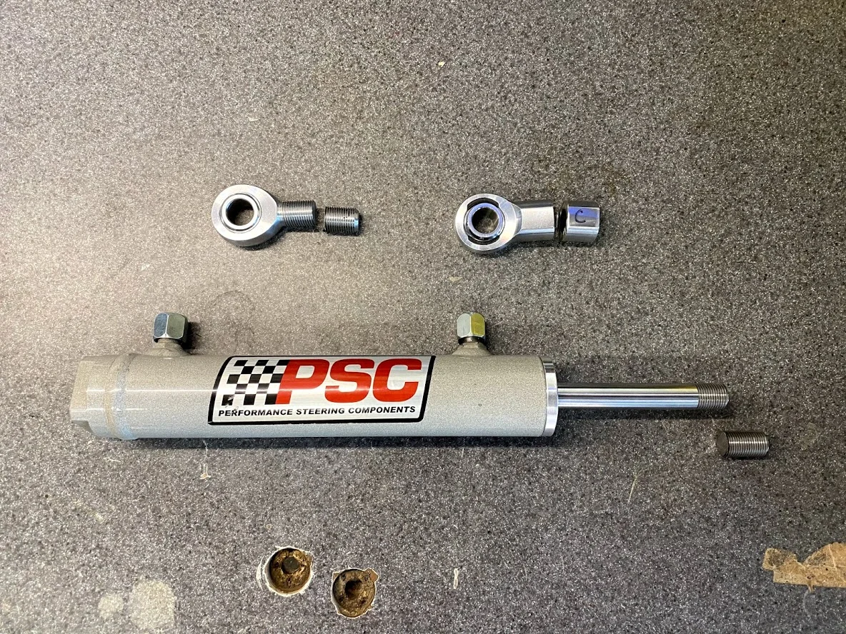

So if I were to keep the Currie steering and use mr blaines kit. How would I modify the ram to work with his kit
First this only applies to the PSC cylinders. You start with the 1.5" bore x 6" stroke. Cut the male rod end down so it screws into the body without a jam nut all the way until the body of the head bottoms out against the cylinder. Orient that vertically lined up with the ports on the cylinder. Lock it in place with 609 or 638 locking compound from Loctite. Shorten the shaft until there is 3/4" thread, do the same to the female rod end, screw them together without jam nuts using the same locking compound.
Assuming you have the 1.5" x 6" ram, it's a fairly simple process - so easy, I could do it! :ROFLMAO:
This took about 15 minutes total - 10 minutes with some masking tape and a 4" cut-off disc, then about 5 minutes with a chamfering tool and long file to make the threads buttery smooth. Some Loctite 609 (per @mrblaine suggestion) and it was done.
