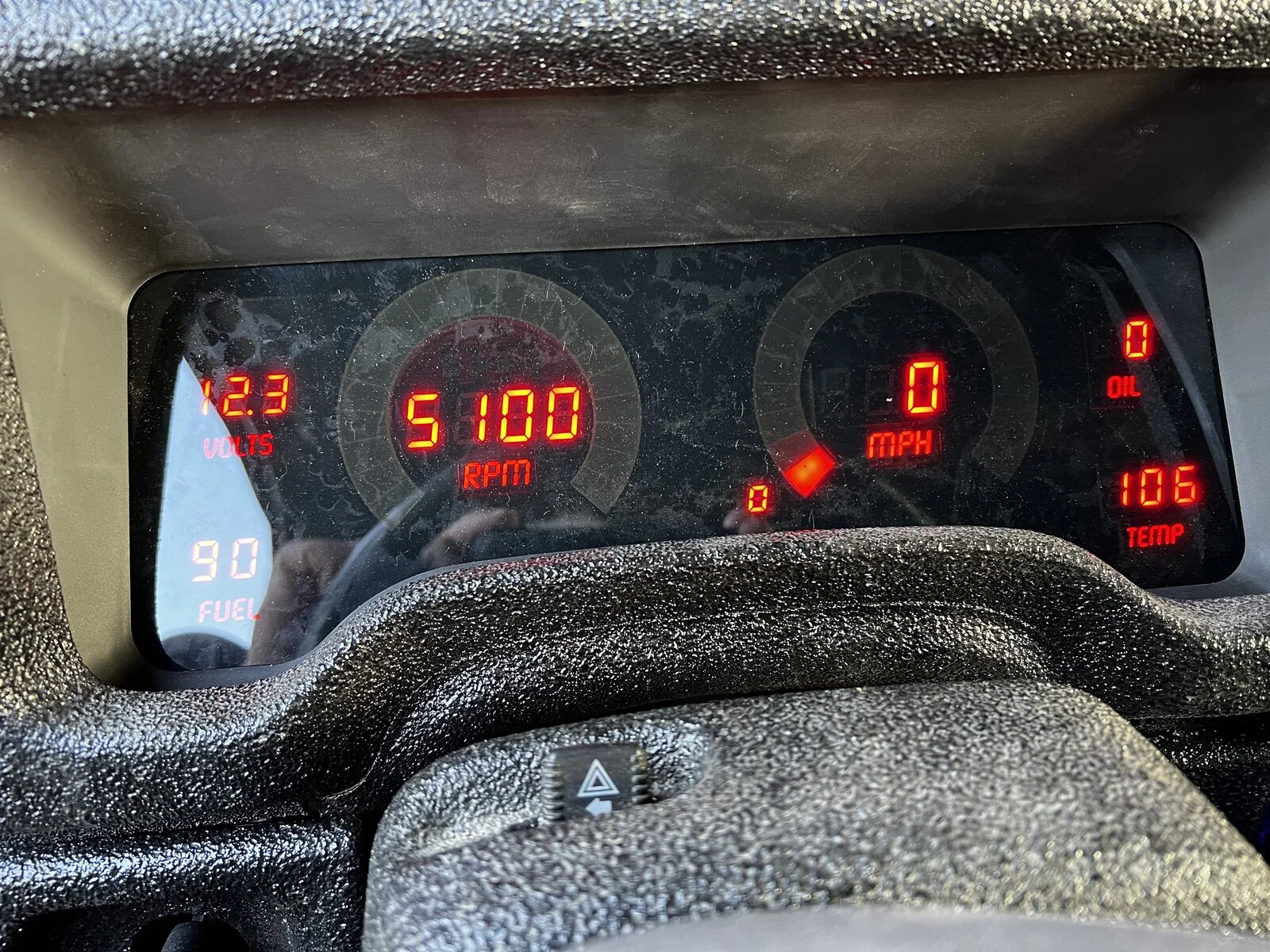

So your Speedo is connected to factory instrument cluster?
If so very nice.
No he has the Intellitronix digital dash too.
If so very nice.
No, I have a intellitronix digital gauge cluster made for the Jeep TJ. Pretty sure I posted some pictures here. I went this route since I ditched the Jeep PCM.
